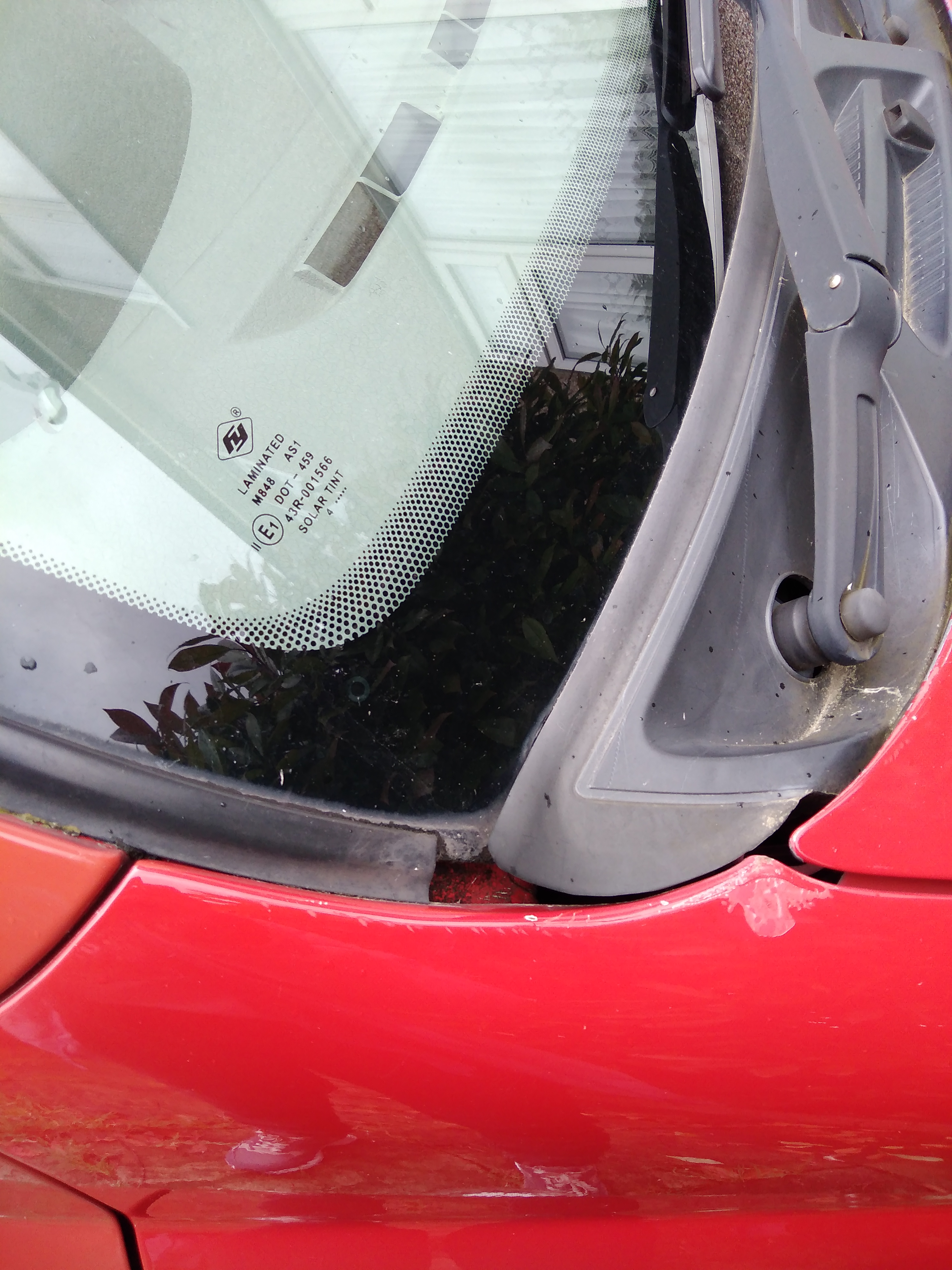

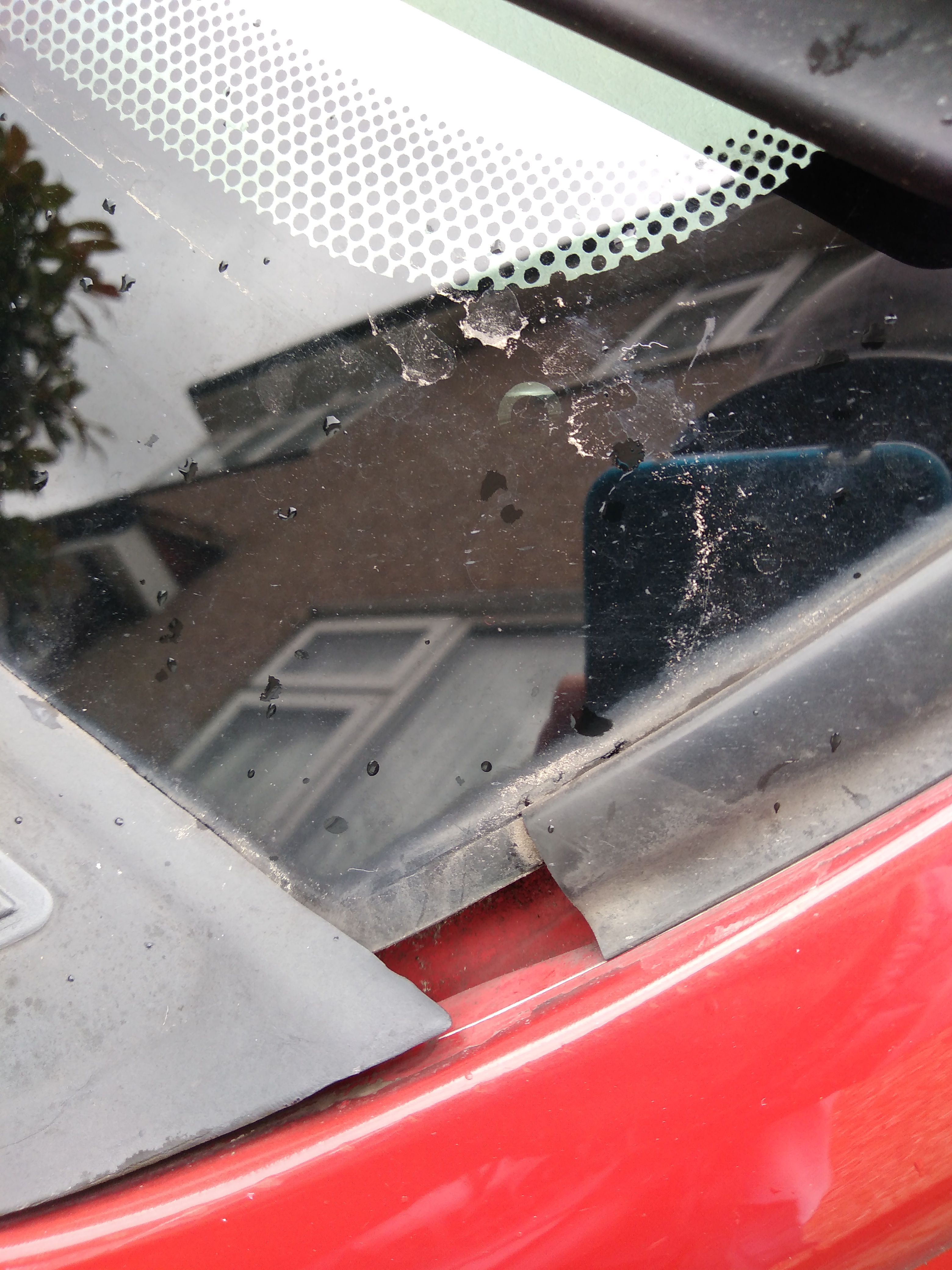

Hello All.
I'm hoping you can help me out with a weird window issue with my 2004 Panda 1.2 Dynamic. Just recently I've noticed the rubber weather strip at the bottom of the windows on the Drivers side have shrunk away from the edge by about 1/2 inch or so. (See attached Photos) Weirdly it is most obvious on the drivers side, though the passenger side is a tiny bit short as well. What worries me most is that water could get into the door and rot it from the inside out. I've already got an issue with the window on the passenger side front where it is grinding almost and that window has the best weather strip of the lot!
Is this a common problem? I know the car is 20 years old now, but I don't recall ever having an issue with any previous cars I've owned. The windscreen rubber has also shrunk by about 1 1/2 inches too and I've contacted Autoglass about it as the windscreen was replaced a few years back. I know they have a lifetime warranty, though I'm not sure they'll be willing to do anything. Still, worth asking I suppose.
I'd also like to know if I can buy an aftermarket replacement weatherstrip. I've tried my local spares shop and they can't help. The Fiat Main dealers have quoted £85 each for three of the windows and £42 for the other one, which doesn't make sense as the doors are surely the same just reversed for both front and back? At nearly £300 to replace the weather strip it's almost as much as the car is technically worth!
If I can't get any weatherstrip, does anyone have any other ideas as to what I can do?
Many Thanks

The shrinking is likely due to age, sun damage and heat drying them all out and causing them to shrink back.
firstly with the doors, water will always get down into the doors and there are drain holes at the bottom to let the water out again. There is a moisture barrier behind the door card that stops the water/moisture affecting anything in the cabin.
I would be inclinde to look on ebay for replacements from a lot newer car. There bits tend to get binned when people are scrapping cars therefore someone might do you a cheap deal if they're adverticing a panda as "breaking" This is probably the most obvious and simple way to deal with the problem and no they don't just turn the seals around for the back doors they will be different lengths.
They are very easy to remove, get your fingers under one end of them and pull it up, then just work your way a long pulling it up so you don't bend it. most are strong enough to pull it up at one end and continue to pull it completely away from the door in one go.

We owned a 1.1active from 2004 to 2018
It did something similar.. But NOT at 20 years old
From memory.. The black end cap of that strip/trim used to Expand in the sun, and would snag as you opened to door
Member @koalar may well have experienced both scenarios..🙂
One side of my 2010 was like this for years with no bother
However if you want it to look cosmetically correct, I suspect the options will be limited, for a reasonable cost,
My gut is saying most 169 will be in a similar condition, from the breakers, unless you are lucky enough to find one that's lived in a garage
As they are shaped and clipped it not as easy as the door seals, which can just be bought of the roll
I also suspect the later 319 will be the same
I have no proof to either case
I have had all manner of cars where the door rubbers shrink like this, and our blasted patio door which has shrunk at least 3cm at each corner! I treat these bits now with Armorall Shield which seems to help keep the rubber flexible and prevent its shrinking as far as I can tell. I expect its UV light that is the cause. My OCD streak will not tolerate such things so I would just buy a new one, if available, but in reality as others have said its mainly a cosmetic issue.

Correct. keep them lubed. Tyre shine or Armorall Shield it helps. I think 319 rubbers are worse.
Your best bet might be to find some replacements from a scrapyard car. They made that shape up until 2011, so you could fine much fresher rubber strips. Give a ring around the scrap yards? Online / eBay sellers might be able to help, if they have a Panda or various Panda parts listed but not the rubber bits, message them and ask for a price, they will usually list on request for you.
If/when you get new ones, get some silicone spray (most hardware shops sell it) and spray on a paper towel and rub along the rubber parts, do this on all rubber rubber components to keep them good. And spray them along the channels the door glass slides up and down, it'll keep things running smoothly. Avoid any oil based products on rubber as I think they can eat away at it. I do this twice a year on my cars, but even my 2005 Panda I kept until 2019 didn't (from memory) suffer from any shrinkage but it seems like this could be a common at 20 years thing.
Find a new model Fiat and measure the side window wiper rubbers. If they are longer than you need, buy a set and trim to fit the Panda.
Please note that new vehicles often have the middle of this rubber bulging upwards. Especially in summer. (eg Merc vans).
