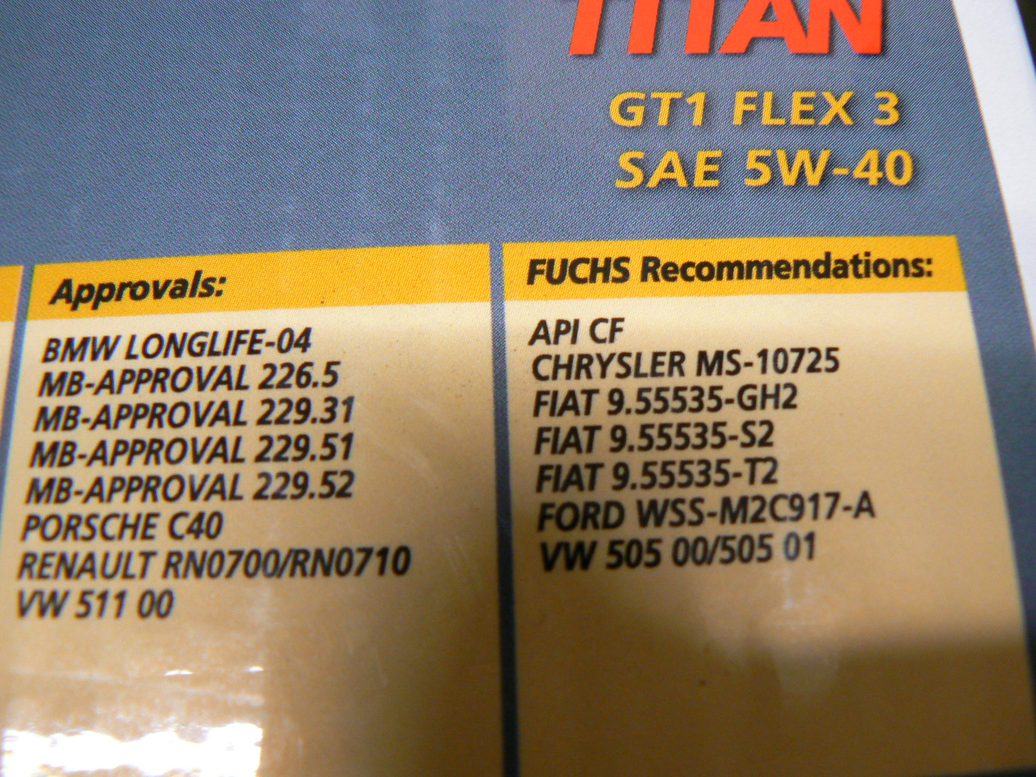

I use Fuchs Titan GT1 Flex 3 5w-40 fully synth in the Punto, which is also recommended by Fuchs for use in the Panda - Fiat 9.55535-S2:
So I use it in both cars. The thing about "approval" vs "recommendation" is interesting: https://www.fuchs.com/dk/en/product...specifications-approvals-and-recommendations/
Many manufacturers of good quality oils quote "approvals" but it's not common to find "recommendations" so I've been looking into it and I think it basically boils down to this. The approvals are manufacturer approvals. This means the vehicle manufacturer approves/licences the particular oil for use in a particular engine/vehicle. This process involves the oil manufacturer in very considerable expense. A Fuchs recommendation is where they know the oil meets the specification quoted but have not gone through the expense of licencing it with the manufacturer. As an official first fill provider to VAG I'm happy to take a Fuchs recommendation at face value.
