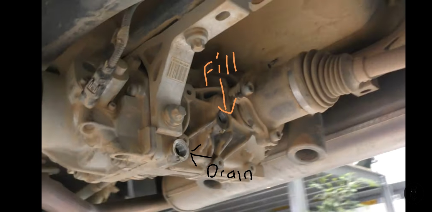

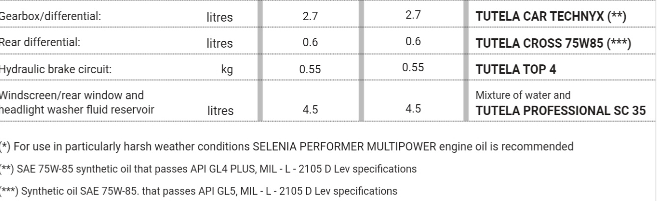

Did anyone have any info on the service oil and drain / fill points for the diffs?
Thanks!
Not it states API I have no idea what that means but someone was told by the oil manufacture that that some GL5 they had bought was not suitable and that bottle did not have API
