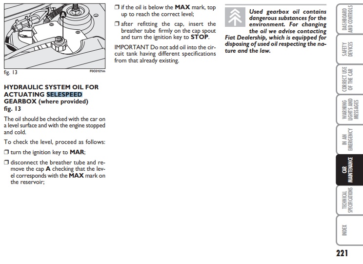

How do i check my selespeed level, i see no min or max level on the tank?
You'll have to check the owners manual as I'm a conventional manual box but I was of the understanding the selespeed system had it's own fluid dipstick. The Alfa setup did.
Note that the dipsticks also have two different scales on it depending upon system temperature.
Found it. See attached.
