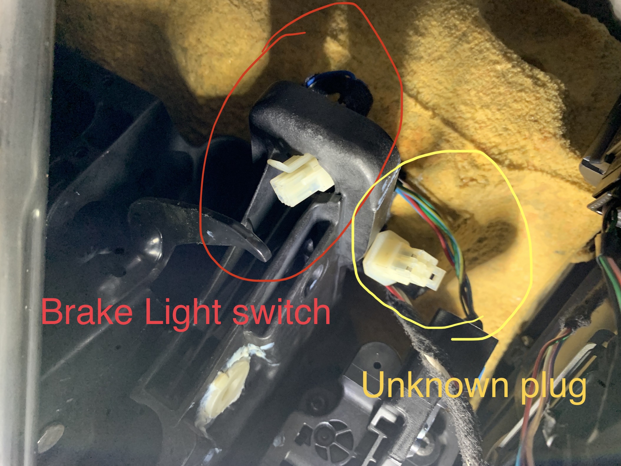

- I bought the switch already and comes tomorrow, so i went to remove the damaged switch and saw one plug disconnected near the brake switch and i don't know where it belongs, i don't know if this comes like this or somebody messed with it. Please Stilo Abarth Selespeed owners, can you tell me if the car comes like this or it was messed by someone, photo attached below.

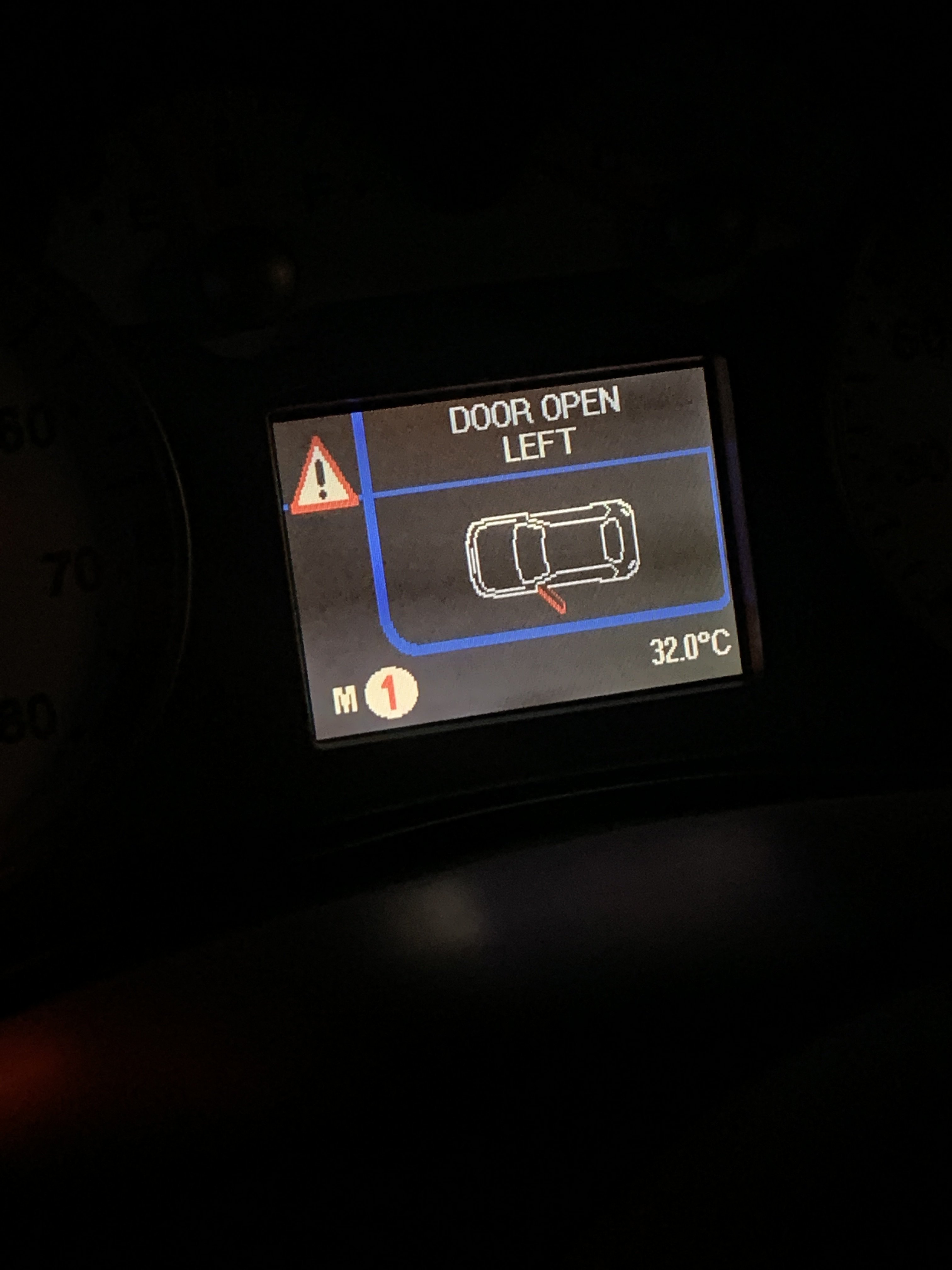

- The other thing really strange is that i can push the car and move it, but since i bought the car it's stuck in first gear (manual and auto), and i can't put it in neutral in order to start it.

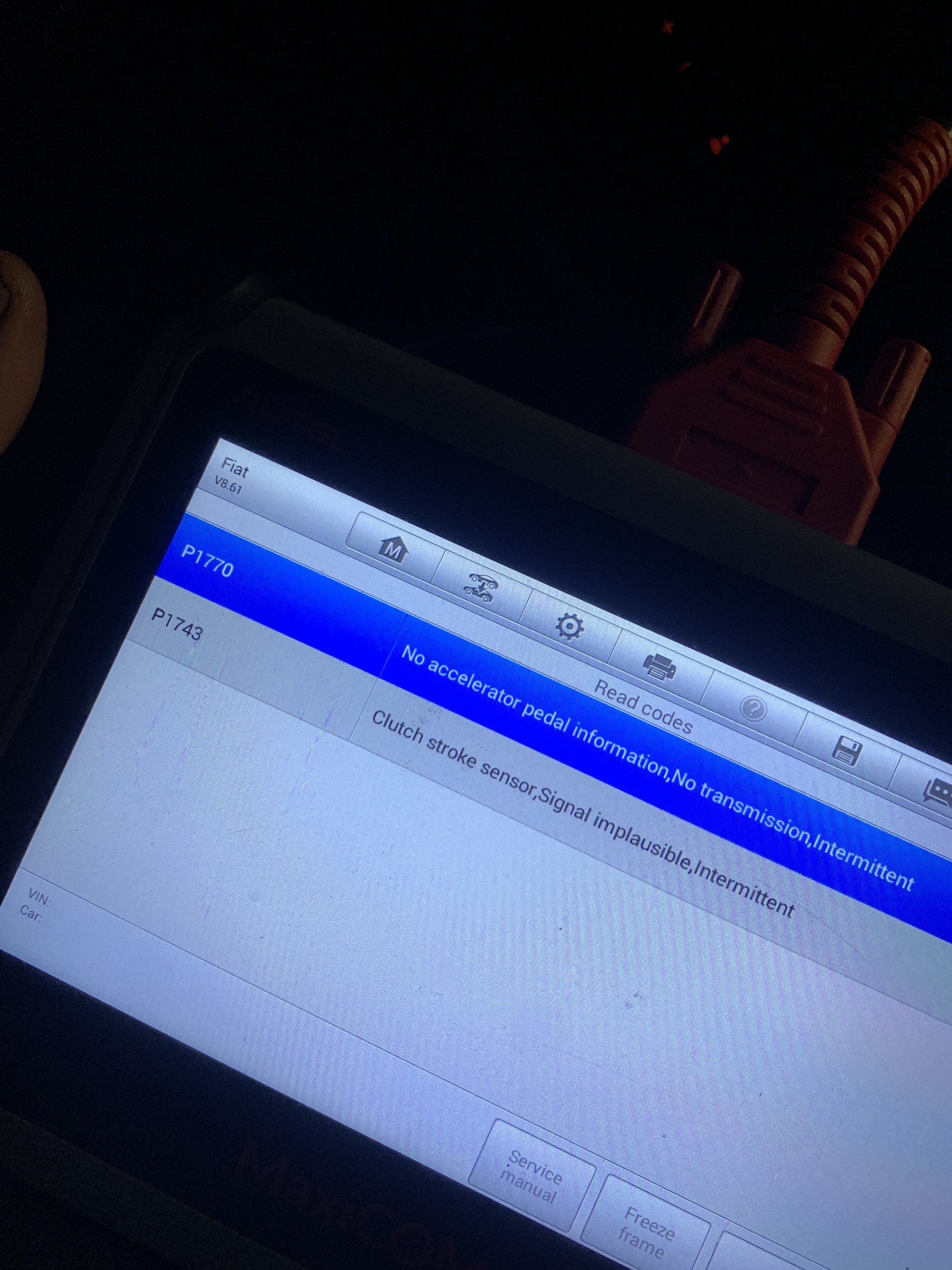

- Using my scanner it the only errors that appear are P1770 (No accelerator pedal information, No Transmission, Intermittent) maybe some issue with the plug laying around on the pedals (no clue), P1743 (Clutch stroke sensor, Signal implausible, intermittent). Before installing the clutch stroke sensor i cleaned it with electrical spray to remove the gunk inside it. Can the Selespeed "work" (at least click) with a damaged sensor or just it shuts down until the sensor is replaced? I really don't want to drop the gearbox again over a sensor :), but if needs it, we do it again, S*** HAPPEN.

I've replaced everything on the gear box, selespeed it's working (pump running when i open the door, good pressure on the system above 40 below 55) the thing is that, someone messed with the brake light switch ( it's inverted, like brake pedal depressed lights comes on, and when you press the pedal lights go out. Easy fix.) Just bought a license for MES and now i'm waiting for the ELM cable and adapters to work with the car. I will bleed the system and calibrate so it can work again. I've deleted all the DTCs (with my normal scanner) and they don't show up anymore.
