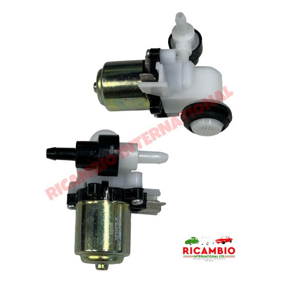

Hi Paul, electrics aren't my strongest point 😂 but the things I'd look at are the fuse you wiggled by mistake & it worked for a couple of seconds I'd look at that first as it could either be a dirty connection/corrosion or the fuse isn't sitting properly, if that's not it then I'd probably look at the washer pump itself for a dodgy connection etc. if it turns out to be a faulty pump they are readily available from Ricambio as in the link below
