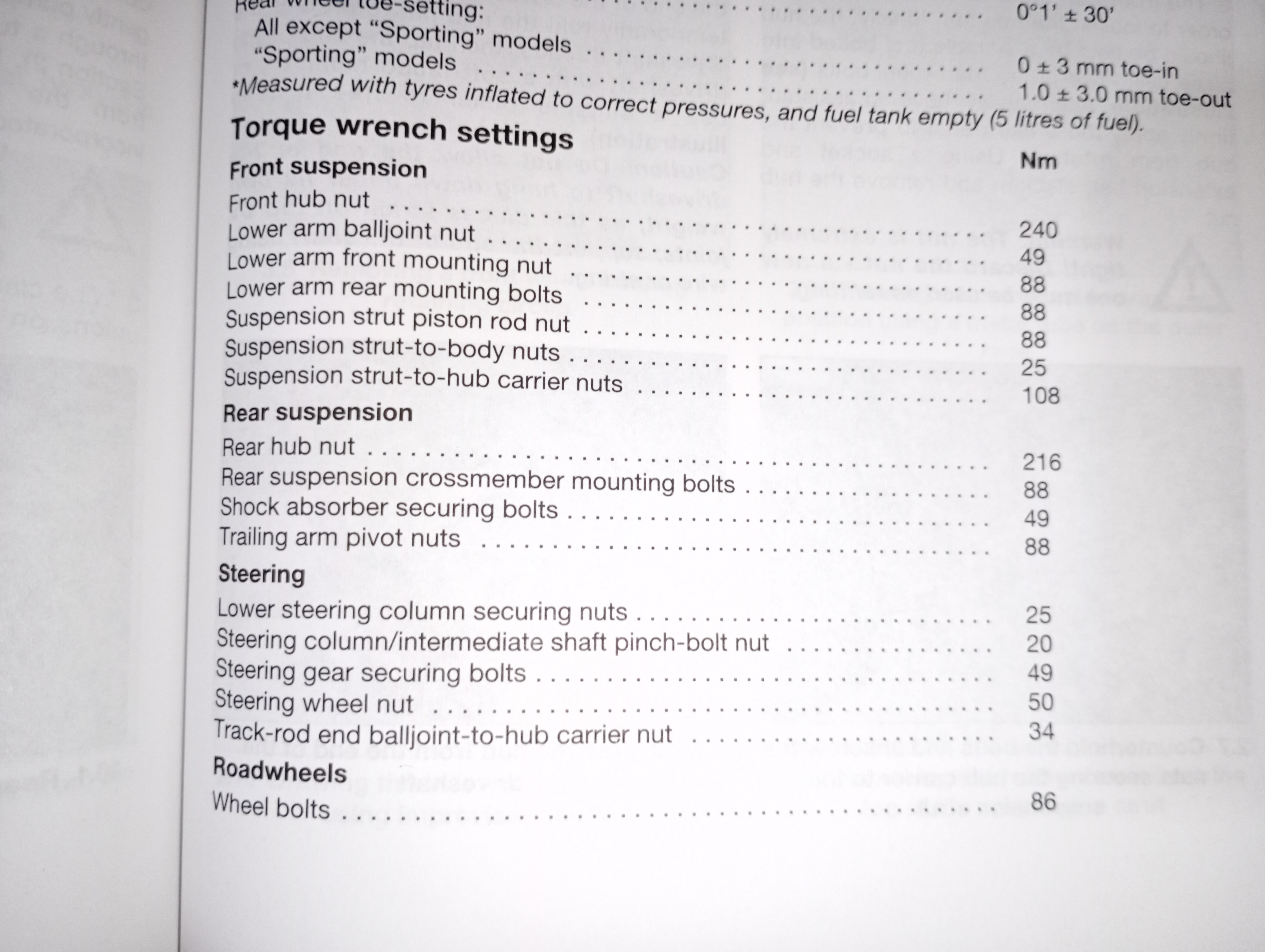

Hi Paul, I've just looked at the manual, although it's not the clearest at times 😂 but got there in the end as the manual is about 3 folders worth & it states the nut for the track rod end is an M10 nut as below.

Hi again Matt.Merry Christmas to you and your Family. The cars been on road few weeks now.Those torque figures on that download don't make sense.Can you please convert to nm or lbf for track rod end nut and front strut to hub assembly bolts please if you can .I got from my Fiat dealer 2 new track rod end nylock nuts with hopefully fine thread, to fit one tomorrow. Both trade £2.64.Every other spares shop or Garage had corse thread including me.Thanks in advance Paul 🎄
Hi Paul, merry Christmas to yourself & your family also. The Fiat ones are never the clearest, however I have recently purchased a Haynes manual for a Cinquecento as you cannot purchase one for a Seicento but all the torque settings, mechanicals etc are exactly the same & a lot of people on here use the Cinquecento manual for the Seicento, the only thing that's really different is the bodyshell, according to the manual the torque settings are
. Track rod end nuts - 34 nm
. Front suspension strut to hub nuts - 108 nm
Hope this helps

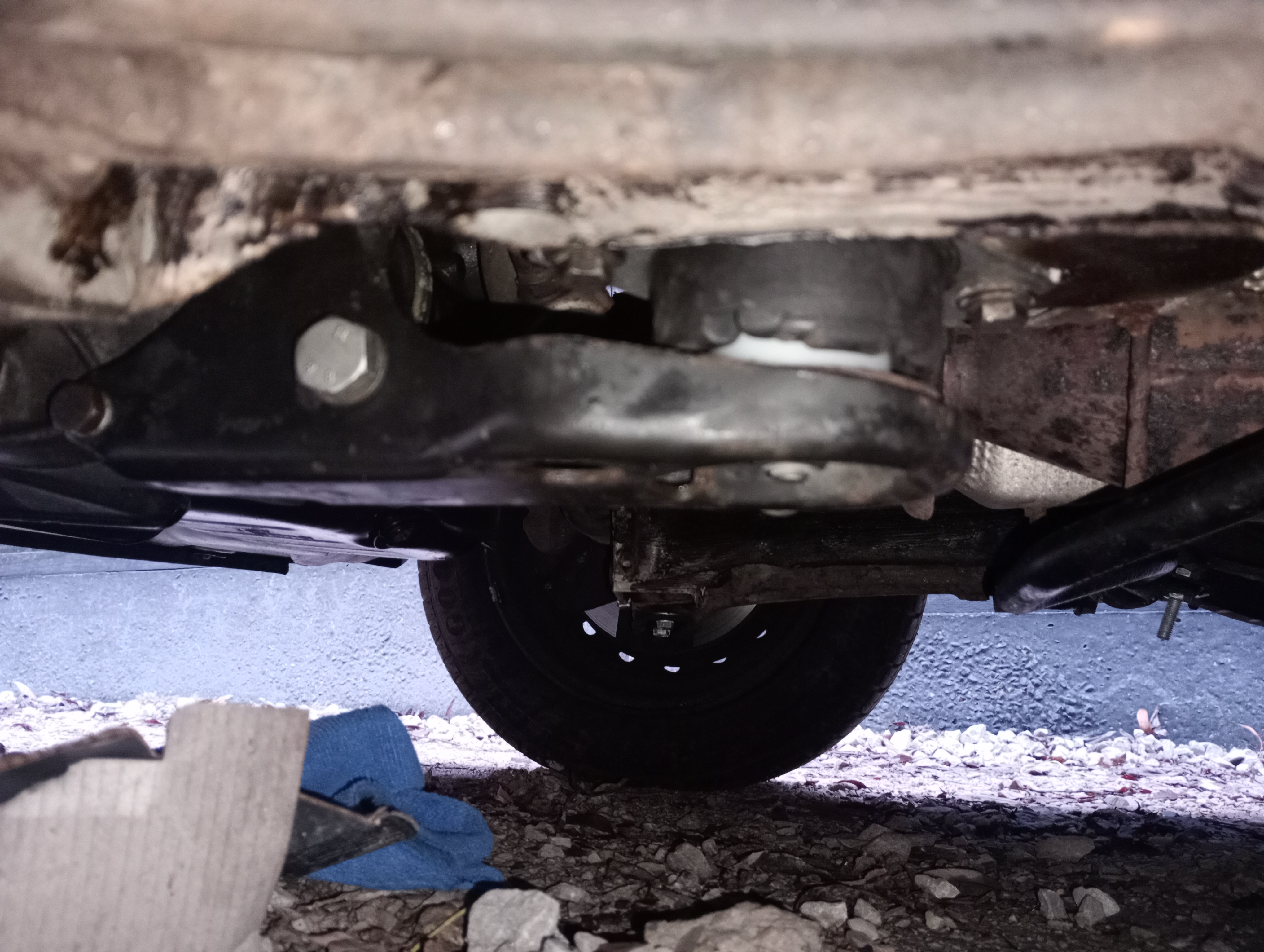

2 things come to mind with this one, it could be
1)
The clutch cable might just need adjusting, the plastic adjuster nut is on the end of the cable on top of the gearbox which on your brother's car being a later model should be a lot more accessible than on my 899 as my car has the air filter housing etc above the gearbox. With my car I usually have it adjusted so that the clutch pedal is level with the brake pedal, also whilst you're at it grease up the entire clutch mechanism with spray grease & repeat this every few weeks as it'll take the strain of the mech & also you'll have a lovely light pedal.
2)

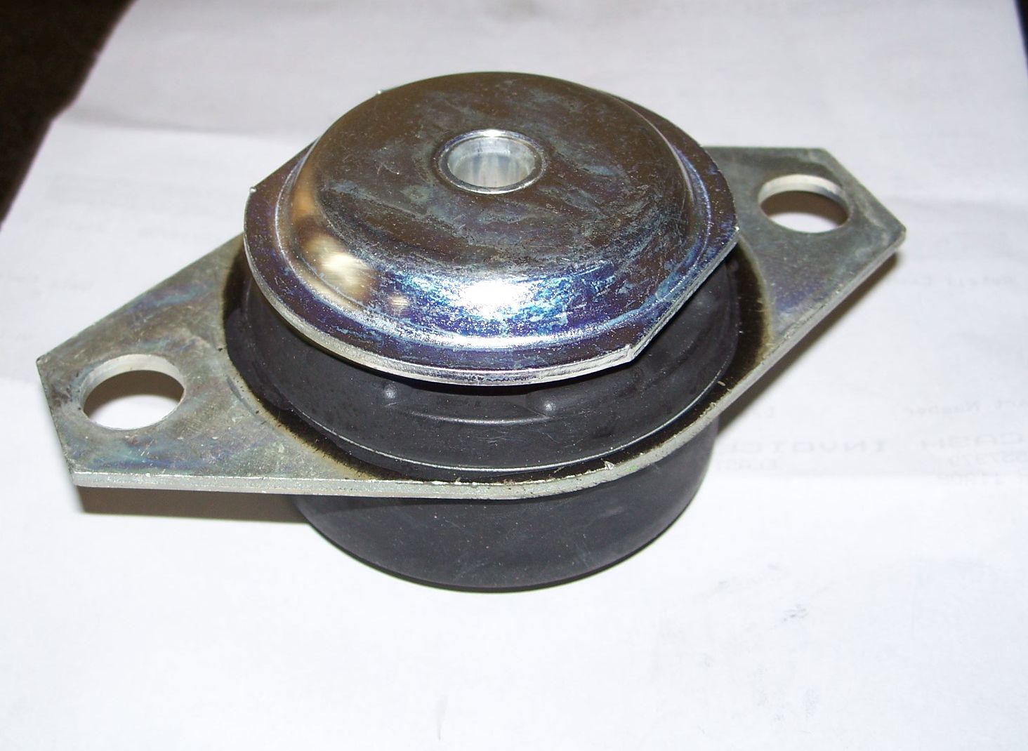

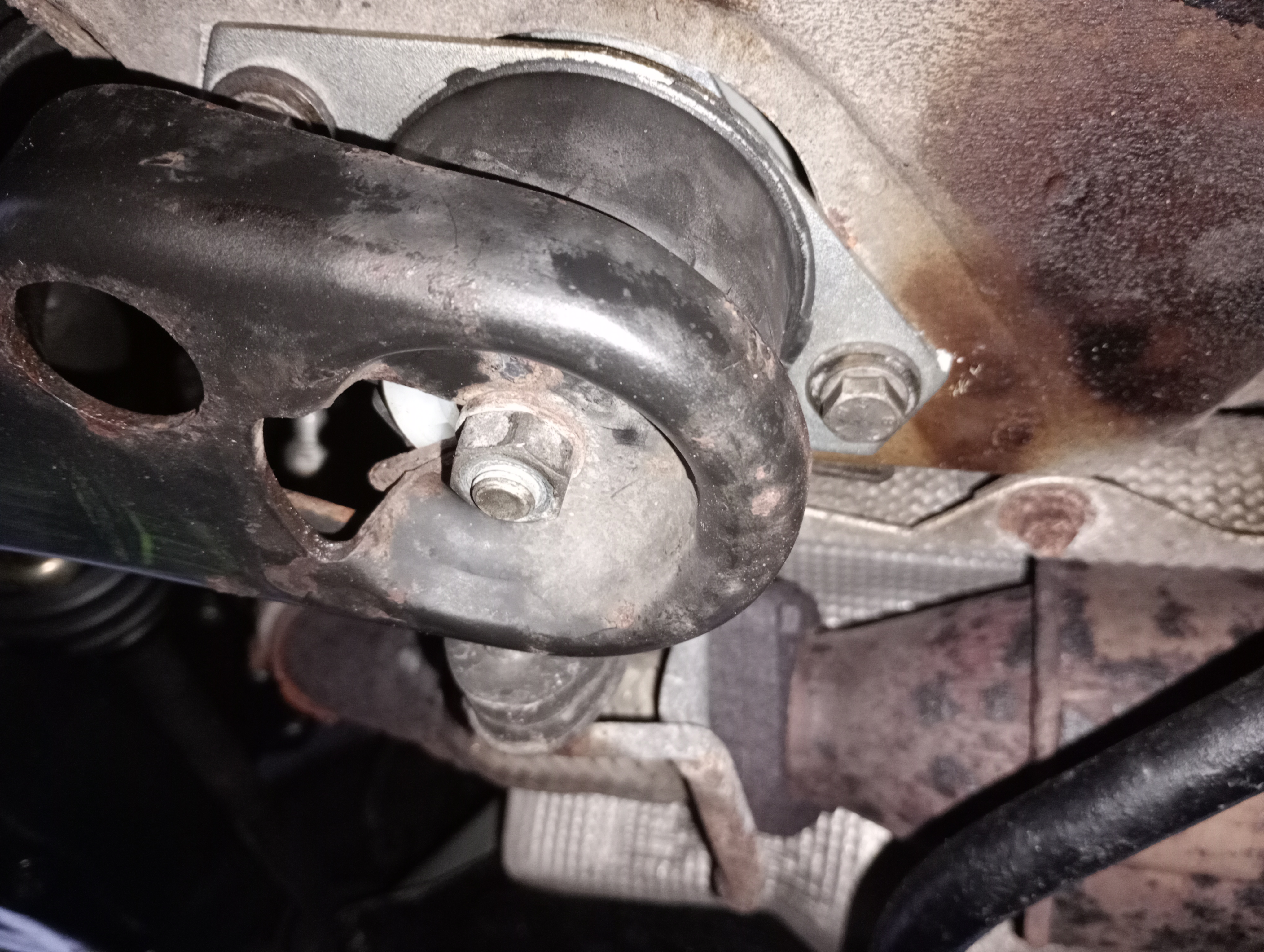

Other thing it could be is the rear gearbox mount, the other gearbox mount & engine mount are not known for going but the rear one is common for going on Cento's as when I first got my Seicento it would crunch between 1st & 2nd if you changed too fast for it's liking 😂 & reverse wouldn't always go in first time, when it's bad enough you'll feel slight movement & hear a very slight grinding like noise when pulling away, what happens is the rubber in the mount starts to deform & misshape whilst also cracking through the centre of the rubber which results in excessive movement & some difficulty in gear changing, I changed mine recently as it was that worn I could move it with my hand & it's completely transformed the car in terms of gear changing & the whole driveability, also it got rid of the slight excessive body roll I had. It's quite easy to do as well & only takes about 30 mins, there's 2 bolts where the mounts attaches to the body, I think 3 bolts where the bracket for the mount attaches to the gearbox & the whole lot drops out, then to release the mount from the bracket it's just a nut & bolt that goes through the centre of the mount, it's quite tight so an impact gun is your best friend for getting that one off.
This is the gearbox mount in question, when you install the mount to the car you have to make sure it goes in the right way up as people have been known to put the mount in upside down & have to do the job again a month later, the mount in the picture is the right way up so the metal plate is on top & is not visible once fitted to the car. The pics of my new mount below show what it should look like fitted to the car
