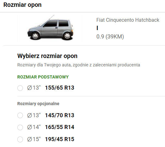

Oponeo says the standard size for the car is 155/65R13.
You could also use 145/70 on the same R13 rims.
Or swap to the R14 or even R15 rims.

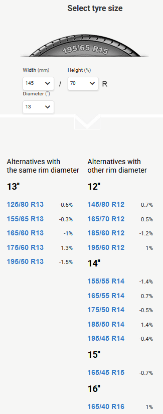

Those are all the equivalents of the 145/70 R13 which will have a similar circumference:
That does not mean you will be able to fit all of them on the car (because of width for example), but is a good starting point.
The oponeo site I checked it on gives a couple of explanations and hints, I think you should read it:
