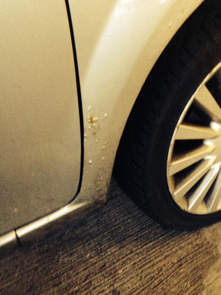

Okay so my car is starting to rust on both sides of the side panels of the car. What should I do? Just those cheap rust repair care kits? Or get someone to repair it. ImageUploadedByFIAT Forum1392749520.187644.jpg
How much would it be to get this repaired? I know you can get a new panel for like 40-70, how much would a respray for it be?
Okay so my car is starting to rust on both sides of the side panels of the car. What should I do? Just those cheap rust repair care kits? Or get someone to repair it. View attachment 131029
Fiat will look at that and say its stone damage, and tell you to go away.
LUIGI
How old is the car? Fiat have a 8 year corrosion warranty so this would cover it
Anti perforation, so there has to be a hole through the entire panel from one side to the other ;)
TBH that doesn't look normal. Have you owned the car from new? Looks like a very poor previous repair which is starting to come through the paint - perhaps a poor pattern part wing fitted (n)
I have only had the car for around 5months. What should I do? :( how much would it cost to repair too? At the moment, they are bubbles atm. And if you pop them, it's just rust underneath
Personally if mine, I'd replace both wings with Genuine OEM Fiat parts and have them painted, once rust is in a panel, and the way its coming through on that one, replacement is the only easy option. :(
Oh :( any idea on the cost for it to be painted?
Decent job with surrounding panels blended in, anywhere from £200-£500 depending upon the place and quality of work. Body shop might be able to get away without blending, but they're best to advise.
It won't be cheap though.
Ive never seen a GP rusting there before... most of that area is open space behind too so doubt its damp going through from the back.. From the pic i could be wrong due to the clarity but looks like the gap between the sill and the wing is on the pee.. so could be a "new" wing... after market parts are often not galvanised like OEM parts
