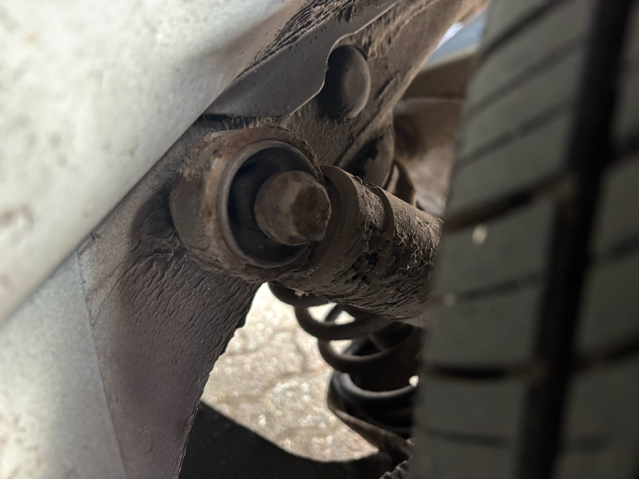

Hi koaler wheel bearings good fuel pump good exhaust all tried and tested brakes spot on tyres almost new worn bushes not sure yet like I said Upper tailgate does rattle when slammed shut yes it's affected by bumps everything else is ok
Hi koaler think you have maybe solved it nearside upper suspension bush looks like it's worn away making it not central
Unfortunately the photo is inconclusive it's hard to get the angle and light right
It's a pretty common failure point

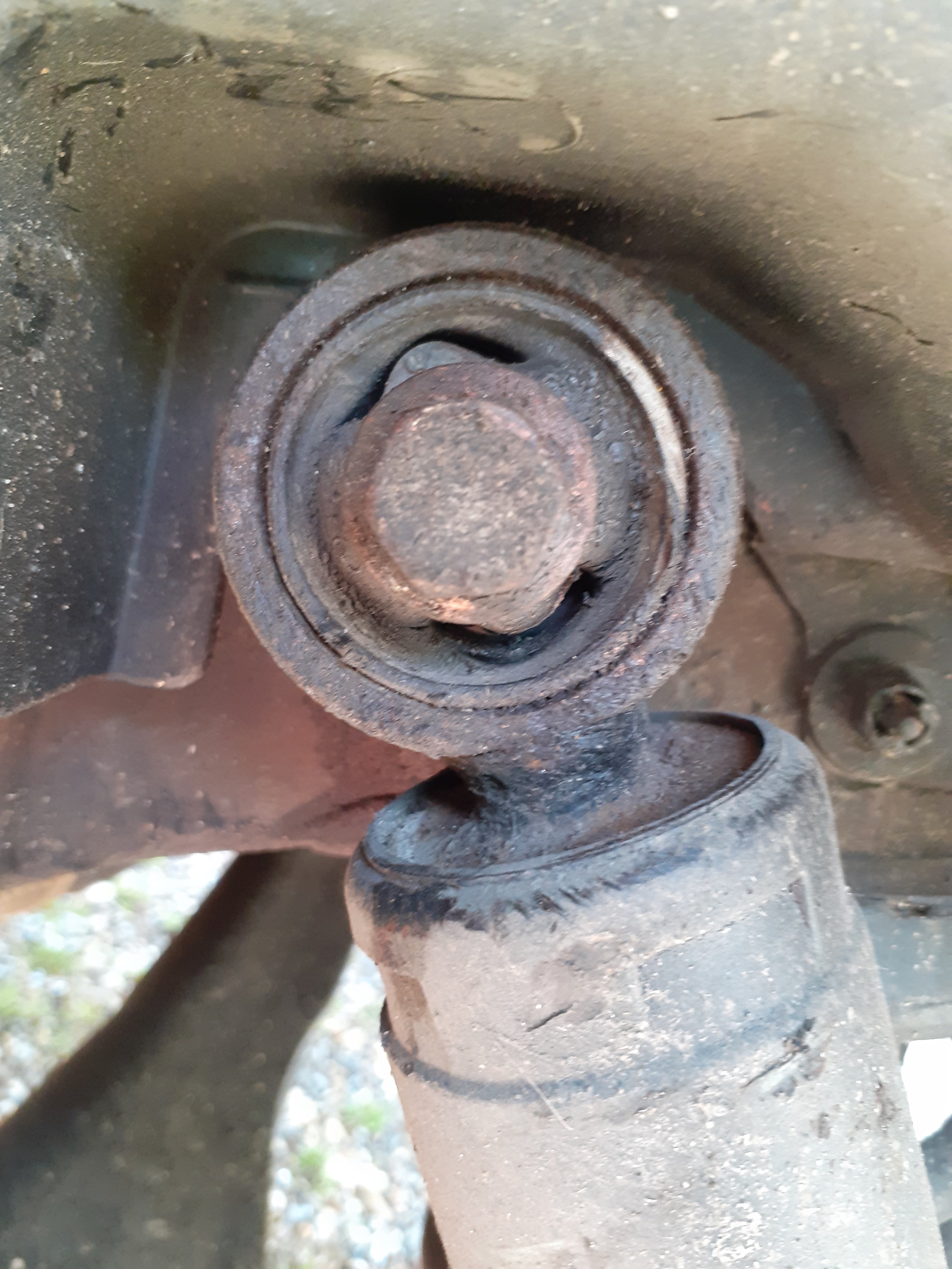

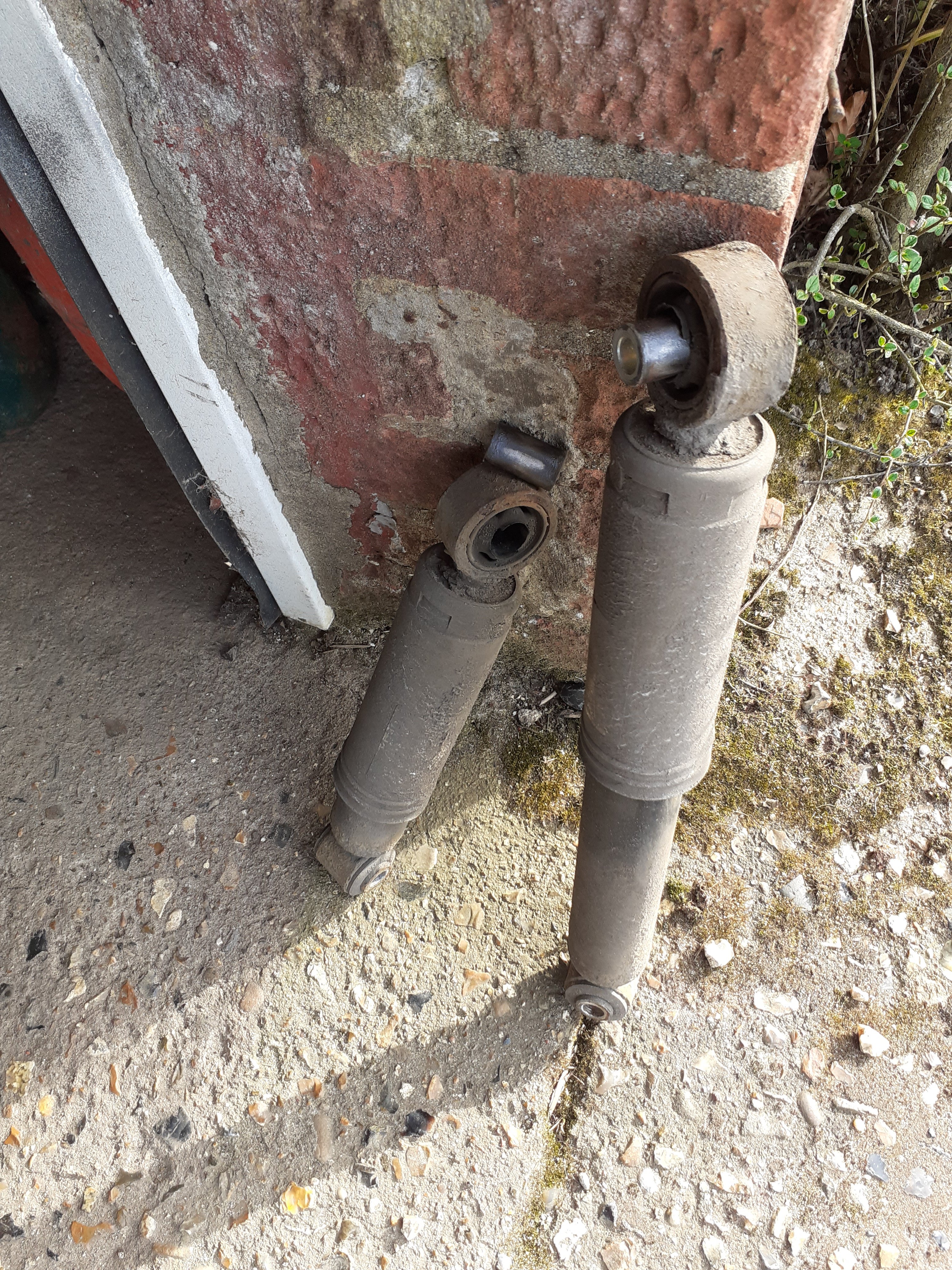

Top bushes clearly toast. Itdoes cause exactly what you describe. Rumbling, and cant be seen untill you takw out the top bolt. I did oneof ours two weeks ago. Monroe dampers not cheapest but are one of the best. Igot from damperplace on ebay. There was a little discount for the asking. Worth every penny.View attachment 466071

Top bushes clearly toast. Itdoes cause exactly what you describe. Rumbling, and cant be seen untill you takw out the top bolt. I did oneof ours two weeks ago. Monroe dampers not cheapest but are one of the best. Igot from damperplace on ebay. There was a little discount for the asking. Worth every penny.View attachment 466071View attachment 466072View attachment 466075n⁷View attachment 466076
