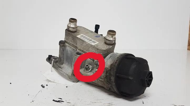

General Removing the oil filter?

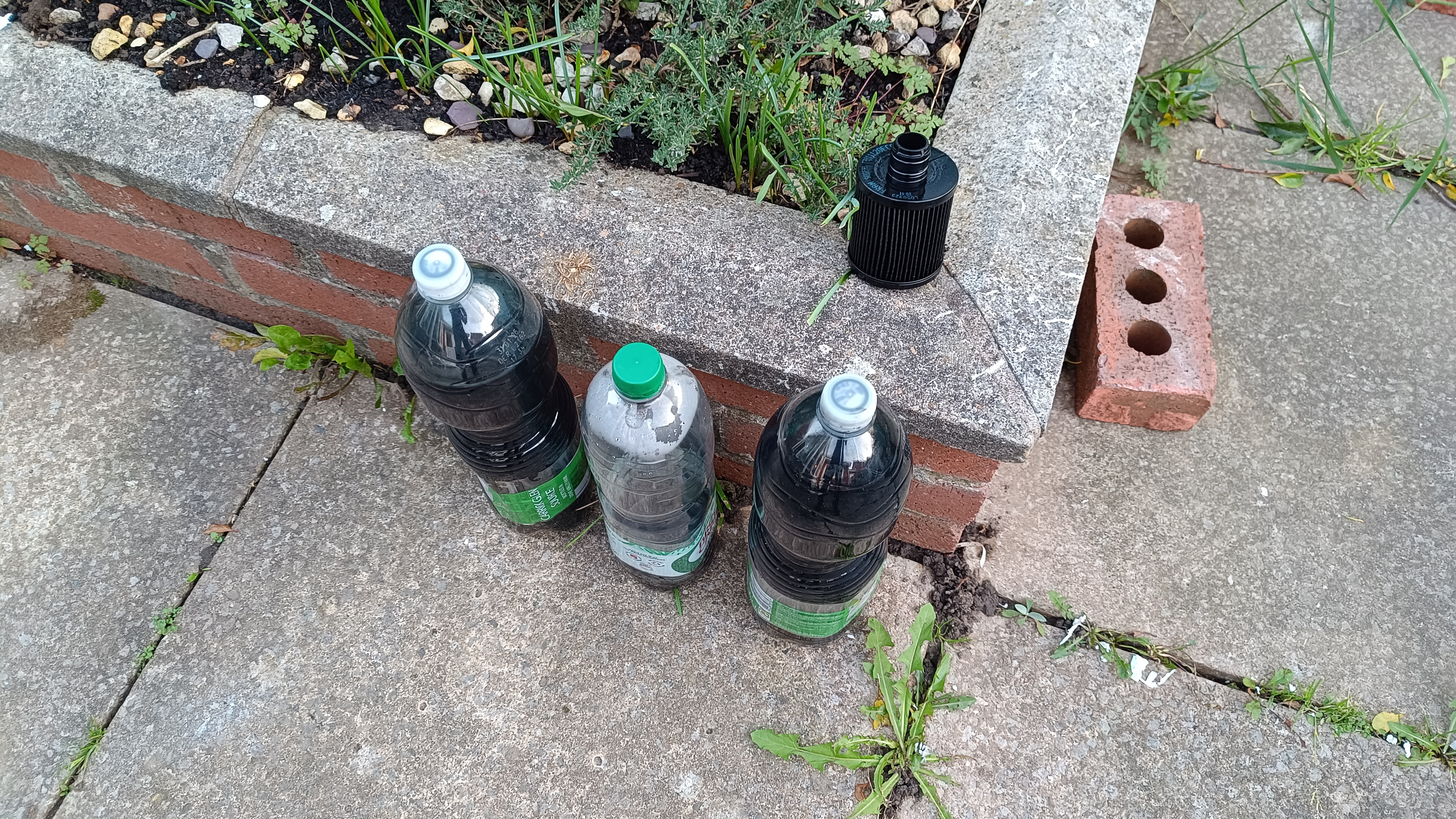

I've bought a pump to get the oil out the dipstick.

I have the oil pump, i checked that the inlet pipe fits into the sump through the dipstick. The oil filter is only on hand tight now and can be loosened easily.
The car gave me one last scare, i couldn't get the oil filler cap off by hand! Which probably shouldn't have surprised me, but its loose now.
The oil doesn't arrive until Monday, is there much danger in draining it tomorrow, or should I wait until I have the oil?
