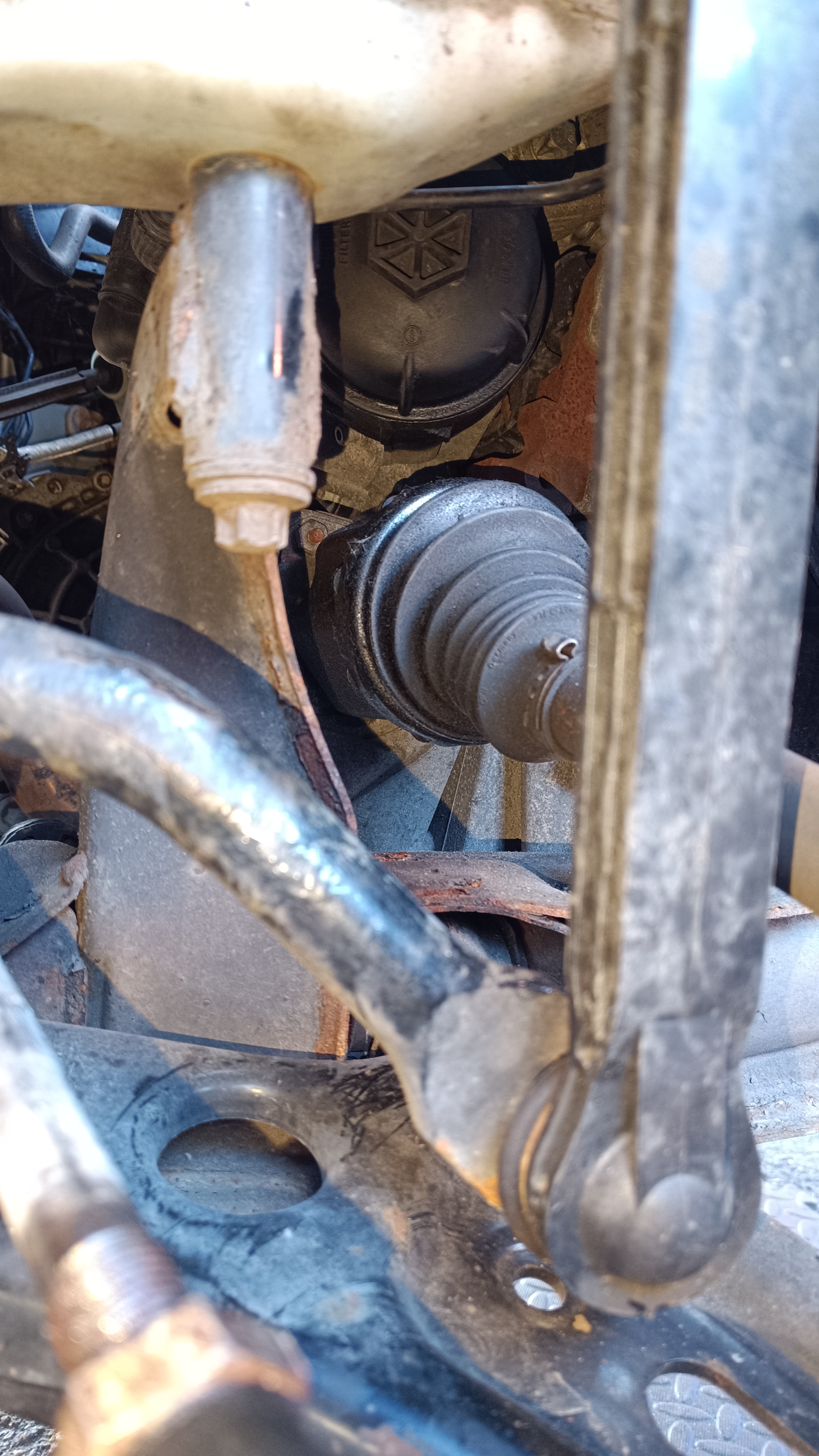

I need to remove my oil filter but its in a really awkward position. Its got a 36mm hex on it but my socket is too deep to get onto it. How am i supposed to shift that? Any special tools?
Its the black plastic placed above the driveshaft.

If you are lucky, a slim comination spanner tht size, or I sometimes use a Facom steel strap wrench that is quite effective.
Alternatively it may be possible to support the engine carefully using a rubber pad on a jack, then slacken the engine mounting so the the engine lowers down enough to allow your socket to get on through the wheel arch.
A small point when they are very tight the plastic nut tends to round off.
Motor factors can supply replacements , but there are several different types and filter designs I have found.
Finally when you succeed and are fitting the new filter and O ring to the cap, oil it well so the oil ring is less likely to stick next time and only do it up gently to recommended torque.:)

I'll give all of those a go, my fabric strap might work and probably won't damage the plastic if it doesn't want to move, a big spanner (will need to buy one) and lowering the engine would work too, but that'll be a last resort.
I didn't try my fabric strap wrench because i got a bit hung up on the Official Fiat Elearn page that said i should use a 36mm socket, of course you're a lot smarter than that elearn website lol
I'm having a go at this tomorrow. On Fiat elearn it said I needed a 36 mm socket, so I bought one that didn't fit...and had to wait for a 32mm that does fit. So I'm on my third socket now. I imagine it'll round off, next I'll try my fabric strap...mmm... maybe this isn't the original cover, so I may be buying another. Isn't it supposed to be metal anyway, why is mine plastic? I don't want to delay this any longer but I'll see where I can buy a new cover now.
The sump plug is probably rounding off tomorrow as well. I need to get it up on ramps and get a big bar on it. Fingers crossed time.

That Facom tool is a steel band rather than a chain and it is adjustable by turning the nut on the end, it also has a ratchet function.
To be honest I was well impressed with it.
What I often do with very tight filters is use the correct socket or spanner, but also the Facom tool so it spreads the load.
