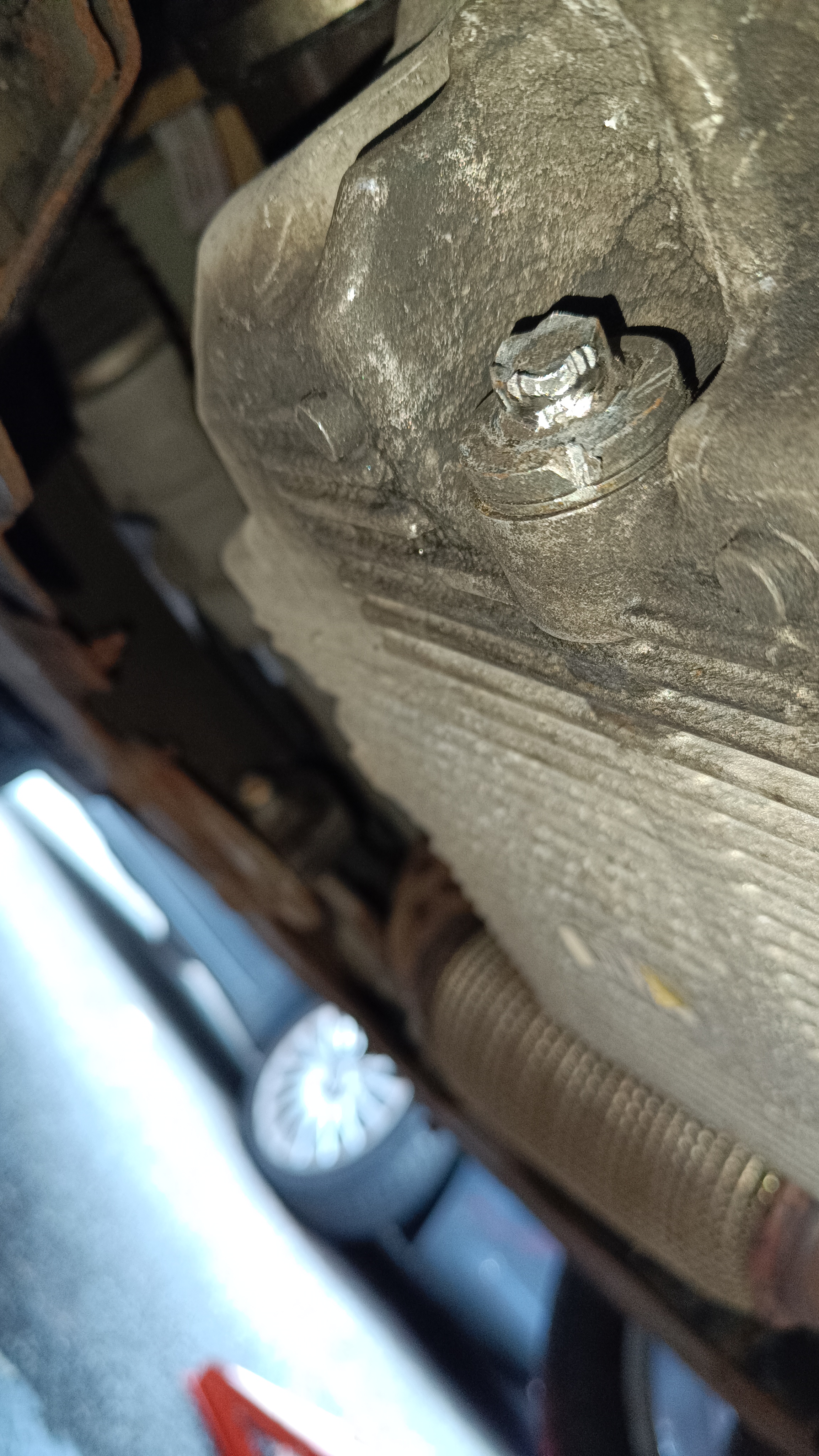

OK, all i have now is a big groove on the sump plug washer, and no movement, so i give up. The metal on the sump plug is too soft, and the plug rammed on too hard.

This is where i got up to after my last post - I've just taken some pictures while i try to get my head around the technique to use. The groove i've previously dug is at 4.30pm by the clock. I've had a go at the washer already.

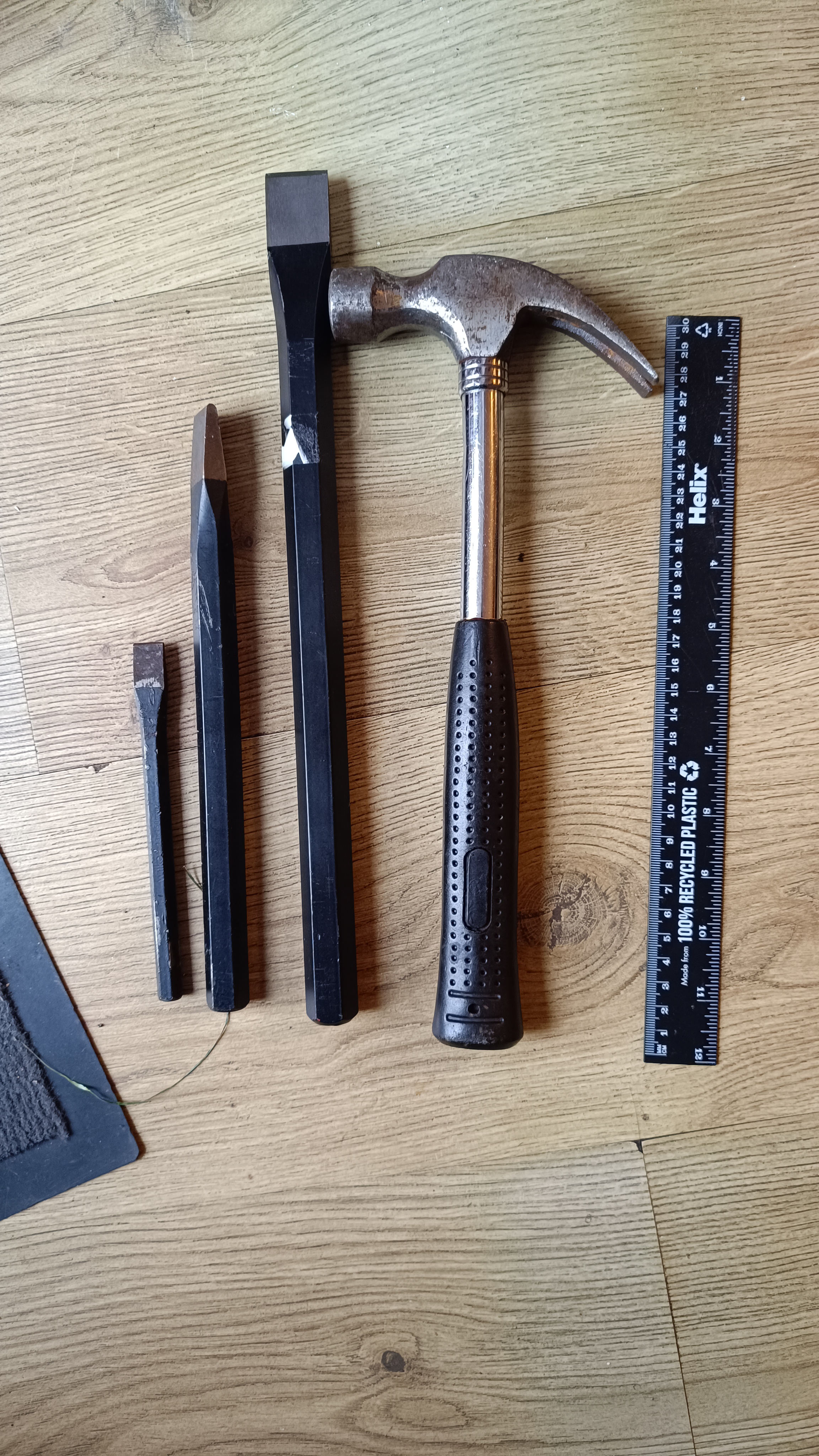

These are the cold chisels i have. I used them all, i think the middle one was best and happily i previously grinded the end flattish, the other two are still sharp.

The 4:30 is fine, it is just at right angles to the plug the main thing is to make a groove so when you angle the chisel to turn the plug it doesnt slip out of the groove.
Looking at the metal, it is very soft, so a fairly blunt chisel to tap it around will be best once you have the groove.
Possibly try a bit of hot air gun around that area of the sump so it expands the metal, not on the plug it's self though
Your hammer may be OK for carpentry but is not a heavy engineers hammer, when ever I have used that type in earnest the heads fly off.:)
I'll give it one last go with my metal mallet ;) I'm not hopeful though. Imagine putting your whole body into a 750mm breaker bar to release the wheel nuts, thats what the last guy did to the sump plug... :)

Also to add to @bugsymike mikes comments above it is not just about the physical size of the hammer but the mass and the bounce as well. You can swing a really big hammer and hit something but if that energy is bounced back into the hammer and subsequently into your hand and arm, not only is not not doing a very good job but can result in injury so sometimes you want a nice lead hammer which will deform slightly with each blow but keeps the energy going into the piece as well as being smaller than a steel/iron hammer for the same weight. and is not going to potentially cause you an injury.
Then you can get dead blow hammers, filled with some medium like sand or lead shot which will hit the piece and then a split second later the internal mass carries more energy into the piece. As the name would imply they are "dead blow" so they do not bounce as a result.
Right hammer for the right job.
What you have in the picture you posted is probably ok for hammering in a small picture hook but not a lot else. Better in the kitchen draw than a tool box or garage.
At your suggestion for my second go at this I used the hammer below, it is around twice as heavy as the one I pictured before, its the heaviest I have, but i imagine there are some that have bigger. I wouldn't say on the ramps I have room for a longer hammer.

I got a cold chisel and hammer on the sump plug, but only suceeded in digging a groove into it, no movement. Any other ideas?
On the plus side i did get the oil filter cover to move, so that'll come off when i need it to. Is there any value in getting the filter changed before the sump plug is off?
Once you have a notch from cold chisel a blunt cold chisel can then be used on notch to knock plug anti clock wise.
Angle the chisel so you are partly turning the sump plug rather than chirping directly at centre of head of plug.
