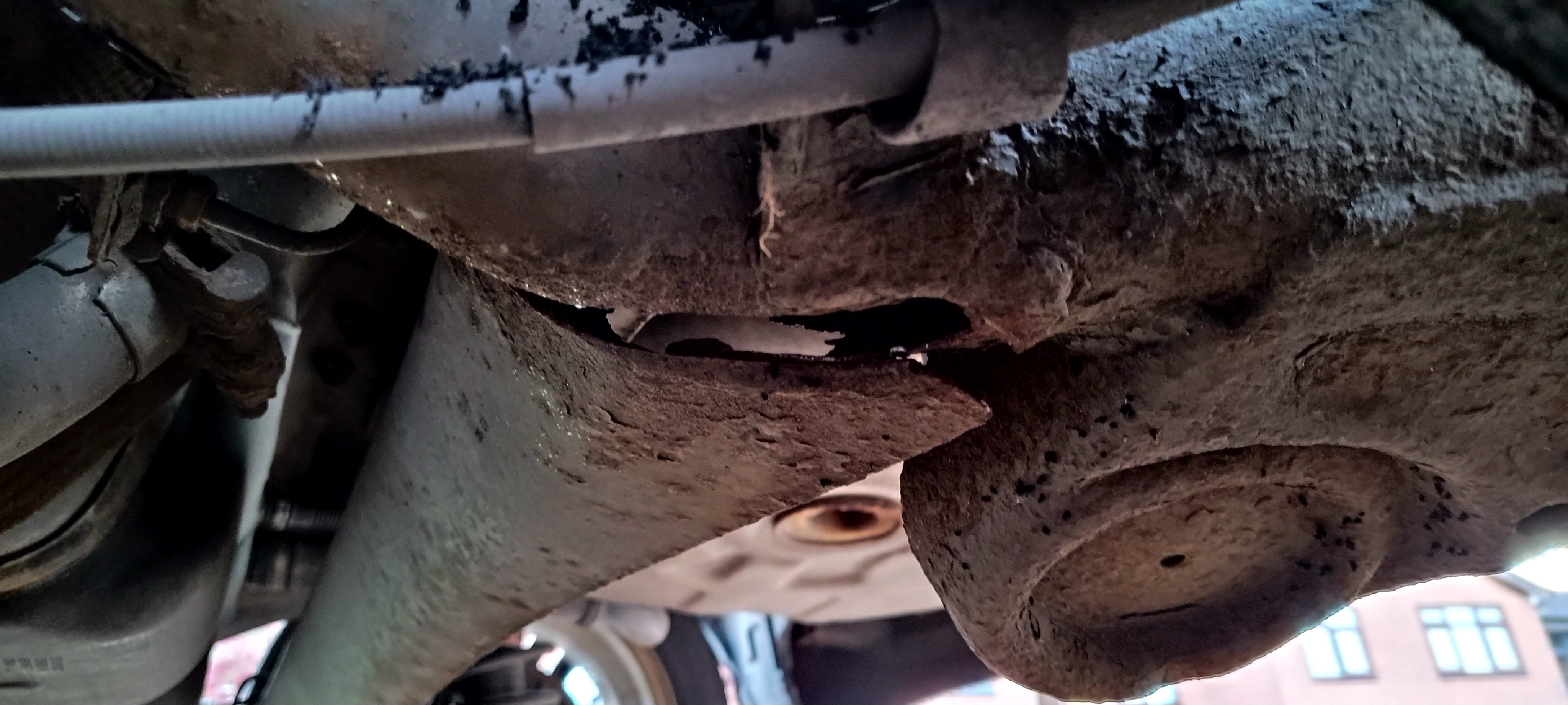

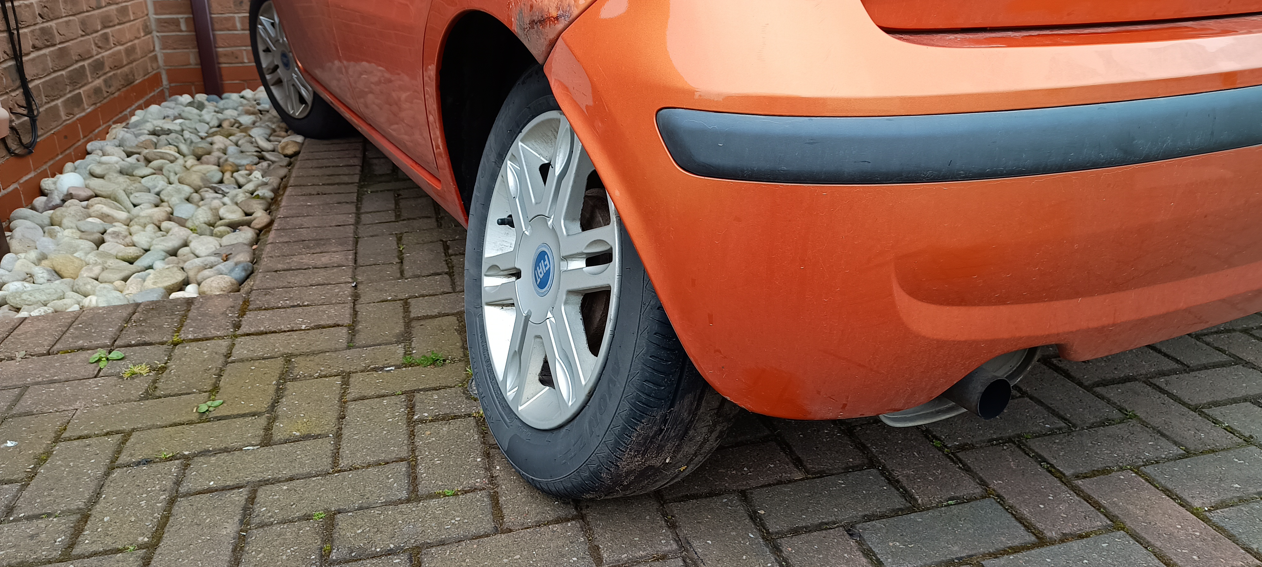

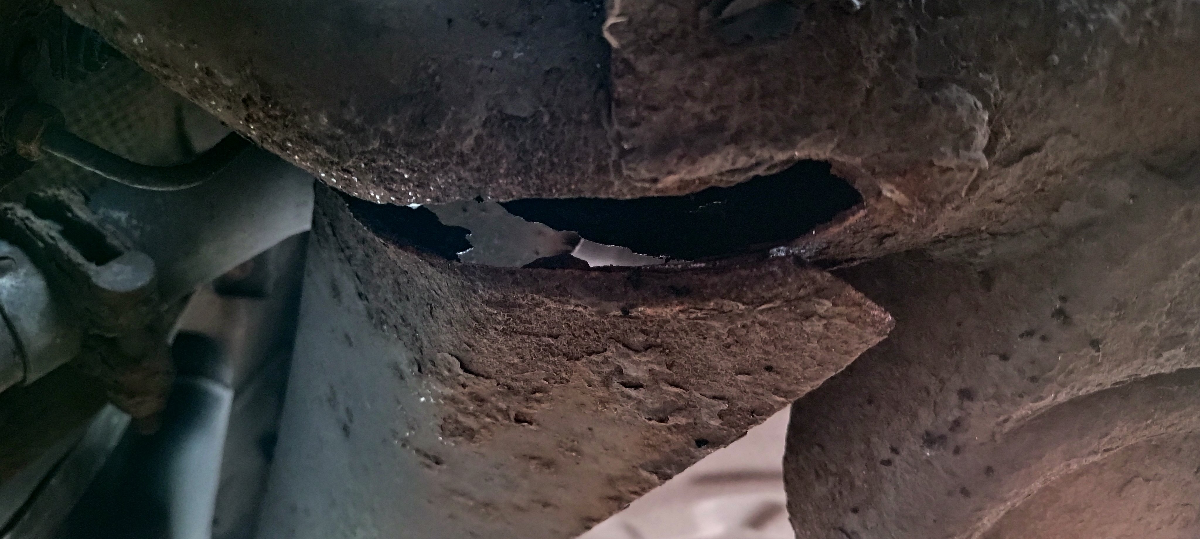

My beloved MJ panda went for the tucked look on the way to work on Monday. Heard a rather loud bang when exiting a roundabout having not hit anything… then a massive trail of black smoke started following me…
Think I’ll be selling as spares or repairs as it’s not a job for me this time.

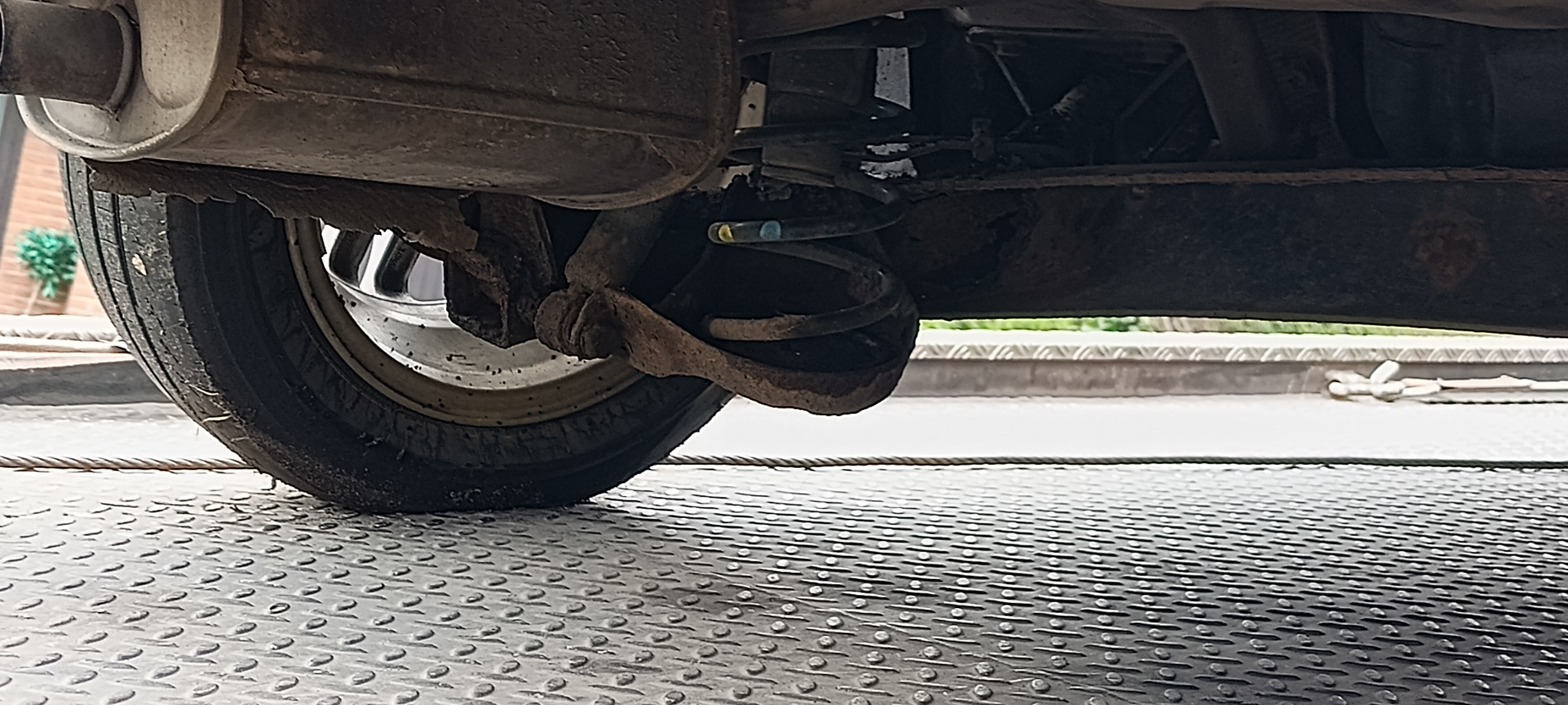

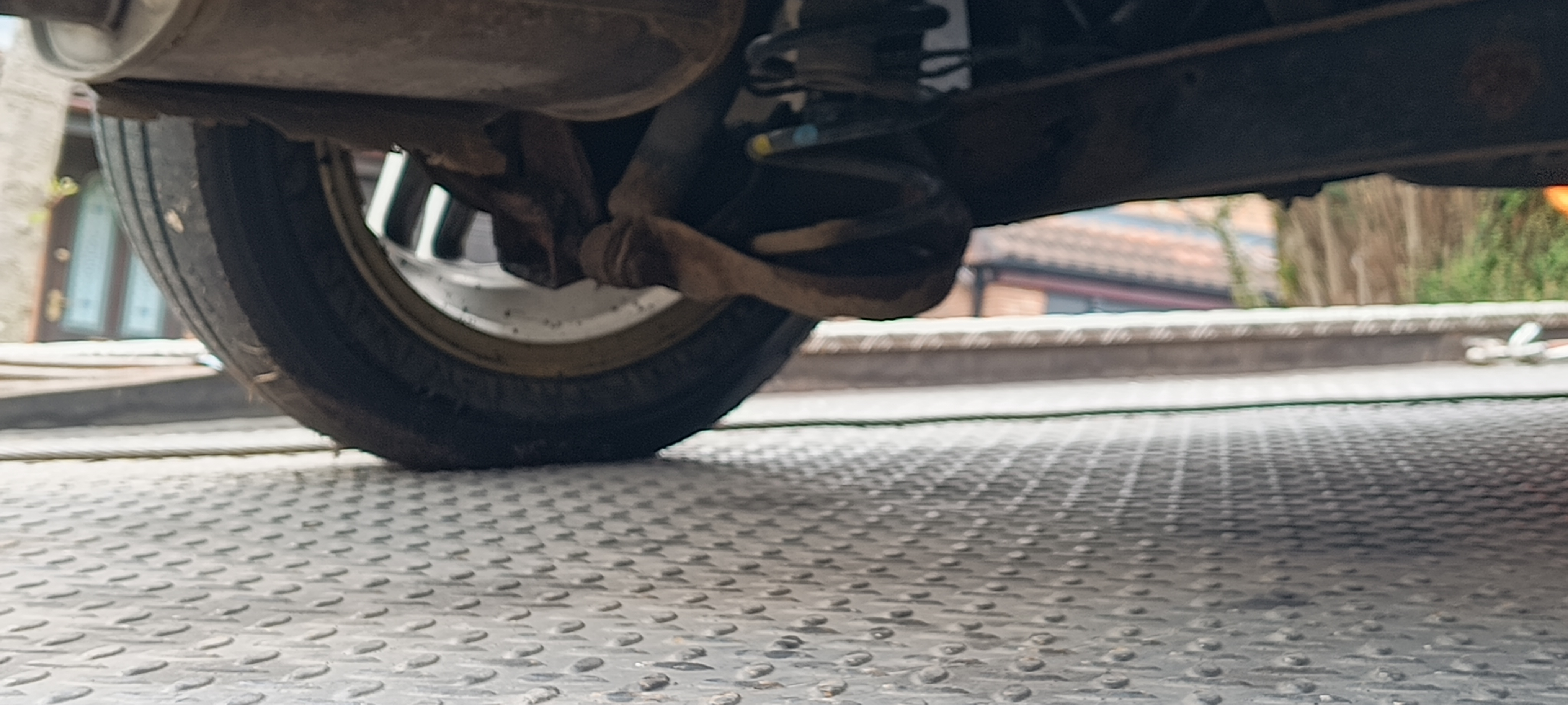

Back home after a ride on a recovery truck...

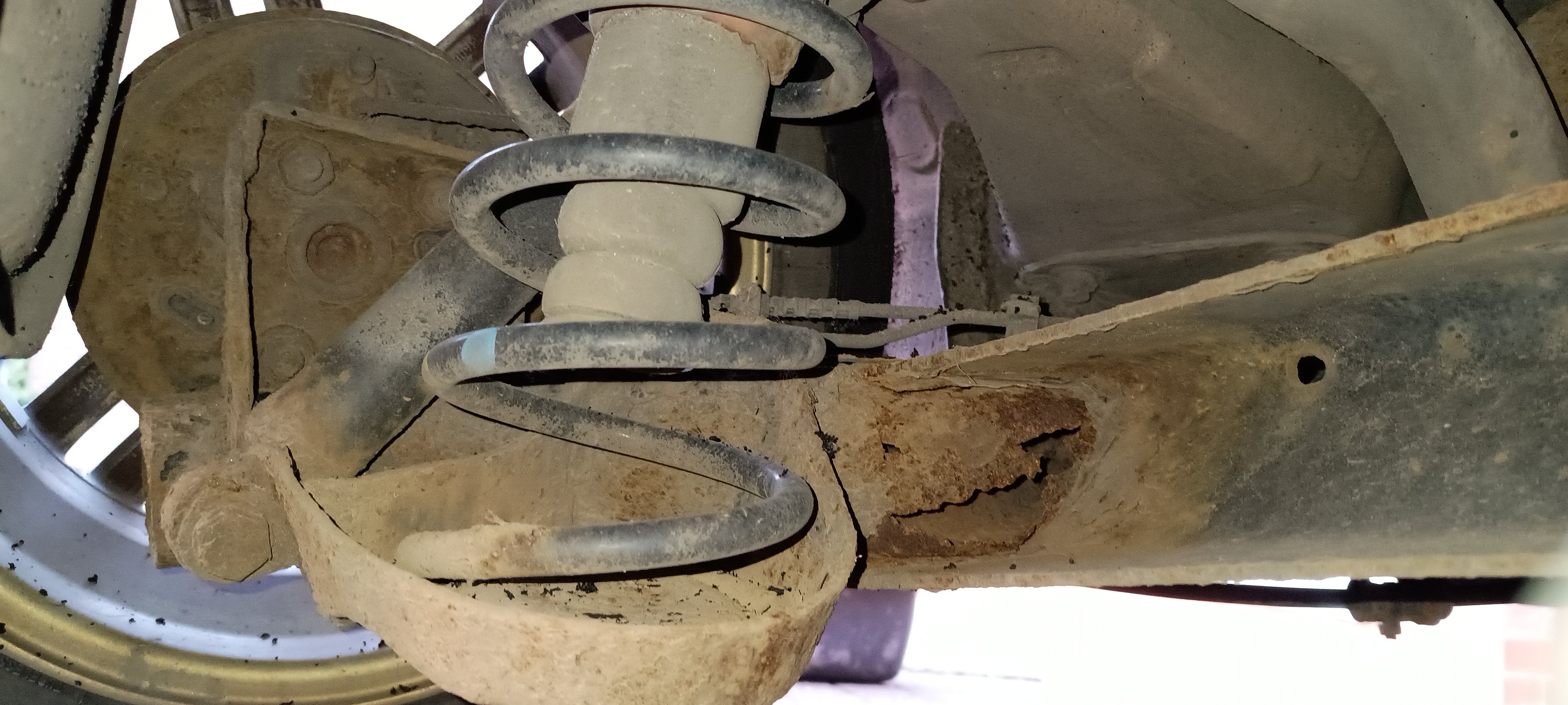

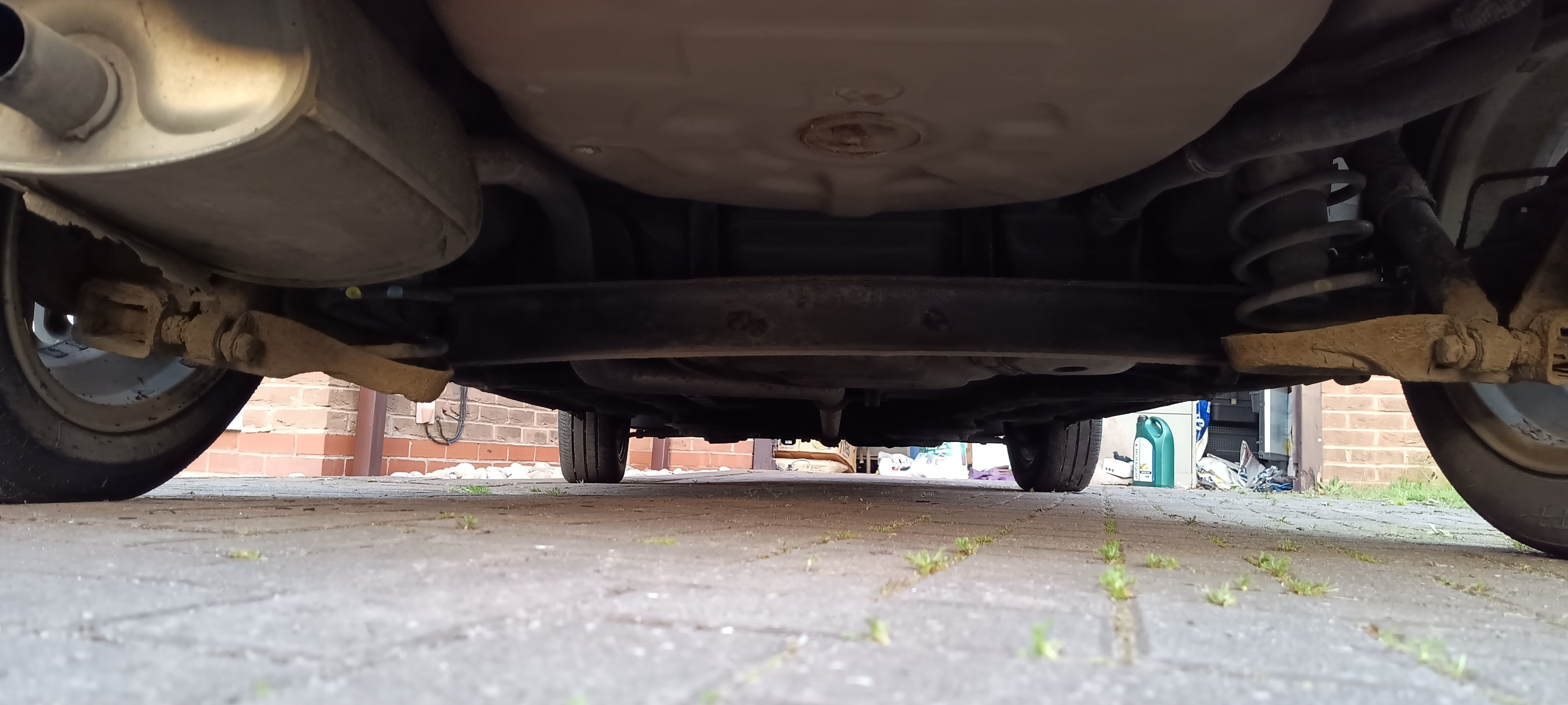

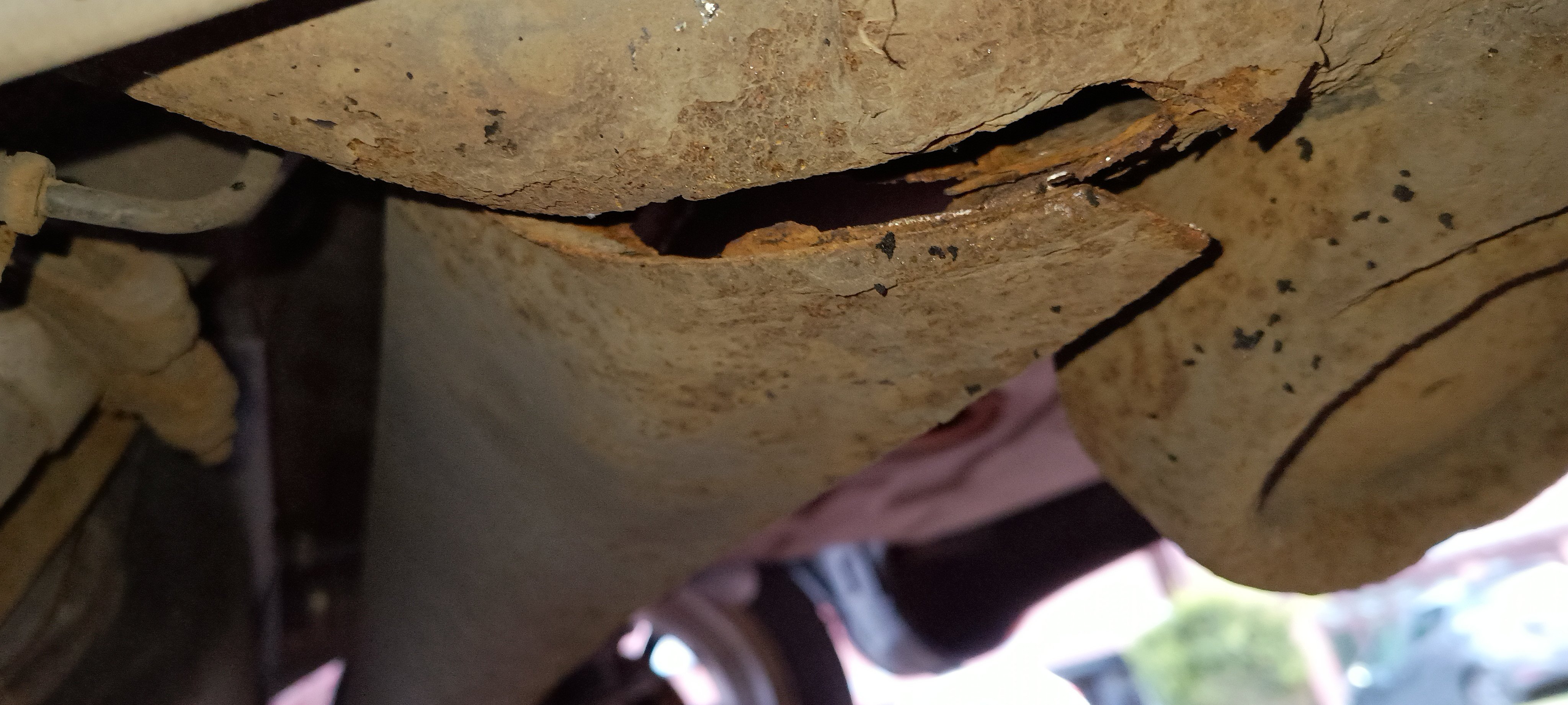

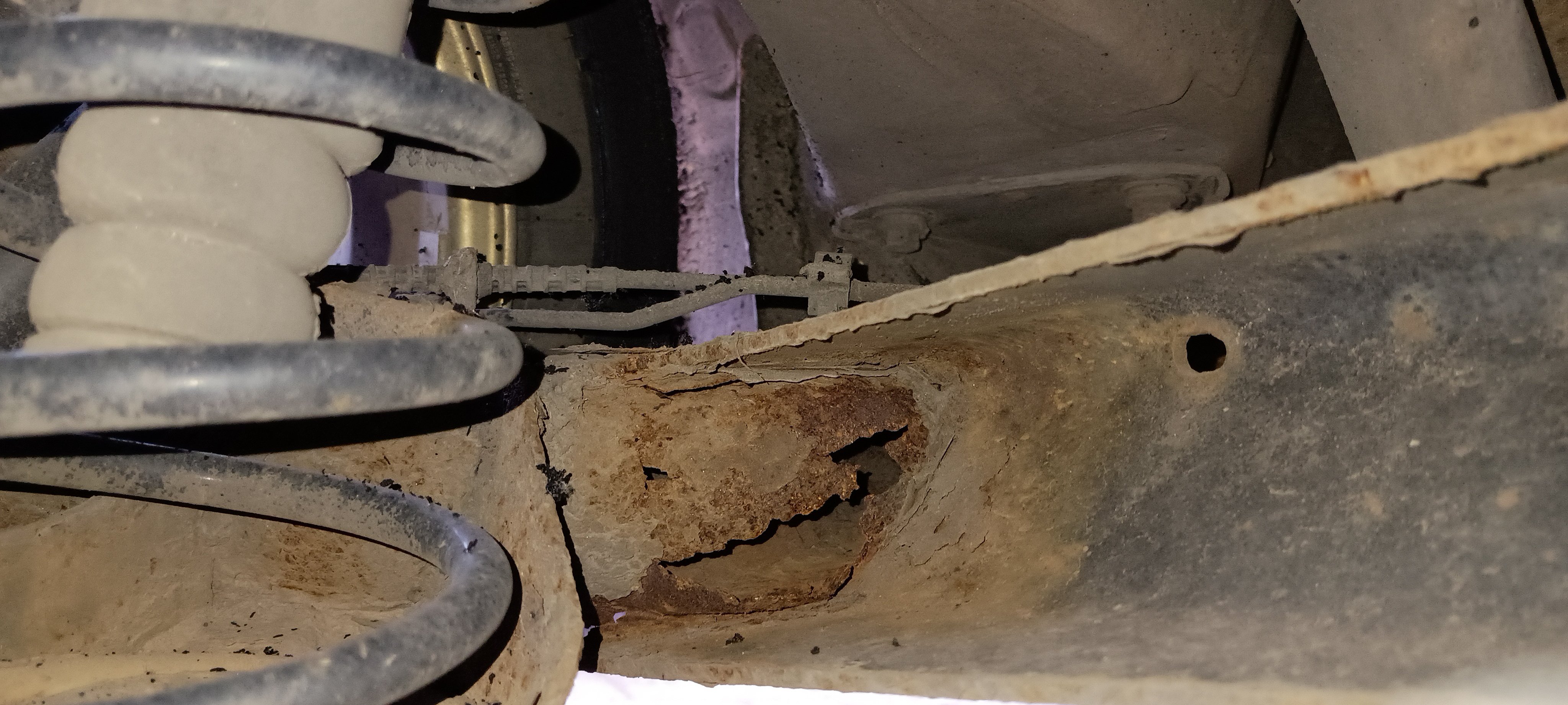

It only needs a new rear beam, and perhaps a tyre, not too difficult, although the rear hub mounting bolts can fight well.
If you are unable to do it yourself, or afford the cost at a garage, it will make a cheap project for someone. Perhaps advertise it on this forum, someone nearby might appreciate it.

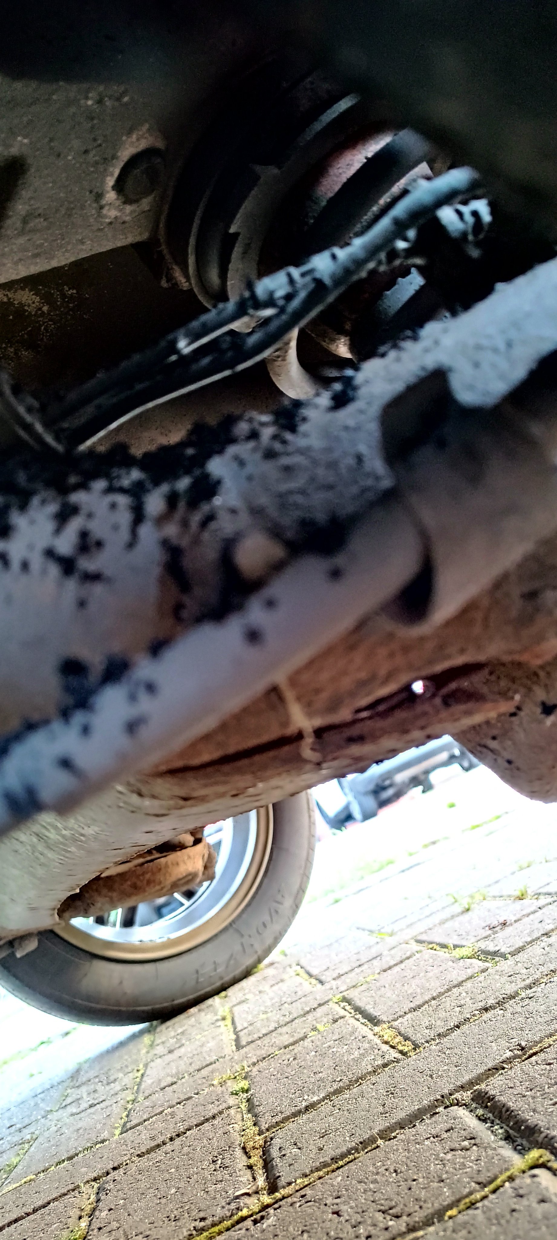

Will need a rear beam, 1 tyre (other 3 are decent Avons) EGR needs freeing off as it chucks up an error code now ang again.

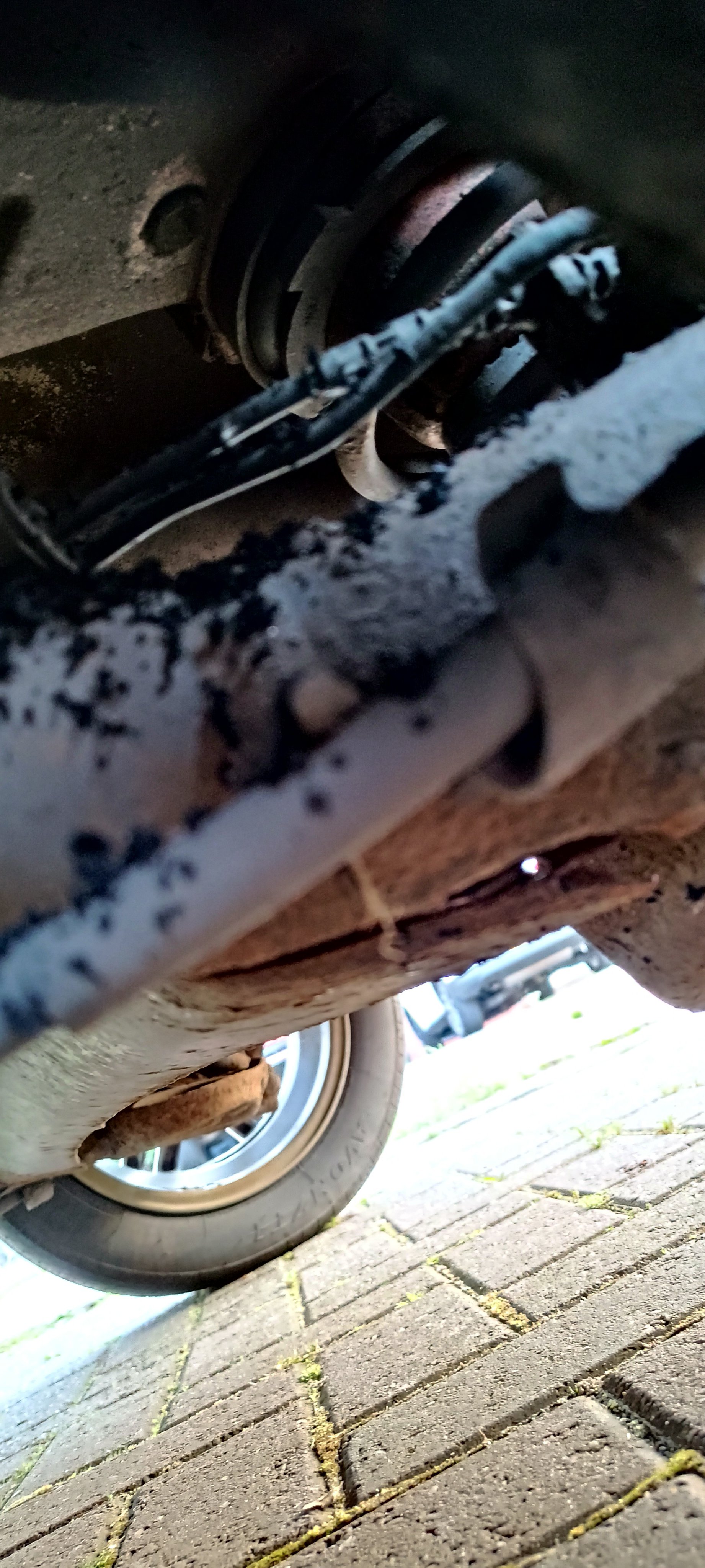

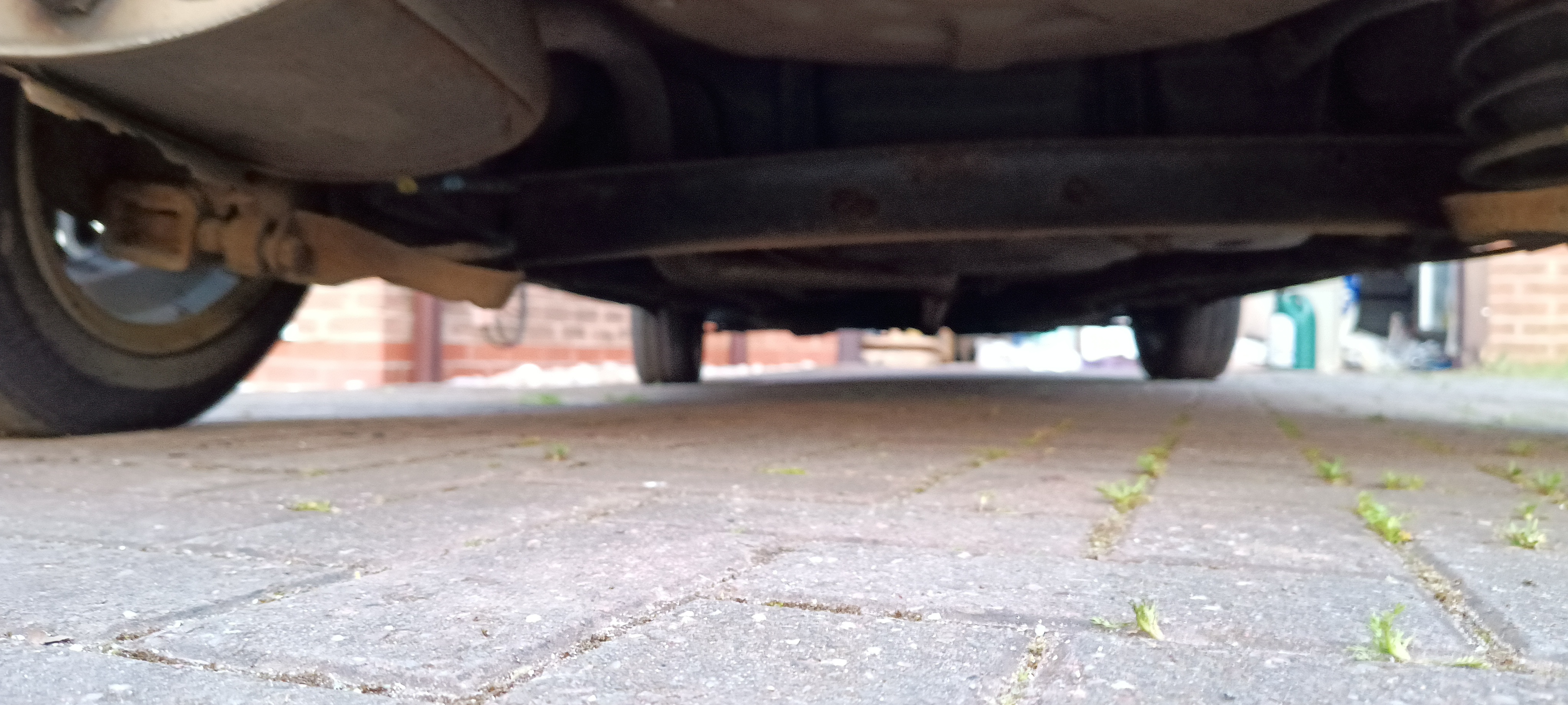

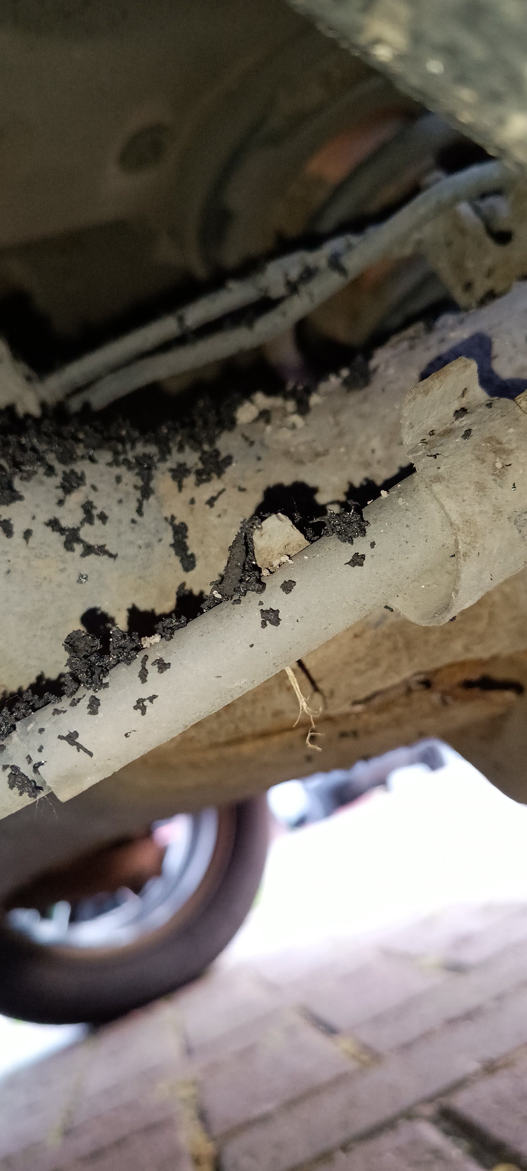

Not the best pics but spring cup looks out of place. Think the rusted bit is forward of that. Will try and get better pics later.
I won't be fixing this panda. Already have a panda twinair which I'm trying to get used to but struggling with the comfort level. The seats are naff

Sorry about your problems. New axles are available for c. £150 so it might be worth repairing. Certainly worth something to someone with spanner.

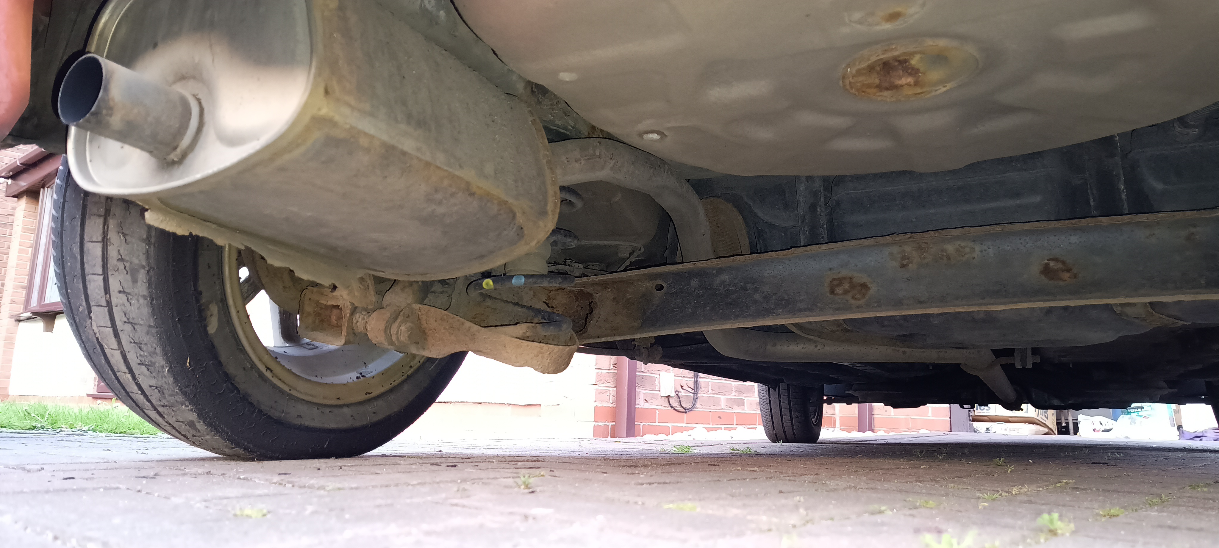

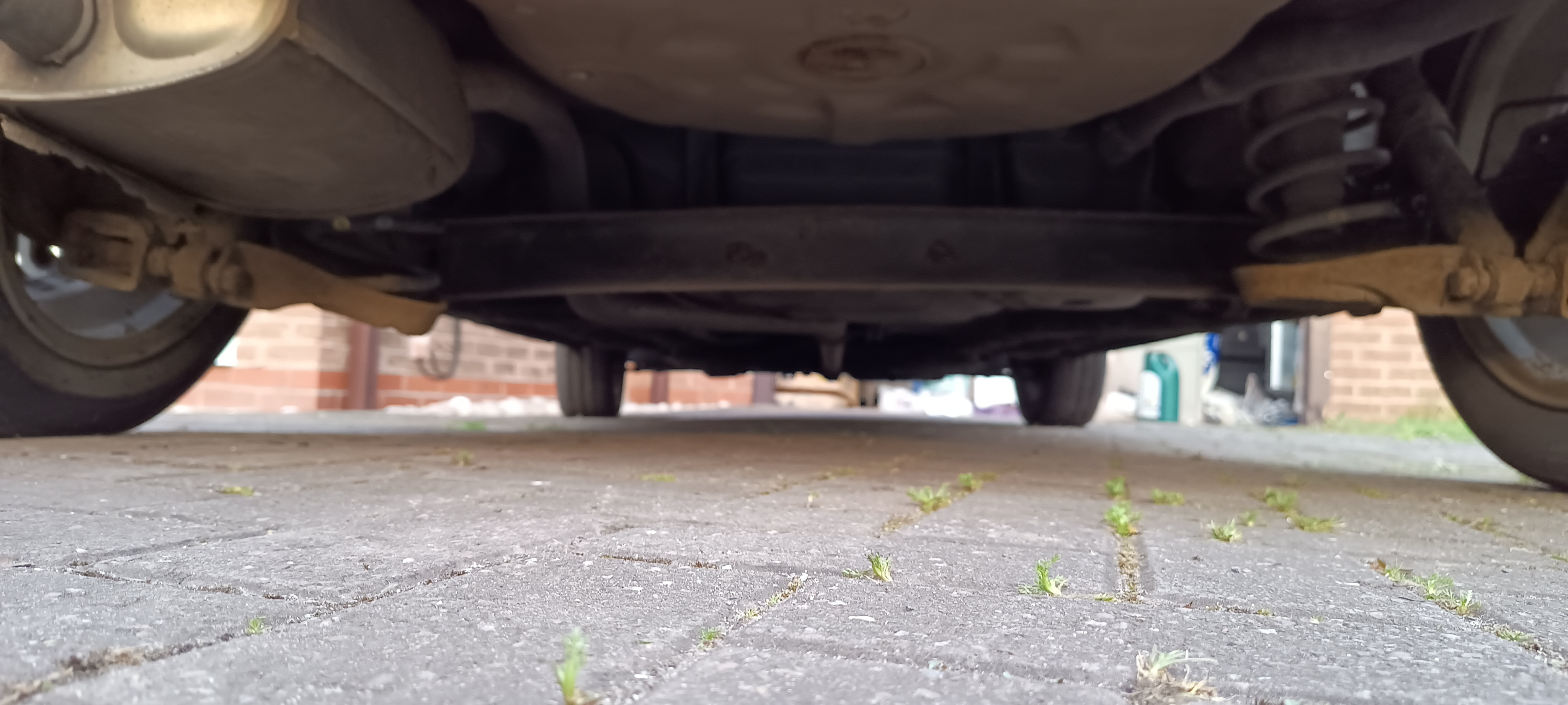

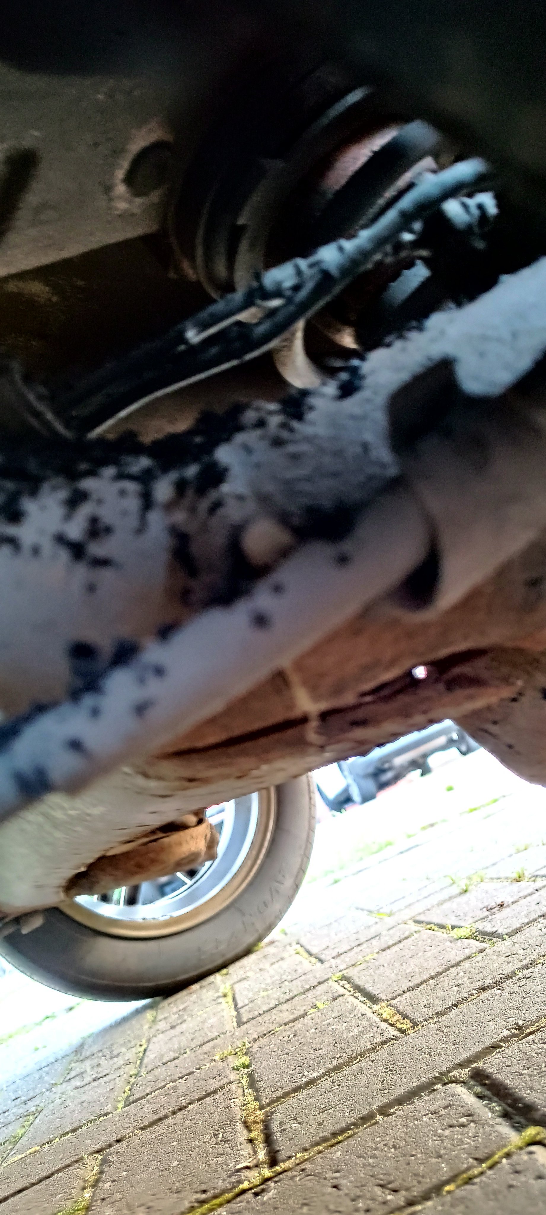

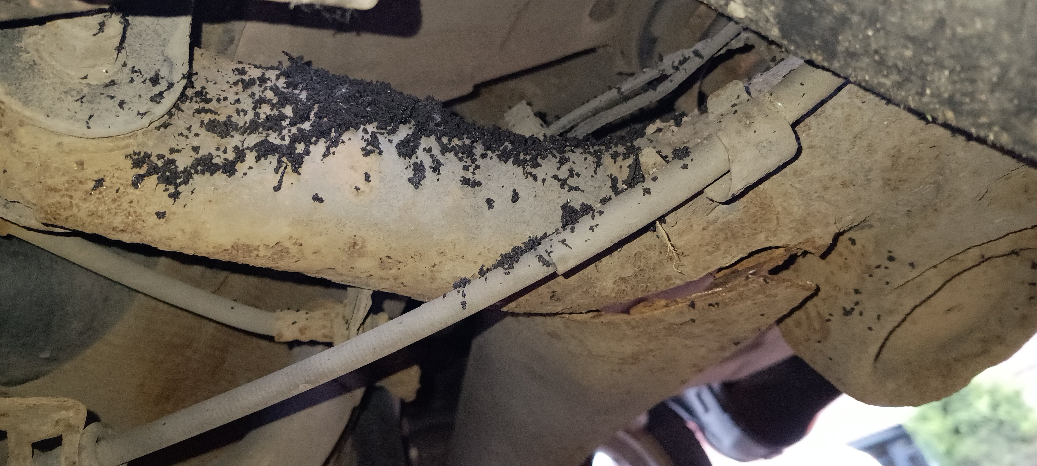

Some snaps...

I fully agree with every comment about everyone's personal likes and circumstances. However, the rear axle job, while it looks big, is actually not a hard one. Obviously you'll need tools (and time), making it impossible for someone who never does such things or simply cannot devote the time.
