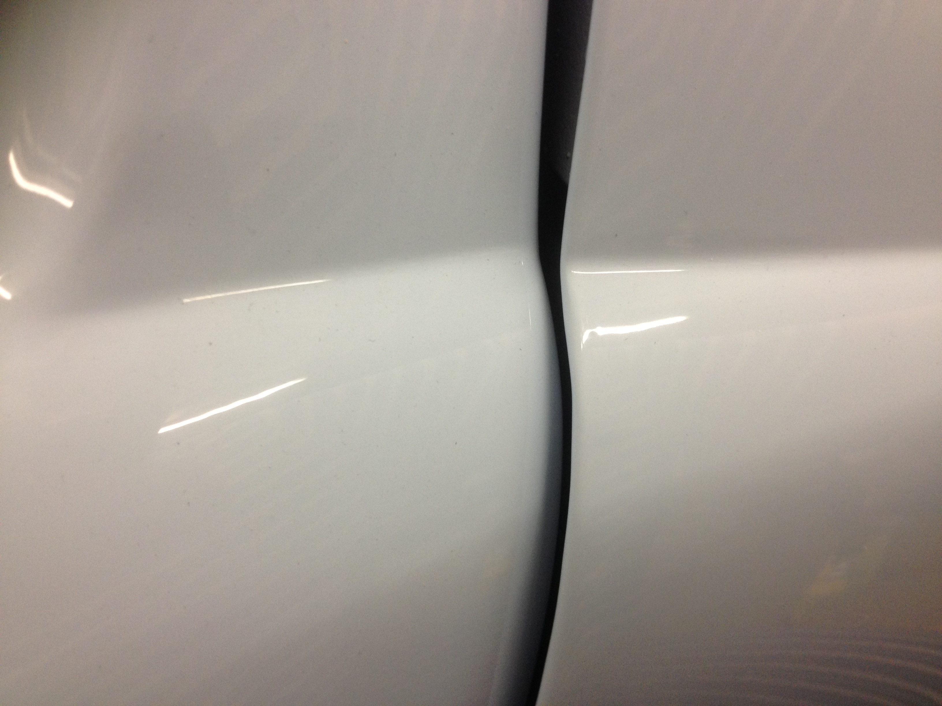

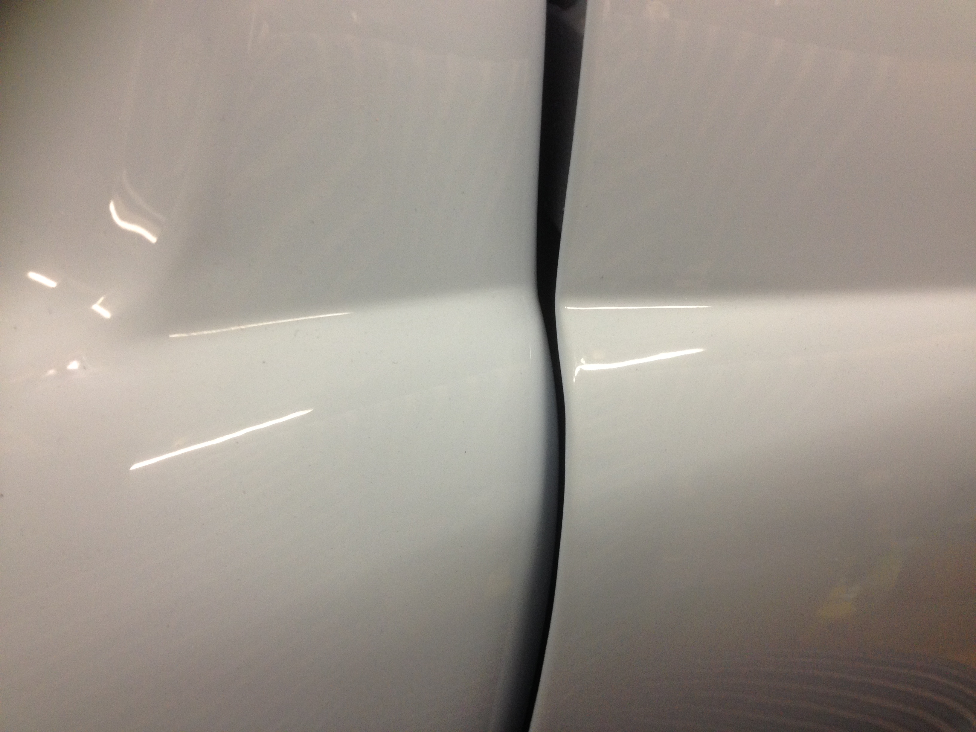

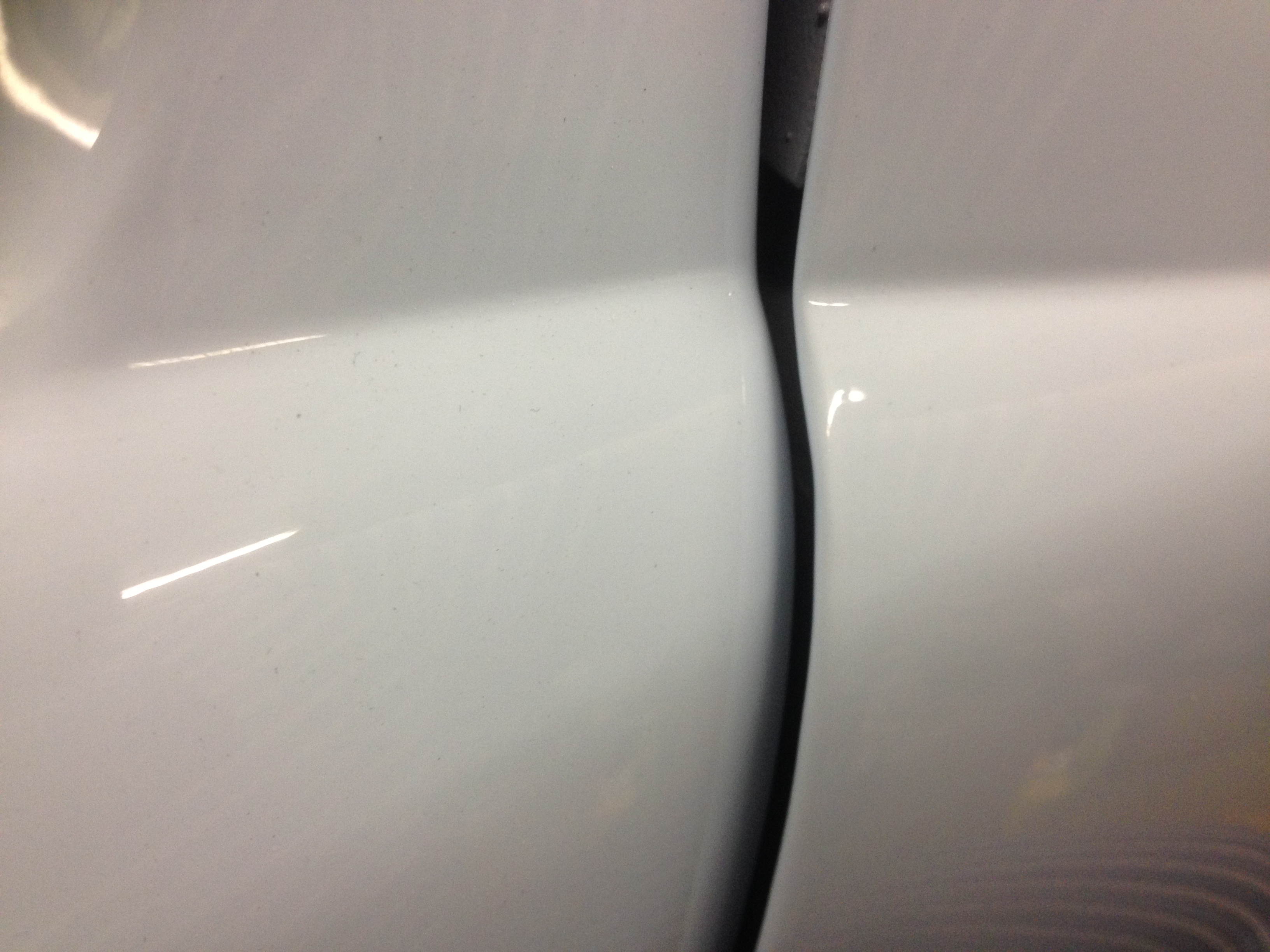

Damian, that might be related to the wide gap you were reporting previously.
In the olden days I remember making spacers or putting washers under the flat of the hinges to avoid that problem. But of course, that makes the gap even wider. I would check the inner flange where the door-skin is crimped to the frame; there may be scope to dress that down or out a little to create clearance taking care not to spoil the lines.
If the door is a replacement, it's possible that the contours of the door and wing are slightly out. If that is the case you might be able to carefully re-shape the edge of the door or slightly tap in the edge of the wing.
Hi Damian,
finally managed to get some images to load.
let me know if you need some more
I took one as well but forgot until I read this thread again!!!! Doh!!!
I think my doors open a bit wider than Sean's, in fact til I took the picture I didn't realise how close they get.
Seans look good and clear the wing more than mine. Mine look more like yours Tony. It gets really close. Of course at the moment mine doesn't have all the coats of paint so it is only going to get worse! Going to get the rest of the car finished first and then leave the doors till the end. I will check them properly by fitting the seals, locks and latches. Thanks for the photos.

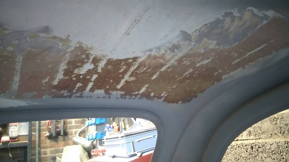

What an arse of a job today. Trying to get what remains of the old roof padding off. The only thing that would shift it is a P60 disc on my grinder. The dust went everywhere. I'm going to have red bogies for days and I had a full mask on!
You were unlucky with that one Damian. The secret is to leave the car in a damp garage or even in the open garden, preferably with the roof open and in a damp part of Scotland for about 25 years. That way the roof lining simply falls off by itself.:D

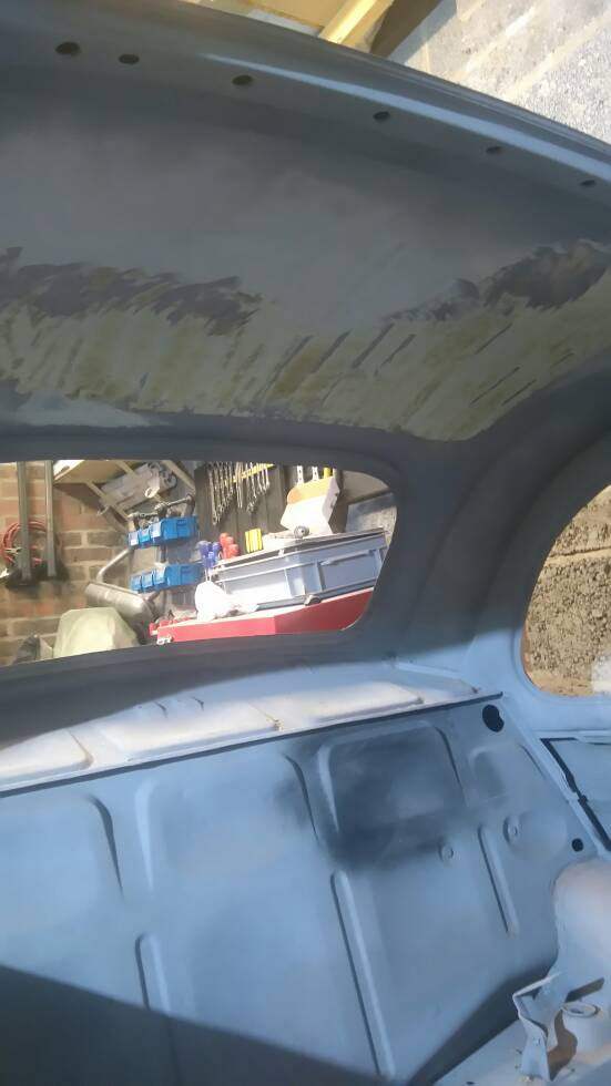

Found a much quicker and neater way to get that mess off the roof. Heat and a scraper. 10 mins, done!

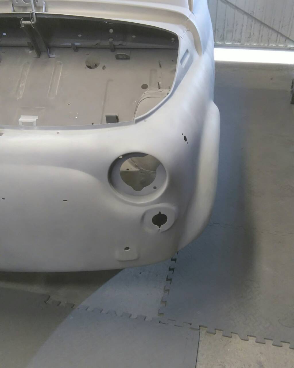

Getting more and more of the car primed grey as filling gets less. Should be just about done by end of the month (?)
