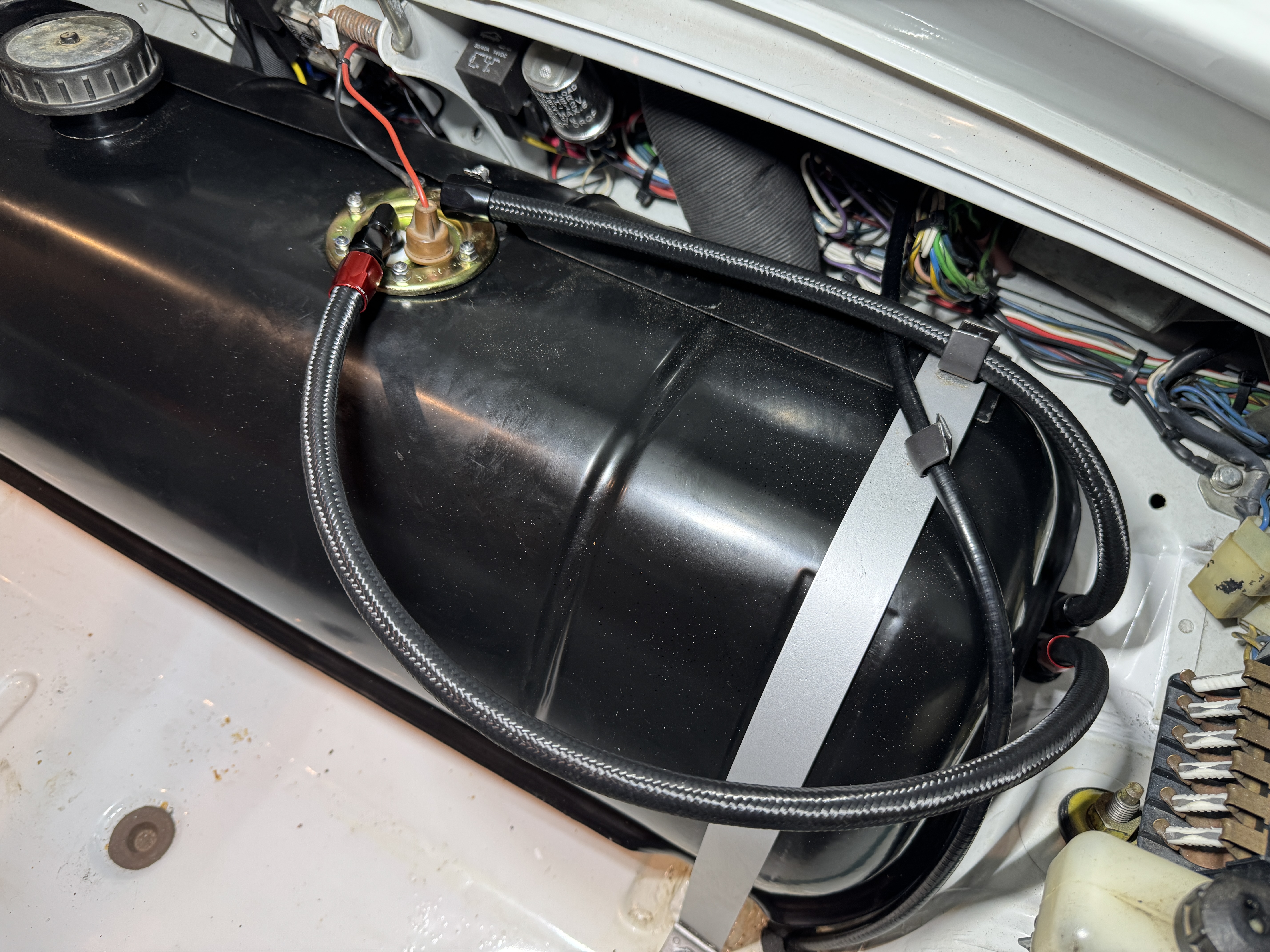

There we go, clean and open. While I was in there, I cleaned up the wiring, wired it for a LH side coil, and put everything into split loom for a neater appearance. Now to start in on the fuel system. I wanted to put something in that was clean, long-lasting, and modular, so I decided on braided lines and AN fittings. I had braided stainless PTFE lines made for the center section that runs through the tunnel, thinking that they would last the longest, be the most resistant to wear, and since they're the low point in the system, the PTFE would be the most resistant to fuel just sitting in there. Those lines were the priciest part of the system, as I couldn't DIY PTFE fittings and had a local hydraulic shop make them. In the front, they connected to 90-deg bulkhead fittings leading to separate lines to the tank, and I fabricated a bracket for bulkhead fittings for the rear lines leading to the carburetor. Now, I could easily disconnect the motor or tank and not fiddle with the main lines - modularity!

For the return, I drilled a hole in the top of the sender unit and used another 90-deg bulkhead fitting rather than dealing with welding a bung into the tank. Coincidentally, I also discovered a pin hole leak in the tank, so I ordered a new one. Hooray for pop up expenses like that. The shorter lines make it easy to splice in an electric pump, check valve, or additional filter without re-plumbing the whole system, if I ever feel the need.
