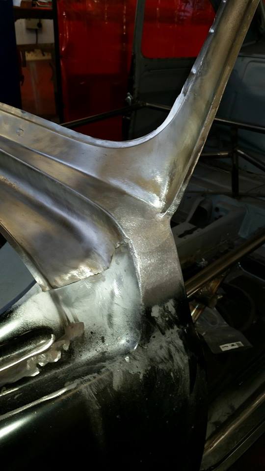

Just FYI.
I used loads of lead on a MGB roadster I repaired s couple of years ago. It's a great way to deal with any large repairs or in areas which are likely to get knocked as it is more resistant than filler.
It's an art in its own, that I was taught over 25years ago. Used it a lot on Rolls Royces and E-type Jags that we used to repair.
Word of warning though, make sure you remove any tallow used to flow the lead as this can cause paint reactions.

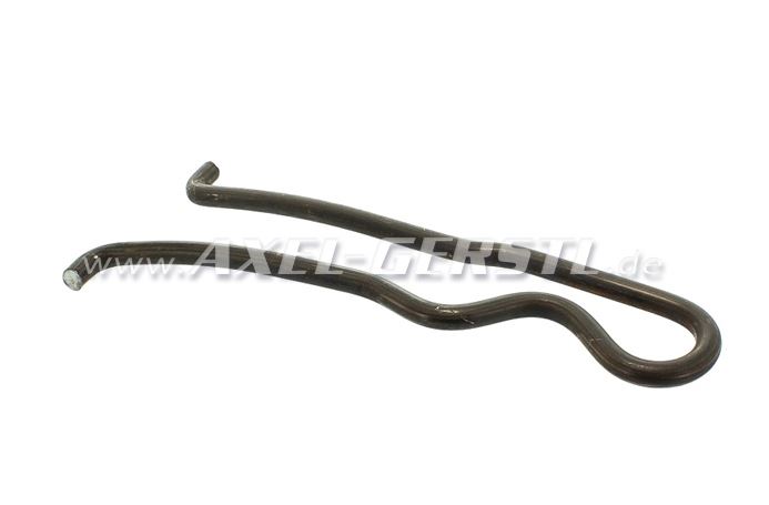

When I fitted the check straps, they wont open enough to hold in the outer position. Its as if the check straps are too long.
Check straps? Thought the doors opened on a metal latch. I am trying to remember back 2 years when it was last back together
