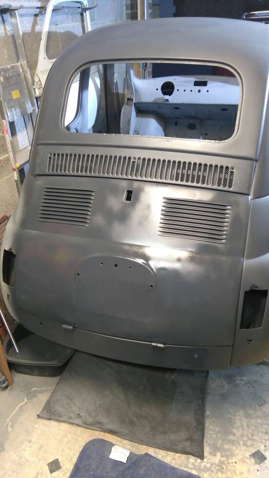

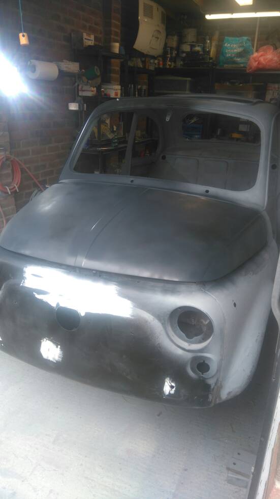

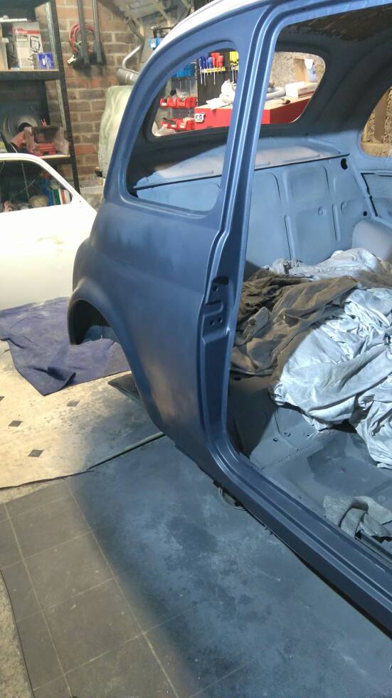

Live updates from the garage. Completed one side and bonnet outer surface. Bonnet is only placed on before anyone mentions shut lines;)

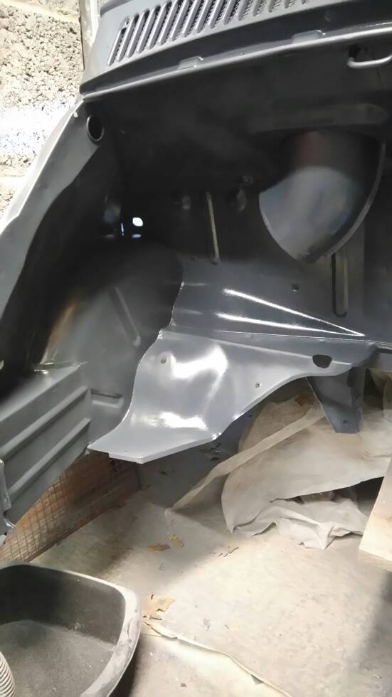

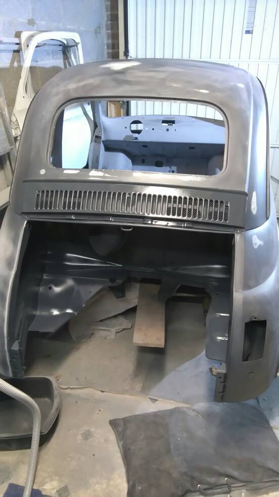

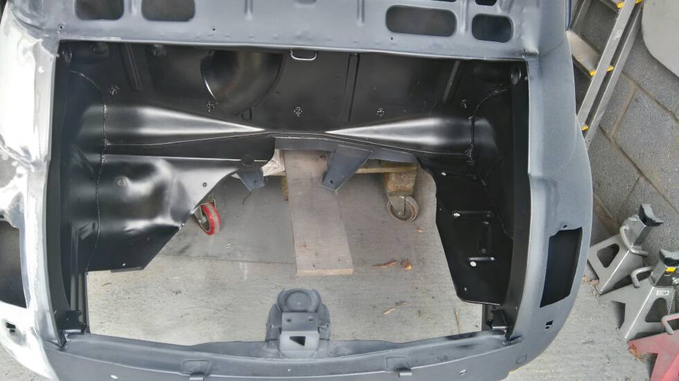

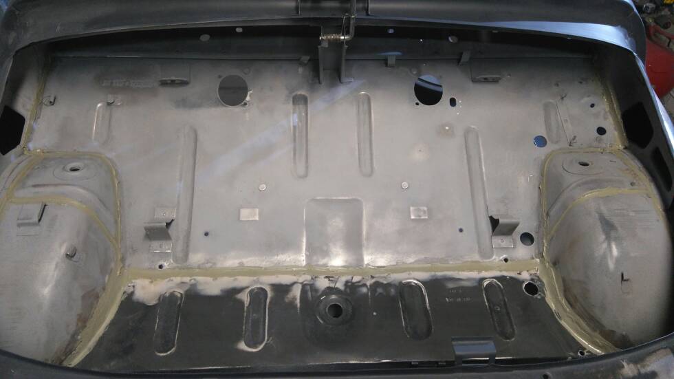

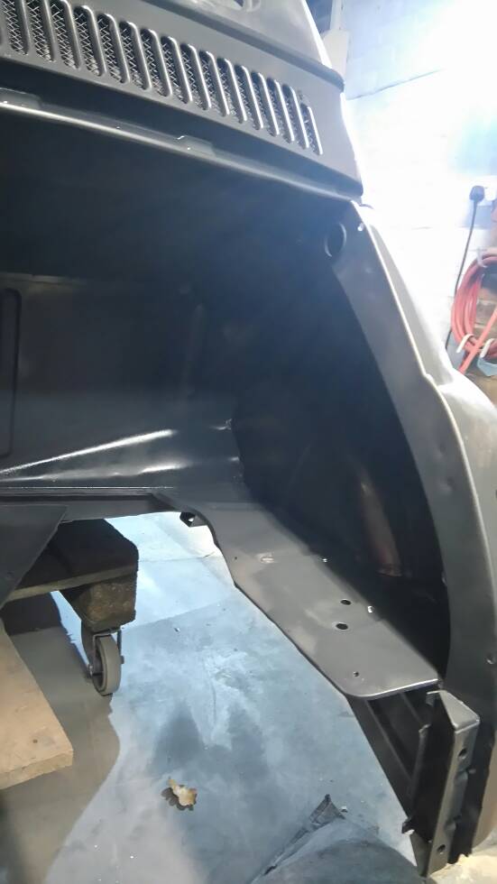

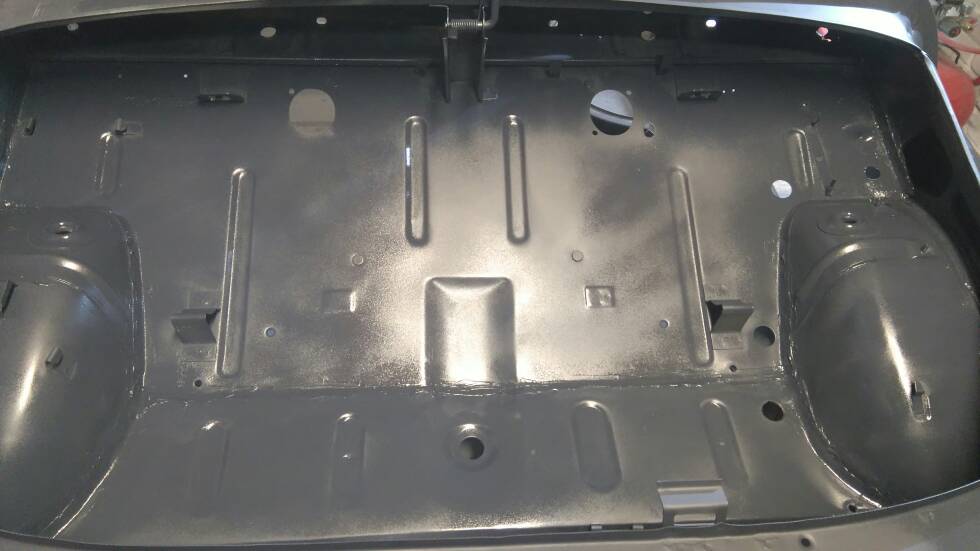

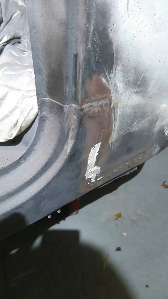

Not posted in a while as life keeps getting in the way but a couple of updates for you. Decided to coat the engine bay in POR15 rubberised coating. This should protect it better than just paint and should provide a little sound deadening! Hope to get the L/H side done today which will just leave me with the inside to do. Got to replace the hinges on the doors which is proving a real challenge. The pins are stuck in good and proper. Seam seal it all and then ready for painting hopefully by end of April?

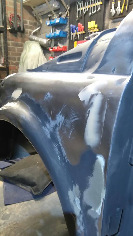

Your going through the difficult phase Damian where it just feels like you are not getting anywhere fast.
I have always set my self a goal to work on 2 panels at a time.
While you are waiting for filler to cure on one, work on the other and once you are happy with these give them a coat of etch. Make sure they are complete before moving on otherwise you may miss a few bits if you don't come back to them.
Keep going mate, you are doing well!

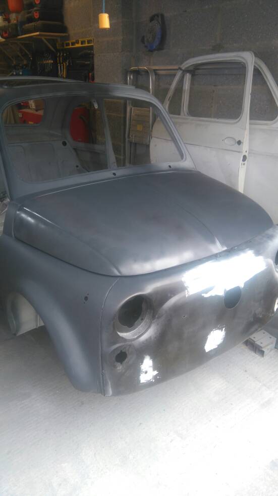

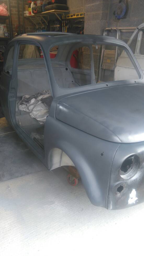

I can see a small light at the end of a long tunnel. Just the inside and front compartment to dress and then the doors. Will have to revisit a couple of places to make them perfect.

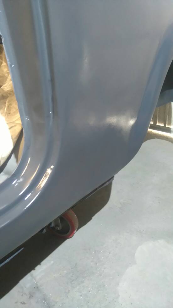

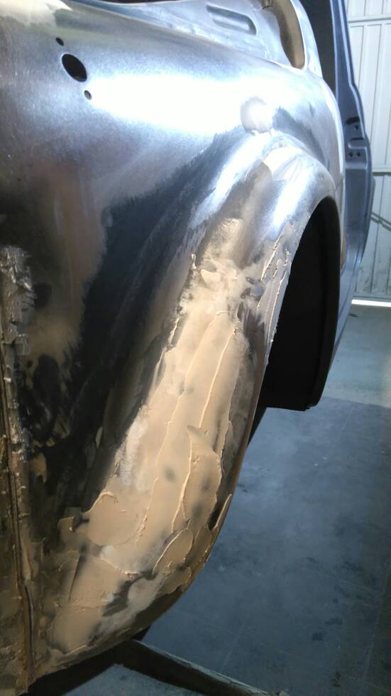

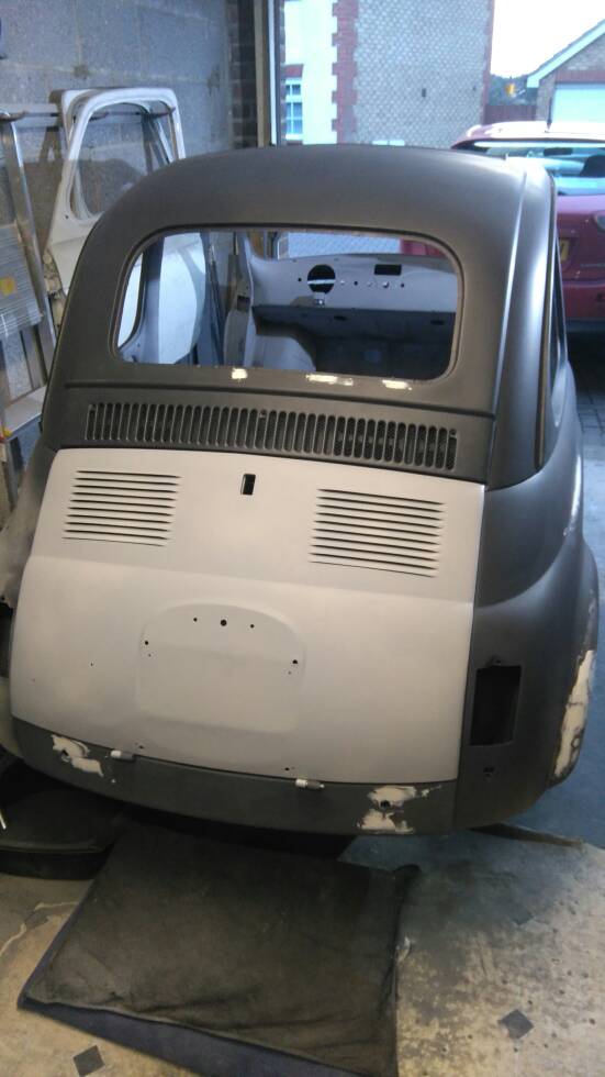

Life keeps getting in the way of my project and the painting deadline keeps getting put back! Aiming to have it all prepped now for end of May. The thing I'm struggling on at the moment is replacing the door hinges. Cut the old ones off with the angle grinder but the old pins are stuck solid. Will not be beaten though and will get them out somehow.

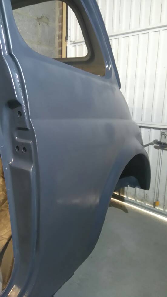

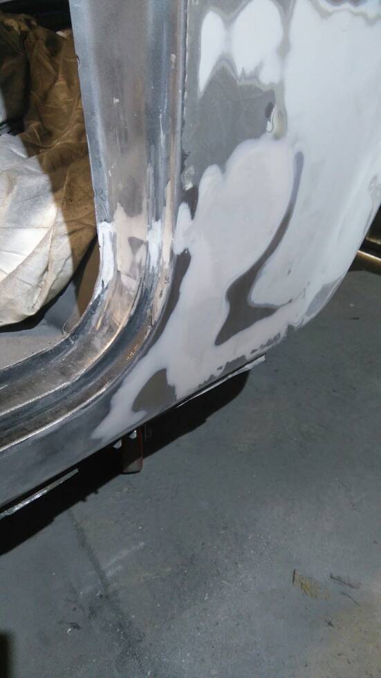

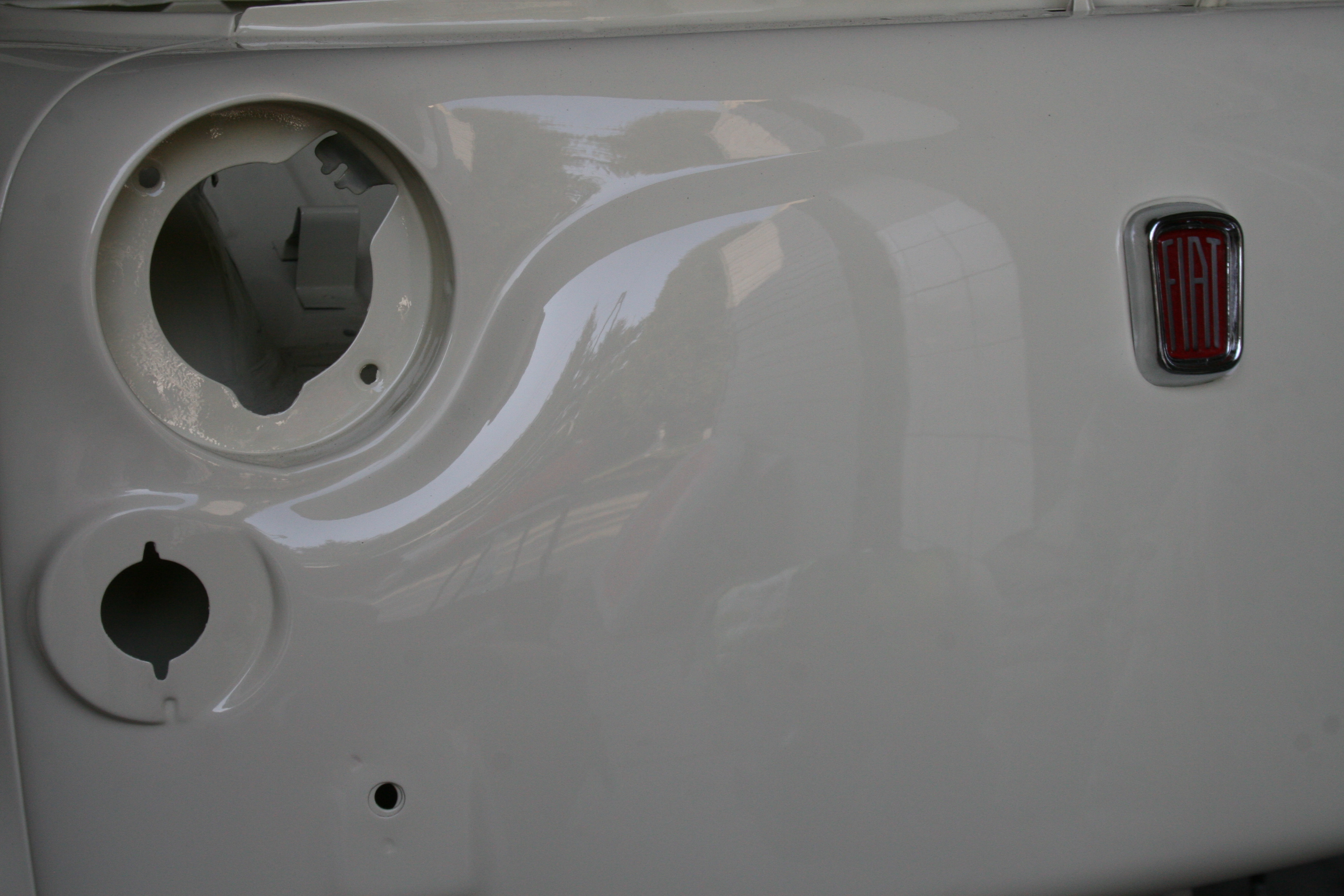

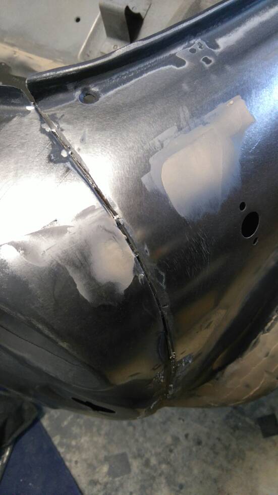

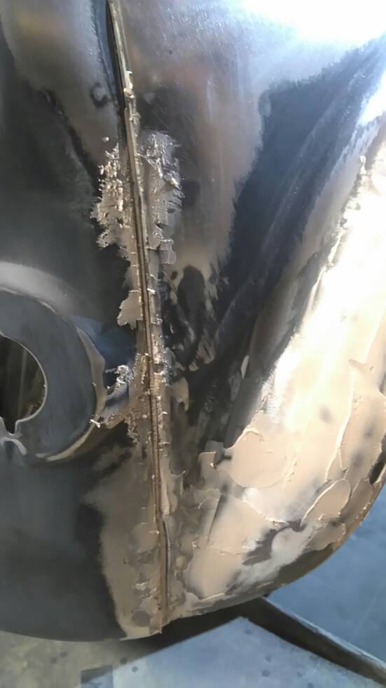

Have enjoyed every single stage of this restoration apart from this one. Having an OCD when trying to get perfect panels isn't good. Gonna get all the easier bits done and then I'll be left with the imperfections to revisit.
Need to add a panel line where the front wing meets the front panel to keep originality

Damian, if you've ended up with no joint line or a badly defined one, I would be tempted to fill it over rather than try to simulate one. Although if you did, lead-loading might be advisable for longest lasting looks.
That joint line is pain to get right at the best of times, as any slight misalignments, manufacturing errors or tool marks from the alignment process all get magnified as soon as paint is put one.
On one side of my car, in spite of great care taken, there are a couple of places on the very sharp radius of the flange on the wing where the paint has chipped away. I think that the sealant in the gaps doesn't help with this. I'm currently scratching away trying to do as invisible a repair as possible.

I am tempted just to fill that panel line over the only problem being it won't look original and we all know how some people on here crave originality;)
:):):).....and there's a lot who don't. The funny thing is that there are some cars where de-seaming is the way to go.:rolleyes:
I'm more of a pragmatist than a purist.
