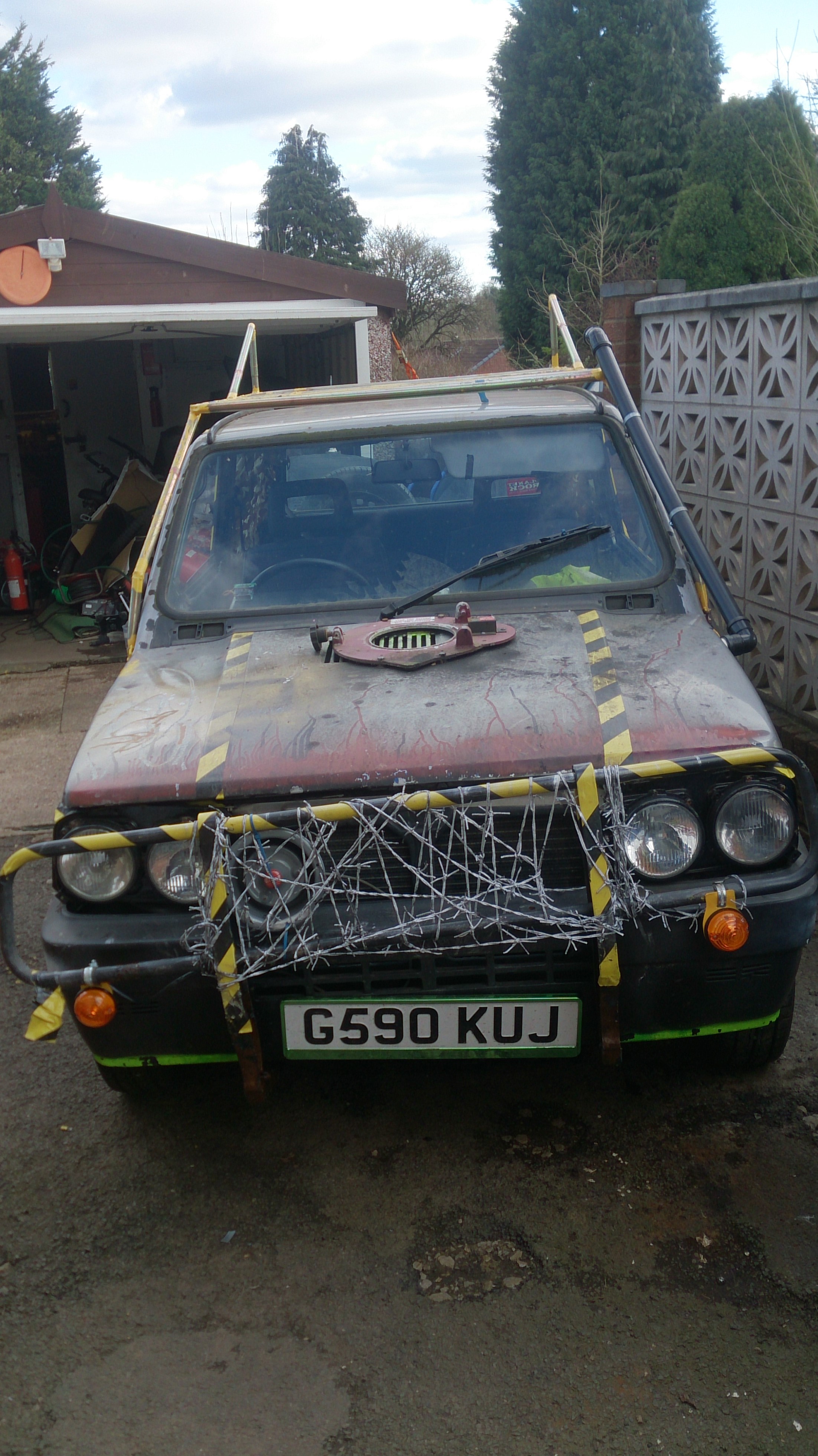

Edit:

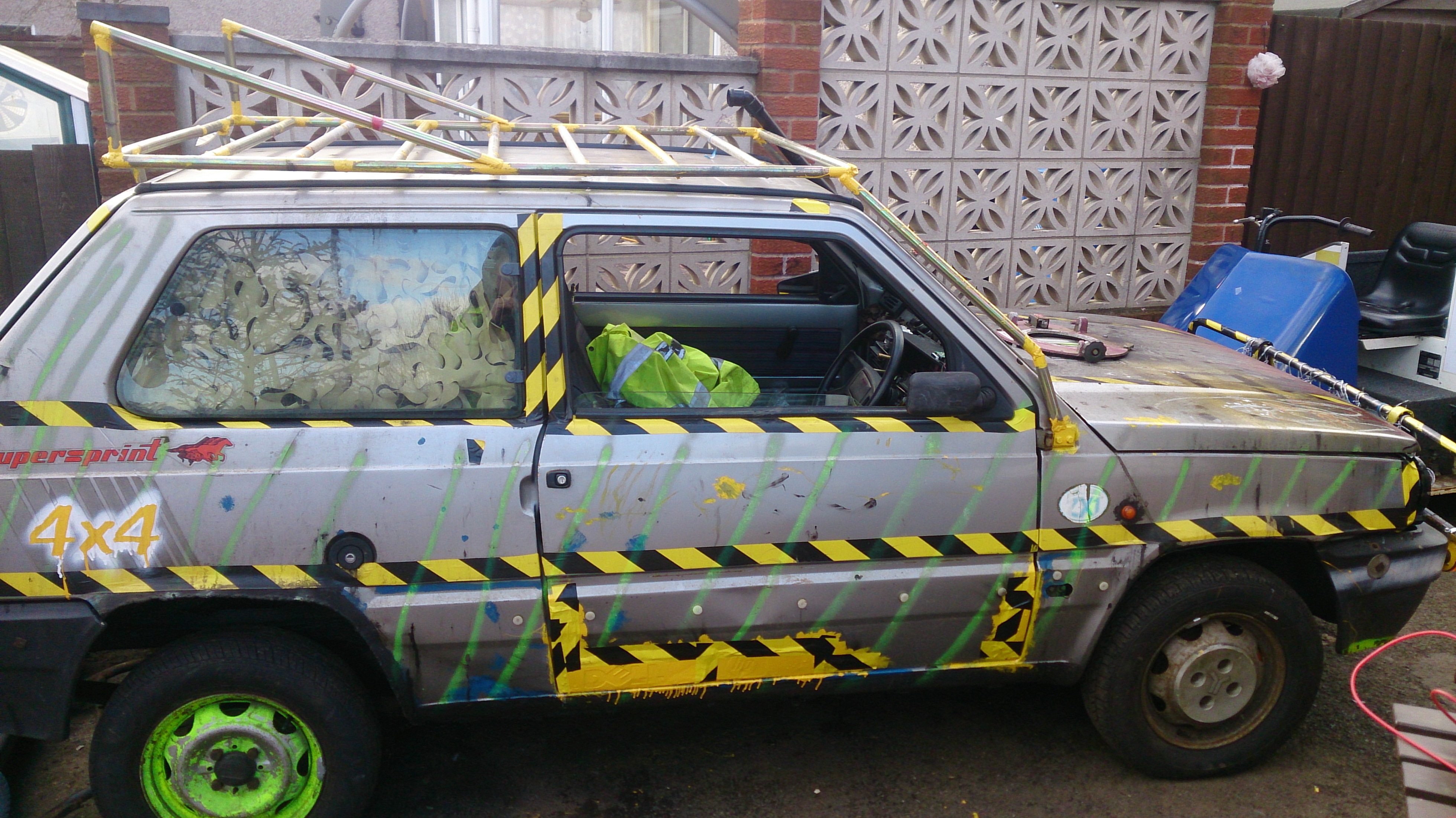

This is how it looks now: :eek::eek::eek: :slayer::slayer::slayer:

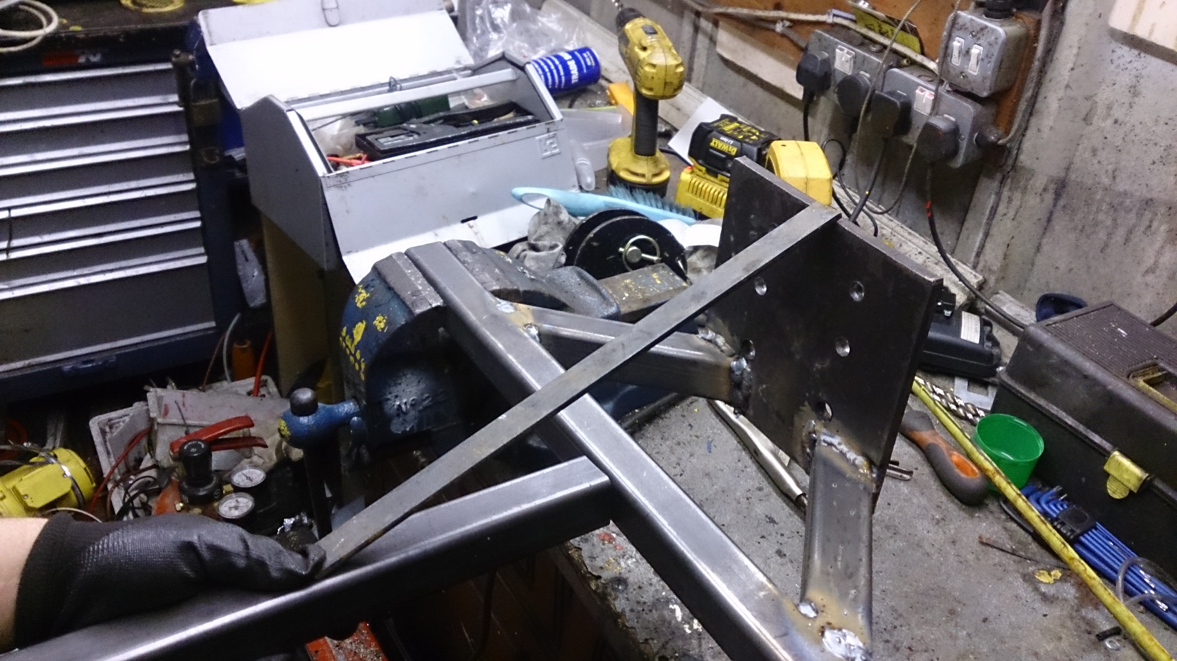

anyway, this is what i ended with.. well till i ran out of box and welding wire.
replace that flat bar with yet more box section.
i still need to drill the holes out bigger and finish doing the welding, but overall its looking pretty beefy. its way over rated for the car but will be a nice thing to mount stuff on to. (such as a pump up aerial mast..) ahem i didnt say anything.

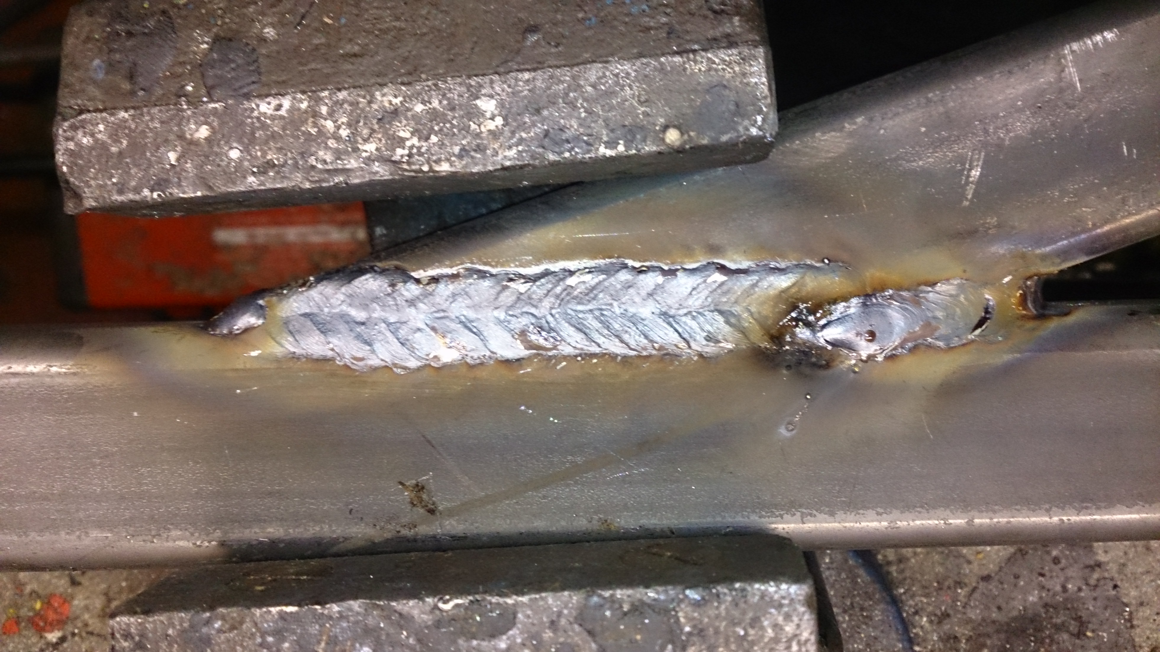

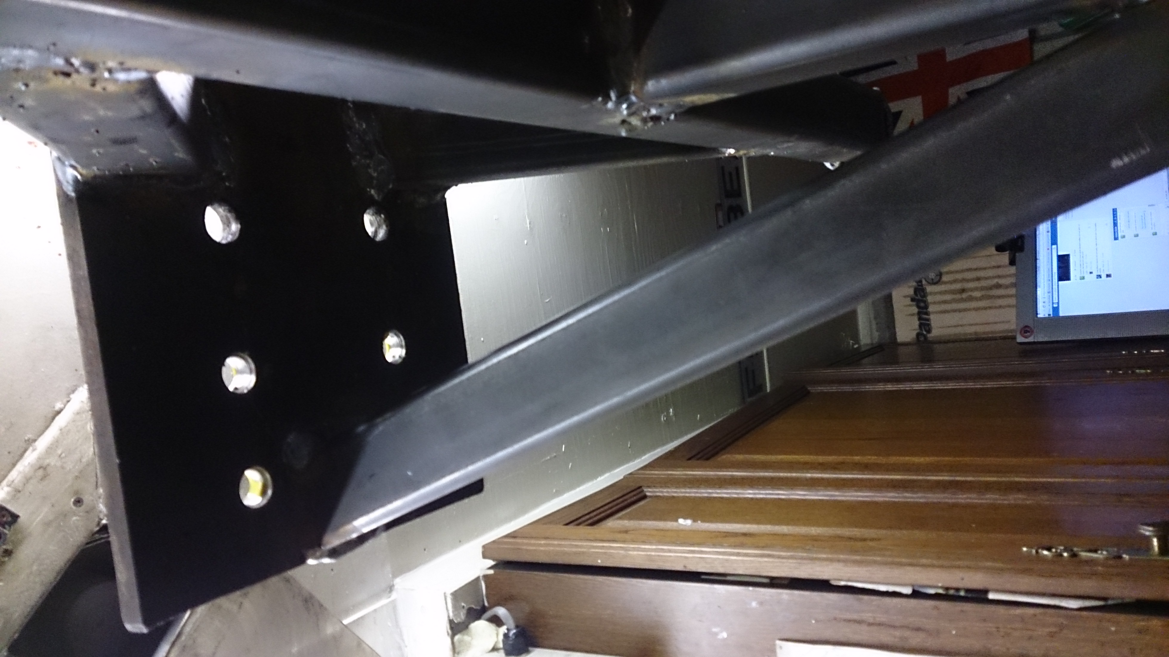

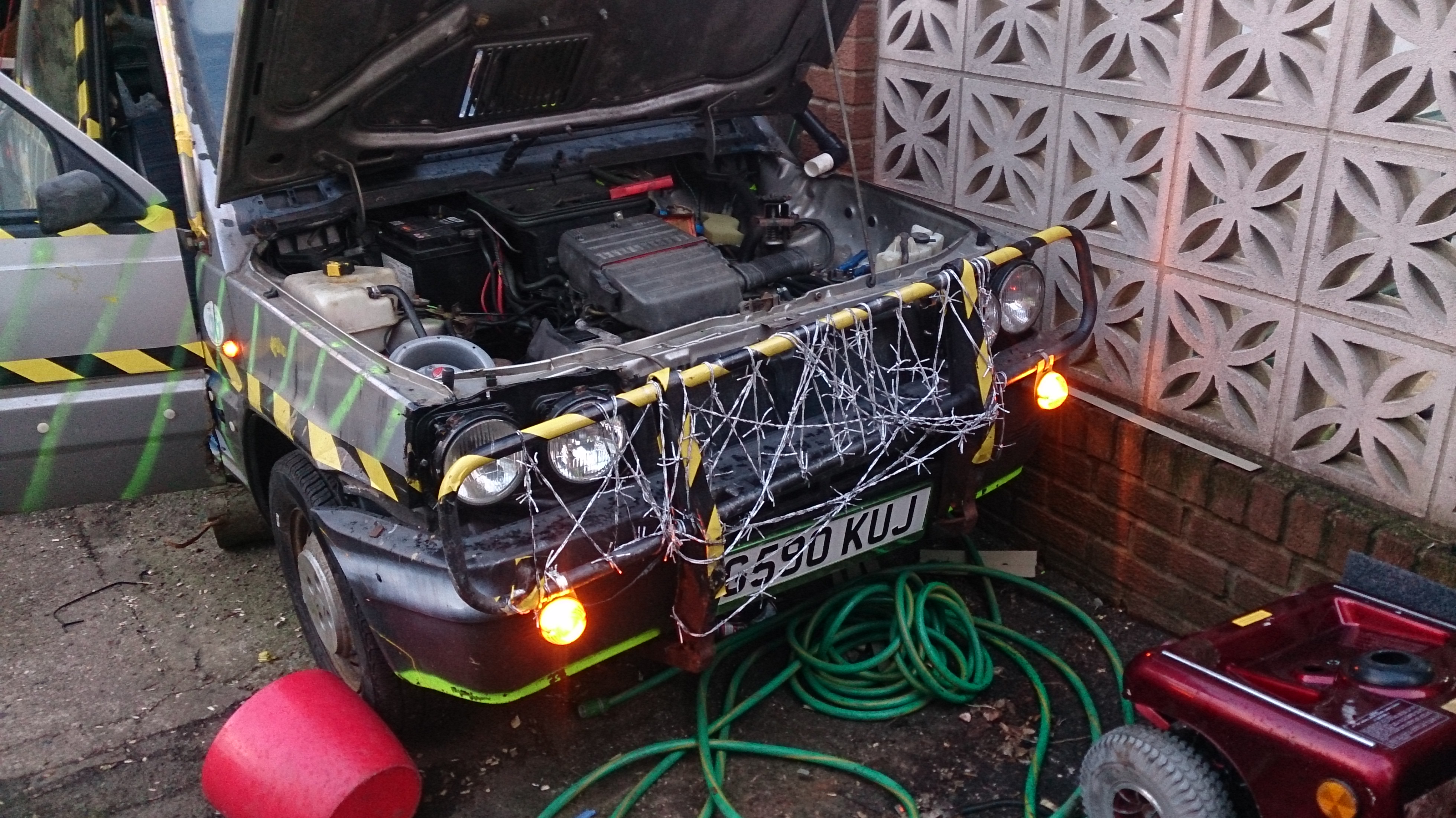

anyway i managed to get some more box, mig wire and some larger tips (i went for 1.2mm mig wire for welding the big stuff)
the result is this:
one of the best welds i have ever done in my life!

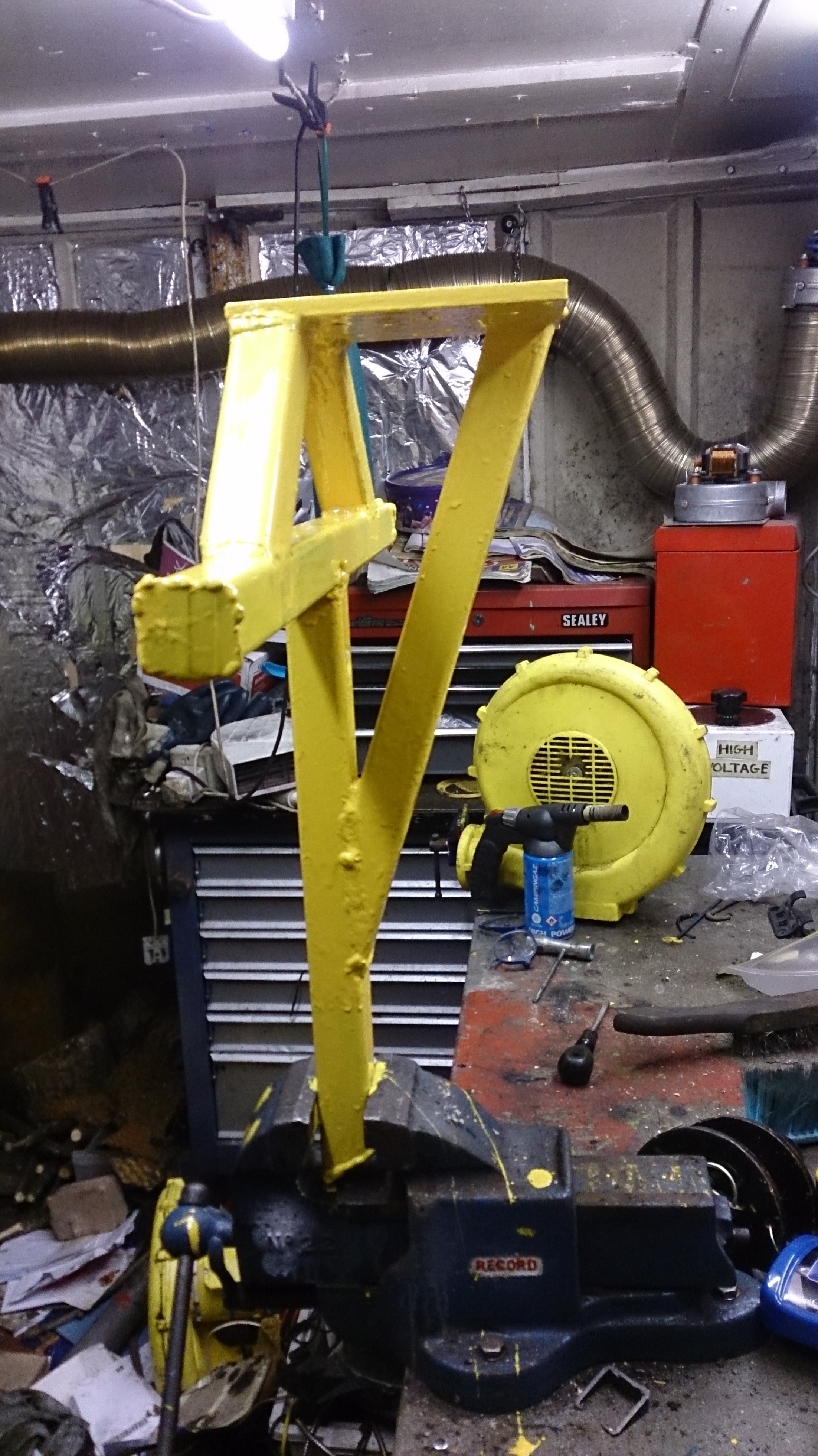

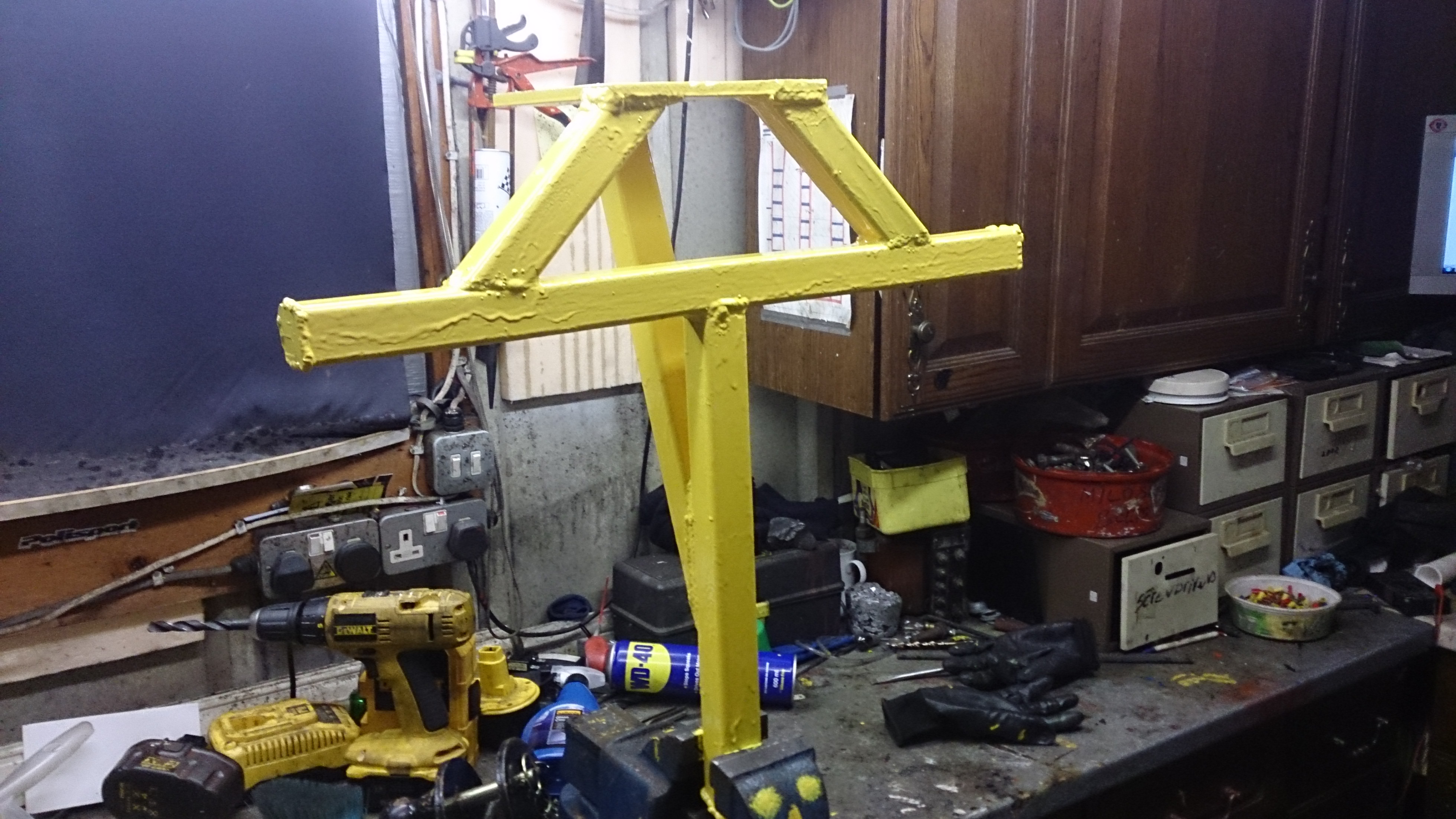

so yes this is going to be a multi use tow bar, used for towing and mounting things to.

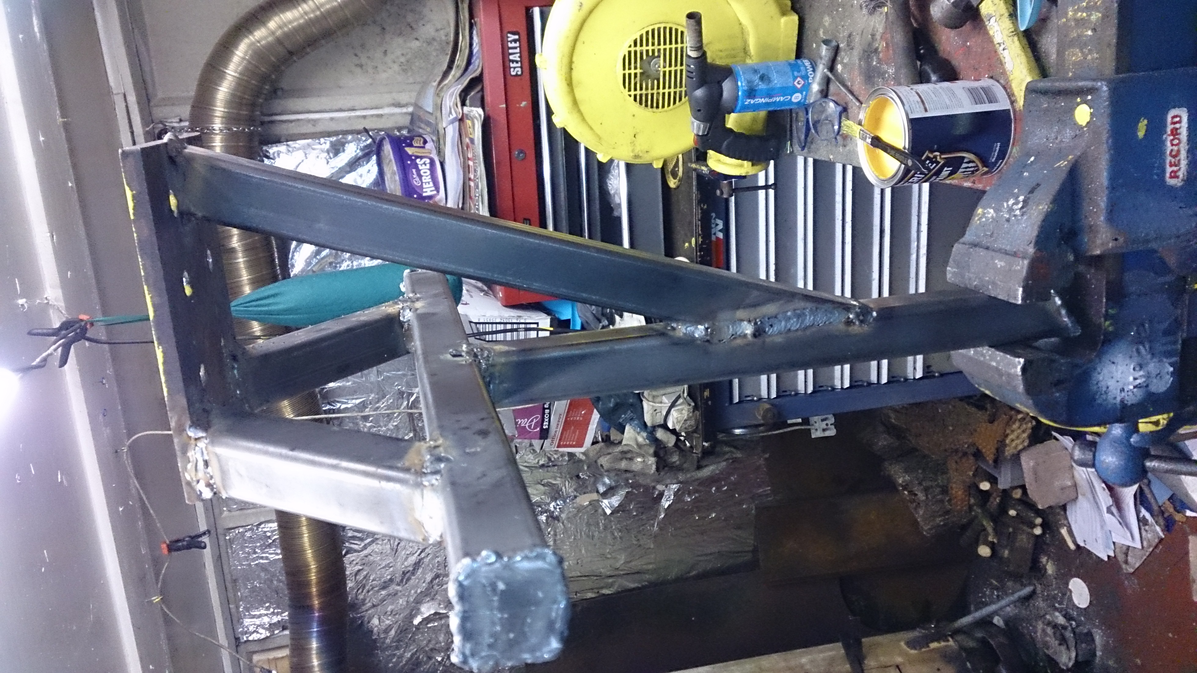

this is how it ended up:
and a bit of paint.. yellow is what i have lots of so its now yellow!
i know.. i know.. i have not drilled any holes in it yet!! oops! oh well, i need to get it mounted to the car first so i can get it all marked up where the holes need to go. i am going to make little tubes that will sit inside the chassis of the car (maybe welded in!) so i dont crush the box section of the chassis when i tighten the bolts up.
plenty of runs in the paint too.. heh oh well. at the time of the picture the back room of the garage was about 29.c! the wood burner just works that well..
i also need a drill bit big enough to drill through the big plate, that is the same size as tow bar hitch bolts.. sadly i do not have one that big! i need to get the thread size of the bolts i have, then get a drill bit a little bit bigger so i can finally get the hitch bolted to the plate.
before you ask, yeah.. its heavy.. i think the 1.2 engine will be just enough to keep it at the same speed as the 999cc!
ahh so, it has come the time where Talon's MOT and Insurance has ran out (early next month).
So Fallout. i want him on the road and give Talon a rest. for a year..
now i know i have a few things to do on Fallout before i take him to the MOT tester. mostly it is just cosmetic issues but i do need to tape up some wires here and there (for CB and other things that i have not got in the car yet) and i do need to do a bit of welding on the drivers door skin as it has rotted rather a lot since last summer.
i also need to get the indicators for the front fixed on.

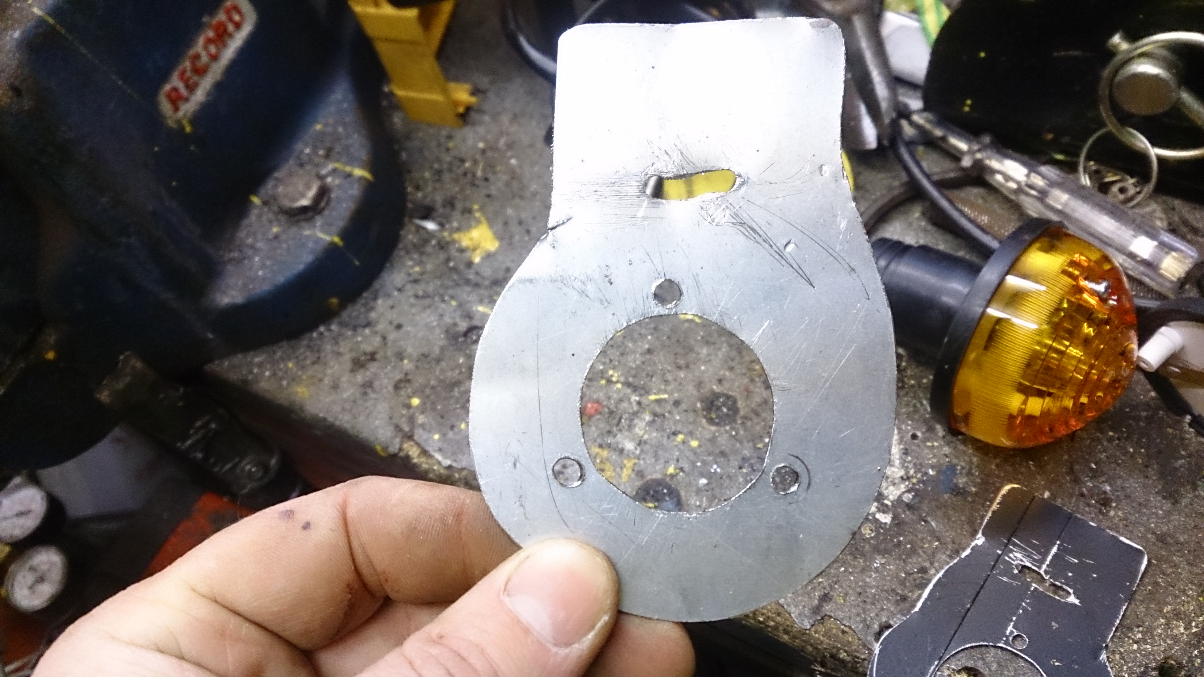

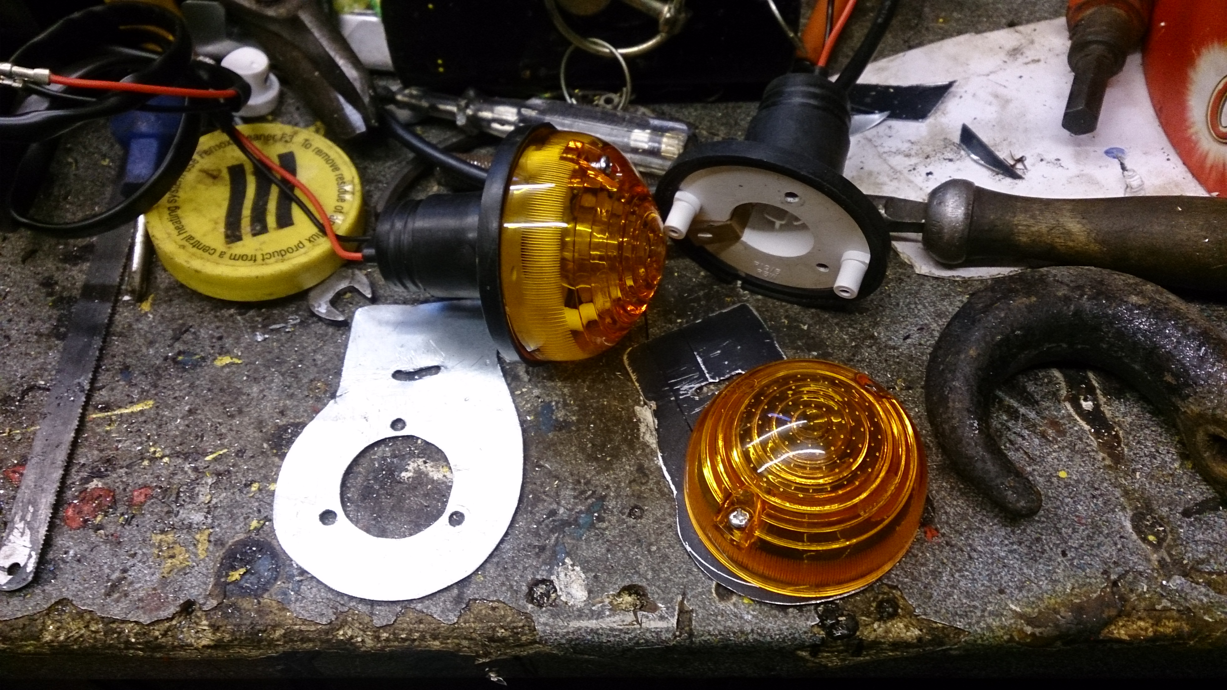

as a tribute to the Land Rover Defender, i bought some indicators from one! (well they were new complete units!)
i made some brackets and painted them Yellow (i have so much yellow paint..) and they will be mounted to the bull bar the same way i fixed the spot lights to Talon. nice and simple!
then it will just be as simple as sticking a jerry can of fuel in it, getting it insured.. (guhh.. this is going to be fun) and drive it to the testing place!
now to ring around insurance brokers for modified vehicles and see what comes up!
