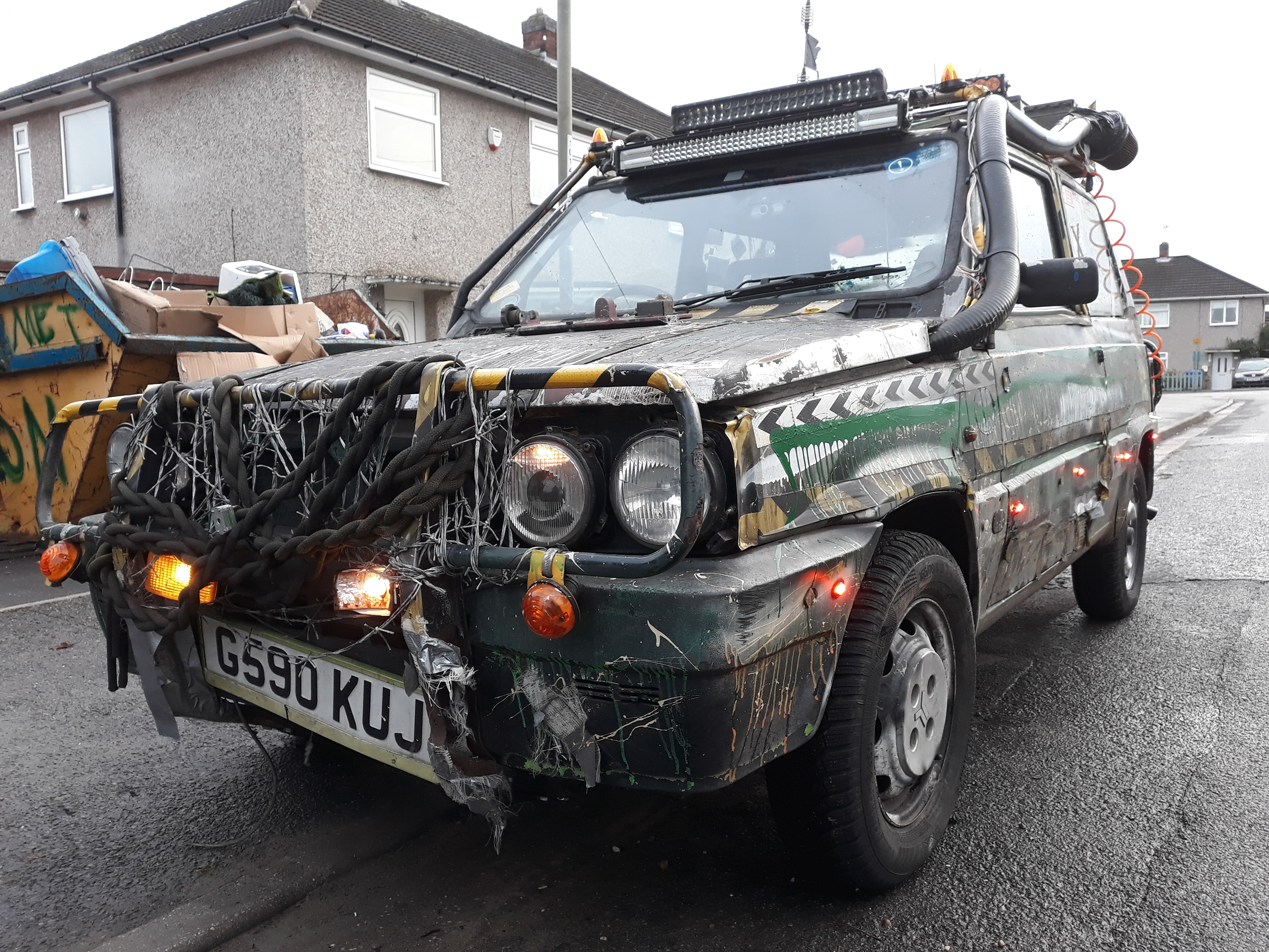

This is how it looks now: :eek::eek::eek: :slayer::slayer::slayer:
Ok, Fallout is pretty good!

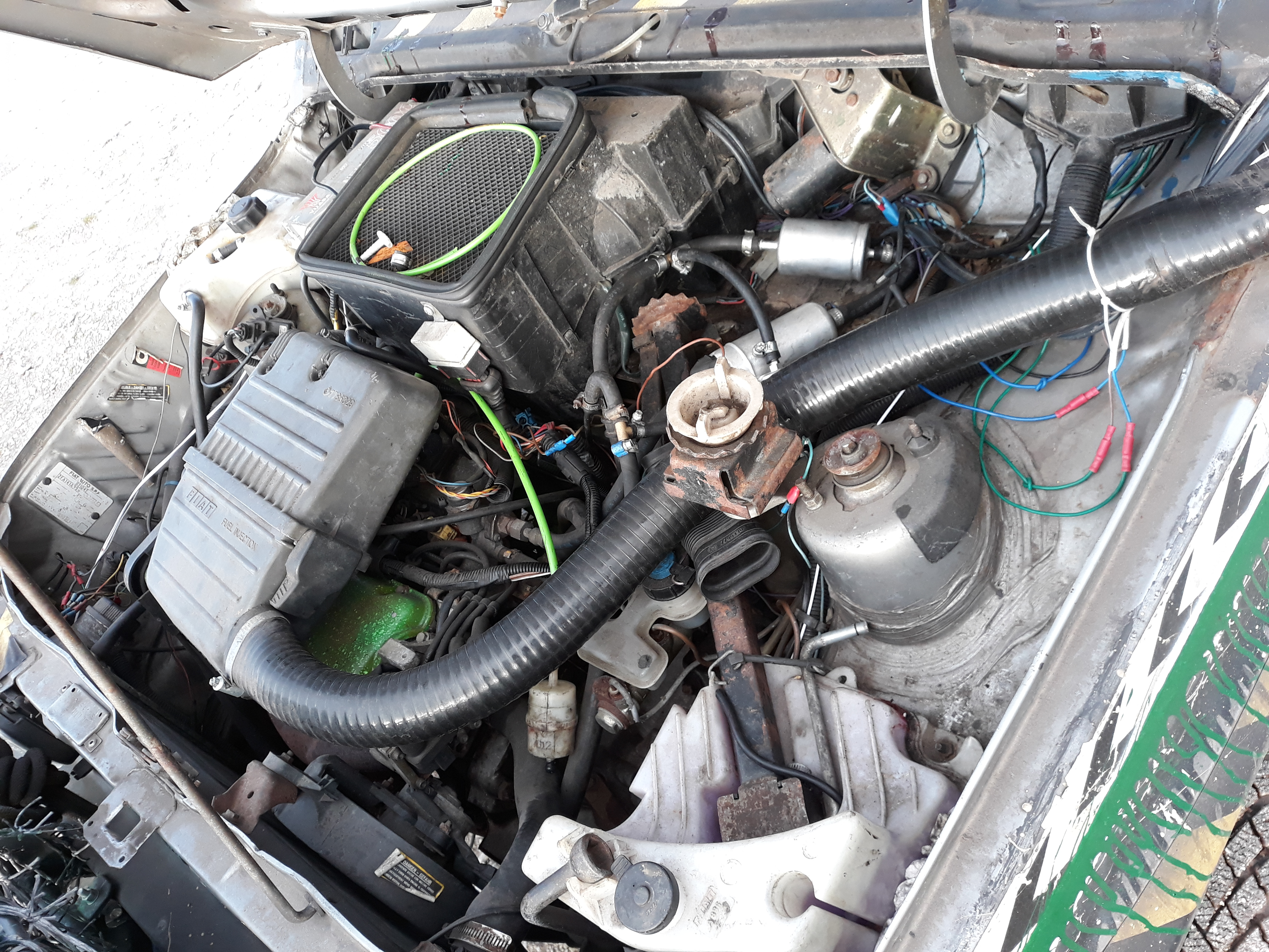

one issue i do have to try to figure out is the excessive fuel consumption.. i am not sure why but man i am getting down fuel quick. a full tank almost lasted me a month last year got to work and back, now its lasting about 2 to 3 weeks before needing to be refilled.
it also smells like its running really rich and hesitating to accelerate too. wonder if i have some vacuum leaks about.. it was fine on the old pump but i dont think it likes this new one so much.. it pumps such high volume of fuel through the fuel rail i dont think it gets chance to bleed all the excess pressure off.
i may have to do some kind of loop back system on the fuel pump to drop its pressure and volume down a bit. i know the thin return line is also causing a bit of pressure build up.
will have a play and report back.. i want to change the fuel filter anyway... the paper has actually been ripped away inside the filter the flow rate is that high. thankfully i run 2 filters, the other being designed for high flow fuel so any paper bits should have been caught in that.

on my p75 swap I ran a uno turbo pump, which is inline electric jobbie and the uno also has a little inline pre pump filter i stuck just before it. I did also change all the fuel lines but it was really cheap and easy tbf. There was probably pics in my old thread of what i used but it was all 8mm ID to and from the tank to the front with the pump mounted where the original coil would normally be mounted. It has been running totally fine since. Don't over complicate it lol

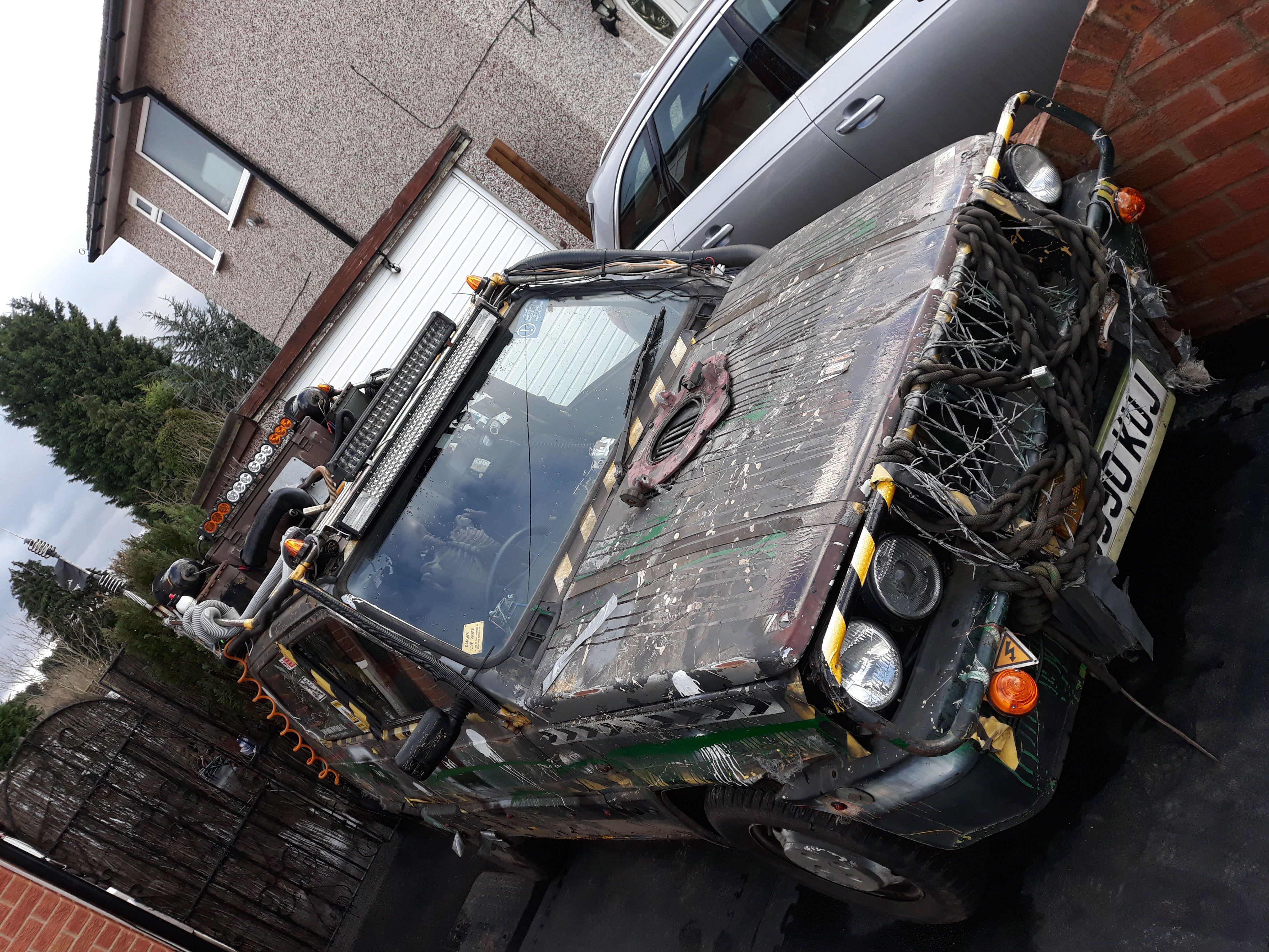

ok for those who have not seen, Fallout has undergone some more mods.
first off.. those winter tyres.. so recommended. £230 for four tyres.. and the difference is unbelievable.
Fallout seems good at the moment the fuel pump loop back idea has been working great for a month or two now.

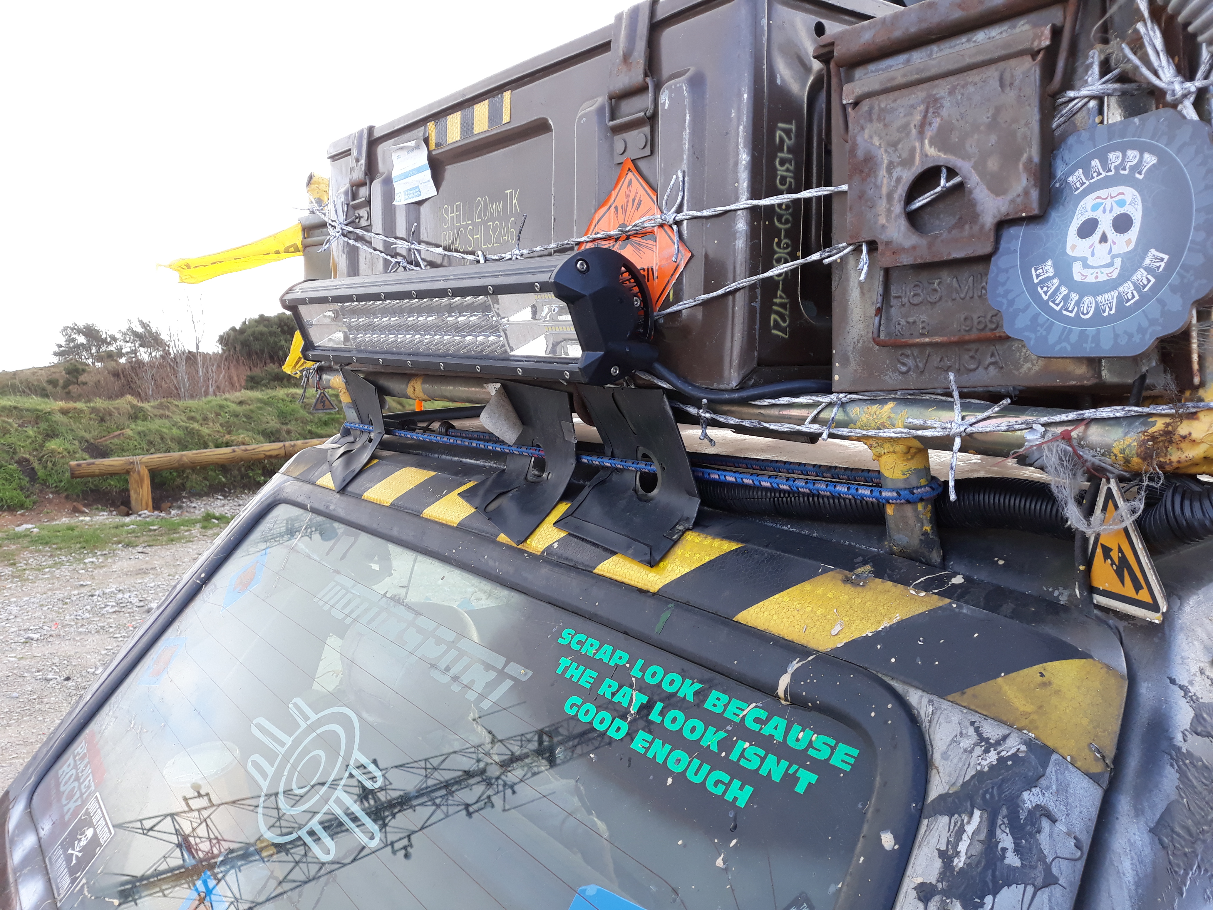

i installed one of those Chinese clone diesel air heaters to the car, made use of the ammo box on the roof. not currently working at the moment but it will eventually.
when installing the heater i found rust under the battery tray. thankfully it had not gone through but it set its self in good under the paint. managed to wire brush it all back, rust convert it then add some brush on metal paint to keep it away!

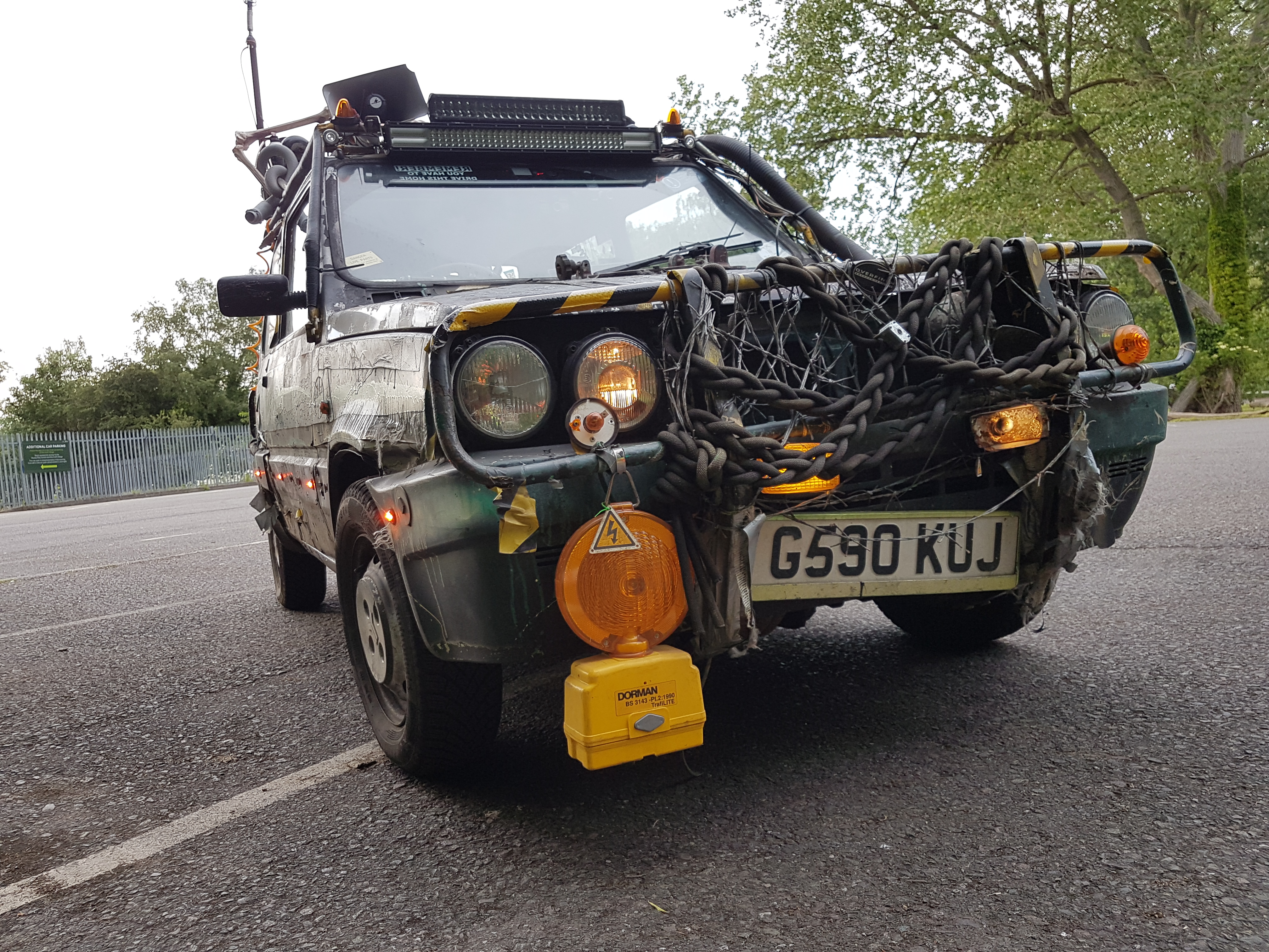

also added the side marker lights, and some red ones on the back. works well!
heres the pictures you have all been waiting for!

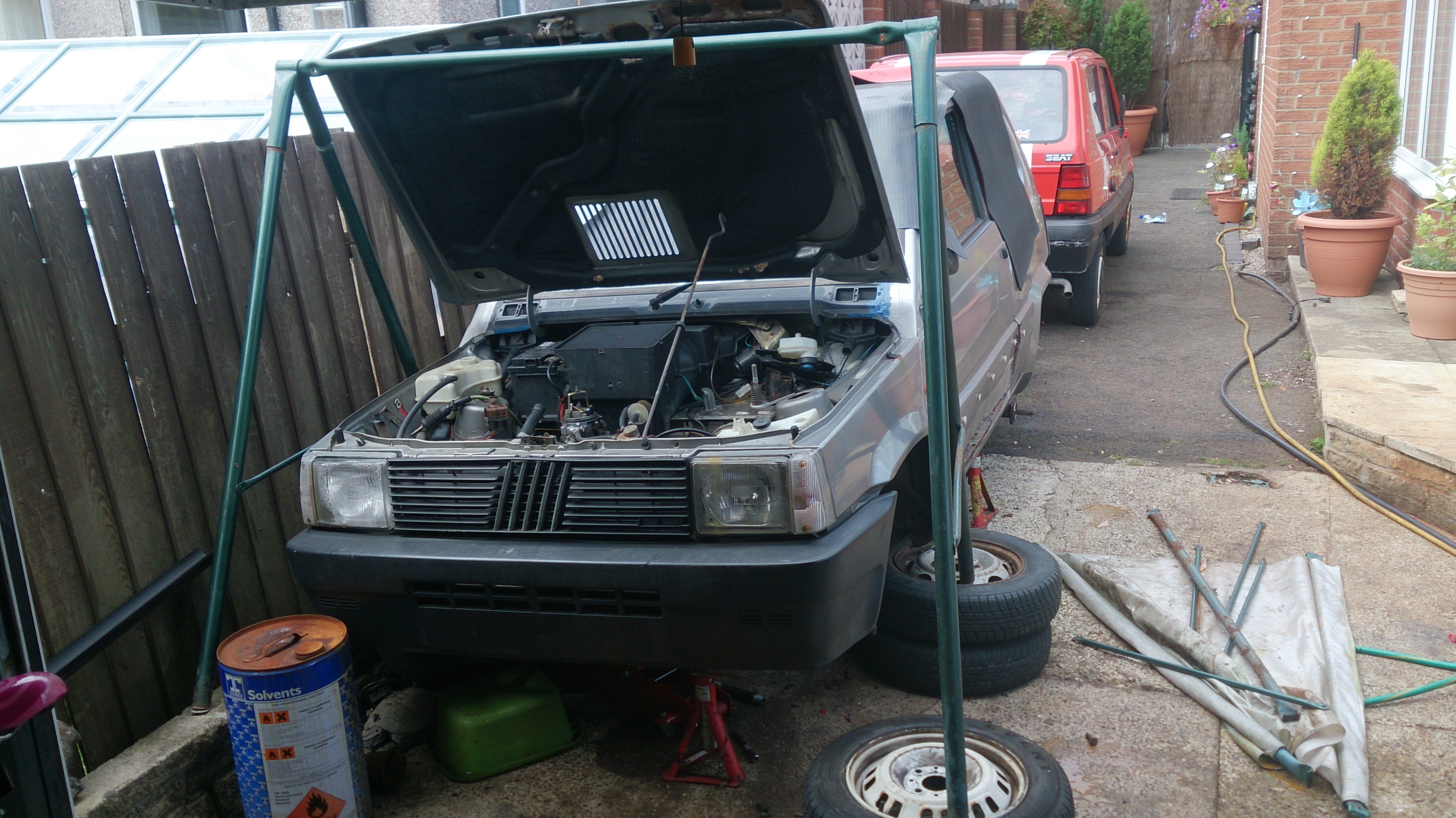

so here is the make shift engine hoist, made out of one of those garden swinging chairs. best use ever for one..
engine out!
its a bit mucky in there :/
Jetwash time!
here is the 1.2 ready to go in...
i notice that the timing belt is lovely on it..
lets get a comparison of that...
other than the belt.. the oil looks fresh.. the clutch looks brand new, the oil filter looks good..
i dont have any history with the engine sadly but in terms of how things look, i'd say that new things were done to this engine rather recently. i have no idea what the story is with the cam belt though.. even the water pump looks rather new.
i just need to get it up and into the engine bay. wish i had some help :/
Brilliant work that.i have been told you CANNOT remove just engine on its own from a panda classic. You just showed it can be done
Yeah you can.. I must say it's one of the more easy transverse engine cars to do it on, even the 4x4.
You guys need to wait and see what happens over the next year or so. Big engine in a fiat panda ;)
Yep
Would that be a diesel??
Having done this myself i also confirm its possible.. Although i would ever bother again myself. It made it so much more hassle than dropping an engine and box i think i could have dropped 2 or 3 engines complete with box in time it took me to get the engine out on its own without denting/scraping the bay up.
