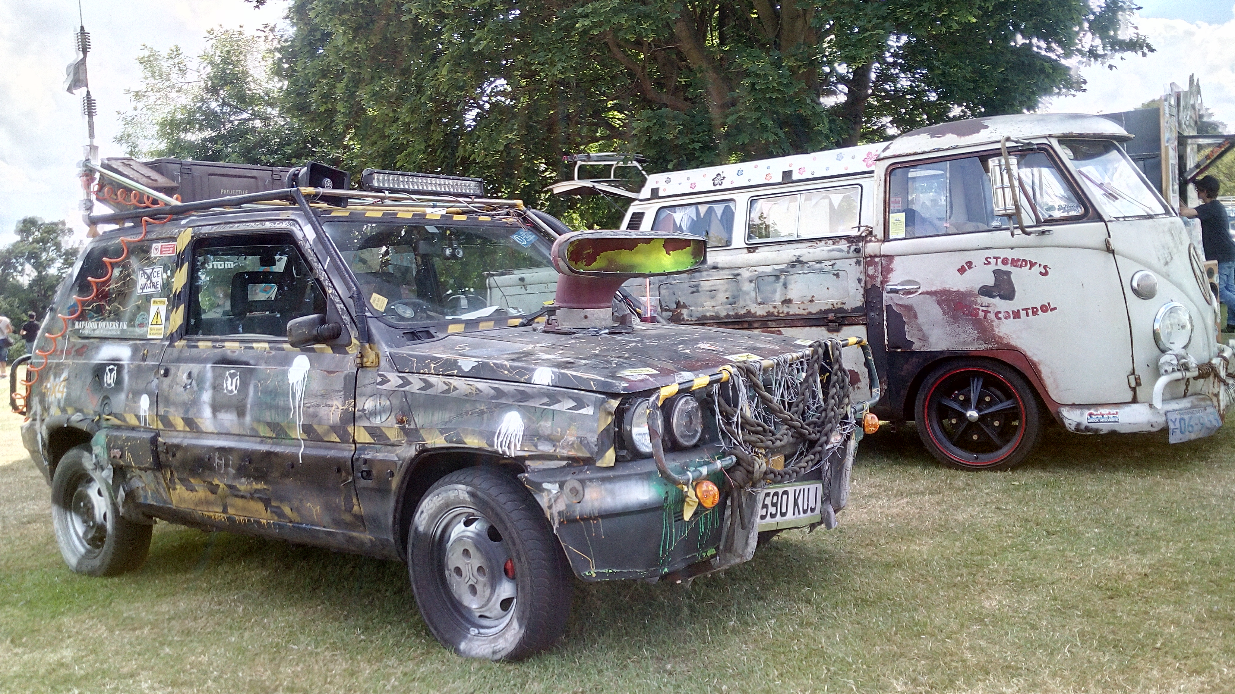

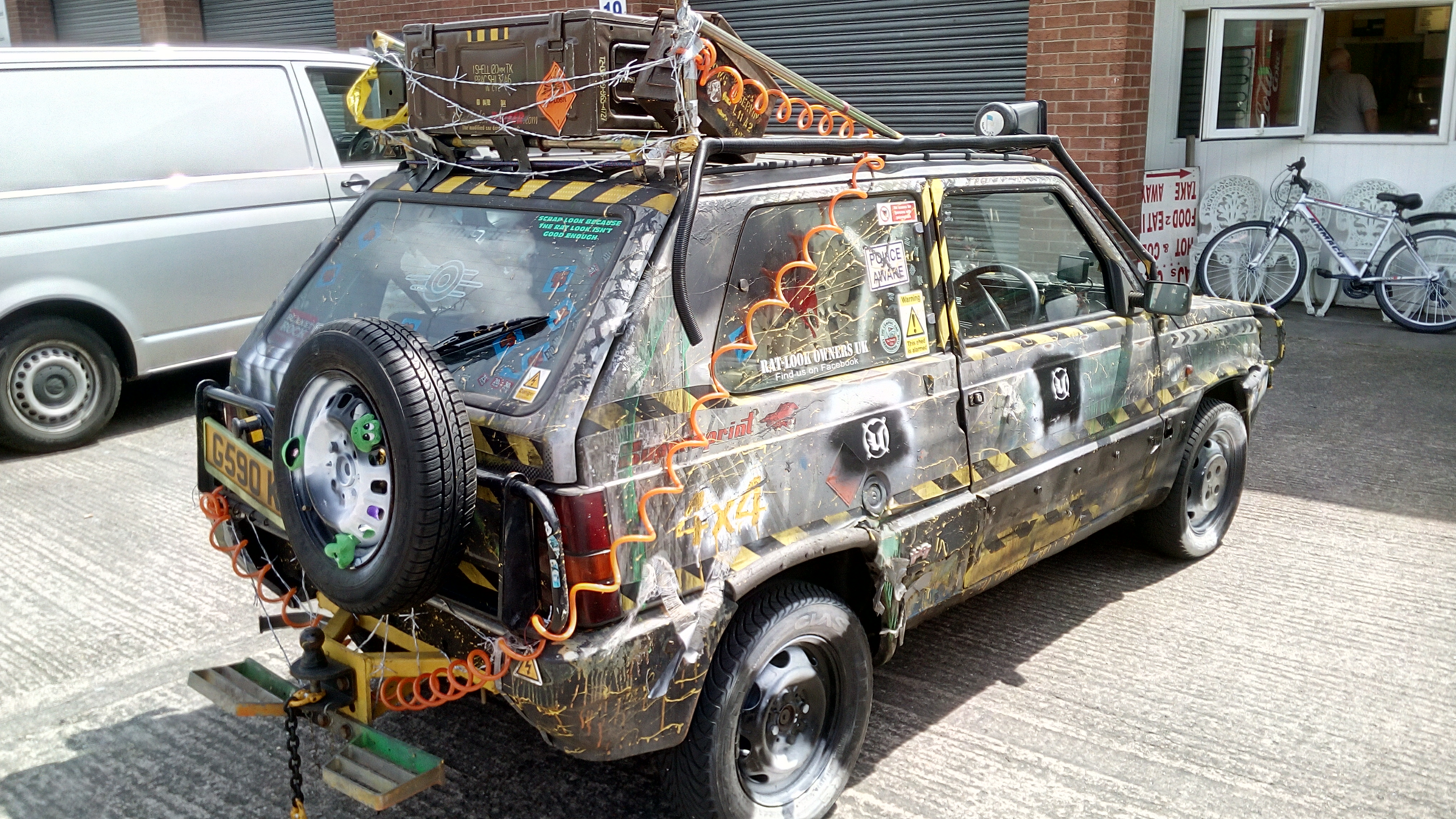

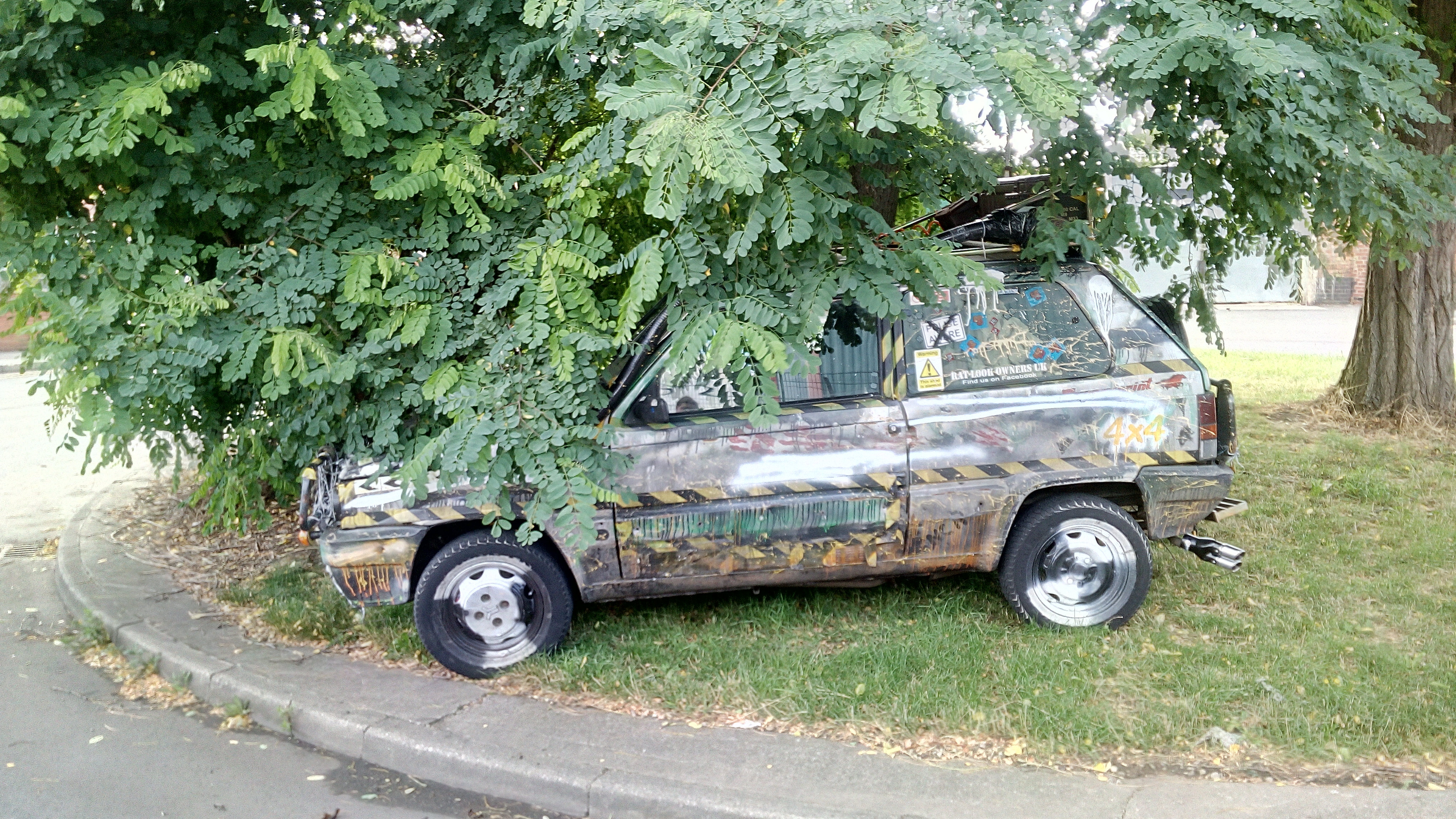

Hey guys, poor old Ratchet has been a little left out but he has been on a few car shows and some (very) local events.
heres some pictures!
the last 2 are where i park the car at work sometimes. not now really though.

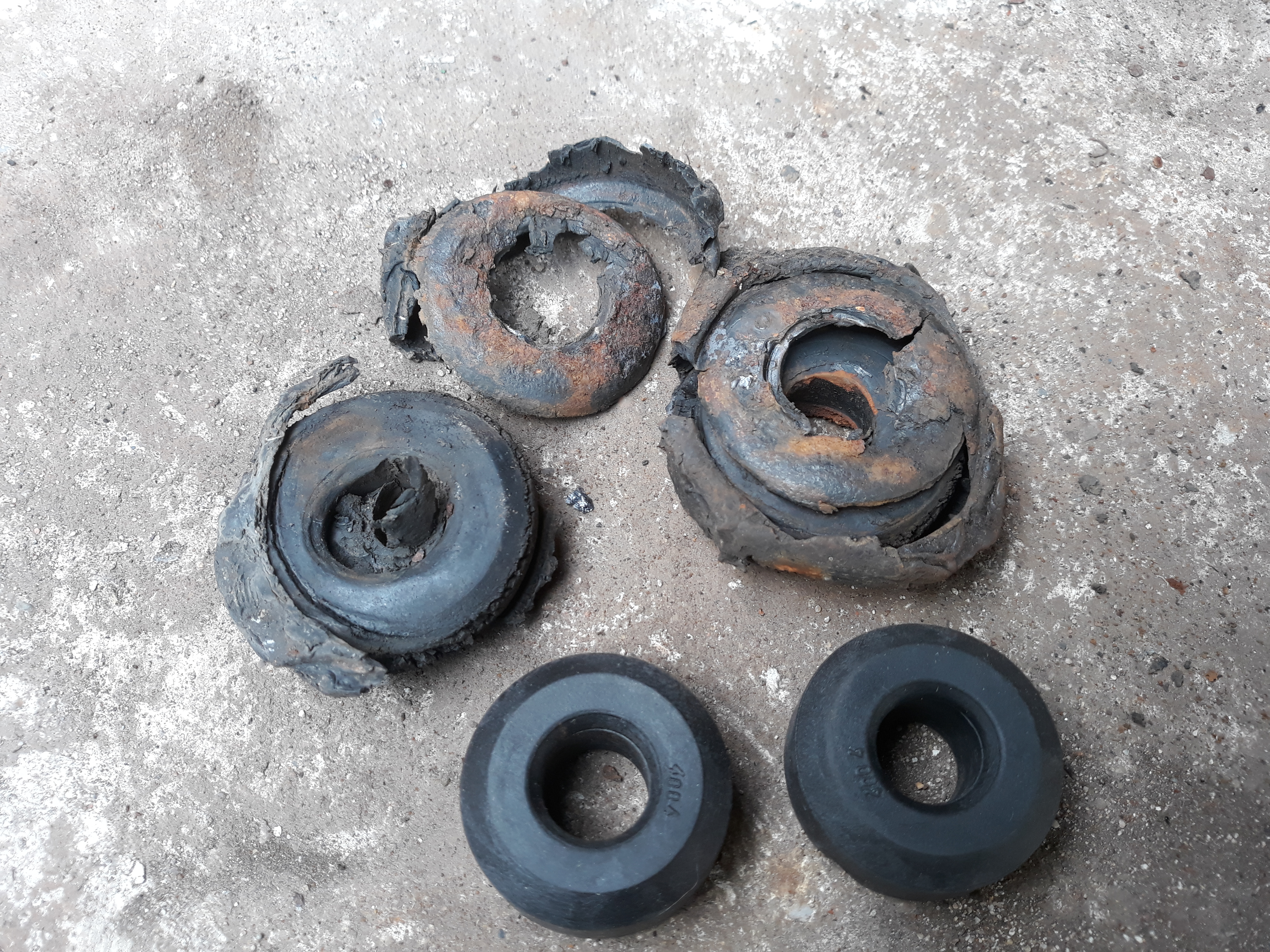

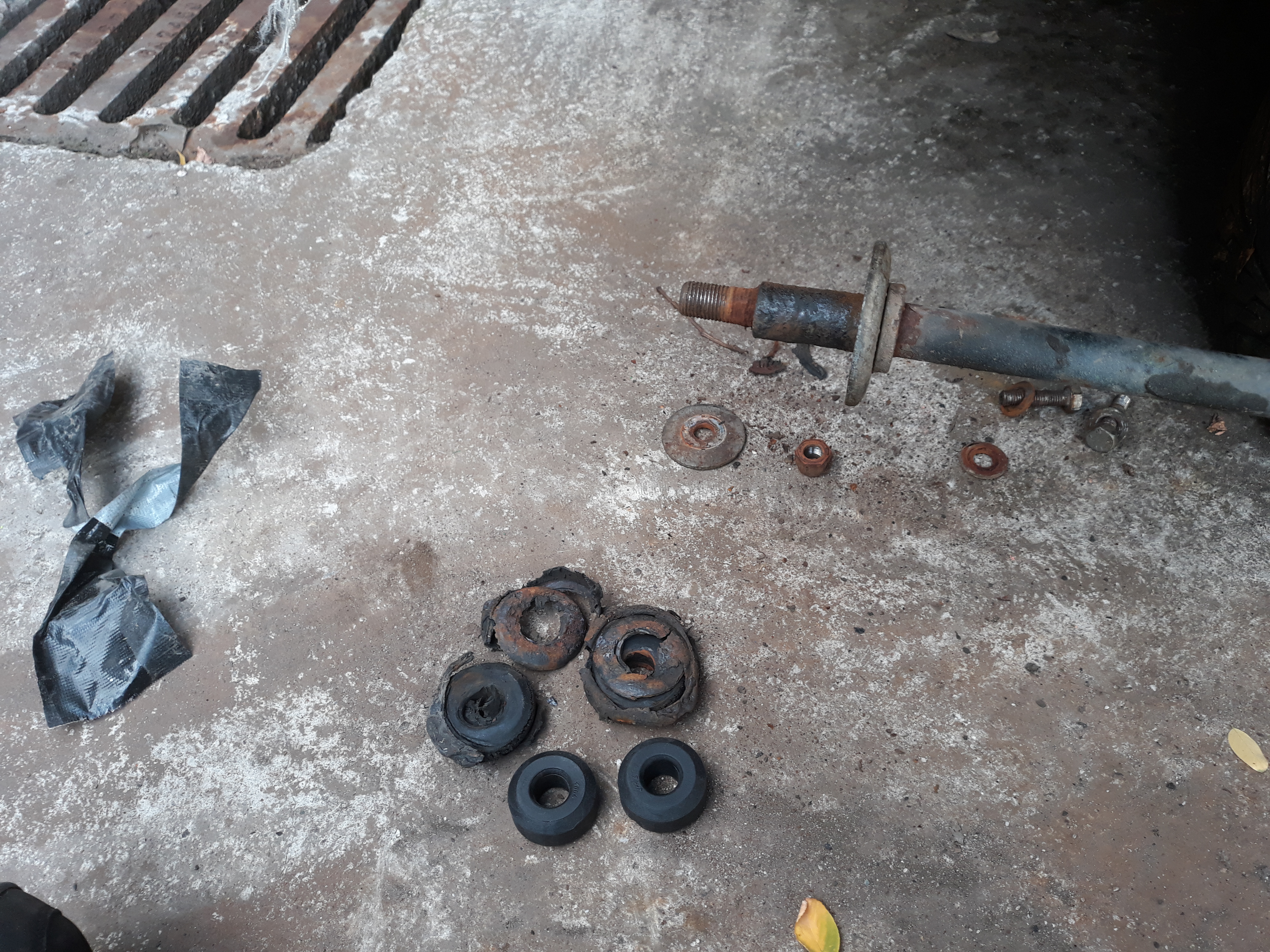

well in preparation of the whole getting it back on the road thing i have replaced those worn bushes.. boy they were bad.. yes i did tiger seal them last year and it worked relatively well to get it through last years MOT.
enough is enough however.. fix and replace!
they were ready!

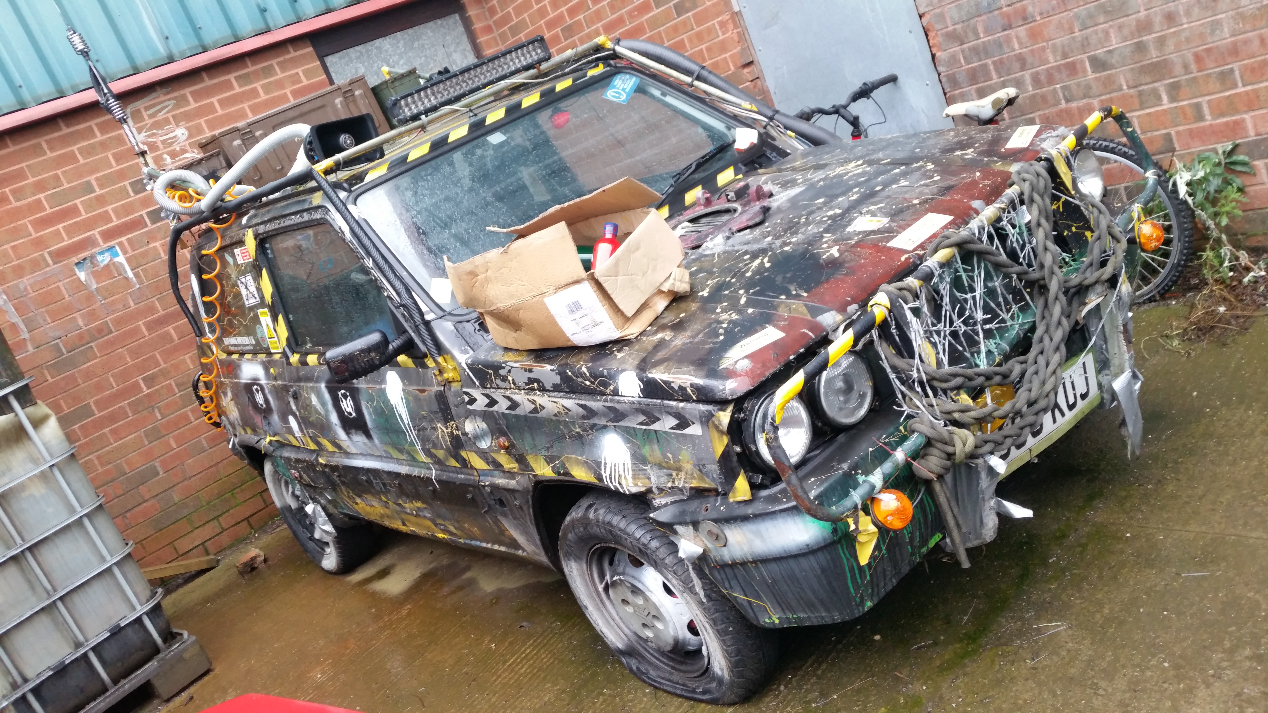

heres some pictures as i know you guys like them :)

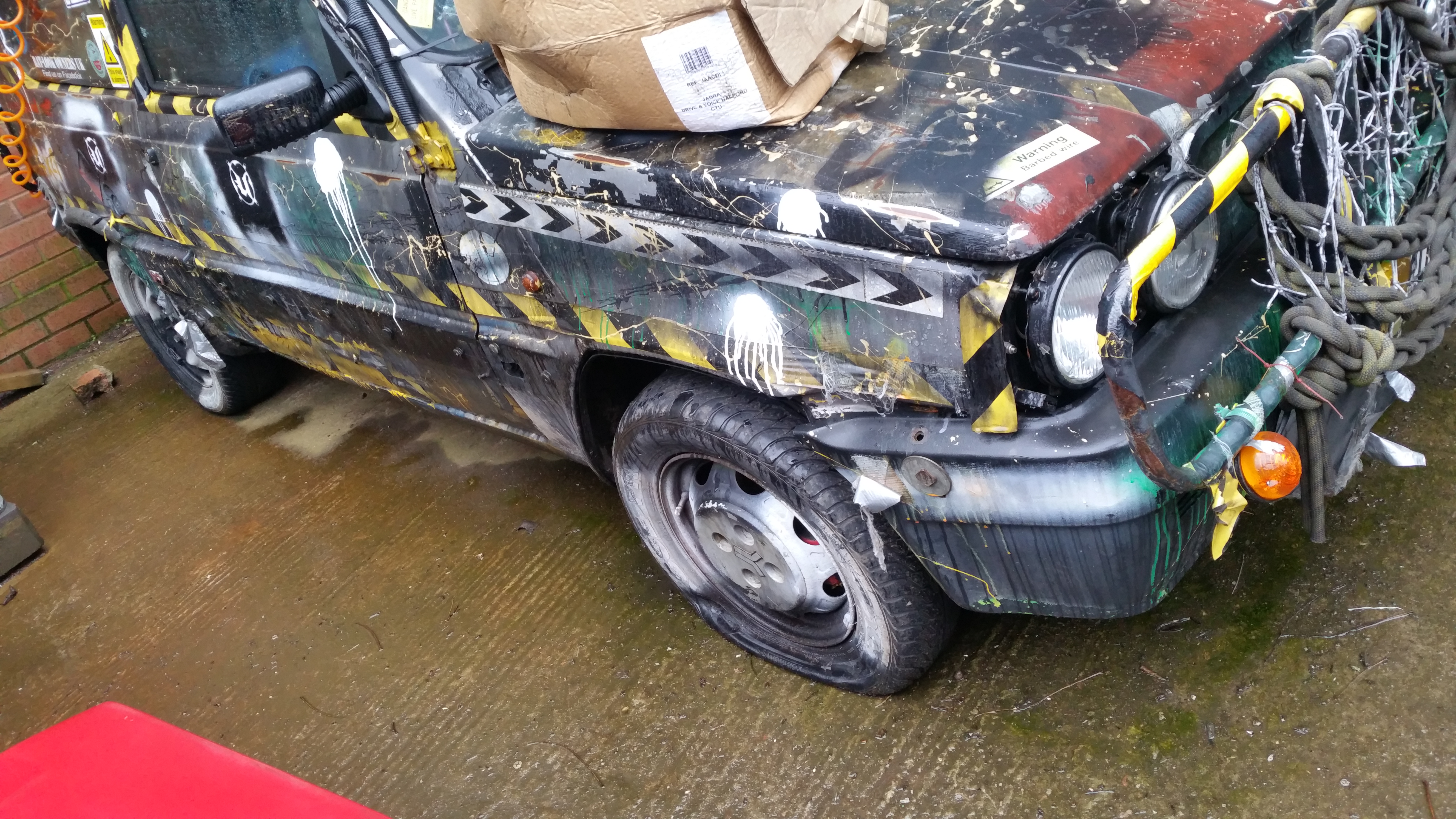

oh no.. flat tyre
raided the skip at the back of halfords and managed to grab some old mixing paint they put in the colour matching spay paint machine (brother tipped me off that they were in it)
and this is how Ratchet looks now. a bit of a mess with that plastic stopping the rain getting in, but after removing it.. it will be fine for MOT
the pallet on the roof is because its had "ford bins" (metal bins we use in the scrap yard) stored on top of it.
should be good for another year given the MOT will go smooth.
