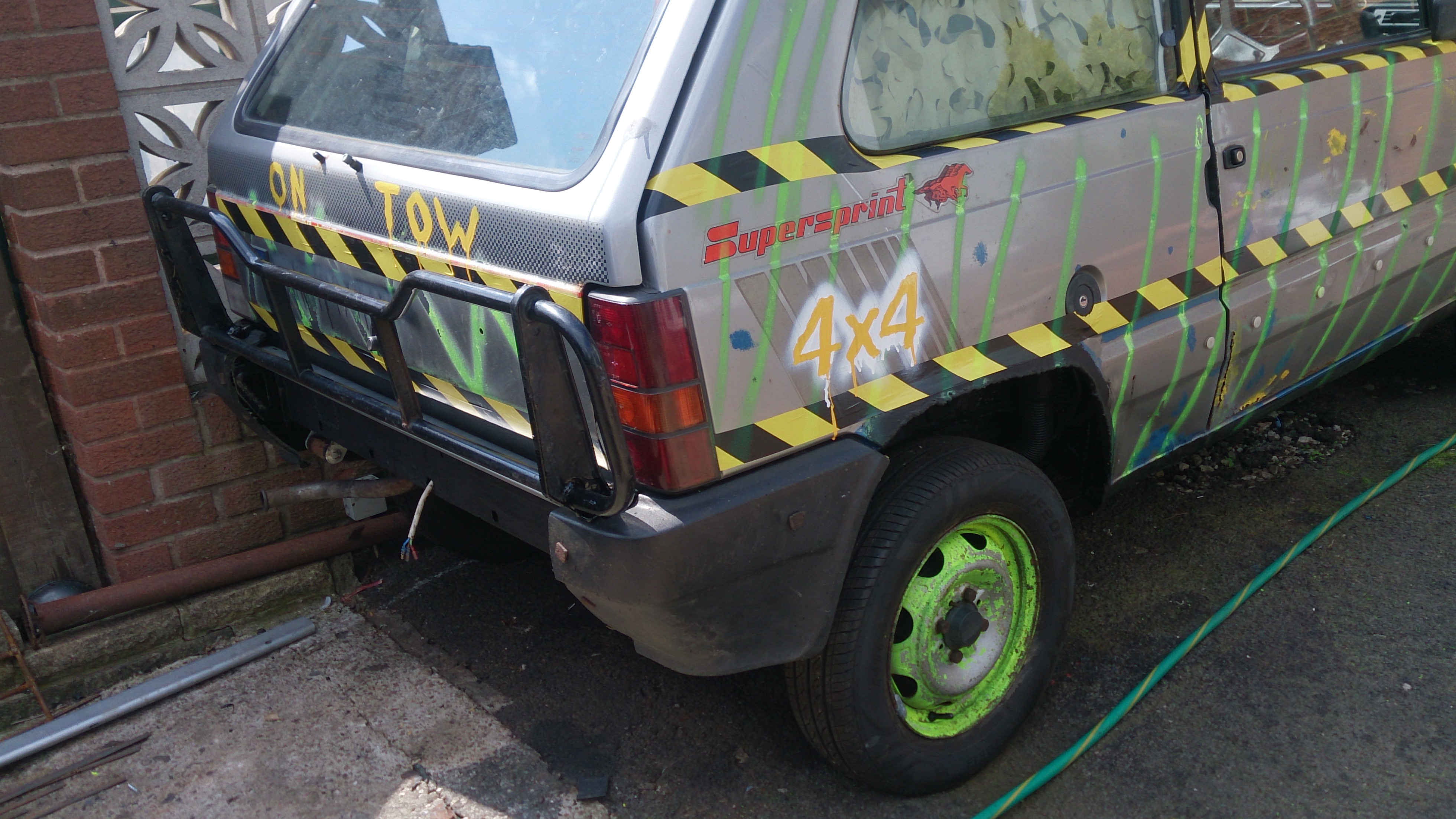

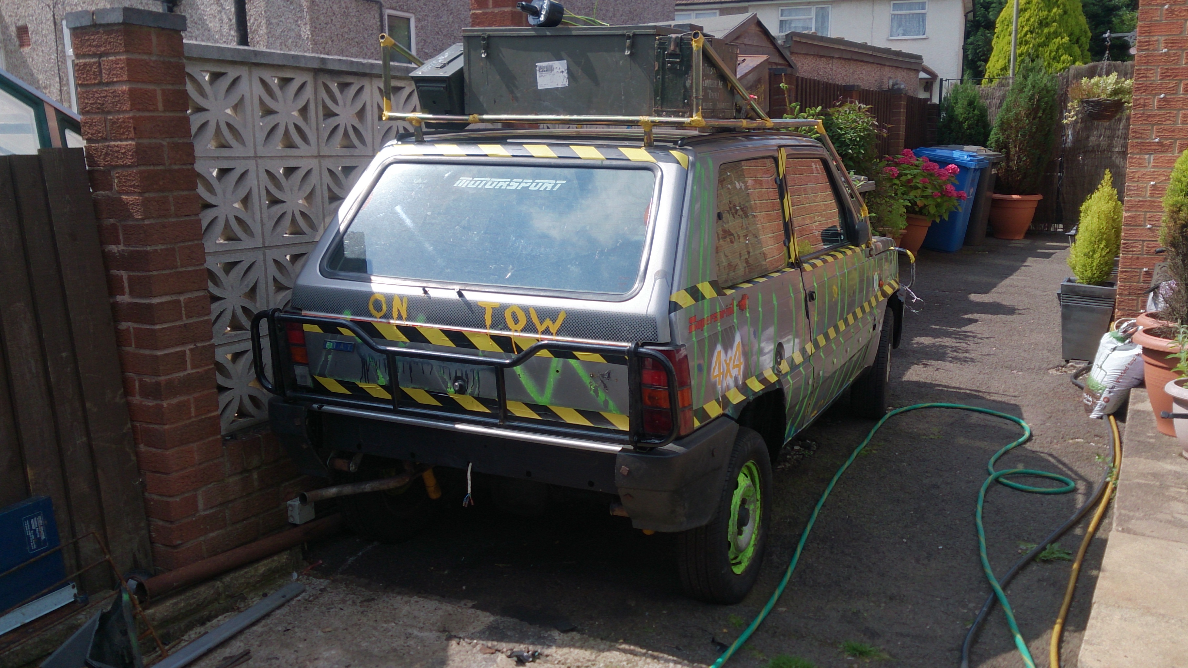

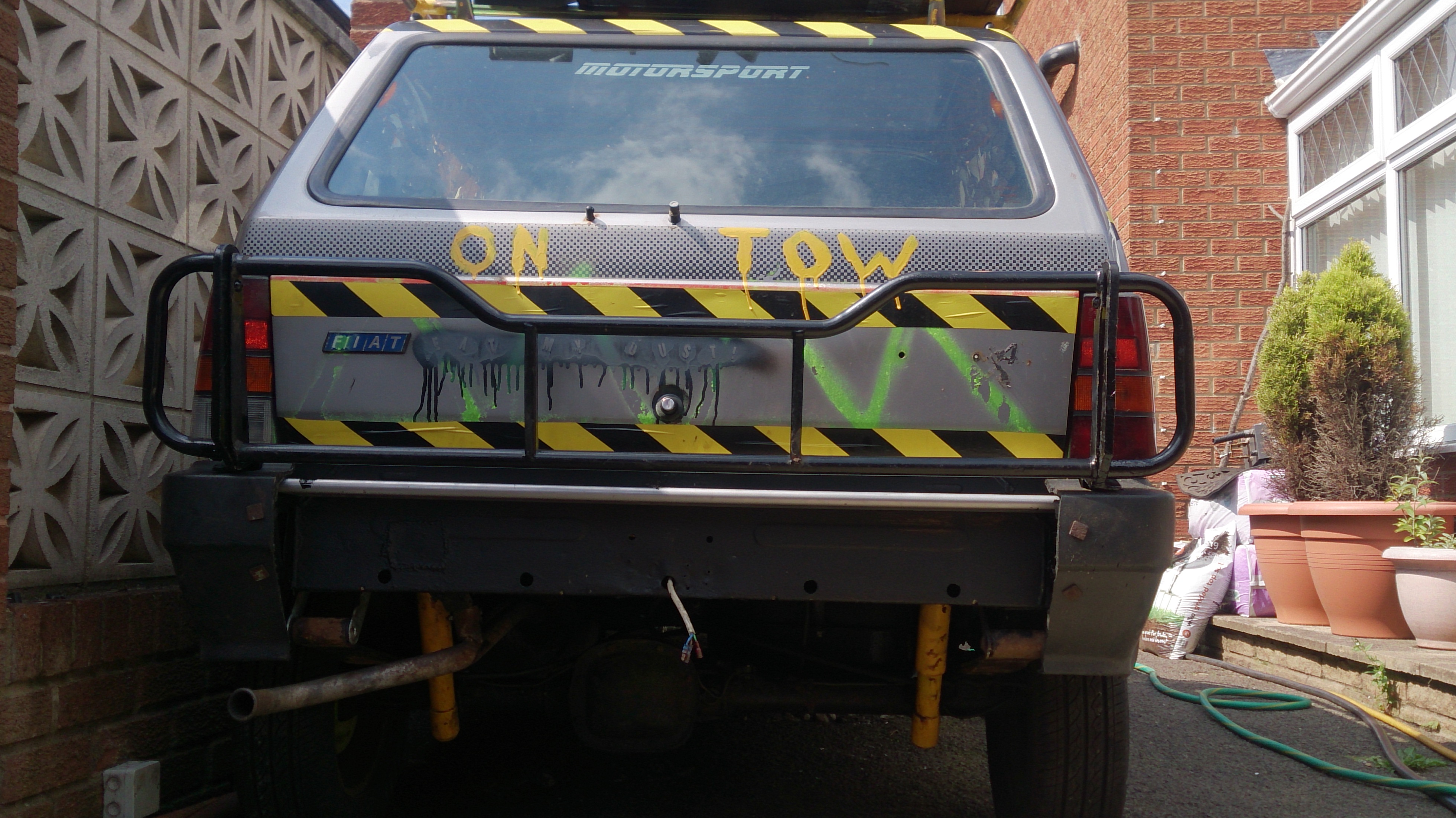

First off. i need to get the panda all well and good.
a few things are broken... the exhaust, the front suspension on the passenger side, both rear dampeners are rusted out, the doors are shot but i will try to fix them, the gear stick is really loose and all the roller bearings have dropped out, the wiring is a mess (mice attack!), there are no brakes.. and i mean no brakes, and lets not forget the underside rust.
so today i started by stripping out everything inside the car to get a good look at the floor pan and clean it all out (Dragon Man style!) i found the usual rust: the boot floor is a mess, but easy fixable, a seam has gone just behind the drivers seat anything forward of that seems to be OK, and the back of the sills are just gone so i will need to rebuild that.
the engine runs.. the vac advance line has split so its a bit rough on tickover but it seems good. the fuel tank seems good.. all the 4x4 stuff seems good.
i have go a few pictures took free by a professional photographer! (or should i say someone with an epic camera :p)
Here are a few picture, but please check out >This Album<

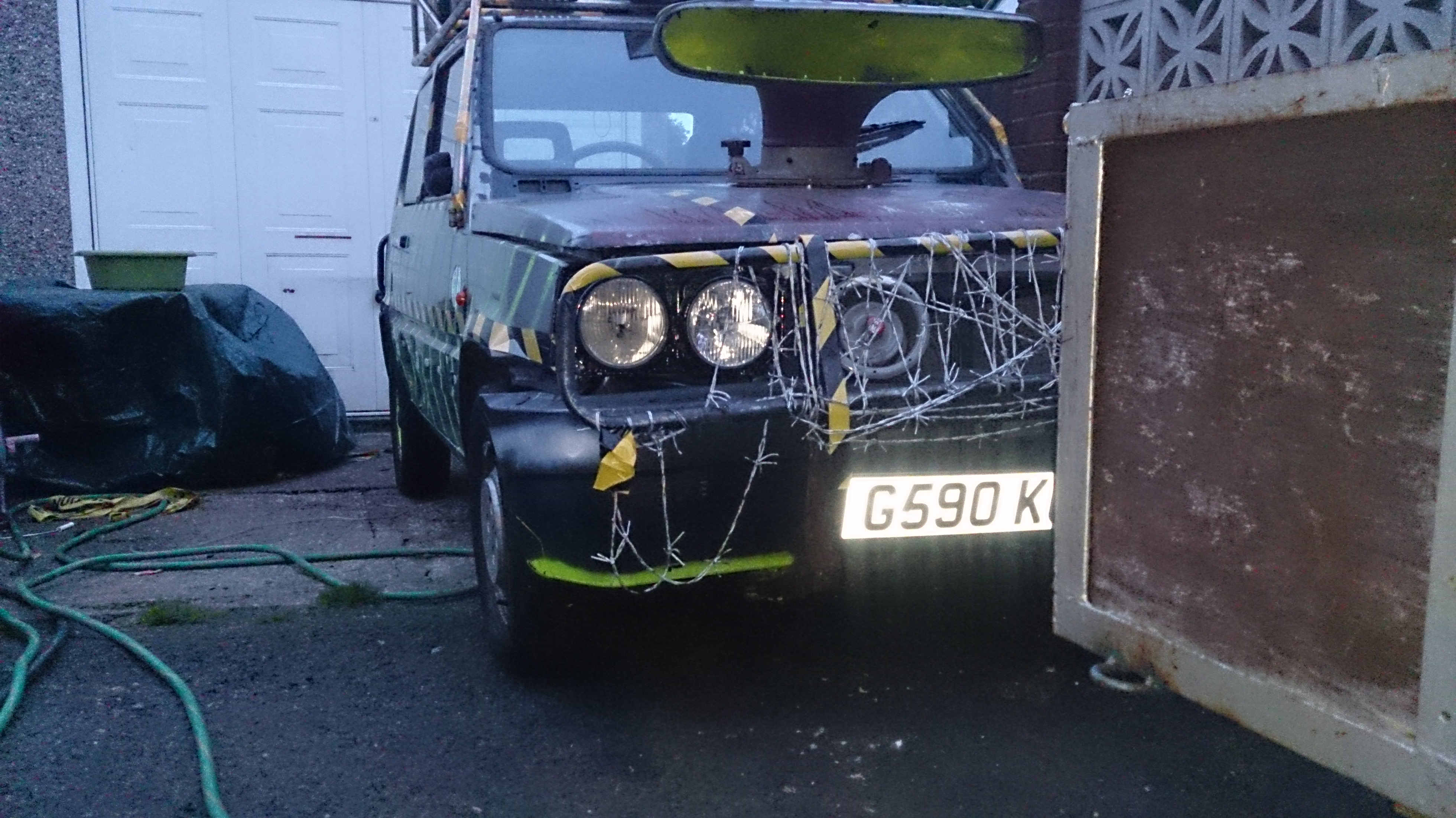

its going to be nice having 2x 55watt bulbs over the standard single 55w? bulb :D
Won't be legal to use like that on the road to the best of my knowledge, you need to read up on lighting regs, will be covered under max bulb wattage vs light output. You'll effectively have 220 watts of light which isn't permitted from memory.
Yep, ECE Reg 48.
Not to mention Reg26 for External Projection.
I've just lost the plot here- what is the point of carry on with more and much severe modification ? That will not make insurance company happy as you can dazzle oncoming vehicles etc.
i am not sure what original bulbs the capri mk3 uses.. i just assumed that it would be 55w 12v H1 bulbs.
unless the low beam headlamp completely turns off when you put the high beam on.
its something i will have to look up.
i cant see how the head lamps can dazzle on coming vehicles.. unless ALL mk3 ford capri's dazzle on coming drivers... :/
The headlamps are integral to the design of the car, from the height of the vehicle to the distance they are apart.
If the adjustment is in them to compensate, then yes, it is doable though.
ahh i should be fine then. if i wanted these headlamps can be adjusted in many directions getting them to point in the right direction will not be an issue.
i already checked this ;)
