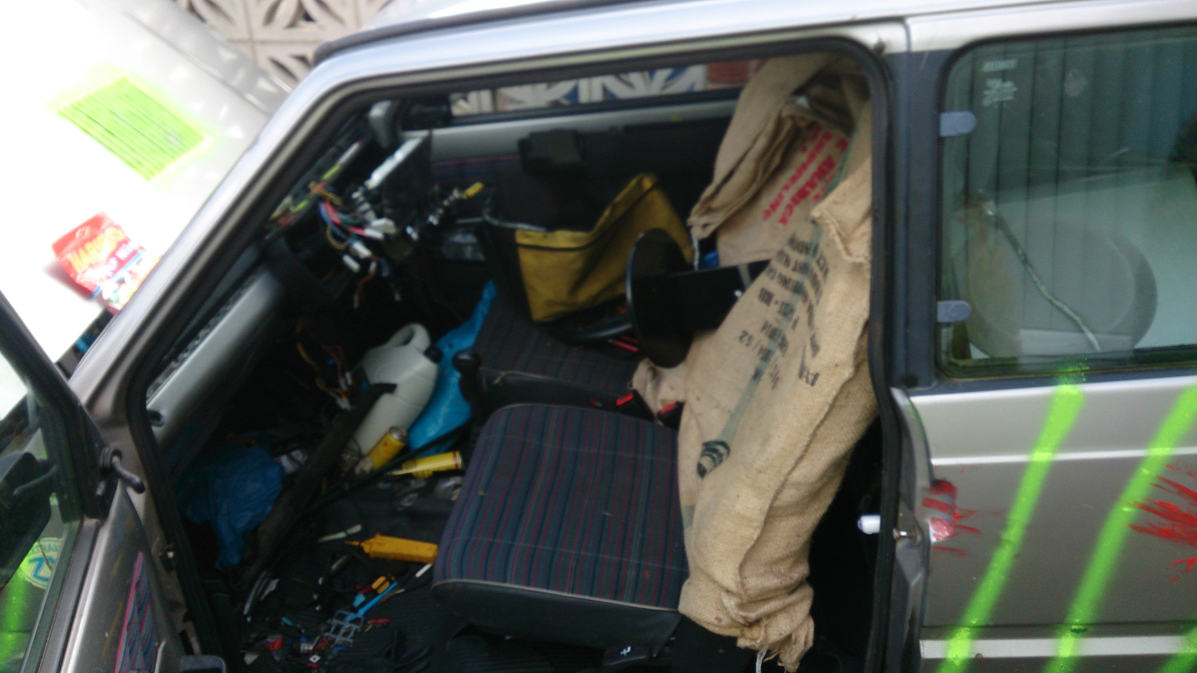

so today i started by stripping out everything inside the car to get a good look at the floor pan and clean it all out (Dragon Man style!) i found the usual rust: the boot floor is a mess, but easy fixable, a seam has gone just behind the drivers seat anything forward of that seems to be OK, and the back of the sills are just gone so i will need to rebuild that.

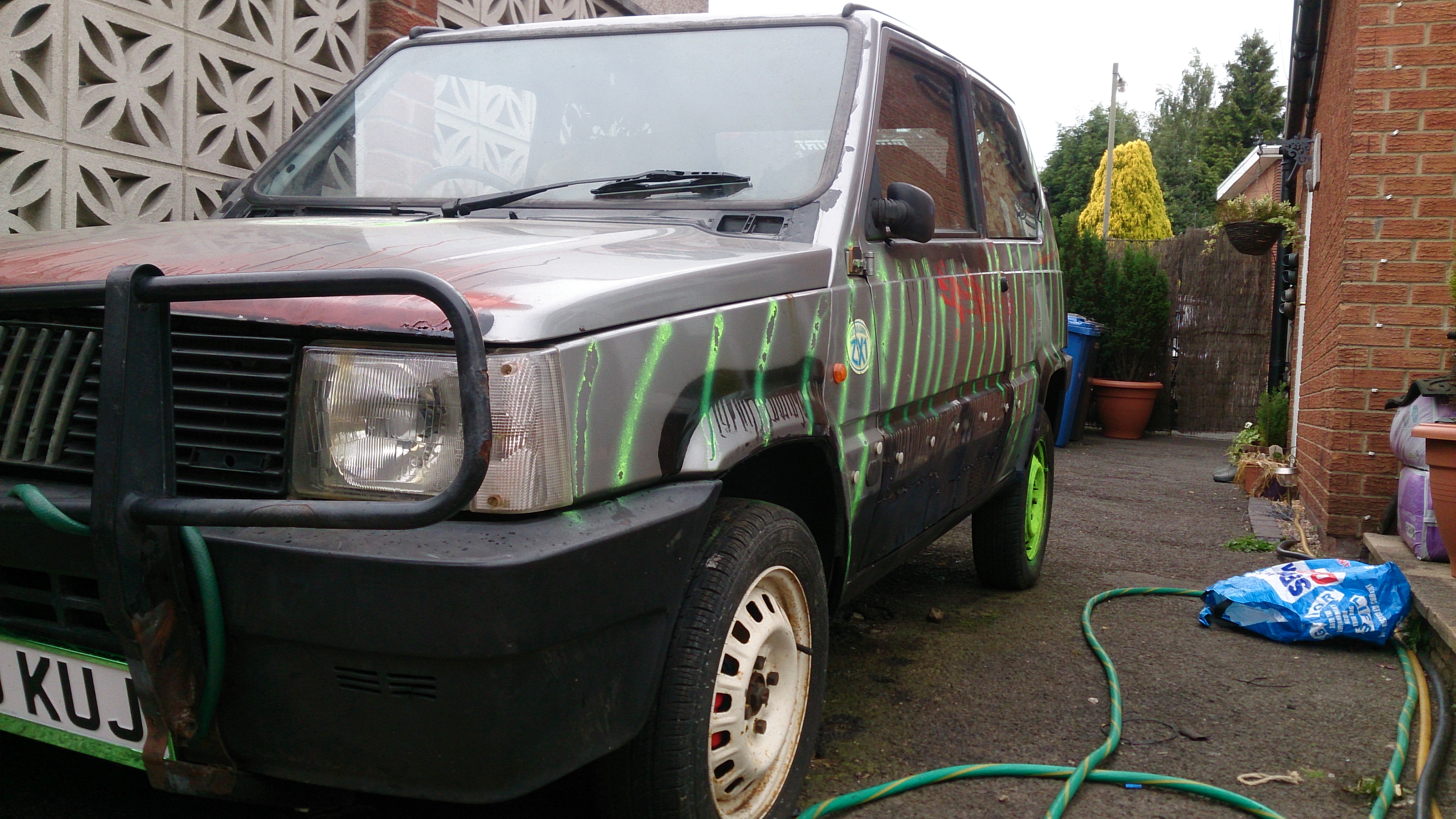

This is how it looks now: :eek::eek::eek: :slayer::slayer::slayer:

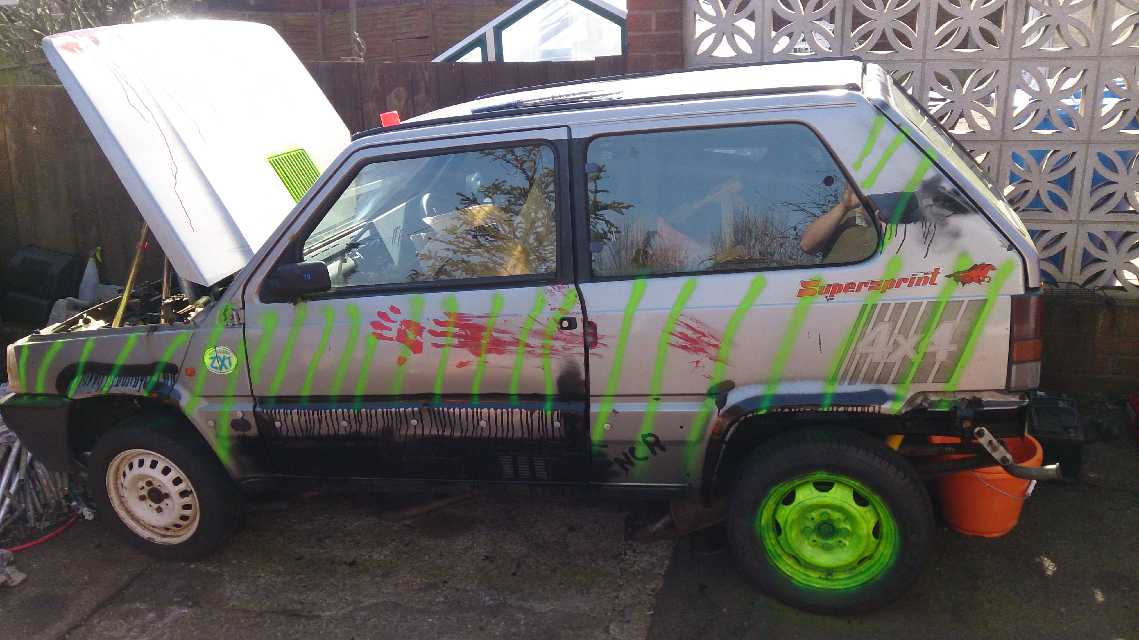

we had a nice warm day today so i did a tiny bit of work on fallout.
well mostly cleaned him out a little so i could get into the drivers seat lmao

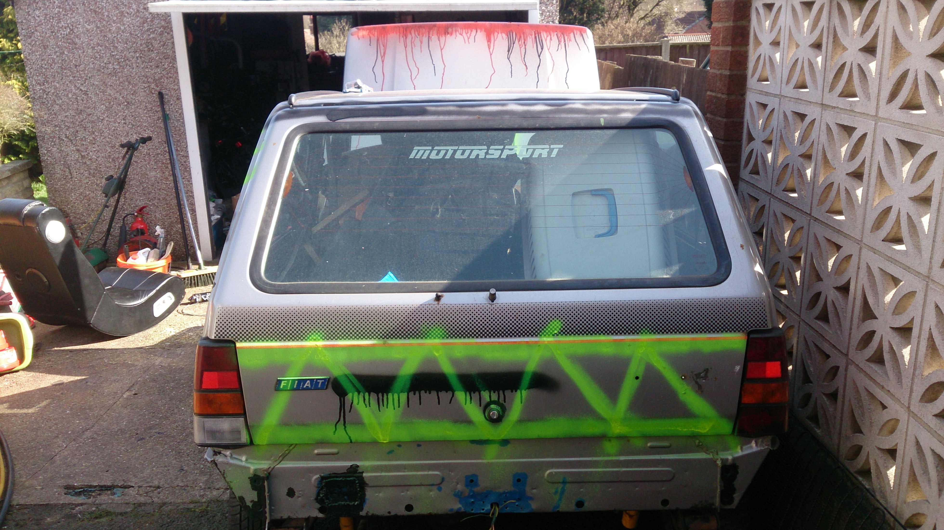

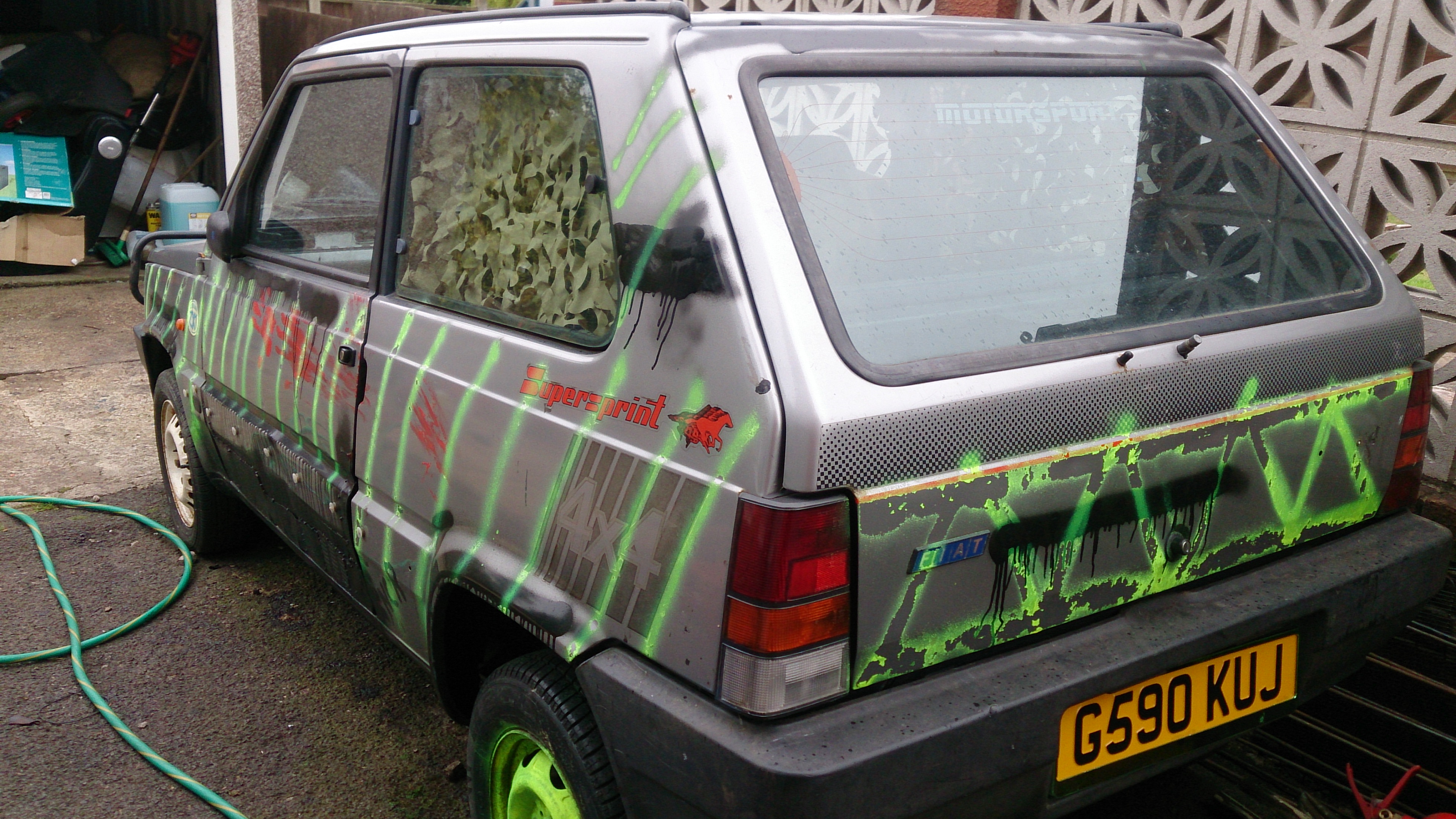

i did however had a bit of a accident with some spray tins.. :/
those of you who love pandas i recommend to look away...
so the first not so bad picture:
yeah.. and now this one..
heh yeah..
and now this..
like i say insane..

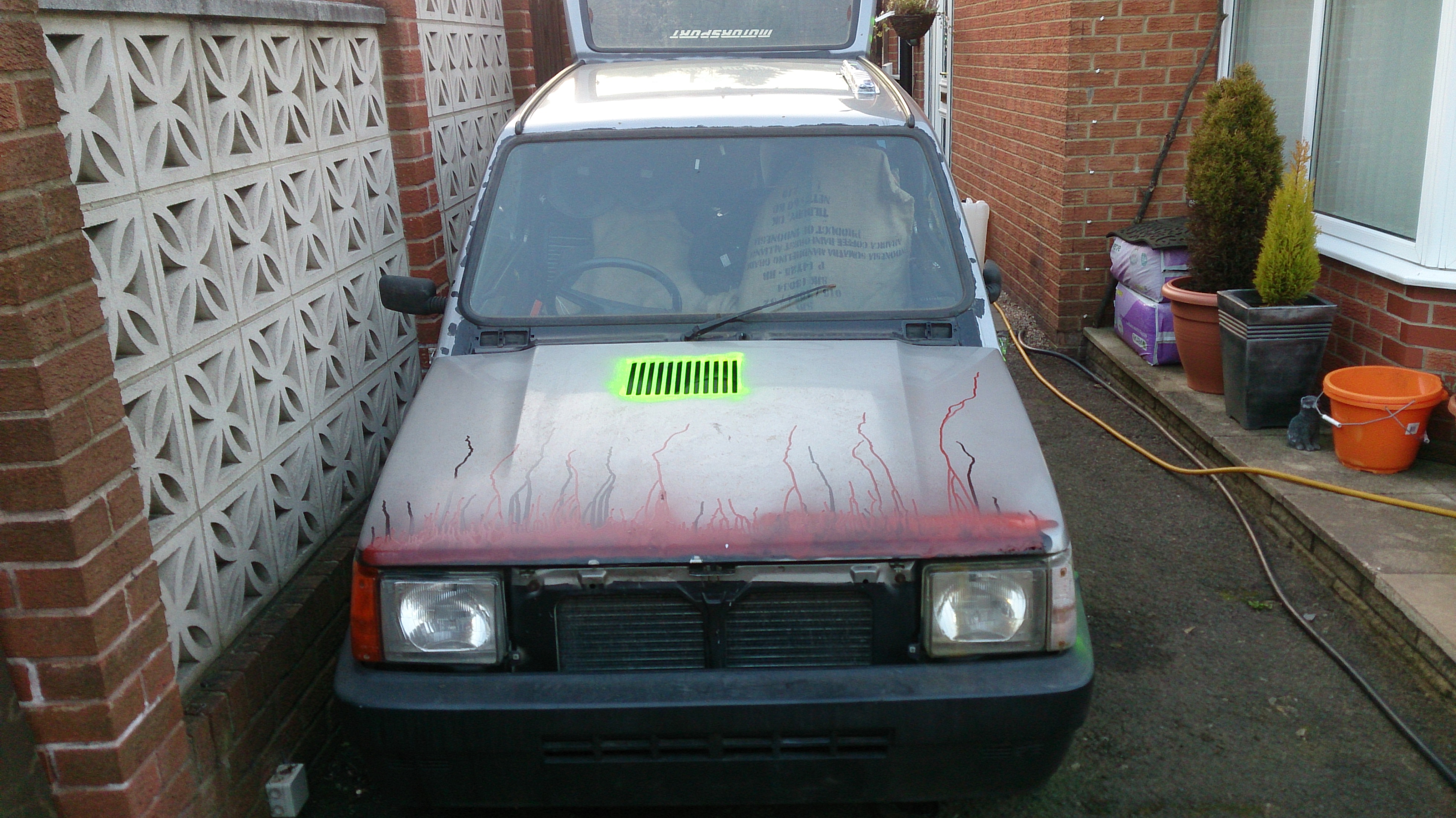

hey guys. i did a bit of tyding around fallout. getting him and the work space cleared up a bit so i can get in and start working on him.
i have fit the down pipe after modding one (as i stole the original one for Talon) and a good way through making another dog food tin swirl pot. (got this down to an art now lmao)

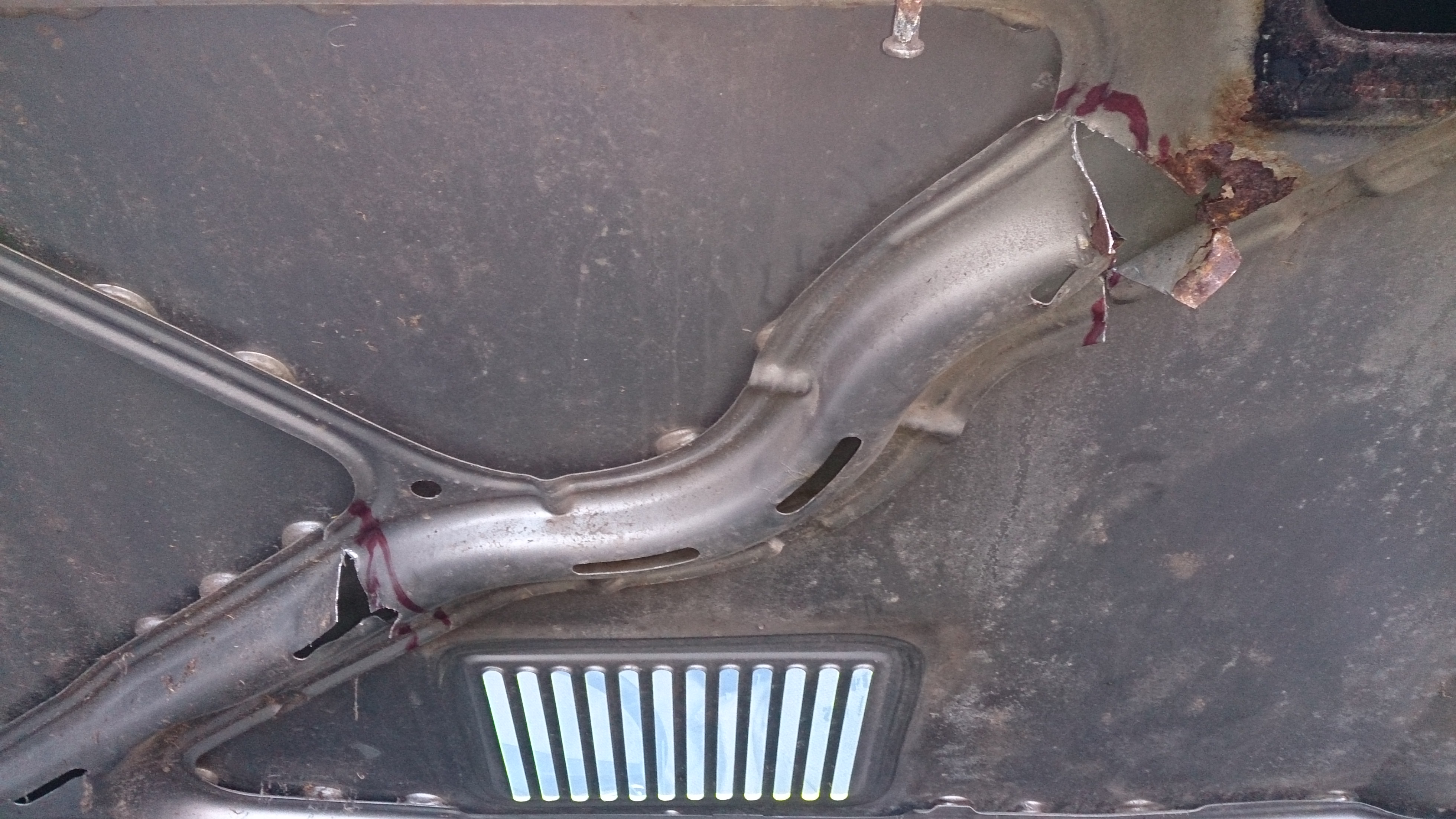

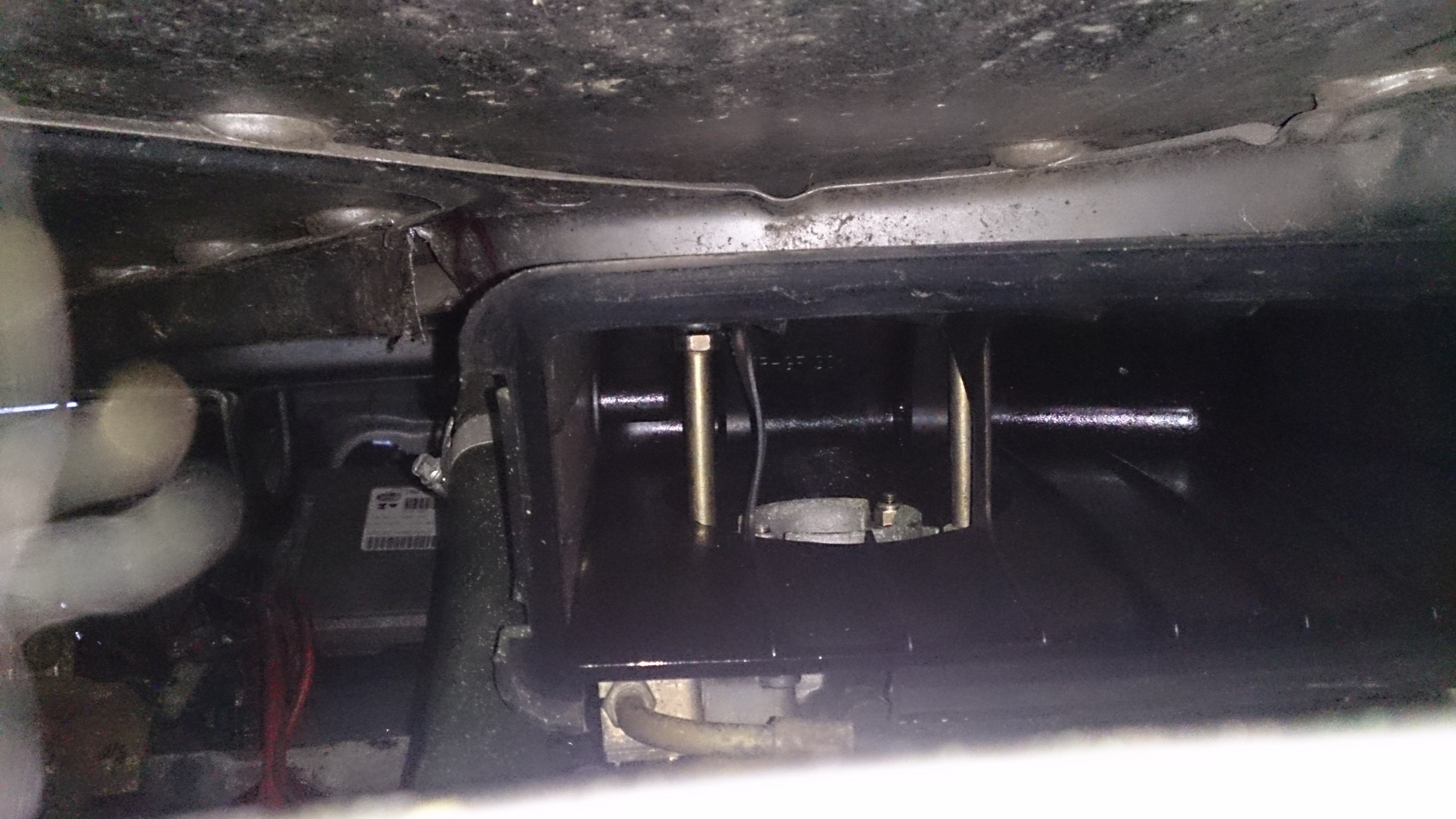

i have also cut out a bit of a support under the bonnet so i can get the original air filter housing on and still close the bonnet.
this is the filter housing.. a lot like the 999cc one just a bit bigger.
you can see how it hits here..
this is the support, i already started to cut it out here.
now its removed.
yeah looks good.

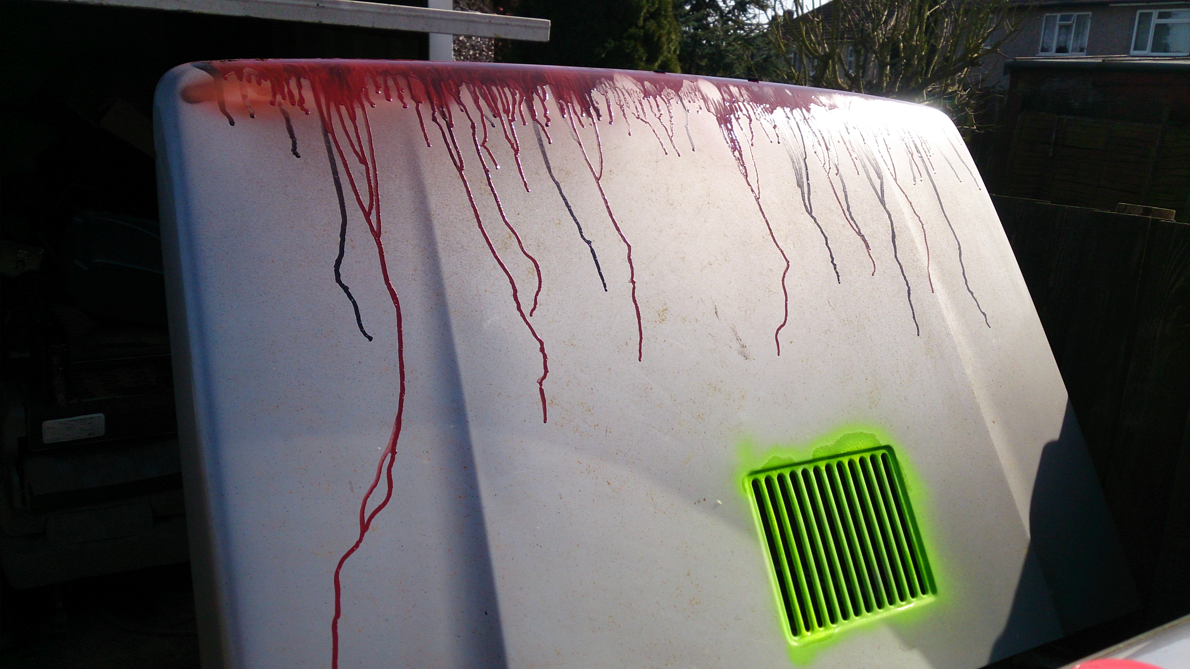

i quite like the effect of how the paint has ran down the bonnet.. i would not mind getting some more just to get some longer runs.

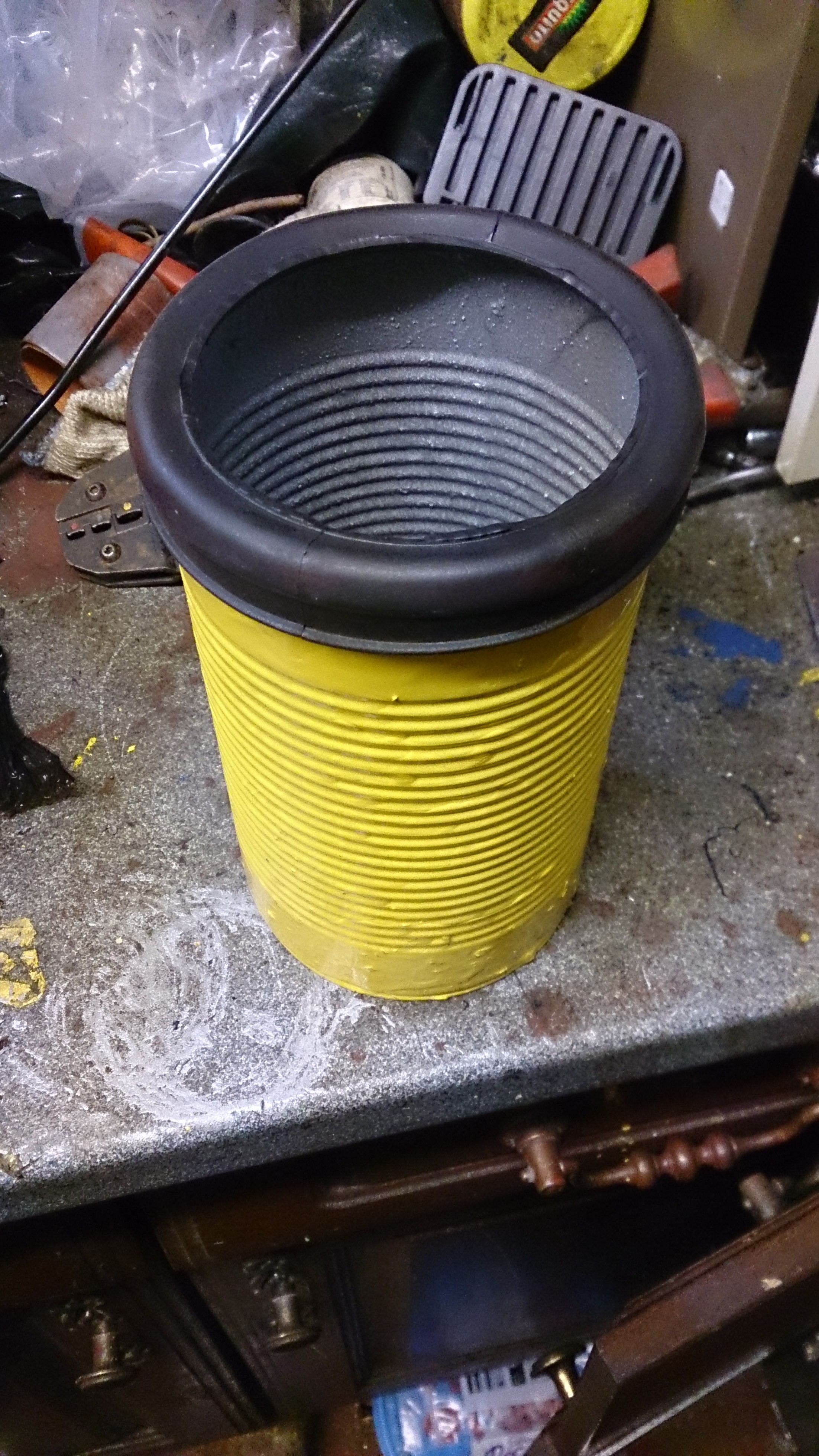

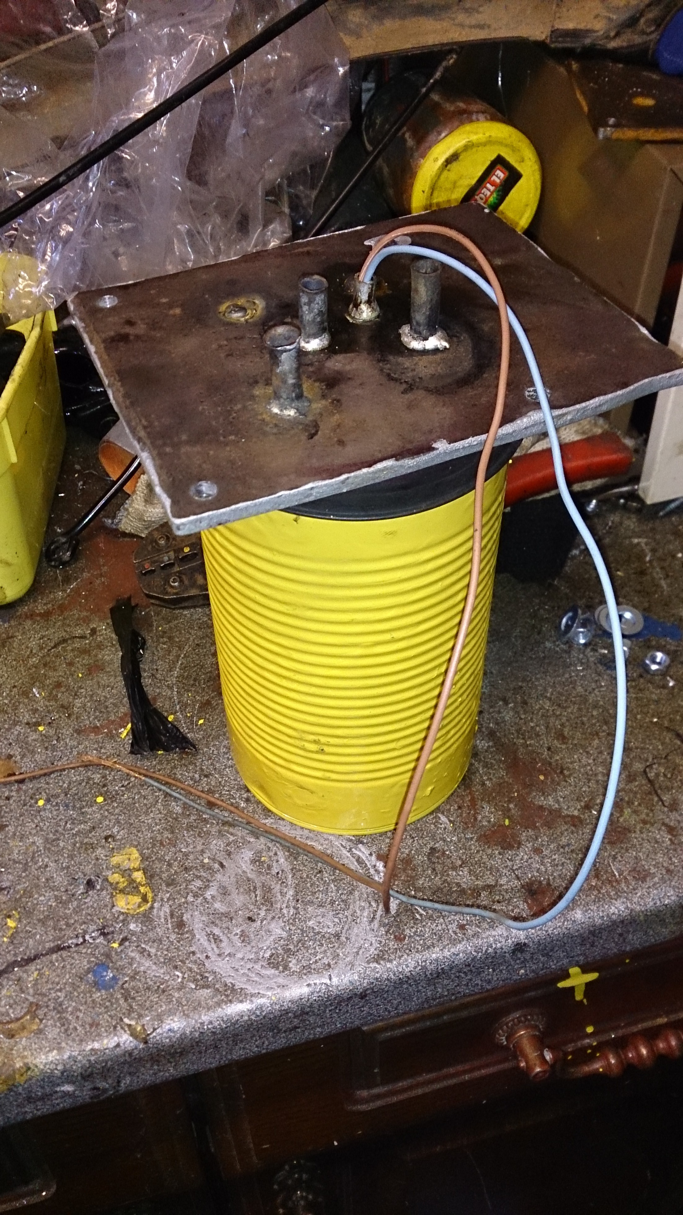

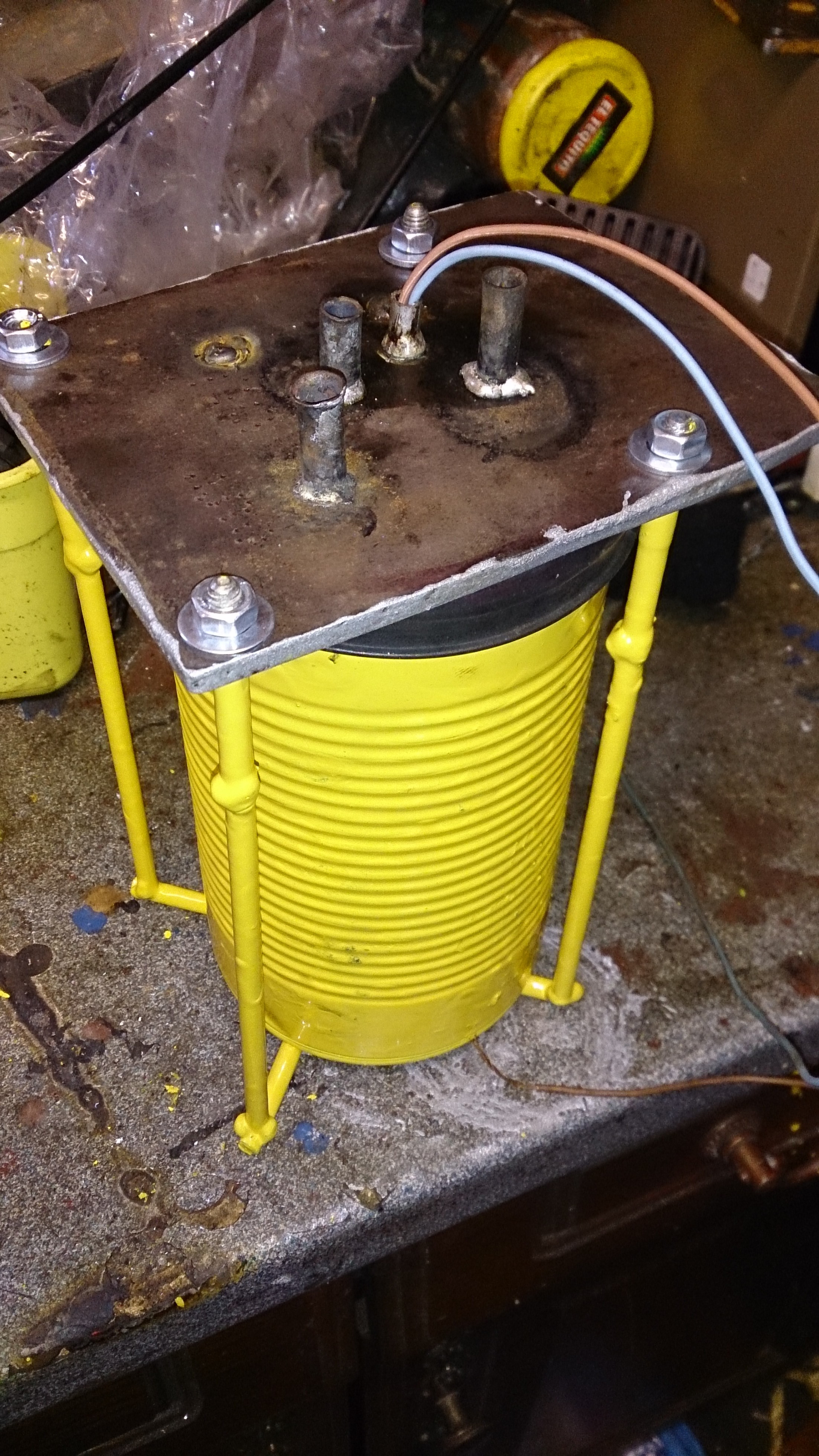

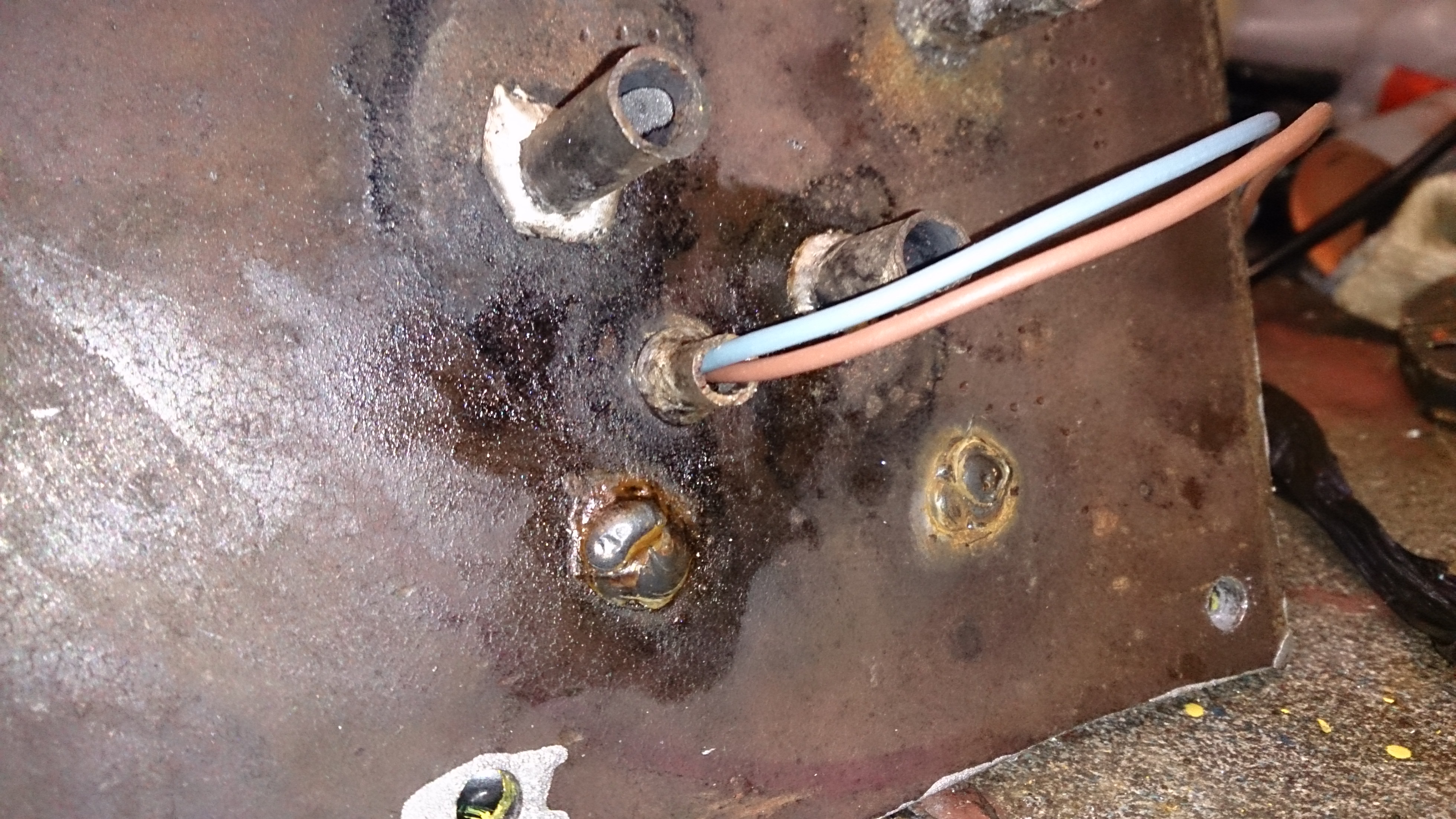

Well.. Swirl pot version 2 point 0hh is well under-way in the making.
heres a few pictures
again using the offcut from one of those universal CV boots for the top seal works fantastic.
gonna seal this with some JB weld

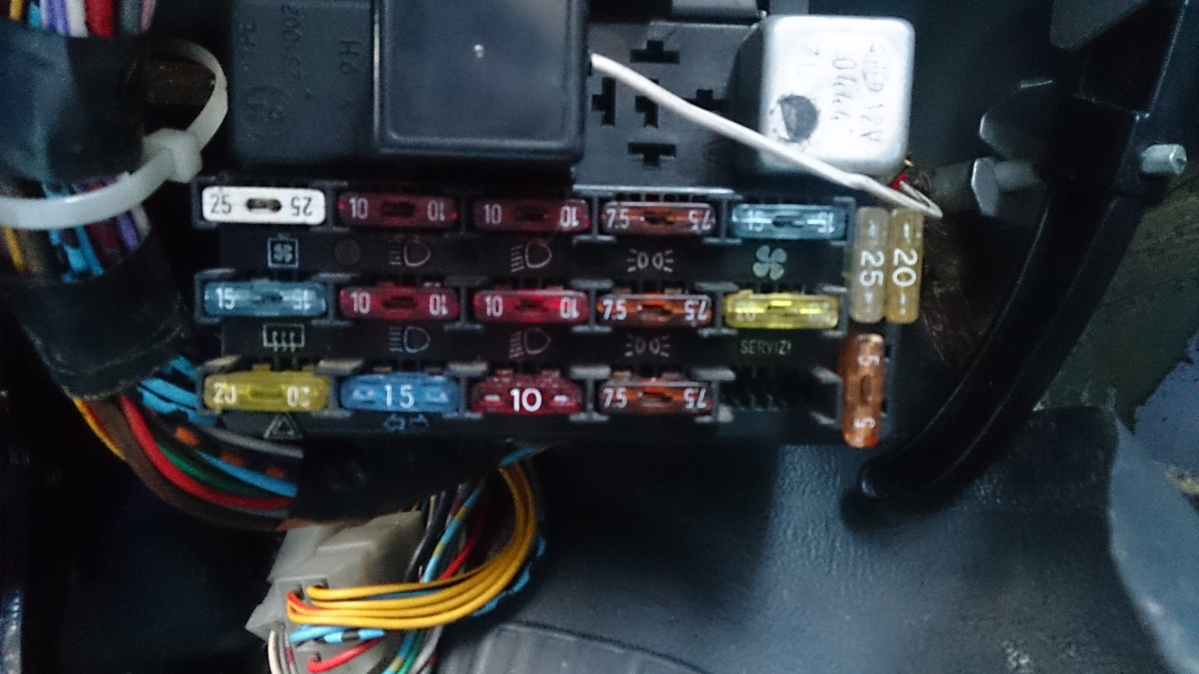

replace all fuses (pic ref)

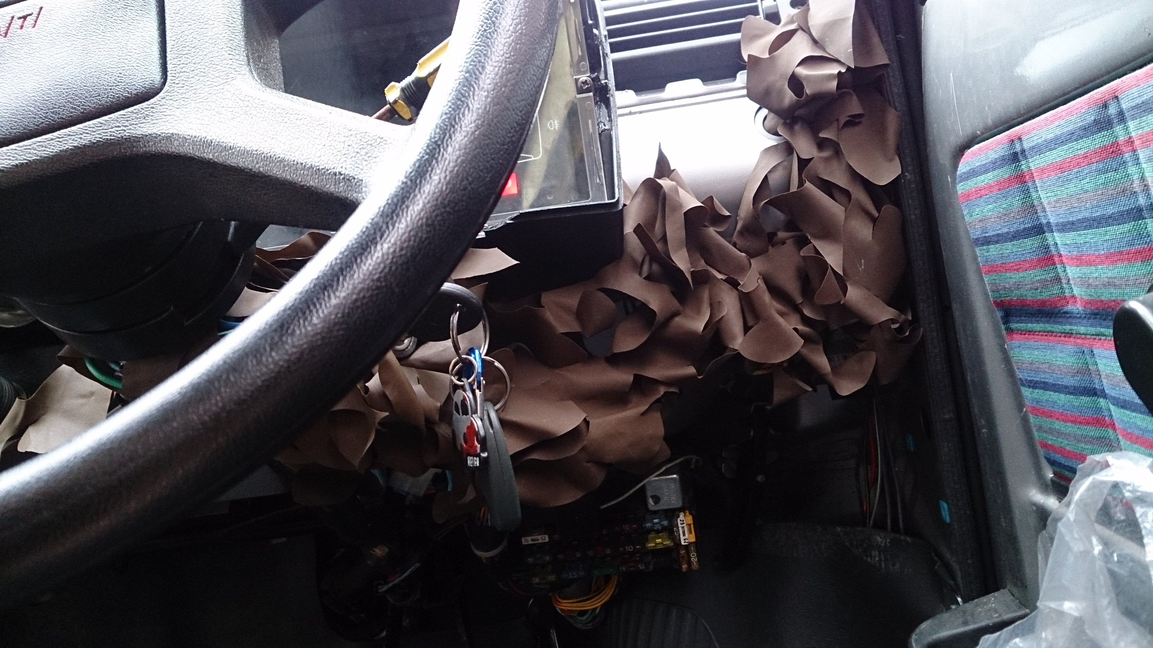

i found the instrument cluster/clocks so i have them connected up.. i have one of the bolts tiger sealing.. as the plastic it sits in had snapped.
sorry its blurry :/

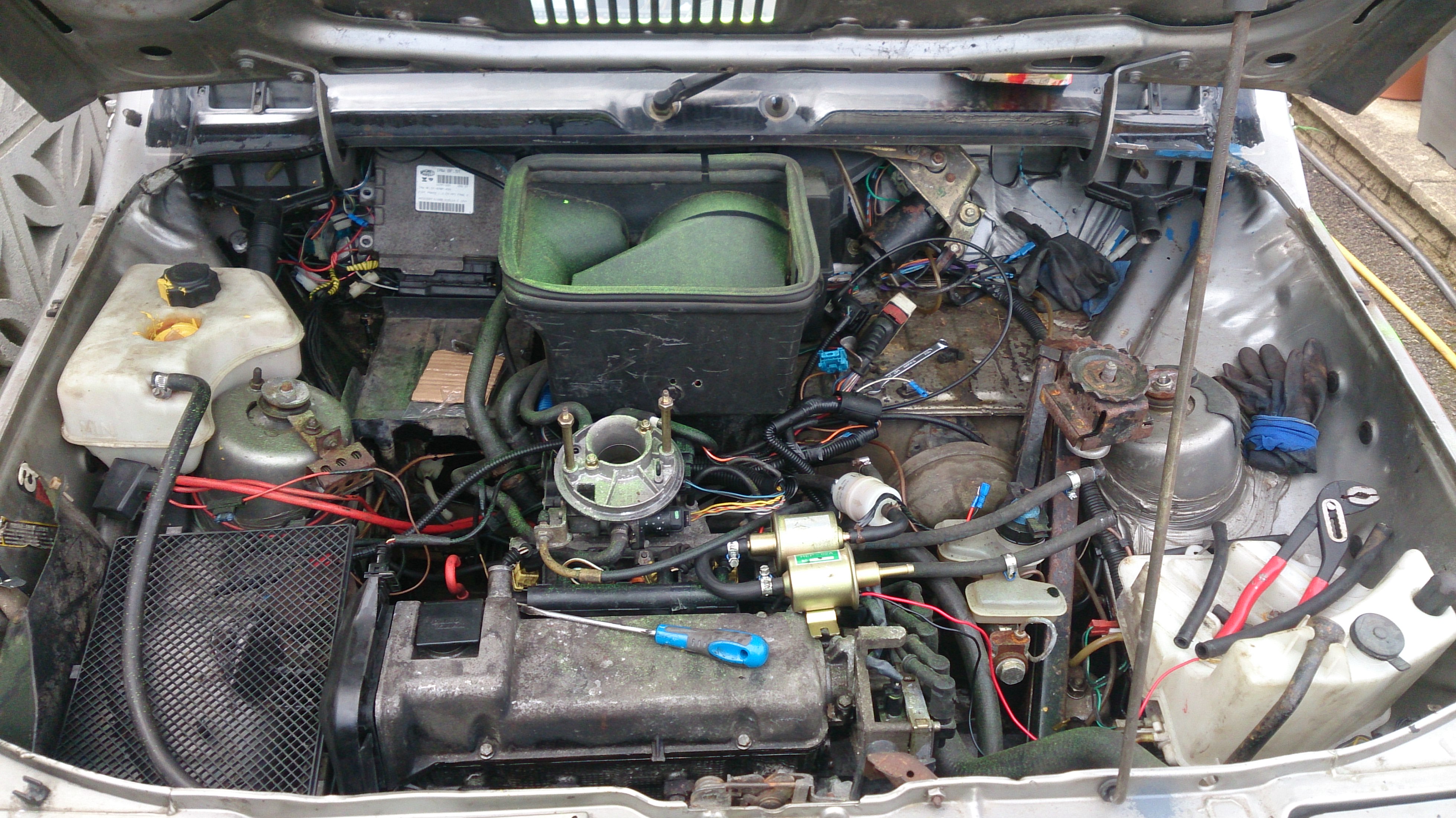

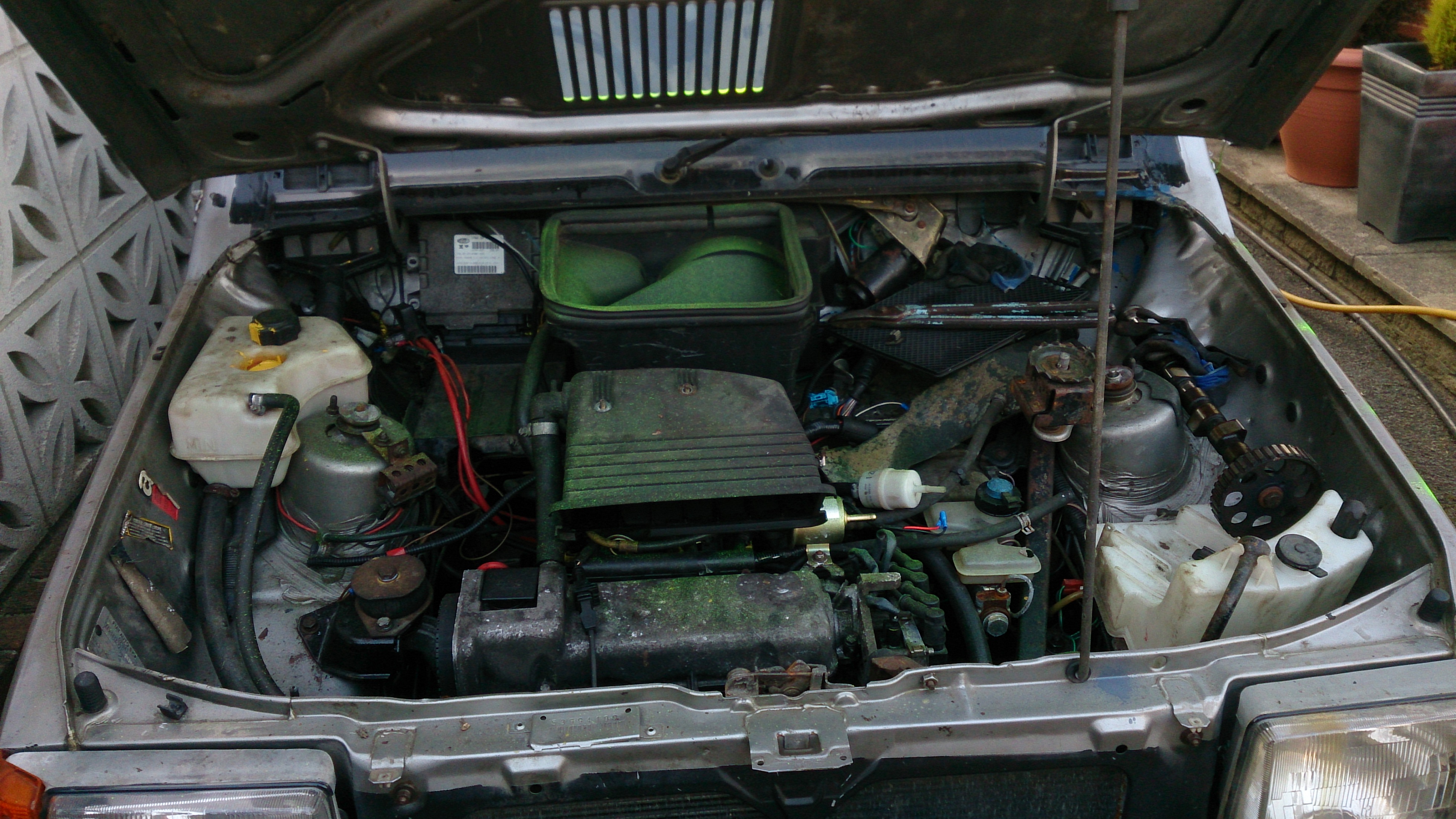

also here is a picture of fallouts engine bay for all who are interested.

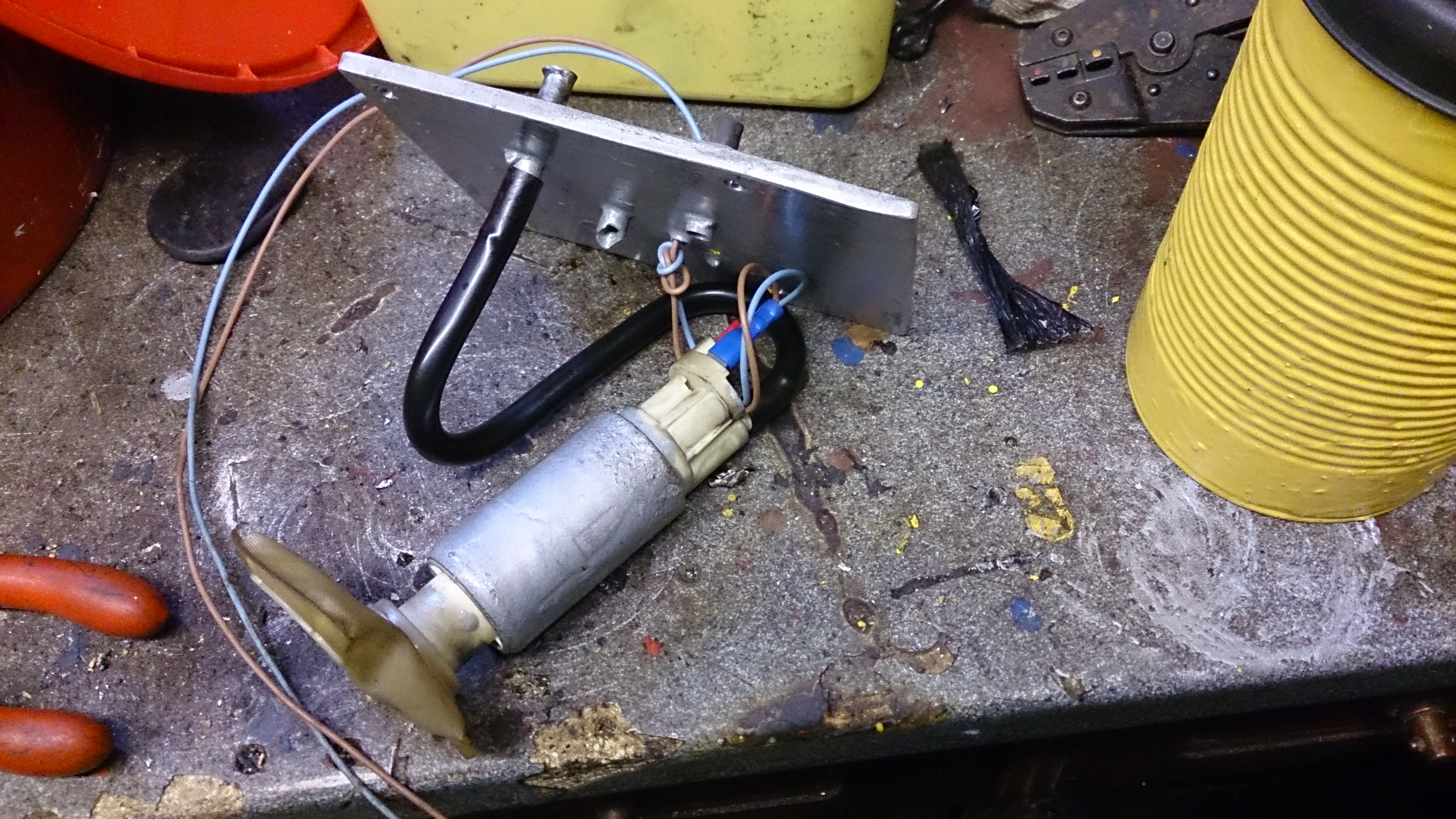

i dont have much faith in these Chinese fuel pumps so i have 2 connected in series. if one goes the other will still work. they are only to keep the swirl pot filled up but pretty important.

well its happened. Swirl pot V2.0hh has done the trick and it is running again!
my friend did a quick video on his mobile communications device which i grabbed off him and uploaded to youtube.
so here is Fallout starting and running once again:

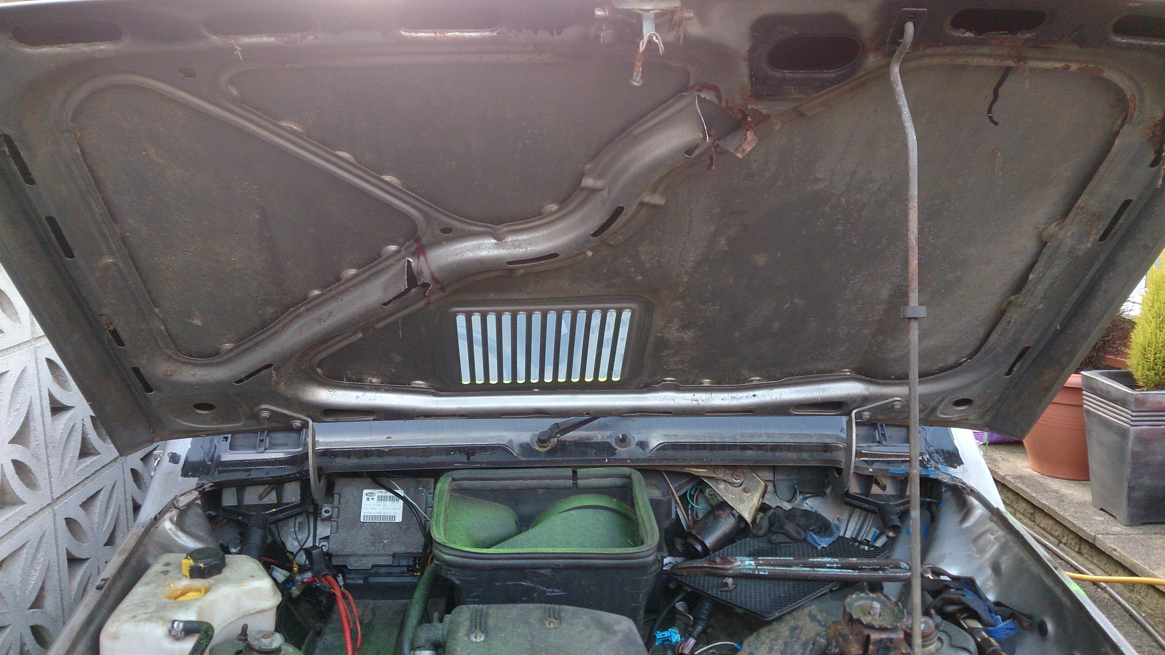

Fallout also has had an air box from off a cinquecento 899cc engine fit. its a little small but will suffice for now.

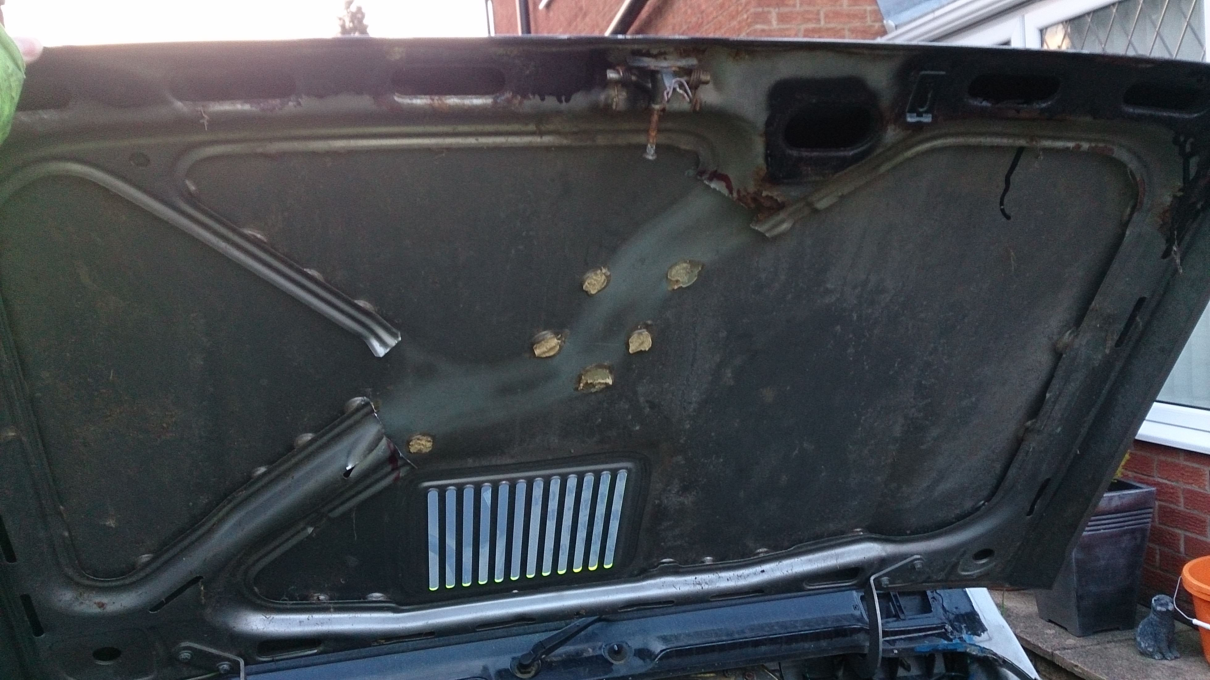

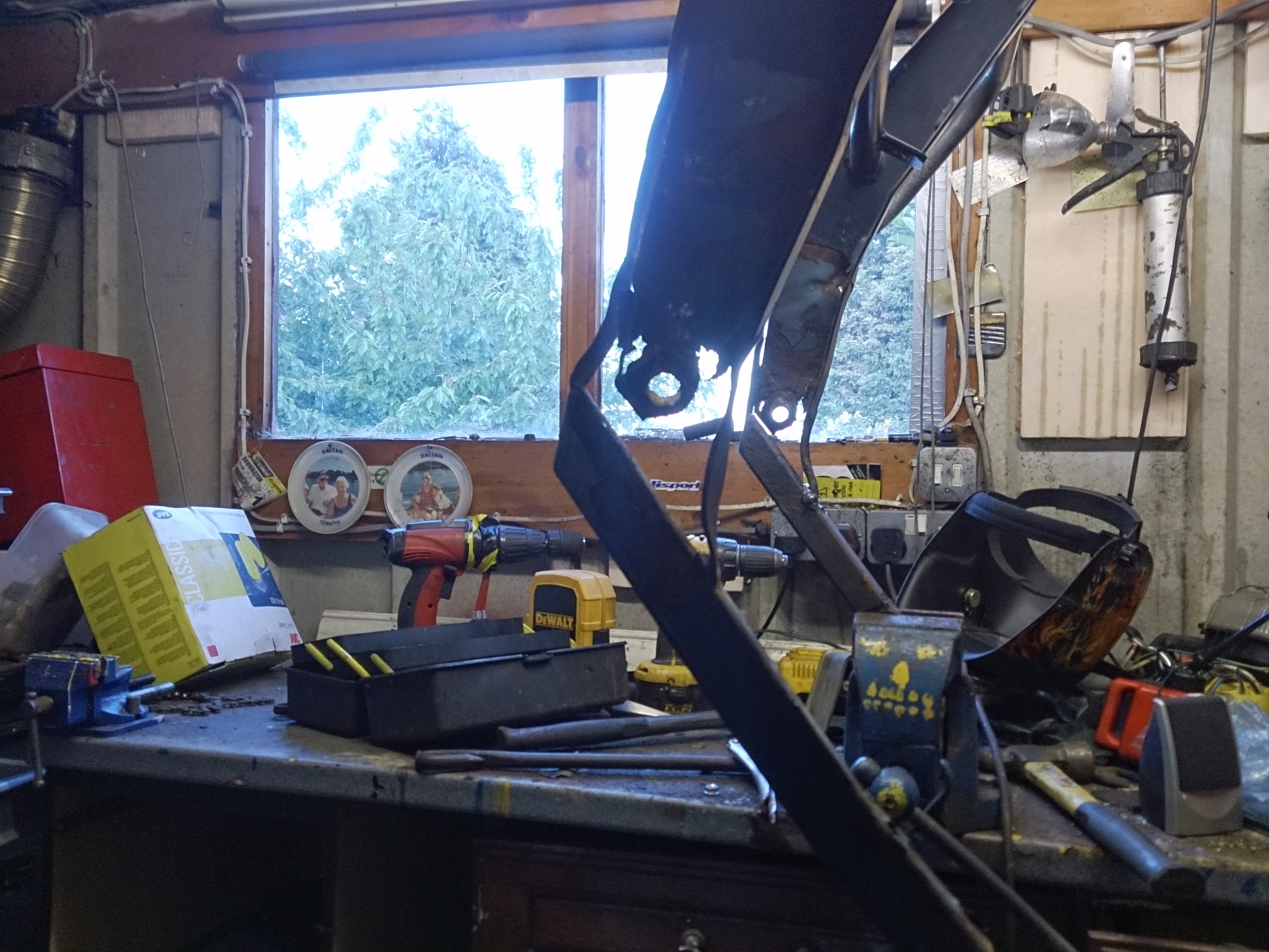

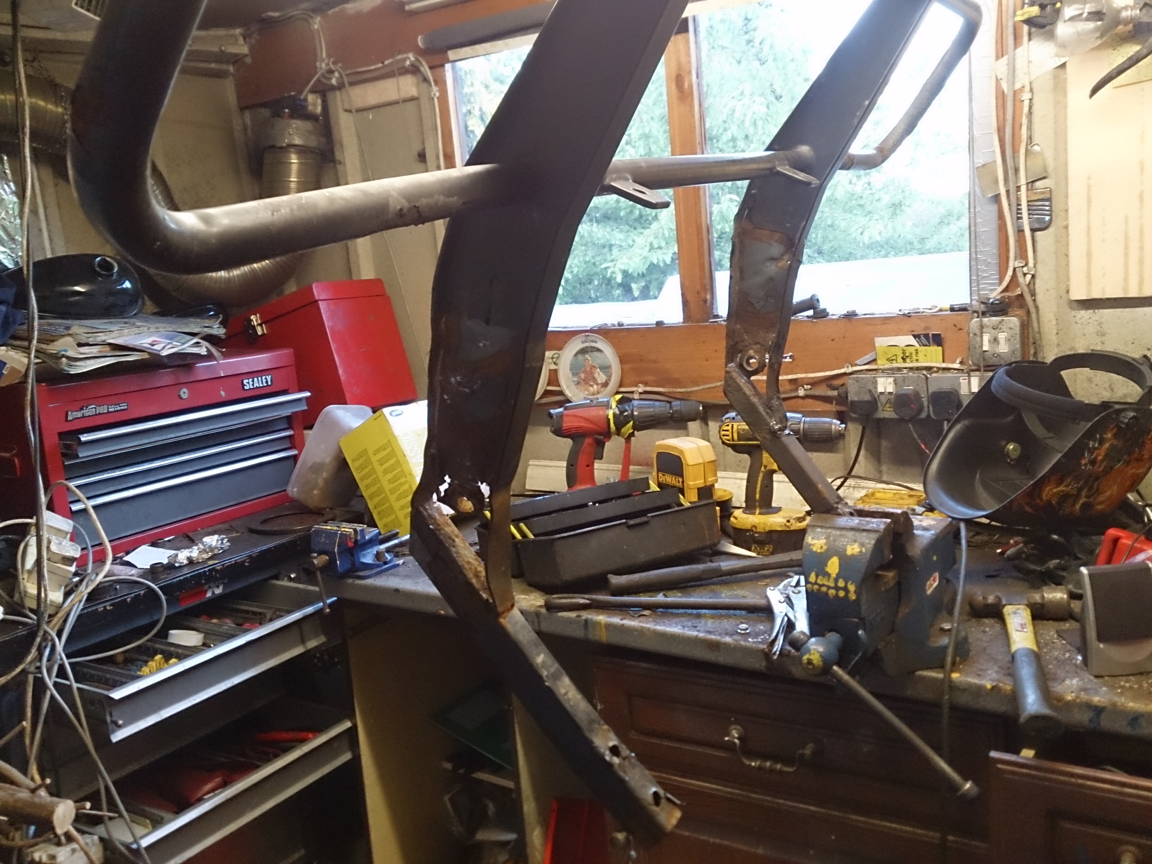

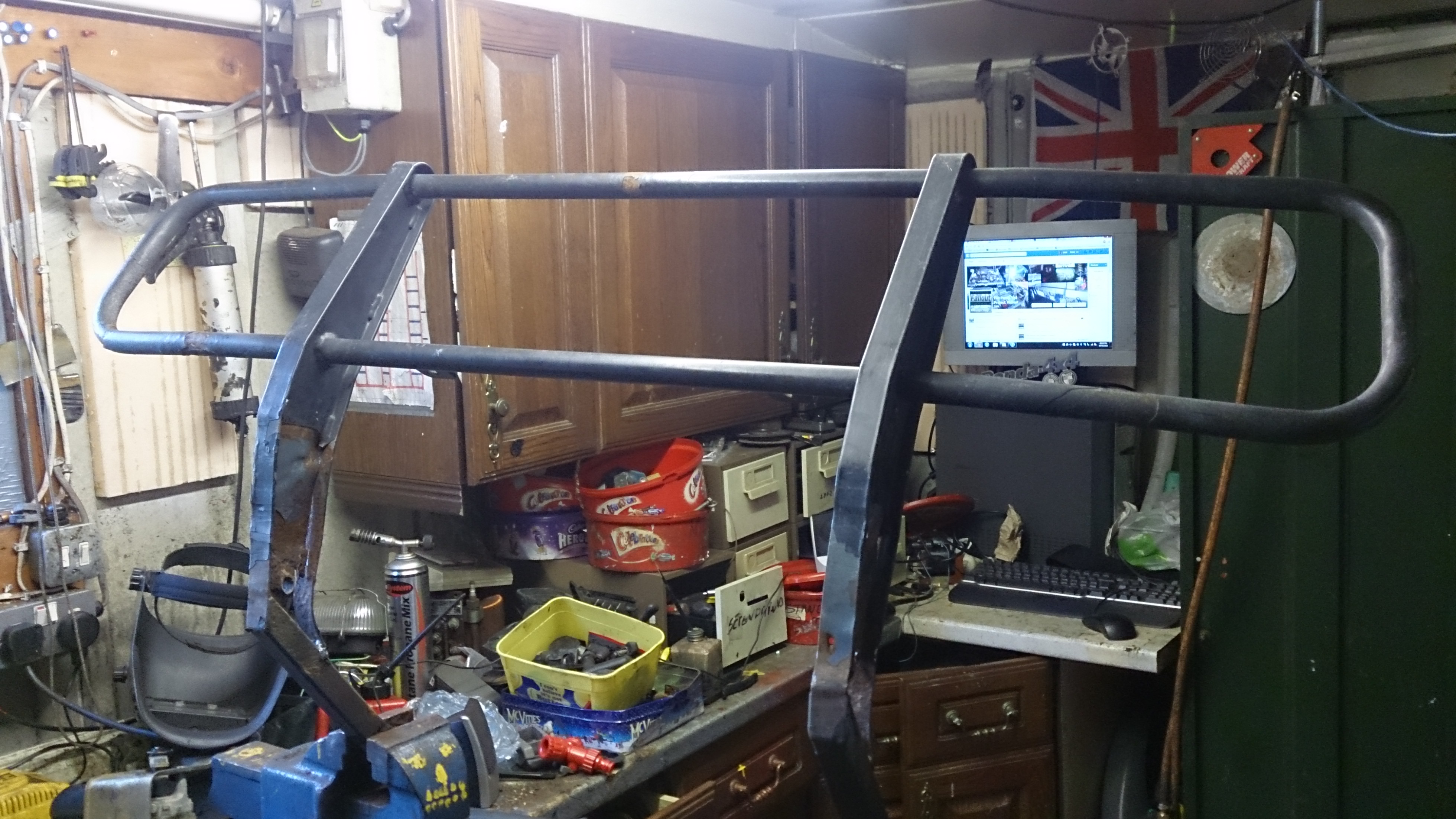

i had Mr. Andyholli visit me, he kindly donated Snach panda's old bonnet, bull bar, genuine panda electric window mechanism and some switches from out of a mk1 Punto.

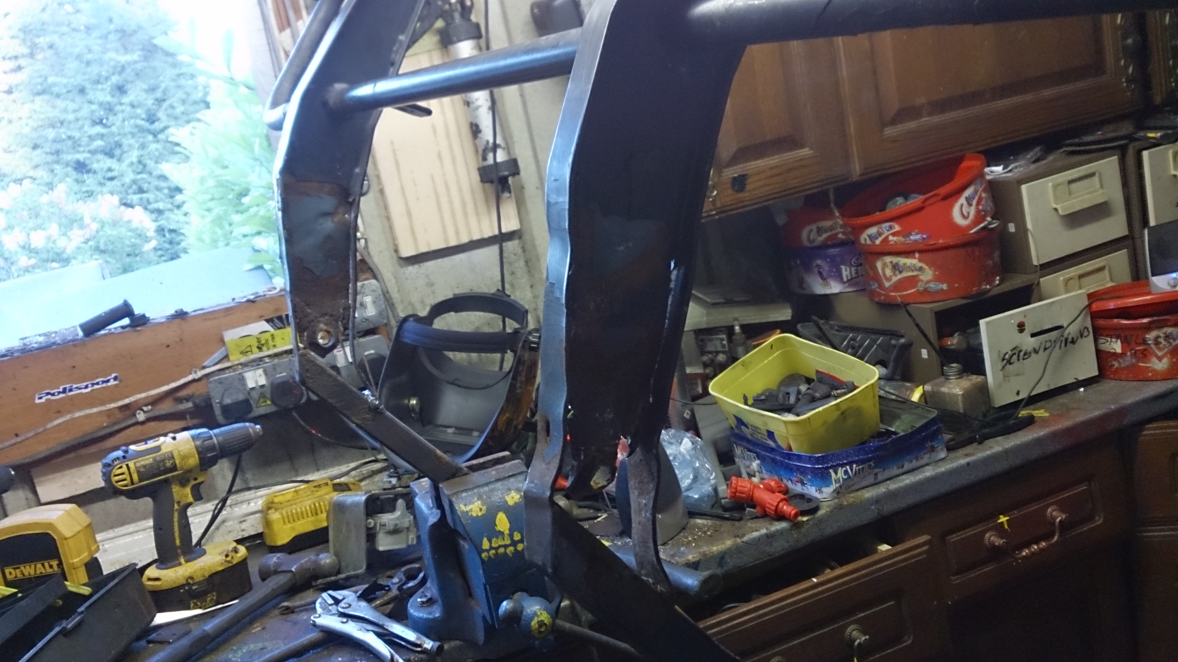

the bull bar was quite badly bent up but nothing ape strength could not (kinda) bend back into shape.

the exhaust now is also bolted and clamped together with Lambda sensor in. i am missing an exhaust rubber hanger though.. the one that holds the back box and centre pipe up :/

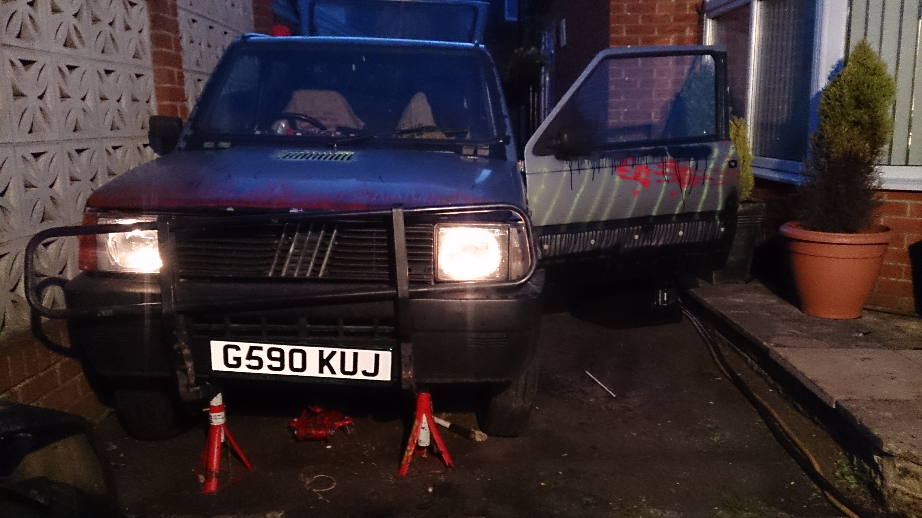

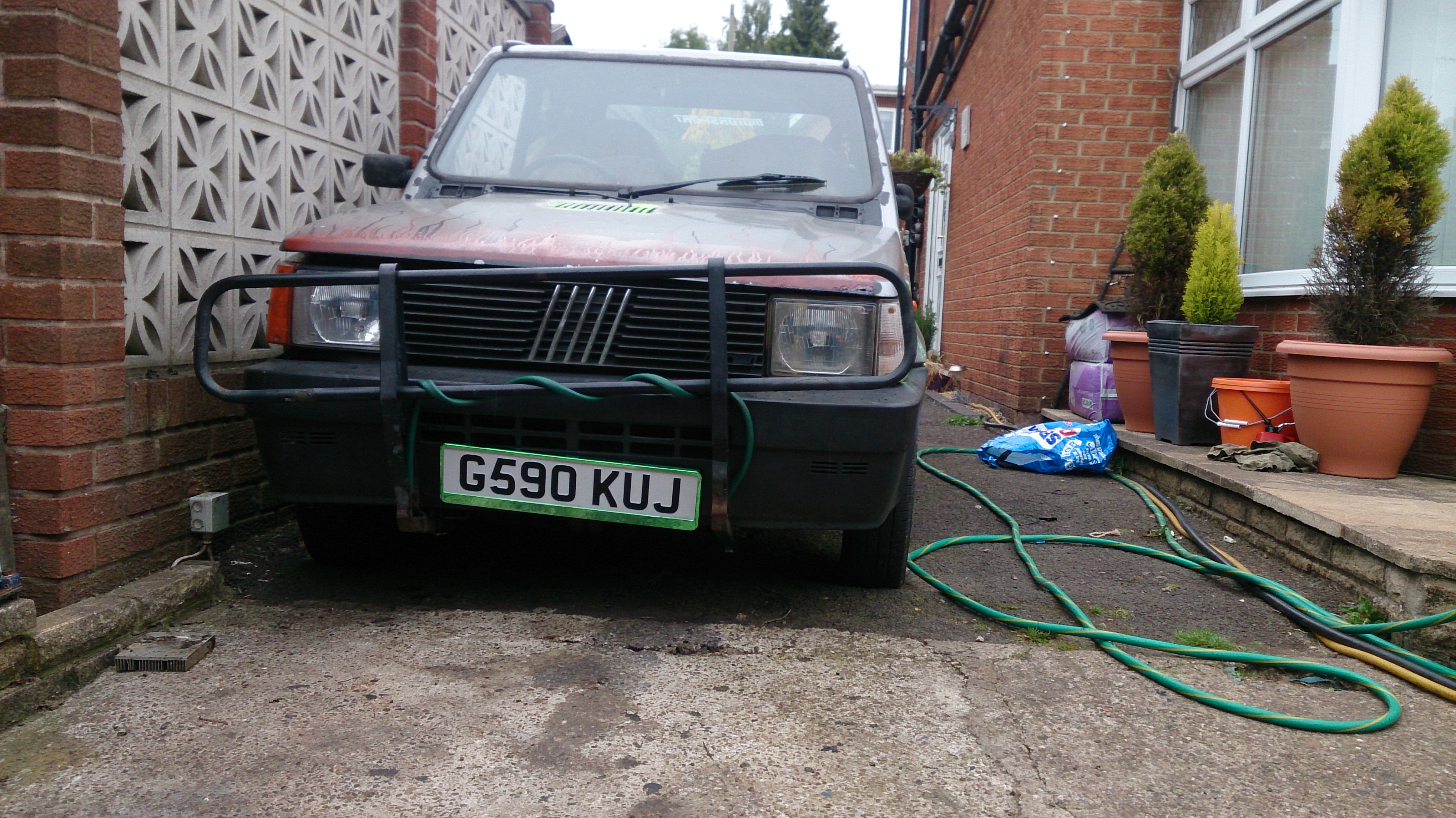

The bull bars.. the old "hit it with a hammer till it looks good" worked a treat!

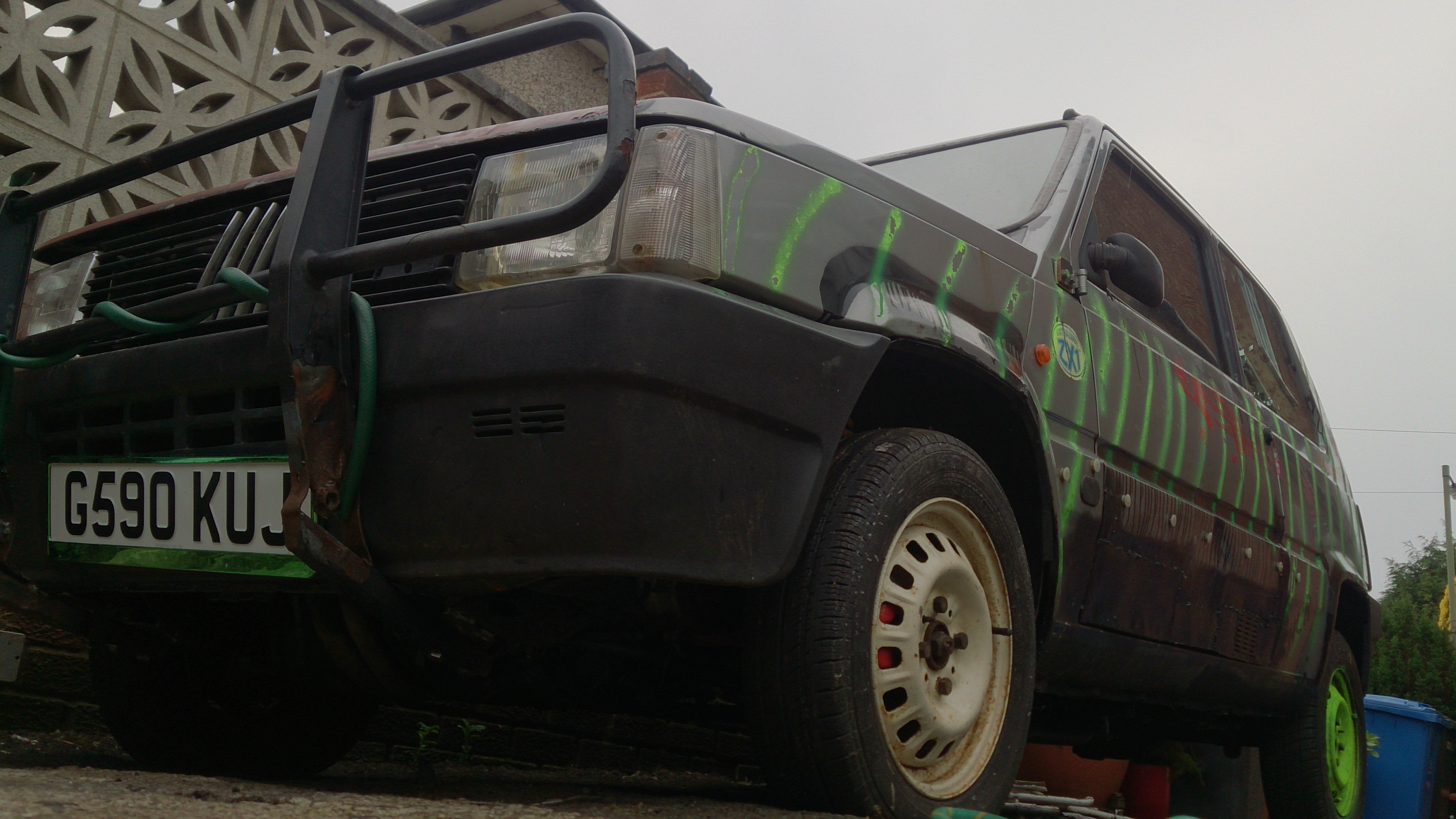

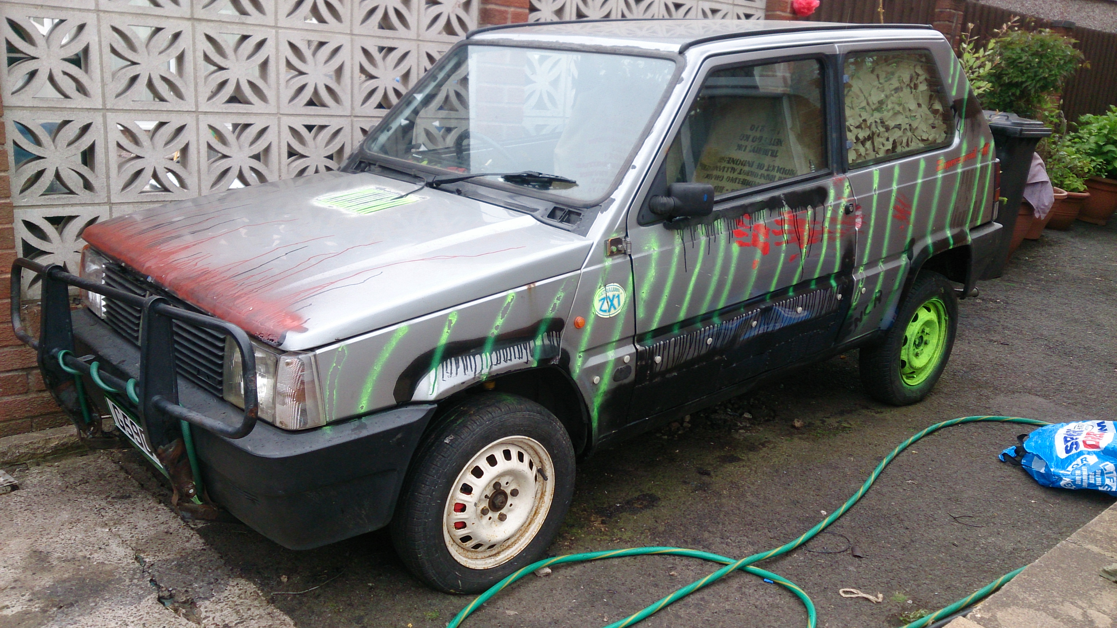

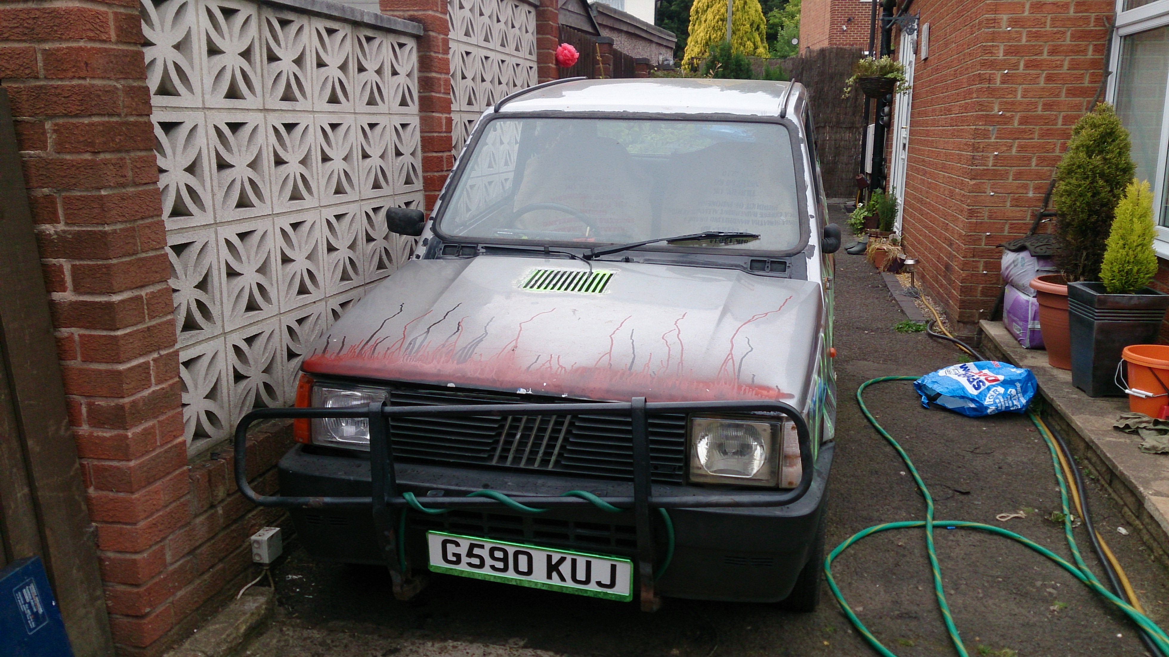

Fallout looks like this now :cool:
what do you think guys?! :D

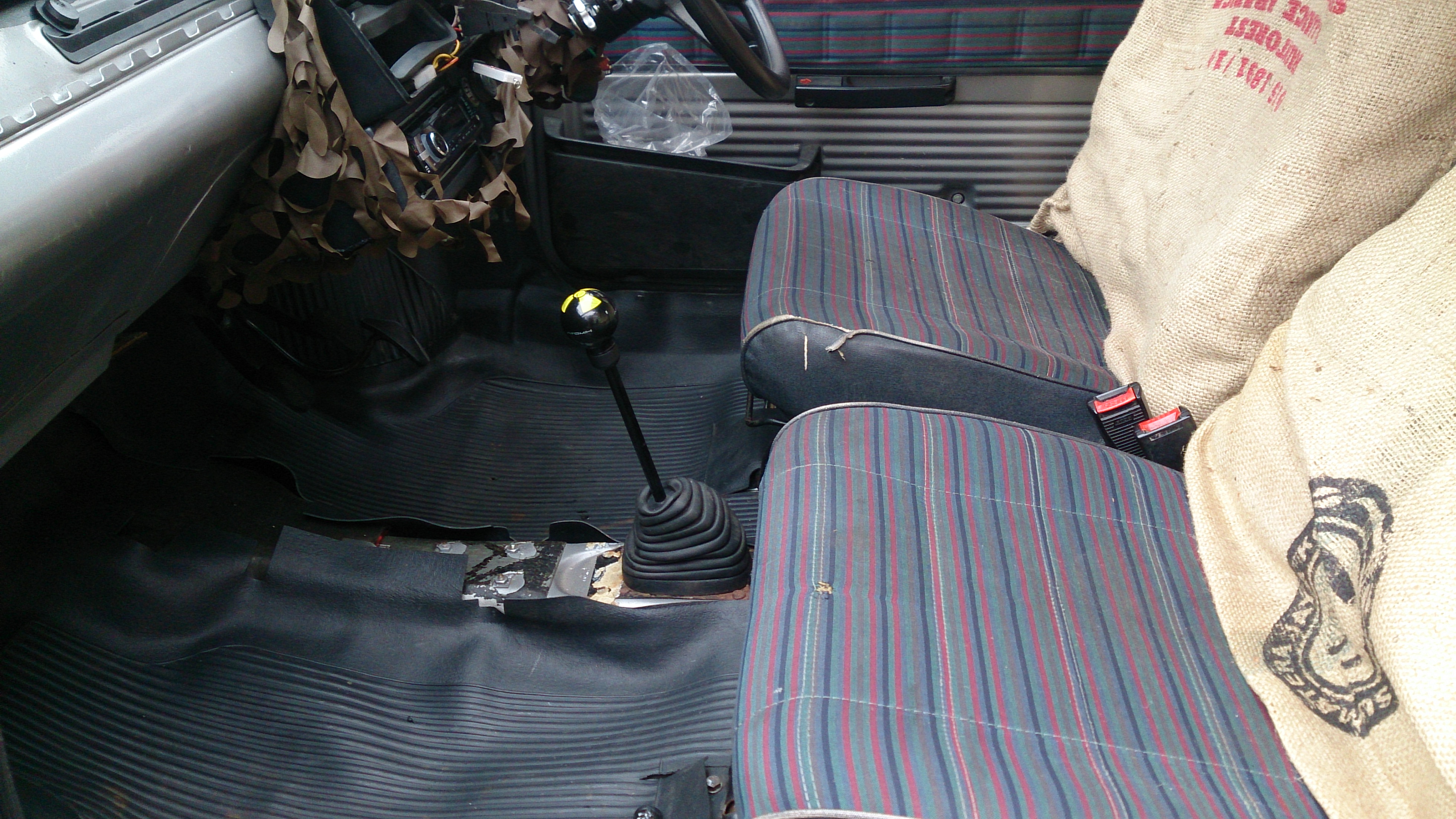

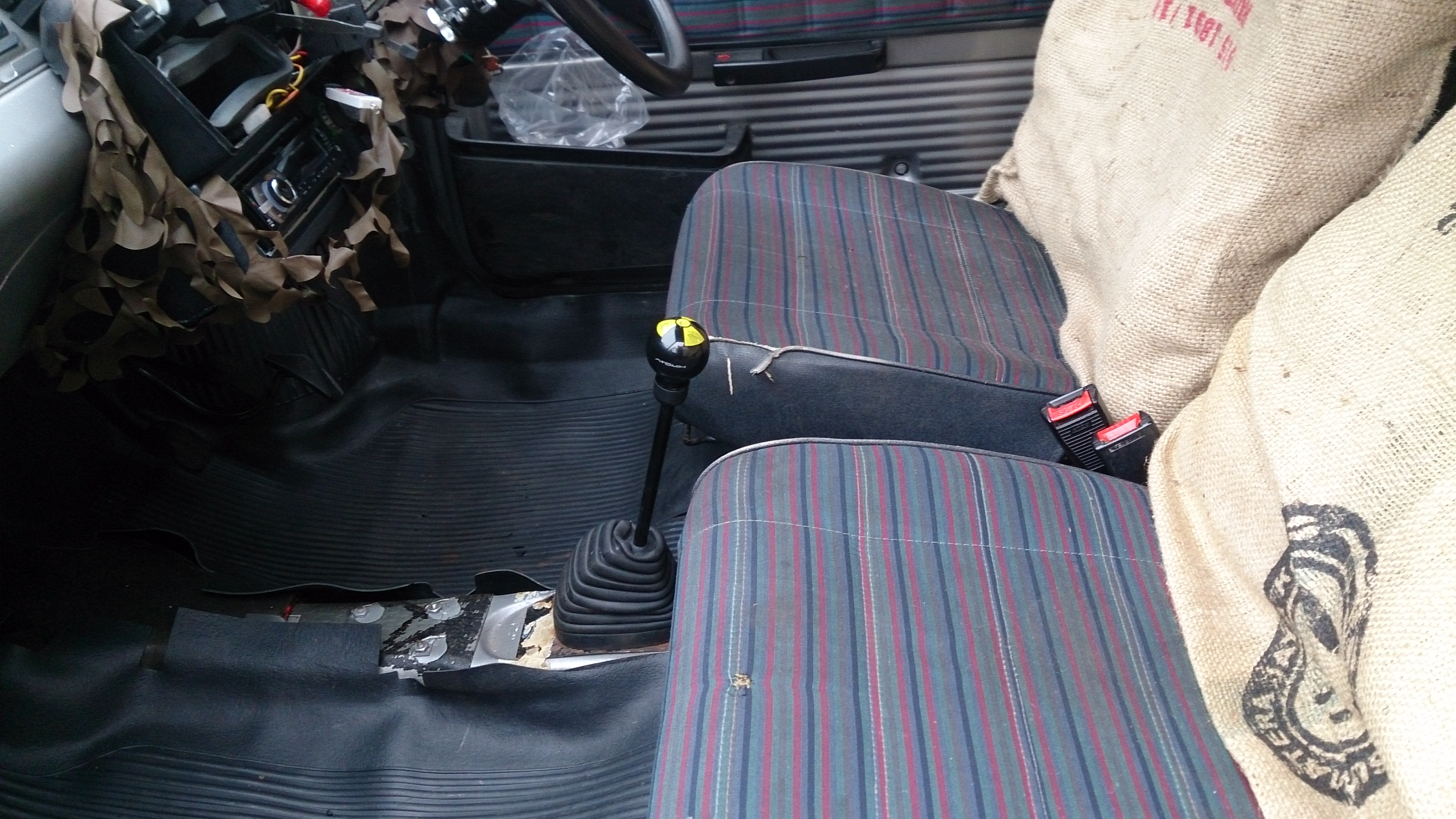

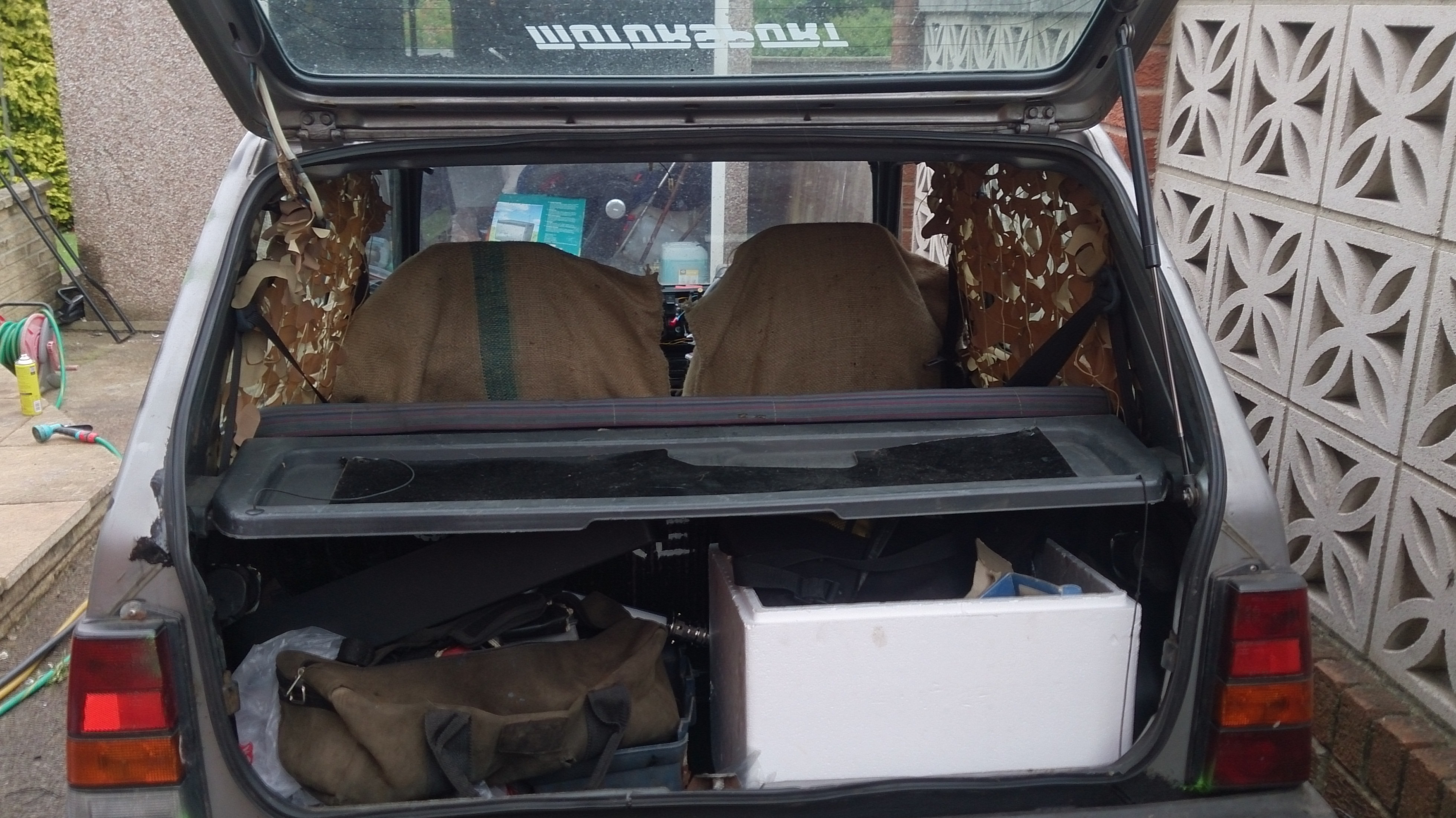

so how fallout looking in daylight:

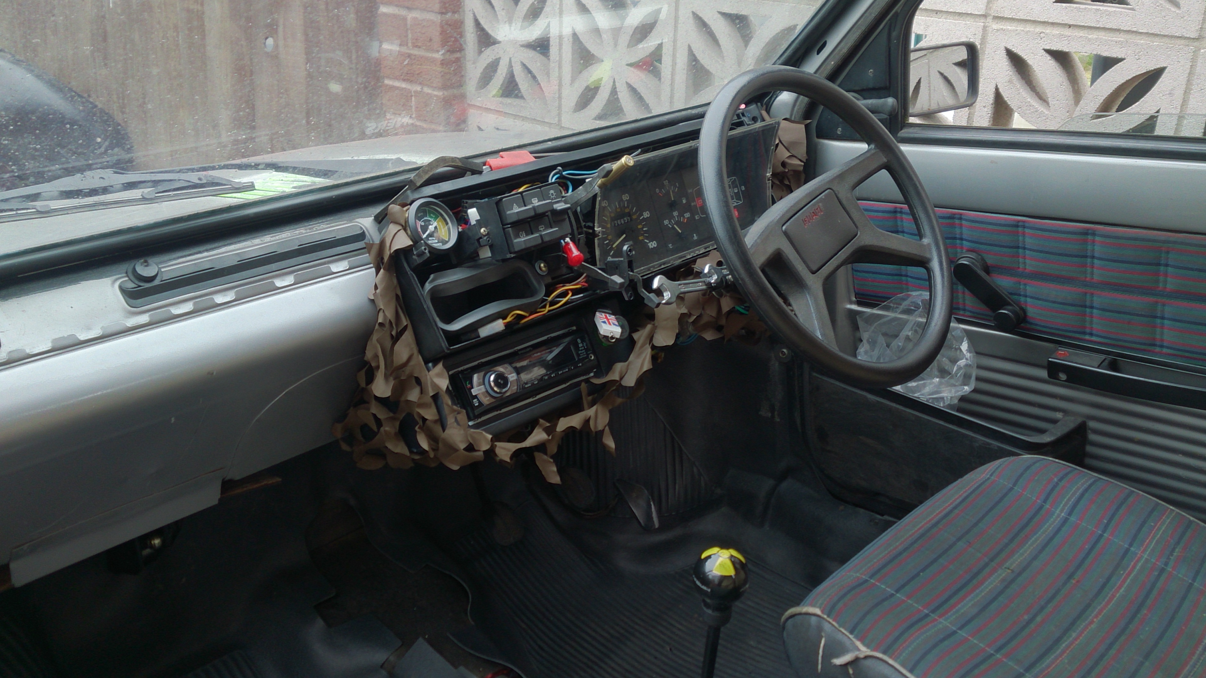

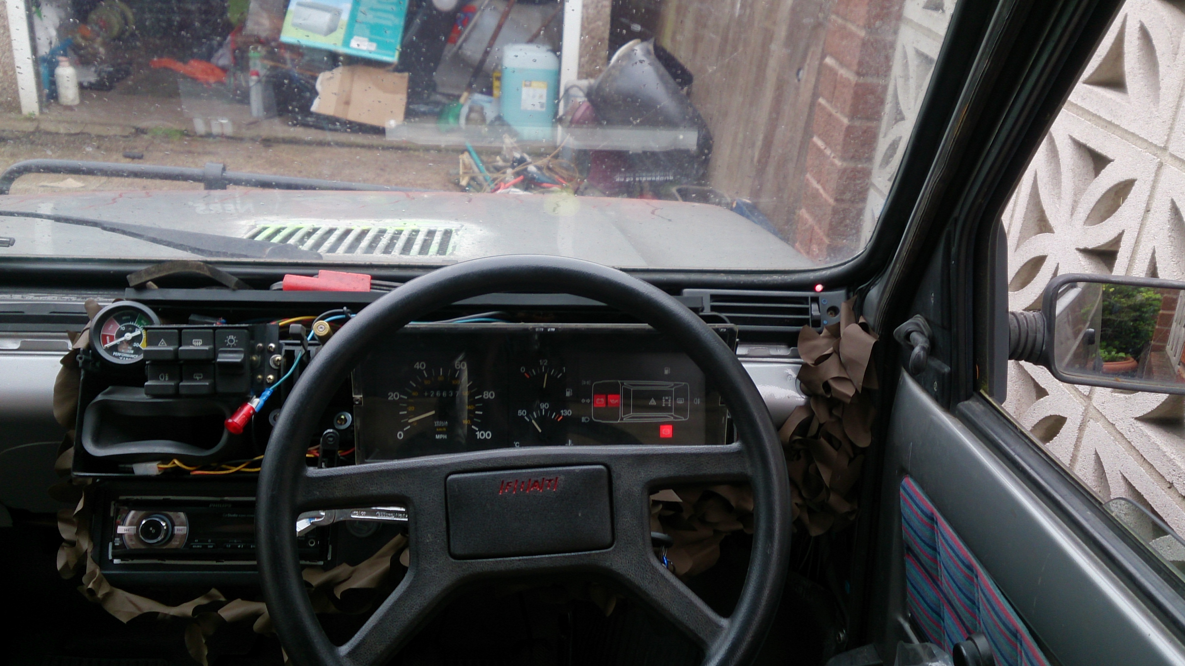

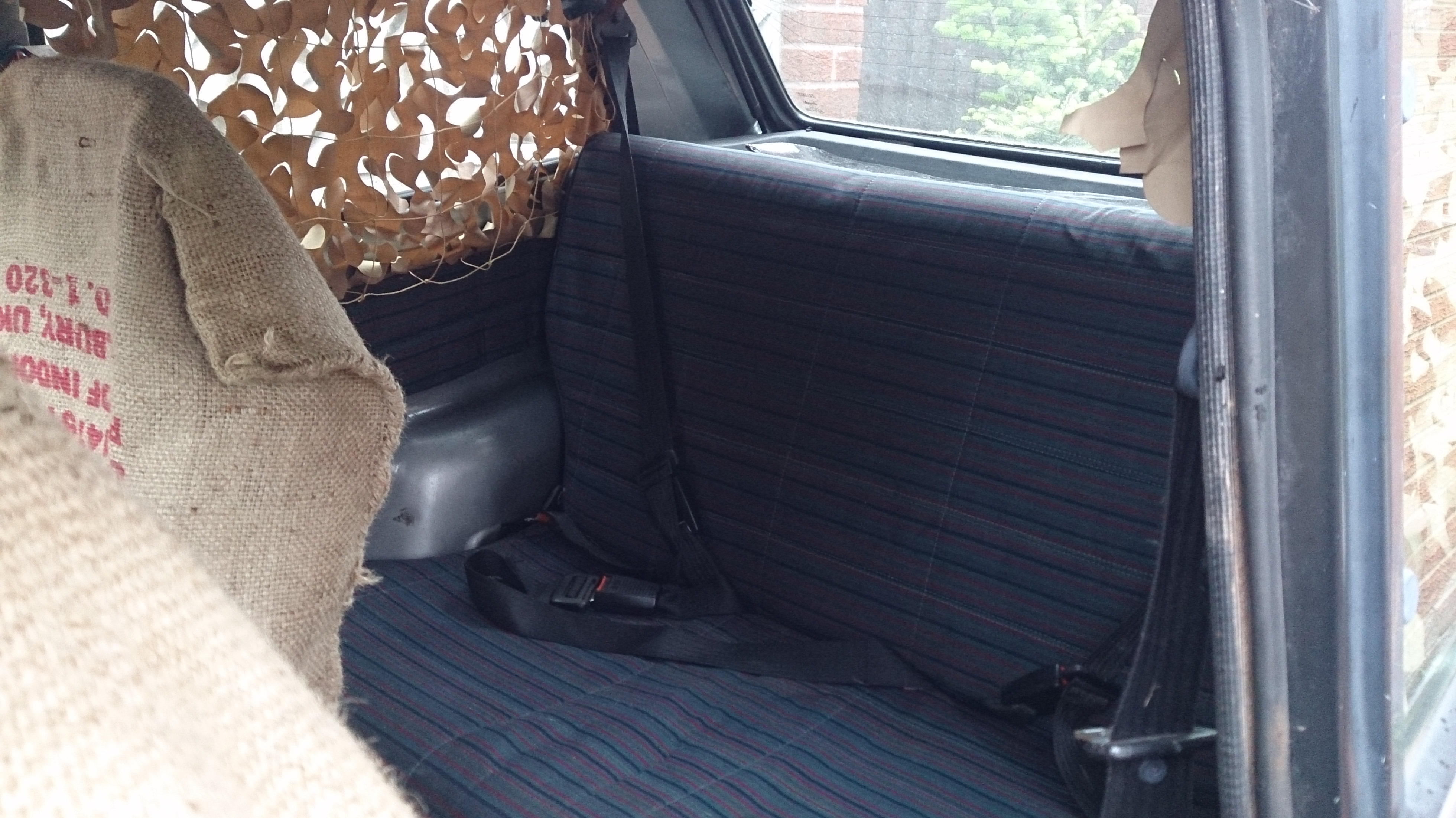

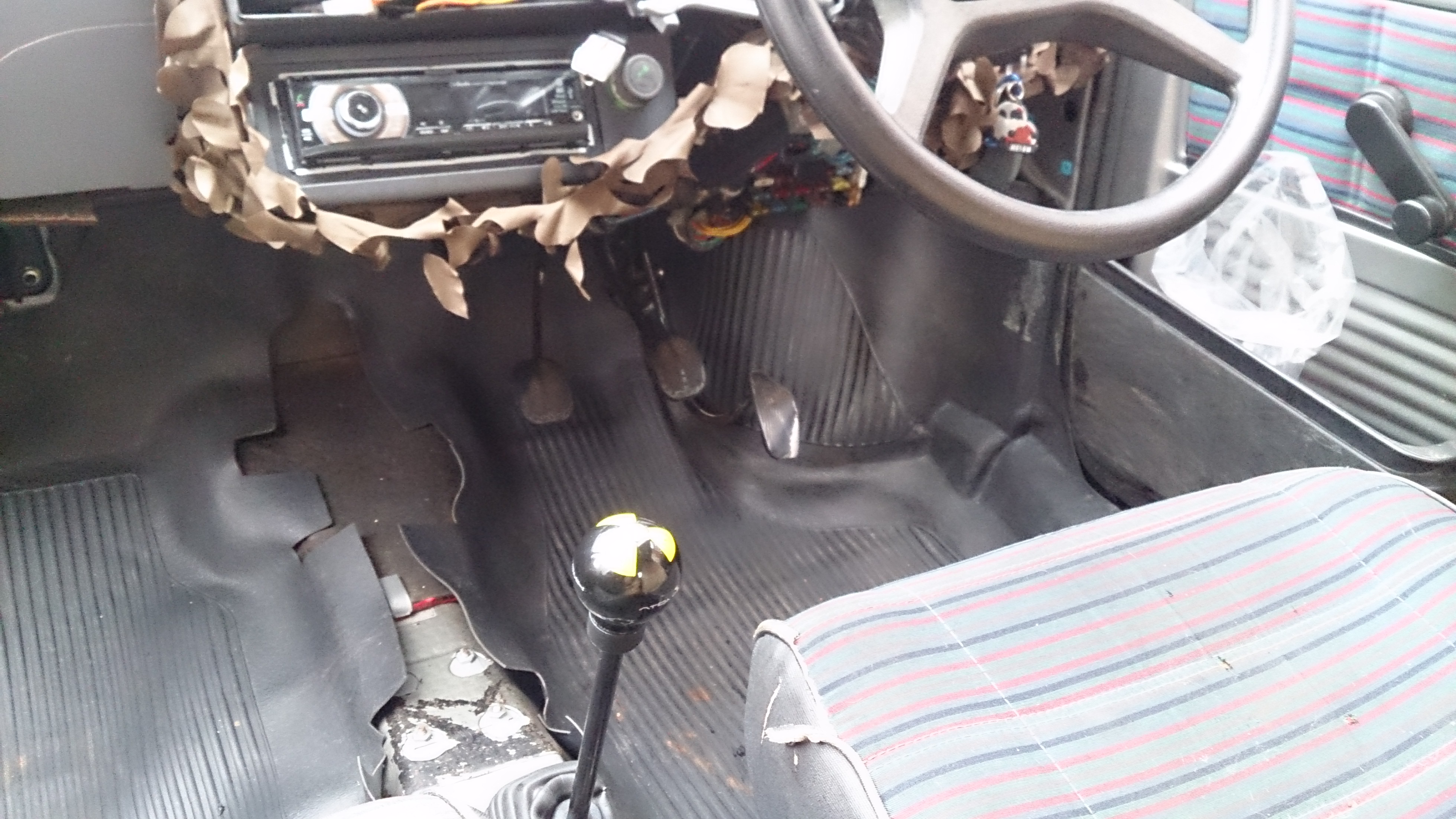

and now moving on to how it looks inside:

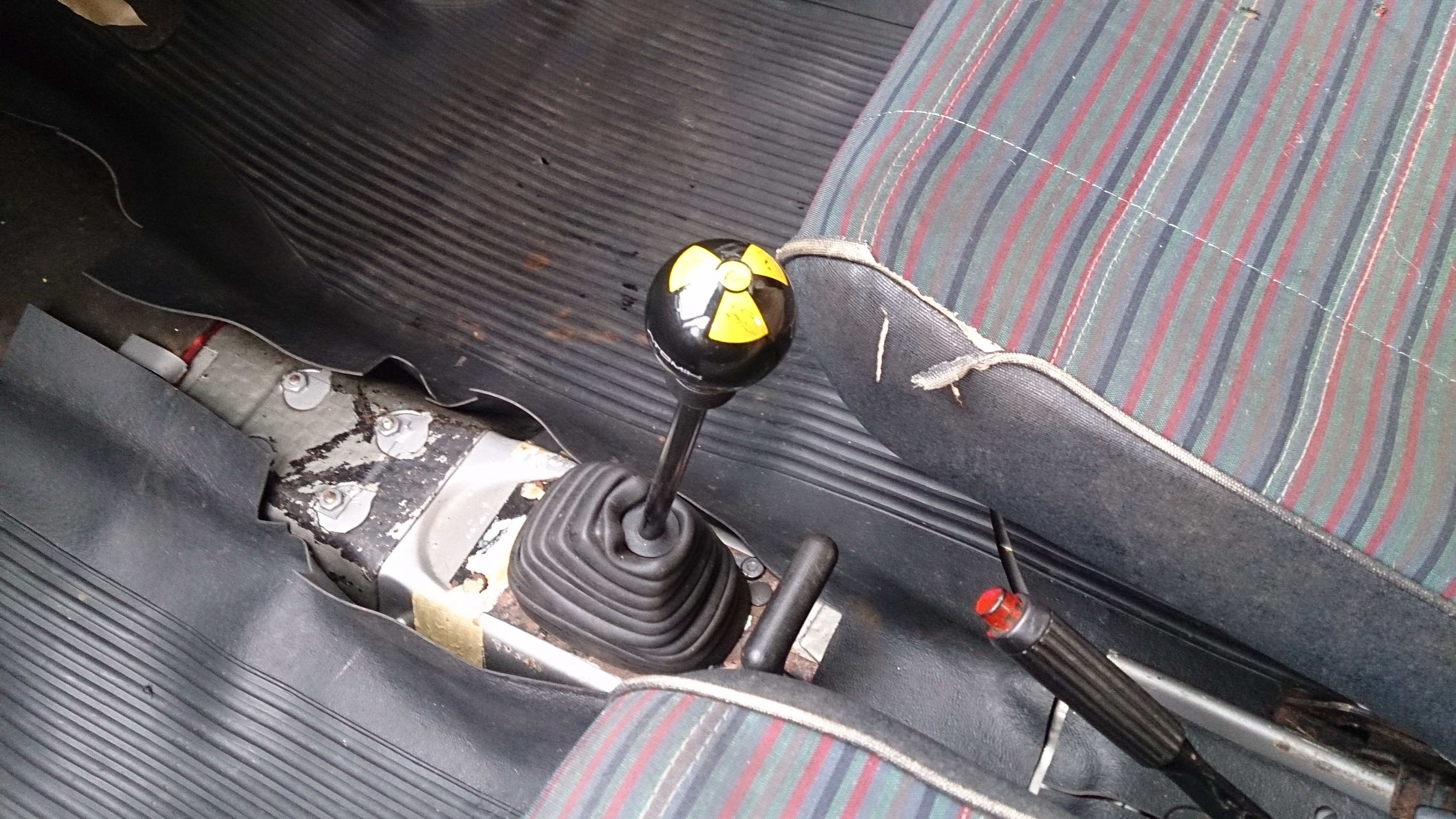

gear stick was welded in position a bit.. off but its fine for me:
1st gear:
2nd gear:

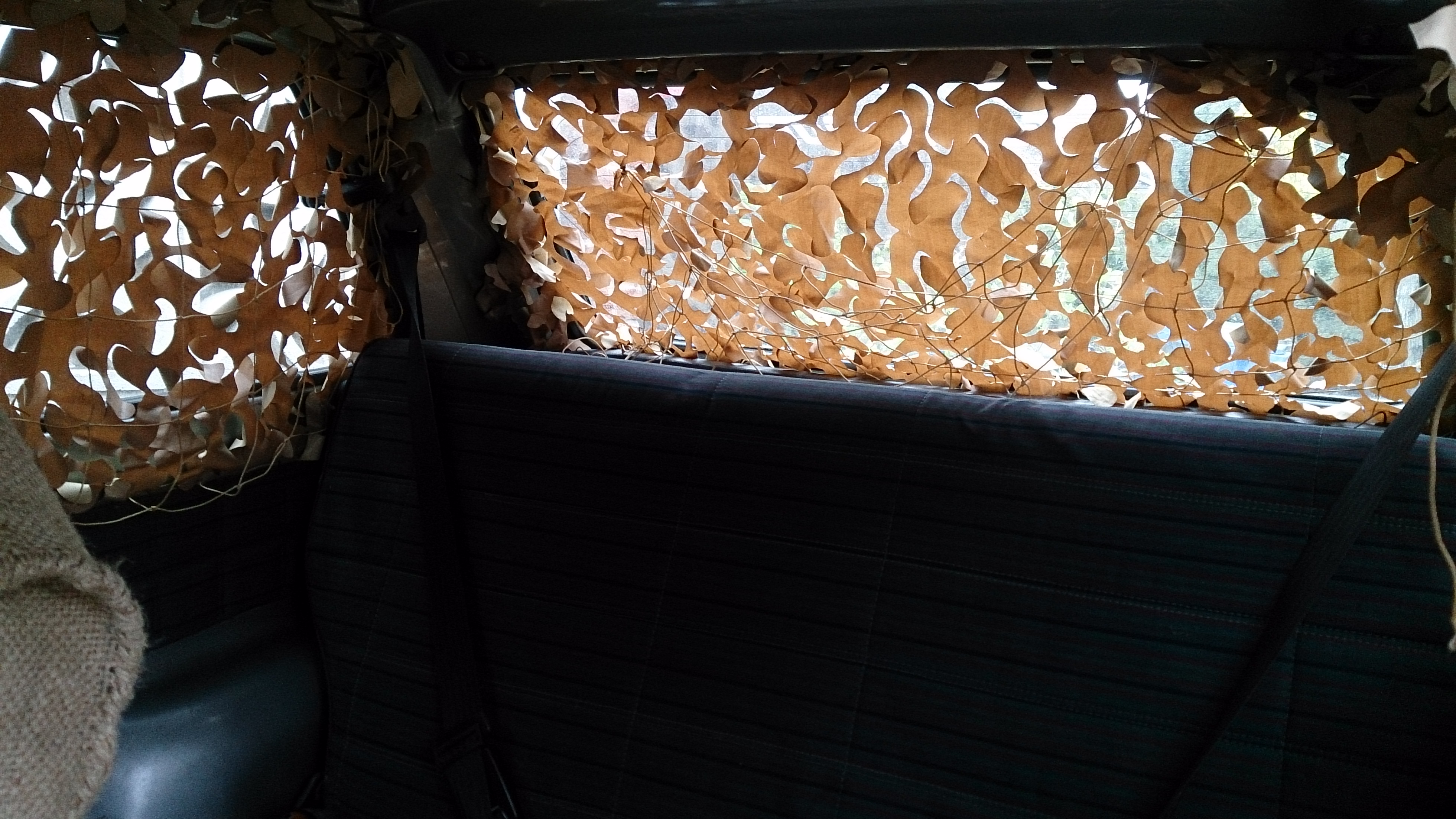

and now the back:

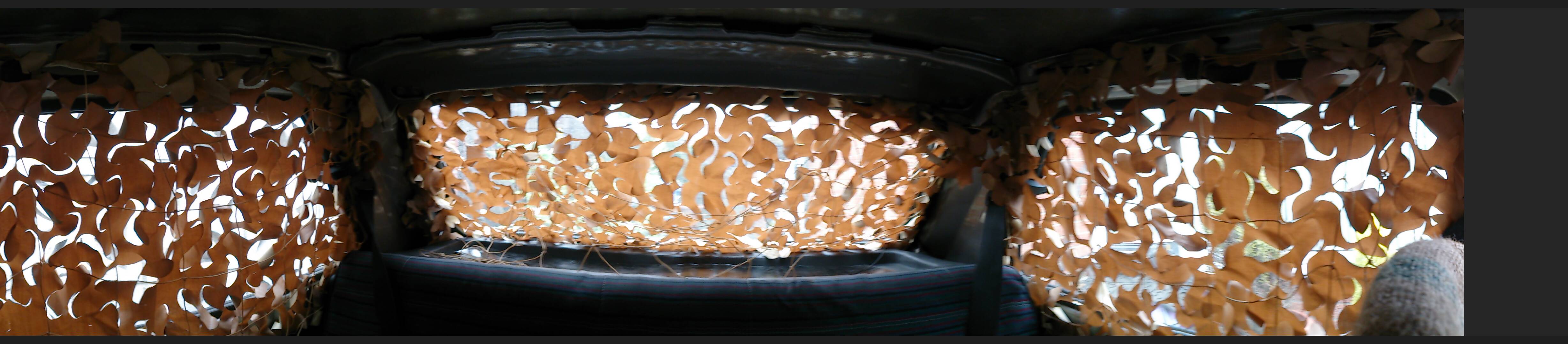

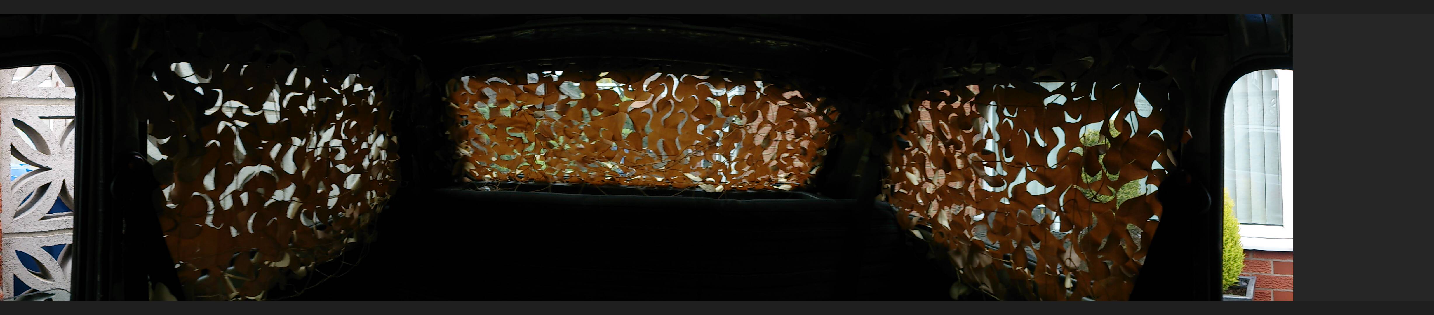

a panoramic of the inside:
im not sure to put the netting over the rear window too though.. thoughts guys?

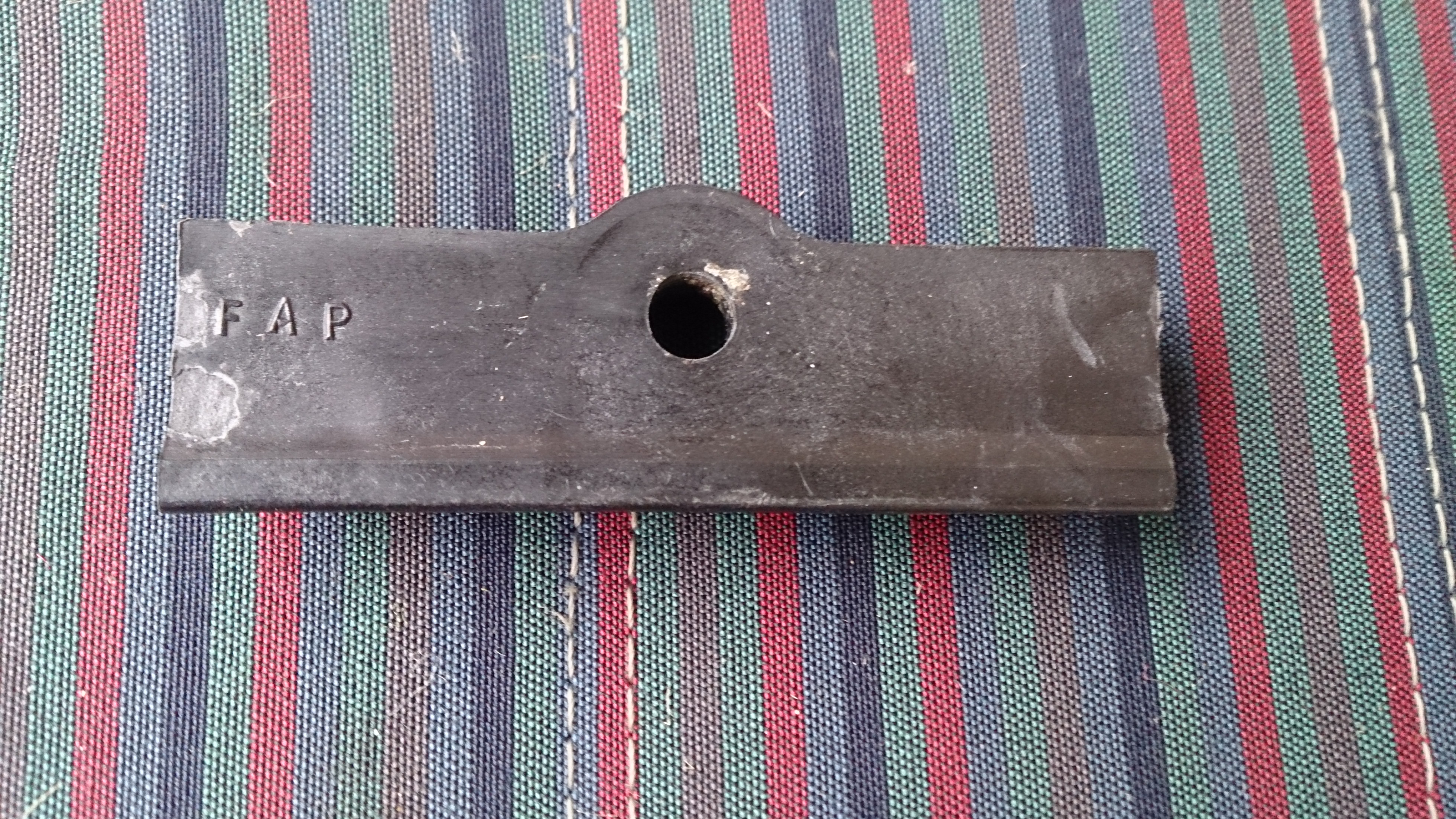

and lastly i found this rather amusing..
imagine knowing nothing about cars or what things are called.. then ringing up for a replacement part..
*Ring ring... ring ring... * Hello Fiat? Yes i would like a FAP please.....

I like the radiation symbol on the gearlever. Maybe some bigger ones for the outside of the car? You want people to feel the fear.
http://www.aliexpress.com/item/Free...r-Shift-knob-for-modified-car/1525338843.html
i polished off the "MOMO" then clear lacquered over the whole thing about 3 times.

On your bullbar, is that ok for the mot? i mean it's obviously secure etc, but if the bar comes down and obscures part of the headlight beam pattern, it might be picked up on that?
the bar needs to be bent a little more.. it sticks out front ways from the car way too much on the "lower" corner.
i think i need to take out the headlamp and bend it inwards (which at the same time will force it upwards) using a tree or something.
im lazy. the most easy way to do that is to kind of drive into a tree (or other non damageable solid item) at a very low velocity.
dont worry about the bar dropping down.. its bolted in pretty good... with M12 bolts! a bit of an improvement over the M8 's it had.. or could have been M10..
