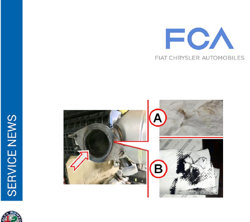

The following are from
This should determine you have a cracked DPF

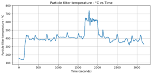

I attached the data for the last part of my test drive in which a regeneration of the DPF took place. During this part of the test drive, I increased the speed from 100 km/h (@2000 rpm) to 110 km/h, and further up to 120 km/h. Below you can see a graph with the temperature behaviour of the DPF during regeneration. Nearly independent of the speed, the temperature of the DPF is about 400 deg C during normal operation. During the regen one can see that the temperature goes up to more than 600 deg C to burn of the soot accumulated in the DPF.
The other graph shows the differantial pressure drop across the DPF before and after regen. The pressure drop goes up a little with increasing speed from 100 to 120 km/h, then it peaks at about 1700 seconds where the regen starts. After the regen at about 2000 seconds the pressure drop across the DPF is reduced from about 100-120 mbar down to about 30 mbar.
From this graph, I would conclude that the DPF seems to do is its job, it captures the soot and burns it off. Hopefully this will prevent the EGR cooler from getting blocked again.

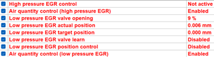

Analyzing the data further, one can also see that the High and Low Pressure EGR valves actually change position, which was not the case before repair. The High Pressure valve changes most during low speed and the Low Pressure changes most during high speed (100-120km/h). Yet, it is not clear to me how these valves are actually controlled because checking with MES, I find that they seem to be disabled for position control but enabled for air quantity control.
QUESTION to the forum: could somebody explain how this air quantity control works ?

Regarding your "disabled" label concerns in MES. I suggest you do not worry about monitoring those as they mean nothing for the Ducato. My Ducato shows exactly as yours and I have owned mine from new and service it myself. Remember that MES is not designed just for the Ducato and there can be some vagaries as a result. So long as you can see that the actual valve position tracks the target position for both valves you are good. Cheers, and a great outcome for you (Also - well done @theoneandonly )

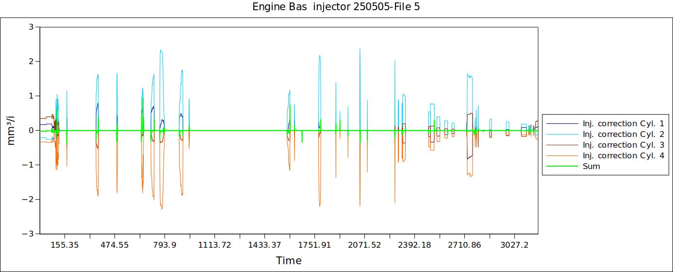

Now to recent results the injector values Good

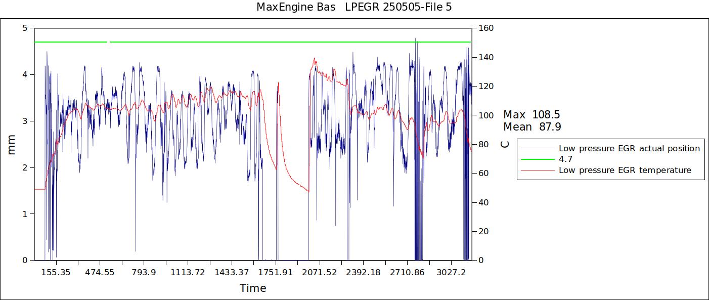

LPEGR working exactly as expected. Temperatures Good

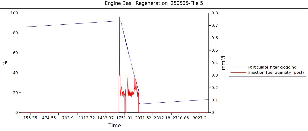

A nice example of regeneration.
Regeneration temperature typicaly trying to control around 640C but with a peak of 740C

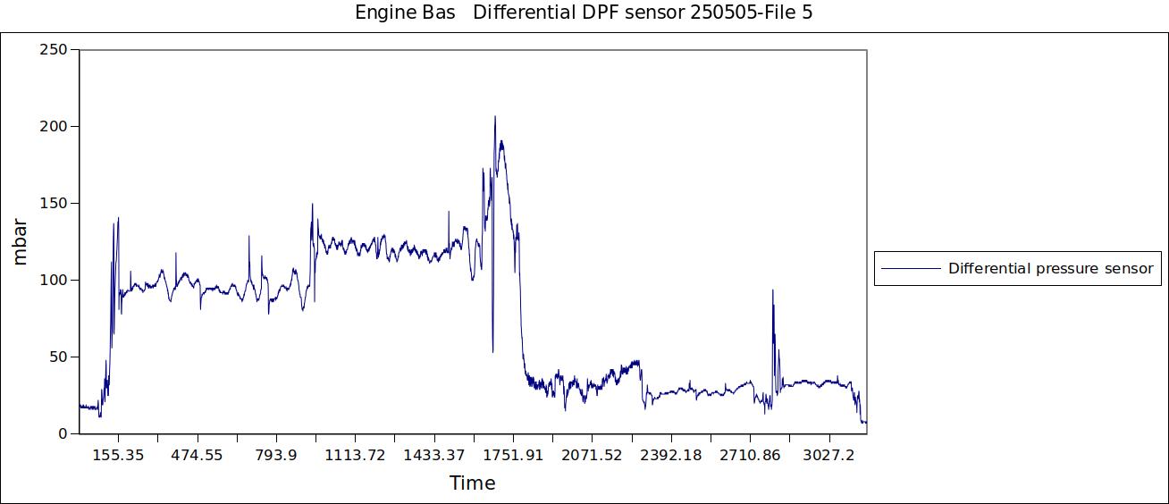

Now to 3 graph that concern me slightly. May just need running in.
The differntial sensor running grater than 100 at begginning. keep an eye on for improvement

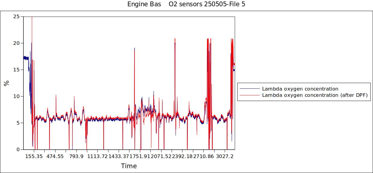

Oxygen levels at long term lows. Ive not seen anything like this. Lots of O2 being used up possibly in combustion of soot. again something to continue a watch on.

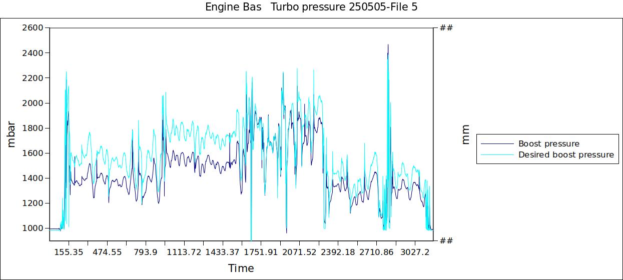

This also is not correct in my eyes, too large a discrepancy betwween desired and actual boost.

I wouold have a few questions for theoneandonly with regard to the turbo boost pressure which seems too low with respect to the desired boost pressure. In your comment you mentioned several possible reasons for the discrepancy which are:
-MAP sensor needs cleaning
-new Turbosolenoid valve required
-turbo activator sluggish
-leakage in turbo line somewhere.
