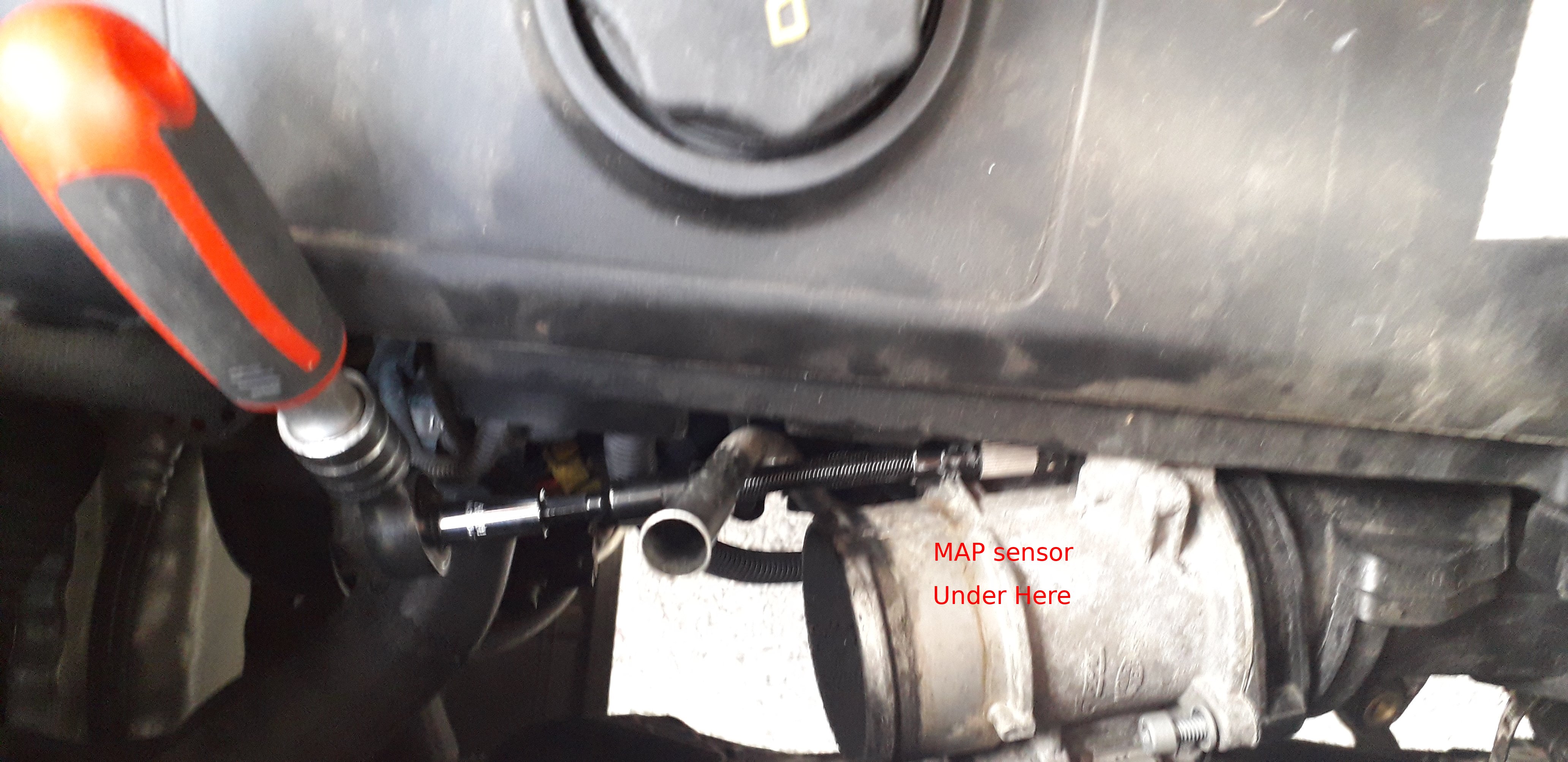

The boost pressure sensor is actually the MAP sensor (Manifold Absolute Pressure) and is on the front of the engine on the intake manifold under the throttle body (big air hose attached to it, can't miss it). Afaik that's the location for 2.3 and 3.0 engines.
Make sure you pull it out straight or it can snap (I got a bit impatient an broke off the tip). A bit of WD-40 can loosen the O-ring that can be stuck due to soot.

If you look at the guide in my last post it includes the position of the map sensor in the 2.3. (towards end)
