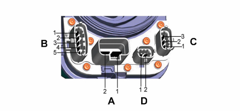

I am a little confused because I was thinking that we are discussing this cable. But, I see no such cable on the photo you attached.
The photo I attached is of the removed pump. There are four cables connected to it, one power and three control.
Dch5WQMKmSqnAAAAAElFTkSuQmCC
Connector A is the power one that gives trouble.
HTH,
Robert G8RPI.
Looking at the image covering the 4 x connectors.
It appears the correct profile..and just using 2-core cable.

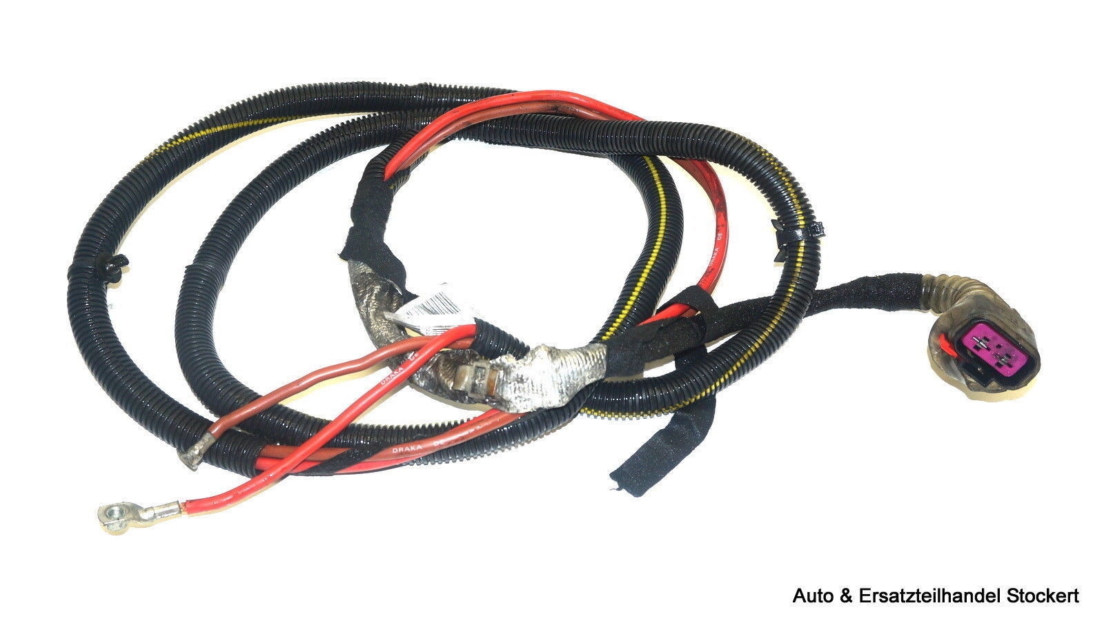

You are right. I will go ahead and order the connector. Just to double check: is it the right connector? https://errebishop.com/it/cablaggi-...roma-alimentazione-della-pompa-elettrica.html

The vectra one you got was the like one on the photo? I found one pretty cheap (around 20 €) but not sure if it would fit or not.
Do you perhaps remember part code? was it 13111603?
Thanks,
Hi Kam05, looks like the correct one. The Vectra one I got had a rubber cover to go over the connection.
