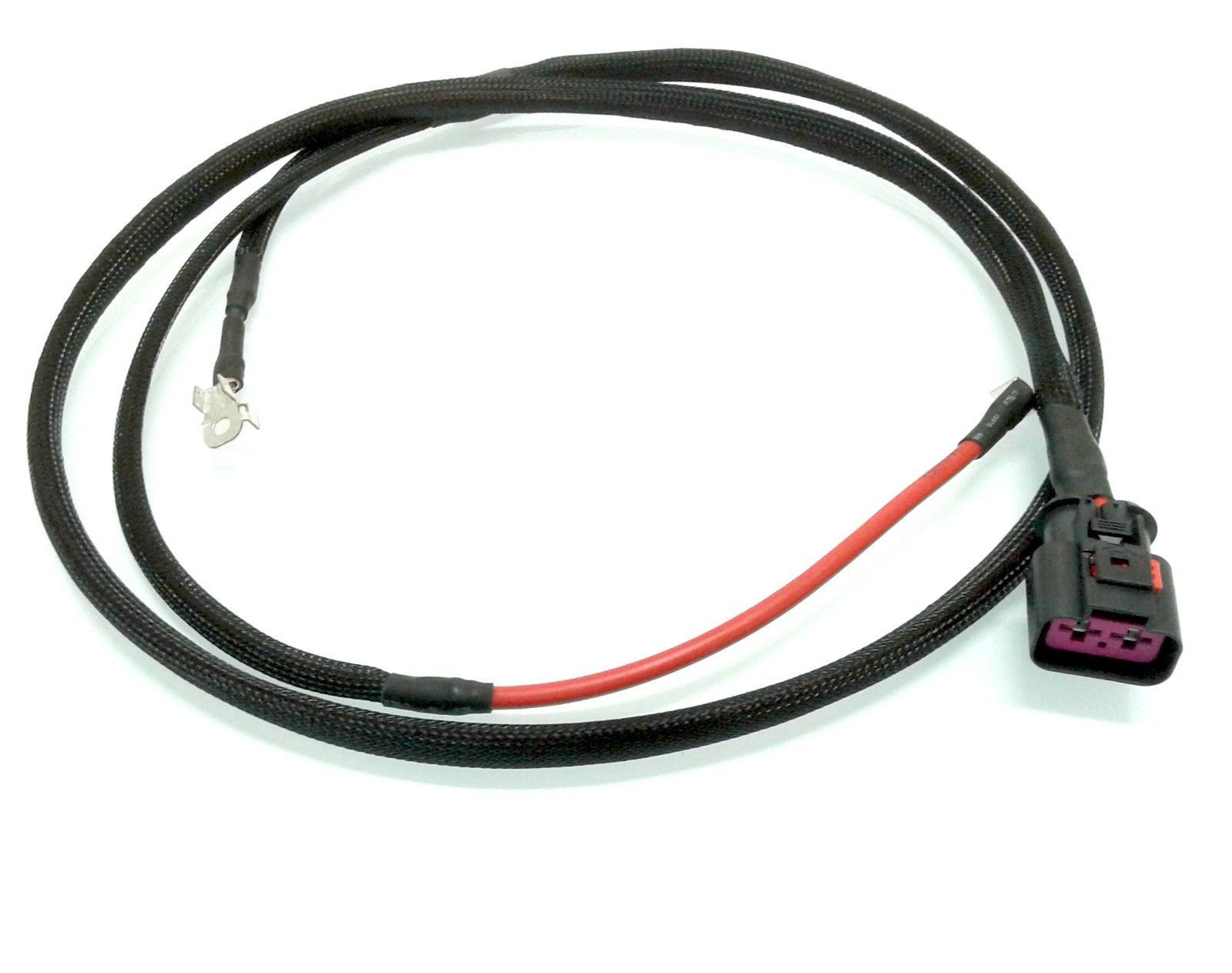

I',m a 3 Croma owner, Italian, all of the Croma i have changed this cable,
because the problem is the cable connector to the pump.
New cable is reinforced (see the red plastic, original not have, only slim plastic near pin connection on the pump), and solve immediately the power steering failure.
i Have buy here in Italy, but i think ship worldwide.
i can't post url's, haven't 5 posts, then
google search: Errebishop Cablaggio Elettroguida FIAT Croma, is 41€
Sorry for my bad english.
Thought I was doing too well with my Power steering. Didn't realise it was back in April I posted regards this, so got away with nearly 6 months of no steering problems. But its back with a vengeance. So I think I am going to go ahead and try and get a vectra cable or the one pistiriddi suggests.
Obviously the black lead is the ground, and in the photo pistririddi supplied, looks shorter than the red lead.
Does anyone know where the ground is attached and I assume the red live wire goes to either the fusebox or maybe a relay? I don't have a circuit diagram to check how the connections are made so it is a case of trying to work out in-situ.
Anyone know the best place to get the Vectra lead?

Just ordered a new cable from Italy. Couldn't find a Vectra one anywhere so taken the plunge and hope it arrives ok.
Think I will go down the same route as Brian and leave the original in place and cable tie the new onto the loom, I can't see a problem with this.

My new lead arrived from Italy (took 2 weeks). Got my local garage to fit it whilst they had it to sort out a power loss problem, and so far so good. Been driving around for a couple of days now and the steering feels ok.

Thats exactly how mine started. It would go really stiff and then suddenly come back. The cable seems to have worked and it hasn't reoccurred since it was fitted.
It is worth buying a cable before taking it to a garage as they will probably quote you anything from £700- £900 + to change the whole steering pump :(. The cable cost me 50 euros from Italy but you may get a Vectra one cheaper.

The power steering draws a huge amount of current and the connector is not very good.
One check is that if you unplug the connector there might be marks around the pin or socket.
The vectra cable I got second hand from a car breaker was far superior and even had a rubber cover built in to protect the connection.

Worth getting the battery checked but it does sound like the steering issue is the connector. A used Vectra C one is better. Seems Vauxall knew a couple of things like this connector and the "tulip" CV joints that they didn't tell Fiat about.

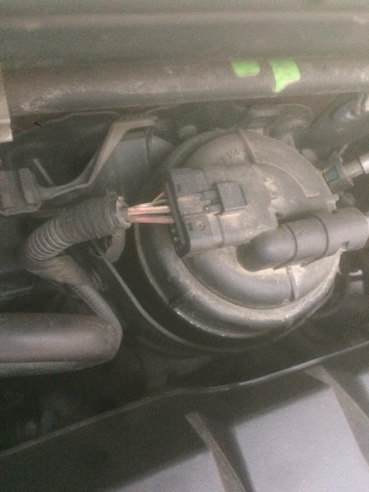

Just to be sure, would you please tell me if this is the infamous cable? WhatsApp Image 2018-12-07 at 16.06.33.jpeg
Thanks, pals
Just to be sure, would you please tell me if this is the infamous cable?View attachment 195765
No, that is the fuel filter.
The power steering pump is much lower down, behind the middle of the engine. The plug goes in vertically to the base ot the pump.
It's the cable with thick ~4-5mm diameter wire.

I am a little confused because I was thinking that we are discussing this cable. But, I see no such cable on the photo you attached.
