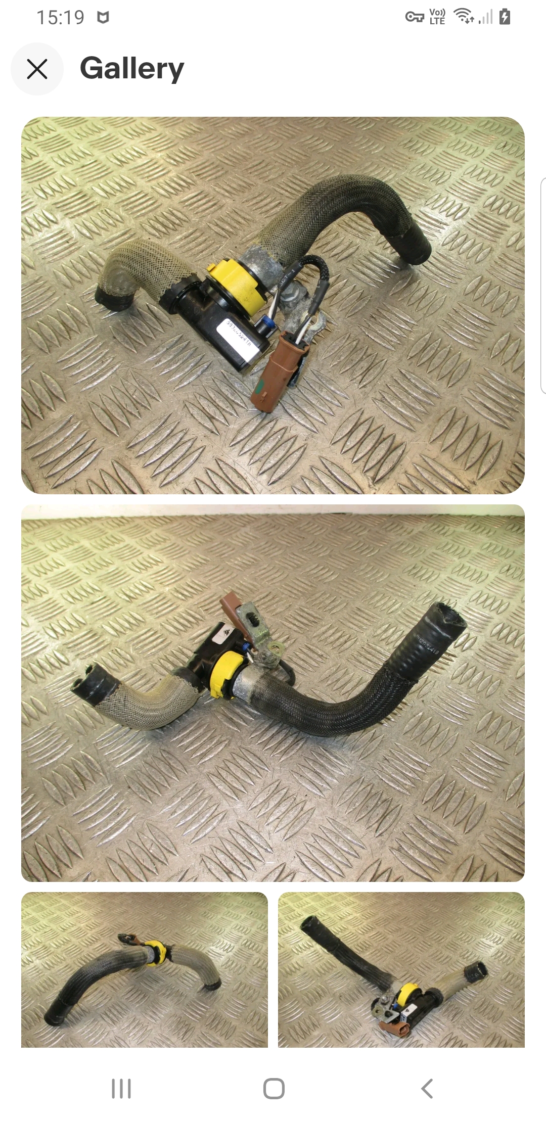

Hi, I posted previously on the above issue. Unfortunately due to health problems had to park the motorhome up for a while. The above OBD code says crankcase breather heater voltage too high. Struggling to find out what part I need. I have now had it suggested that the attached could be the part. I have been advised the above takes oil/water vapour from the crankcase and burns then before returning them to be pushed out the exhaust system. Could anyone help to confirm this could be the correct part. I reluctant to order the part @£135 for it to be wrong. Many thanks.

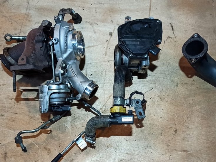

I did find a photo which shows it attached to a throttle body just upstream of the air input to the turbo. I am fairly certain therefore that this is indeed the pipe which recycles unwanted oily "blow by" vapour from the engine back into the air stream to be eventually burnt. Under very cold weather conditions it's possible for the water vapour component of this flow to turn into tiny ice crystals, which doesn't do the turbo blades much good. The heater is there to melt these and prevent this problem.
Your fault code indicates a possible fault with this component, so it's probably worth changing it. If you can buy just the centre part it might be cheaper and you could re-use the hoses, but you may find you can only buy the whole assembly.
In older Ducatos this was a 20 watt PTC thermistor type heater plain and simple, with only 2 wires. I have no idea if this later part has extra sophistication in the form of valves or sensors.

No not yet, I have managed to track the attached part from a scraped 2017 Ducato. Hopefully change the part next week,and clear the error code 🤞.My engine light stays on constantly with the following message " check engine" during start up. However when it first happened I could clear the code using a cheap OBDII reader.
Update..
Having sourced the item below from a scrapped Ducato on the same year & engine code. I connected the power lead to the replacement, plugged my obd 2 reader, cleared the code,then started the engine, which has cleared the engine fault light. Just need to change the fault part out. Hope this can help others. Cheers
2017 Fiat Ducato 2.3 Diesel F1AG. Temperature Sensor 5802052418
