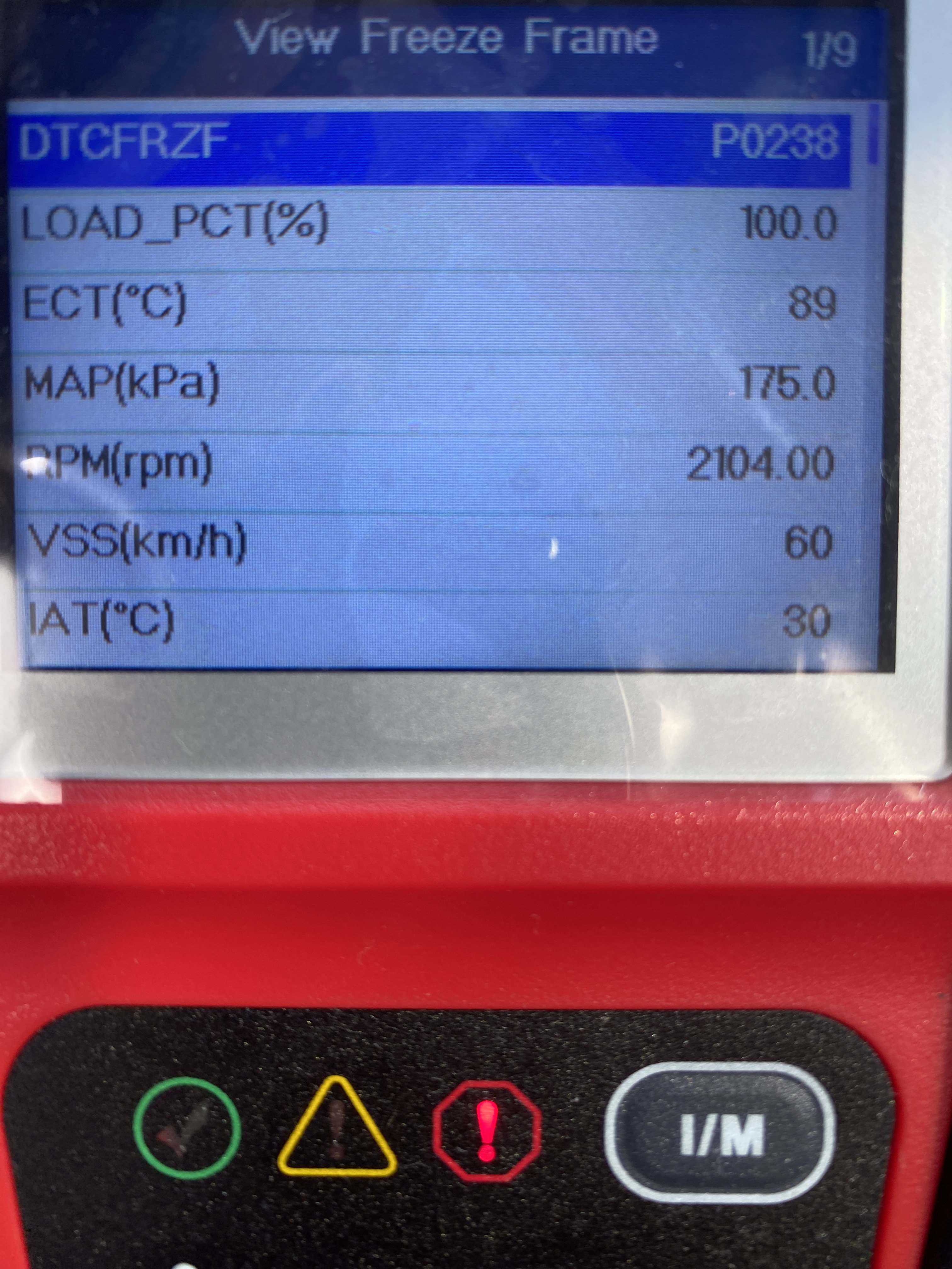

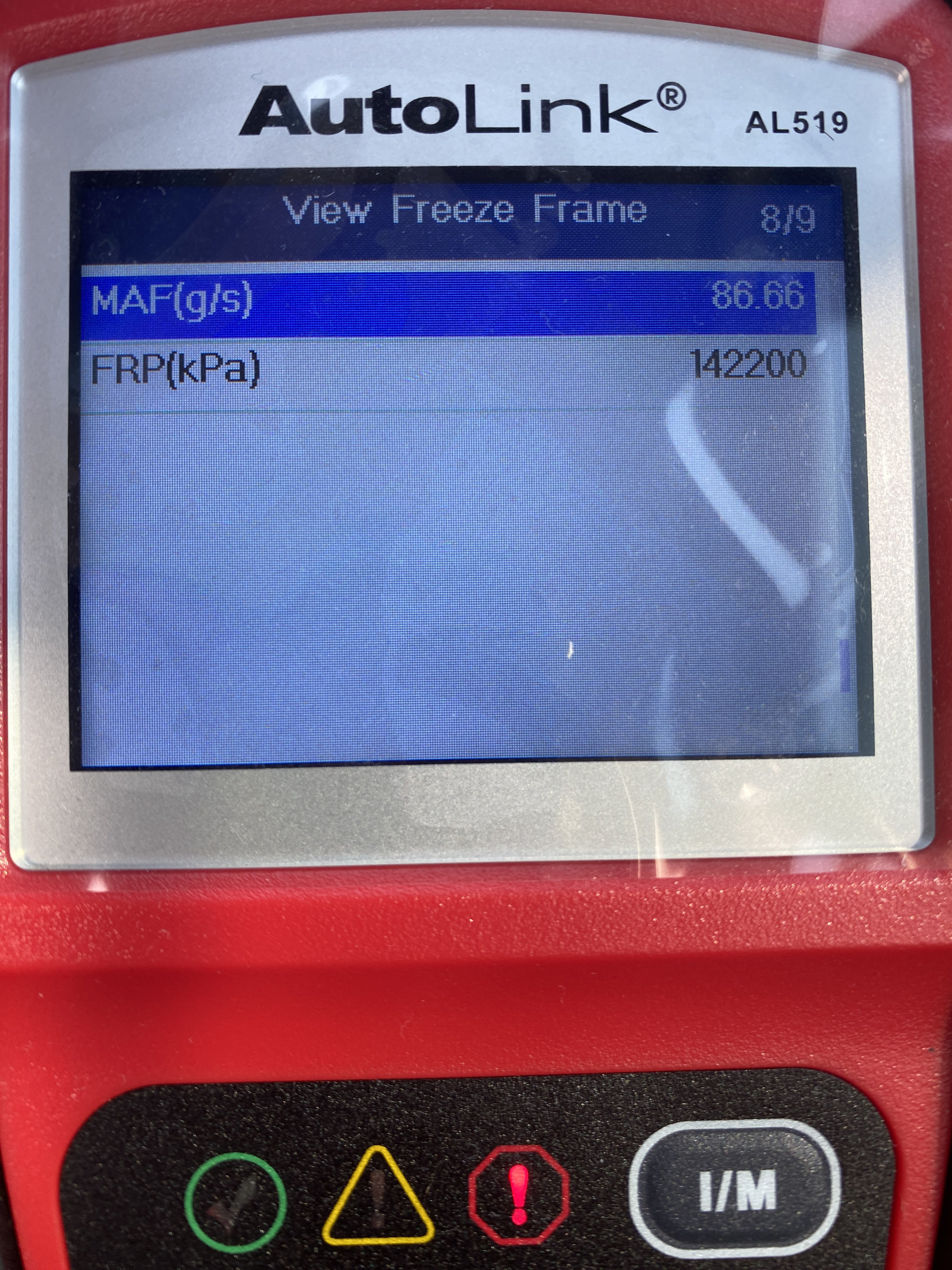

Sorry for late reply, I was on holiday and didn't have laptop with me, the initial codes were 0236 & 0238. The Fiat professional garage replaced the MAP sensor and said it was all good. But after 300 miles I got the error 0238 again and limp mode again. I've had to reset the code numerous times now so we could get home to Scotland from France. The van goes in to limp mode when I'm on 6th gear and trying to accelerate or maintain speed on any kind of incline. this is a freeze frame from the OBDII scanner I bought.

You may find benefit in joining us on the main P0401....thread and reading through then buying multiecuscan, (MES).
@theoneandonly can guide you through making templates of certain components results then doing a road run to record data.
You will read that I've been through the whole saga. I consider there may be benefit in changing the turbo solenoid however if your van is our twin EGR model then you may be the next victim of the blocked cooler syndrome.....
