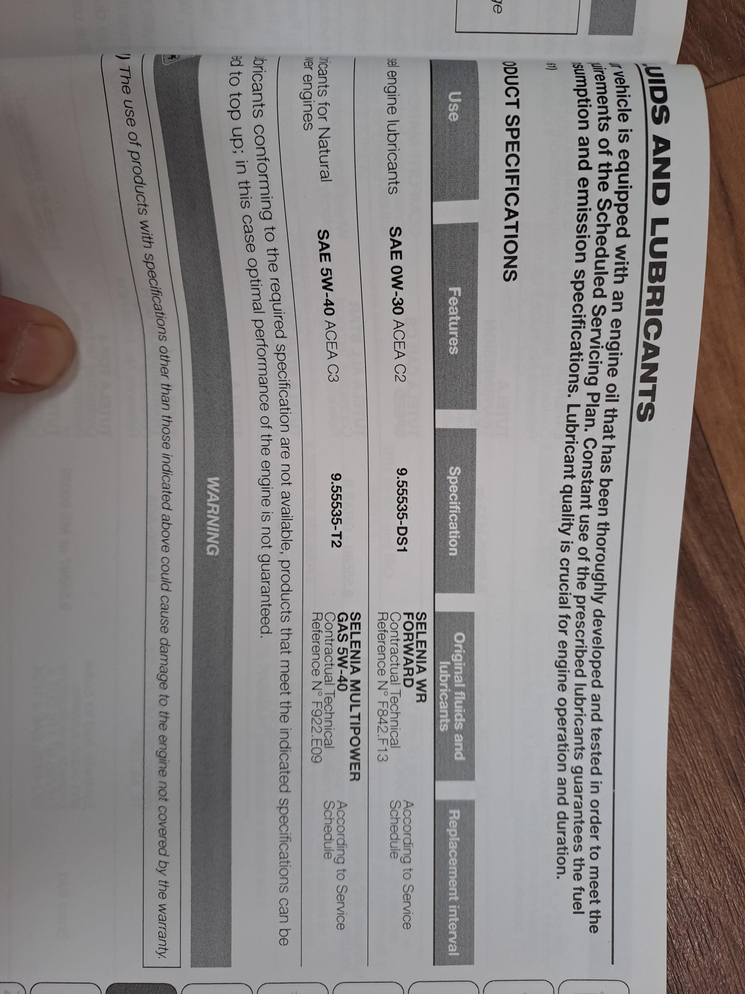

Just a thought regards DPF blockage. I was watching a YouTube video regarding Land Rover V6 engines and the recommended oils. Our Ducato handbook lists 2 grades of oil, SAE 0W-30 and SAE 5W-40.
Would the 5W-40 help reduce DPF blocking?
What grade oil is being used in engines that fail prematurely?
The very first handbooks were erroniously printed with the euro 5 reccomendation of 5w-30. 0-30 has always been reccomendation for the twin egr euro6. the 0w purely to get the lowest emmission. If you have a reccomendation of 5-40 that is a mistake.
I think the best bet is a low ash oil, changed fairly frequently safest option.
"A3/B3 is a high SAPS, sulfated ash, phosphorous and sulfur, oil. High SAPS oil will plug DPF or GPF, so you do not want to use these oils in vehicles with DPF or GPF. C3 is a mid SAPS oil. It is designed for DPF or GPF."
But what weight oil? If YOU read the hand book it recommends C2. The point I'm trying to make is that 0W-30 is like water and will easily seep into the combustion chamber and out through the DPF. A a heavier oil may contribute less to DPF blockage
So you don't think Fiat could have made a mistake recommending 0W-30? Do Fiat recommend a different weight oil for hot climates?
0W-30 is recommended to improve fuel economy so they can meet emissions, I doubt they gave much thought to oil consumption while it sat on a dyno trying to meet some standard.
If oil of the correct C rating but of a higher viscosity could be used it would be easier and cheaper than replacing the DPF etc.

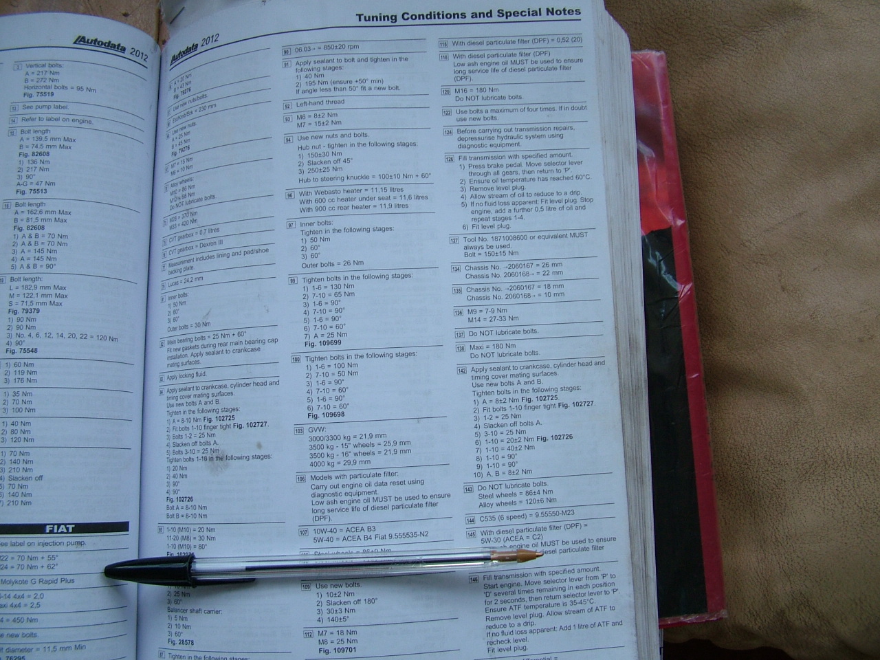

I didn't see which version and age yours was, this Auto Data Manual is a 2012 version, the other page is the special notes 107 re Fiat oil etc.
