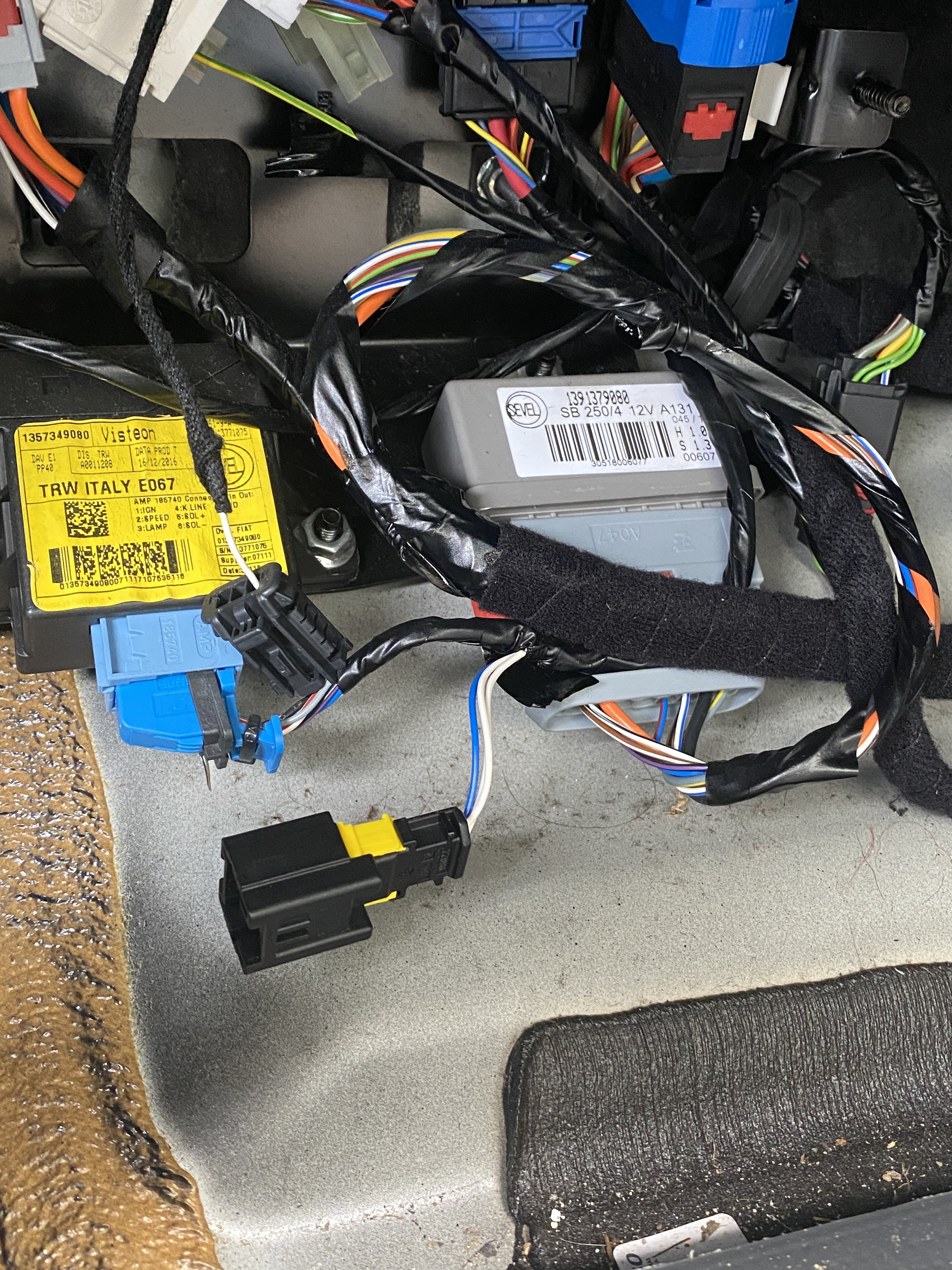

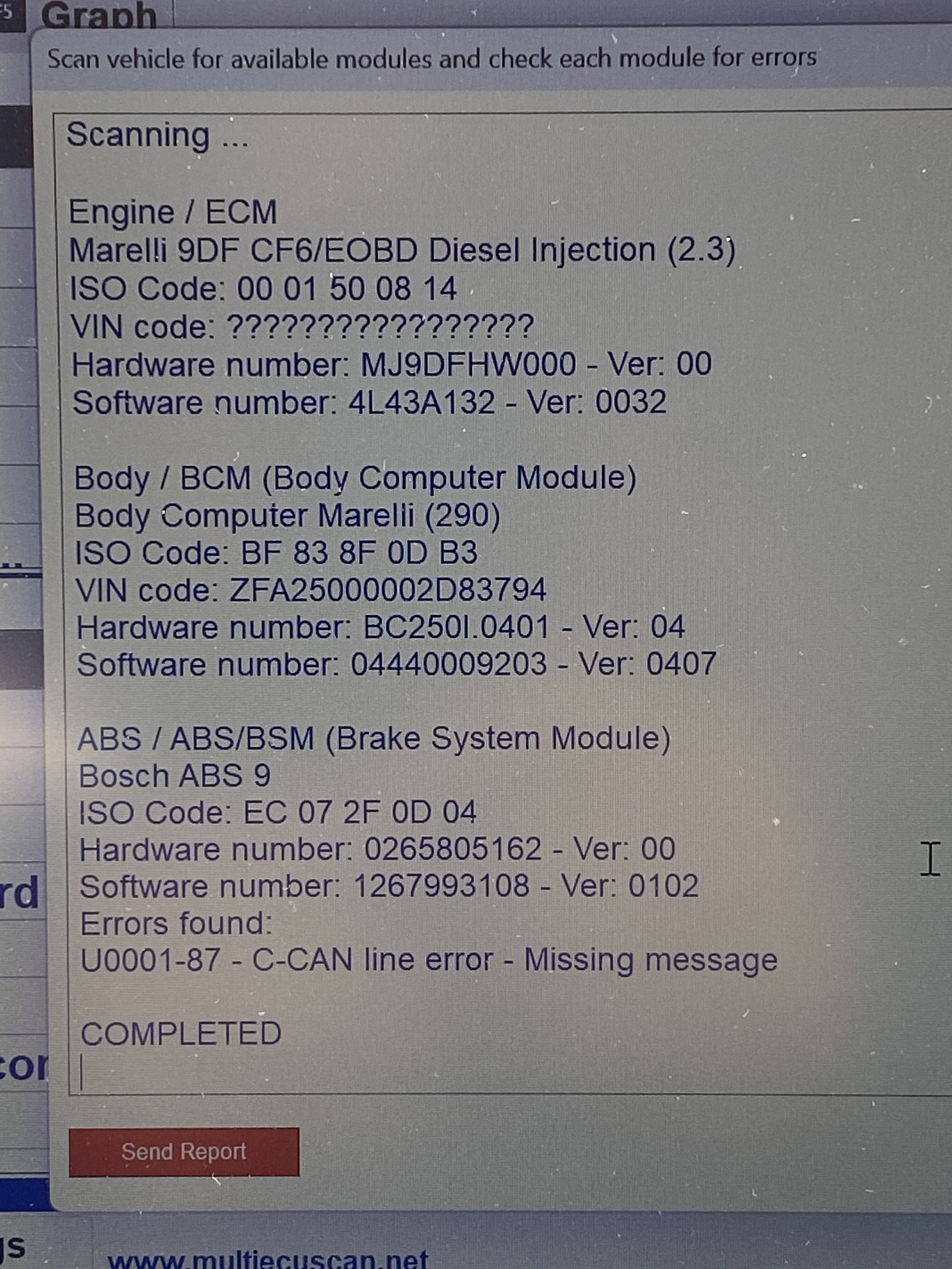

After we stopped on motorway the engine would not turn over. The breakdown mechanic tried to start a few times while trying to fix/diagnose at service station. I’ve located the fuel cut off and pressed it to reset. It definitely clicked. While o had the panels off I noticed a plug disconnected, do you know what this plug is for? Not sure if mechanic has forgot to connect it. Now the only error I’m getting is U0001-87. Thanks.
Sorry don't know about that plug.
So it was still running when you stopped with EML light on, but wouldn't restart?
Did recovery driver try to do anything to start it?
U code is can bus stuff and like ABS stuff doesn't usually stop engine from working.
All your immobiliser side is working like normal?

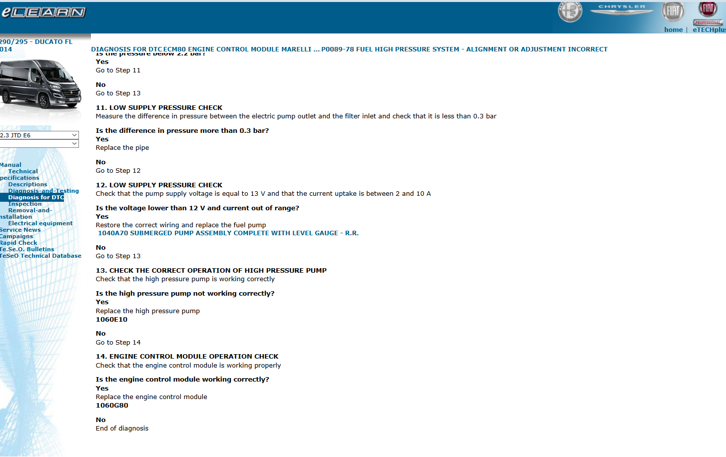

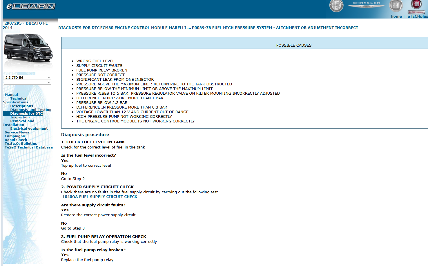

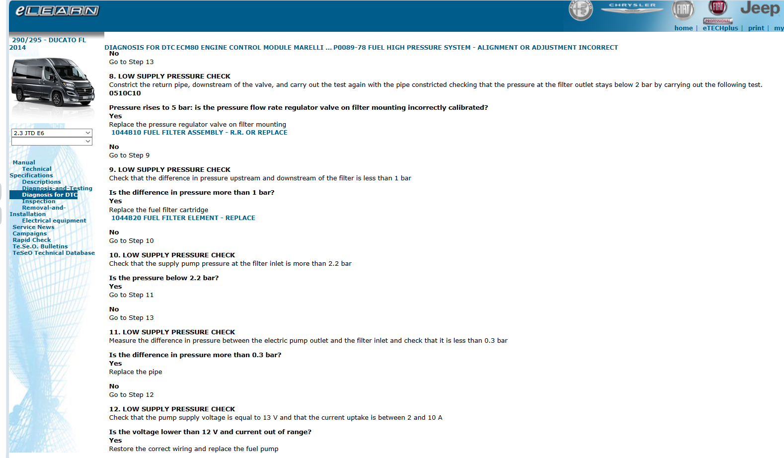

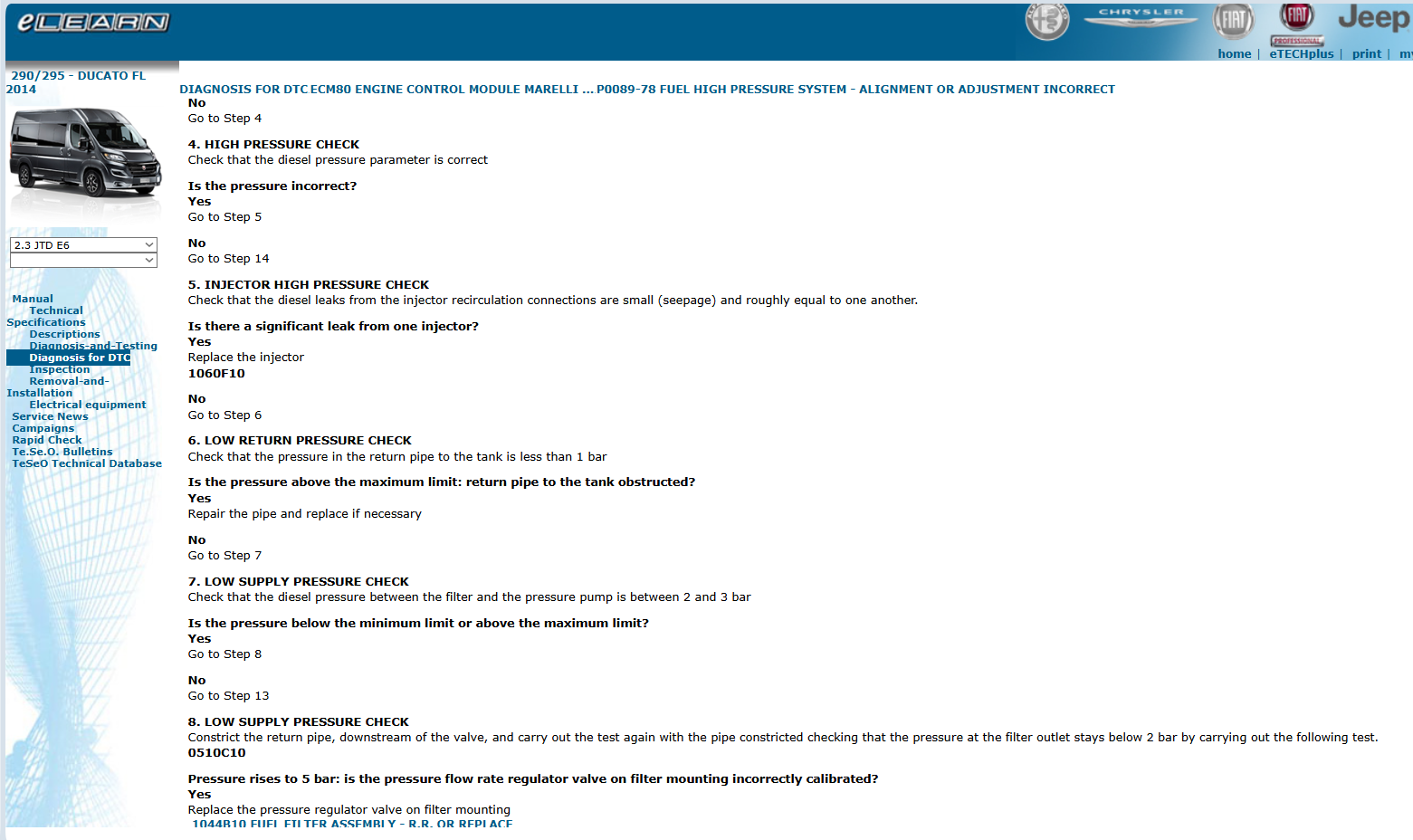

I'm thinking along the lines of fuel pump fault, Just checked that the fuel relay is working, I can hear and feel it click , checked that camshaft rotating during cranking
Good cam is moving.;)
So engine is turning on the starter then?
Does it feel like good compressions, as in normal cranking sound?
Is rev counter moving as in faulty crank position sensor fault?
Can you measure common rail fuel pressure on cranking with your diagnostic tool in live data.

Well Fiat Professional have now had 3 hours for diagnosis and requesting an additional 3 hours for electrical testing. I’ve just read a post on an other forum where the problem turned out to be the fuel lift pump in the tank, this was found after replacing multiple components/ sensors and injectors. This is my latest message from Fiat, are they going the right route?

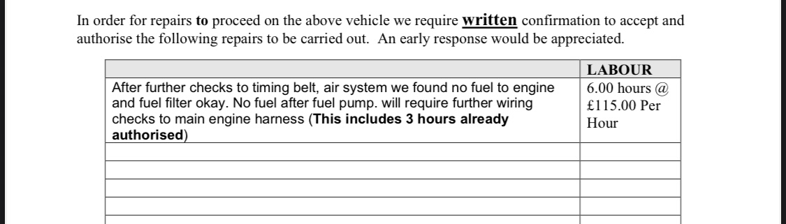

Also, I received an email to authorise additional time and it stated:
After further checks to timing belt, air system we found no fuel to engine
and fuel filter okay. No fuel after fuel pump. will require further wiring
checks to main engine harness (This includes 3 hours already
authorised
It seems strange to me that a technician would progress to electrical harness checks on an engine that is seized /wont turn over?
