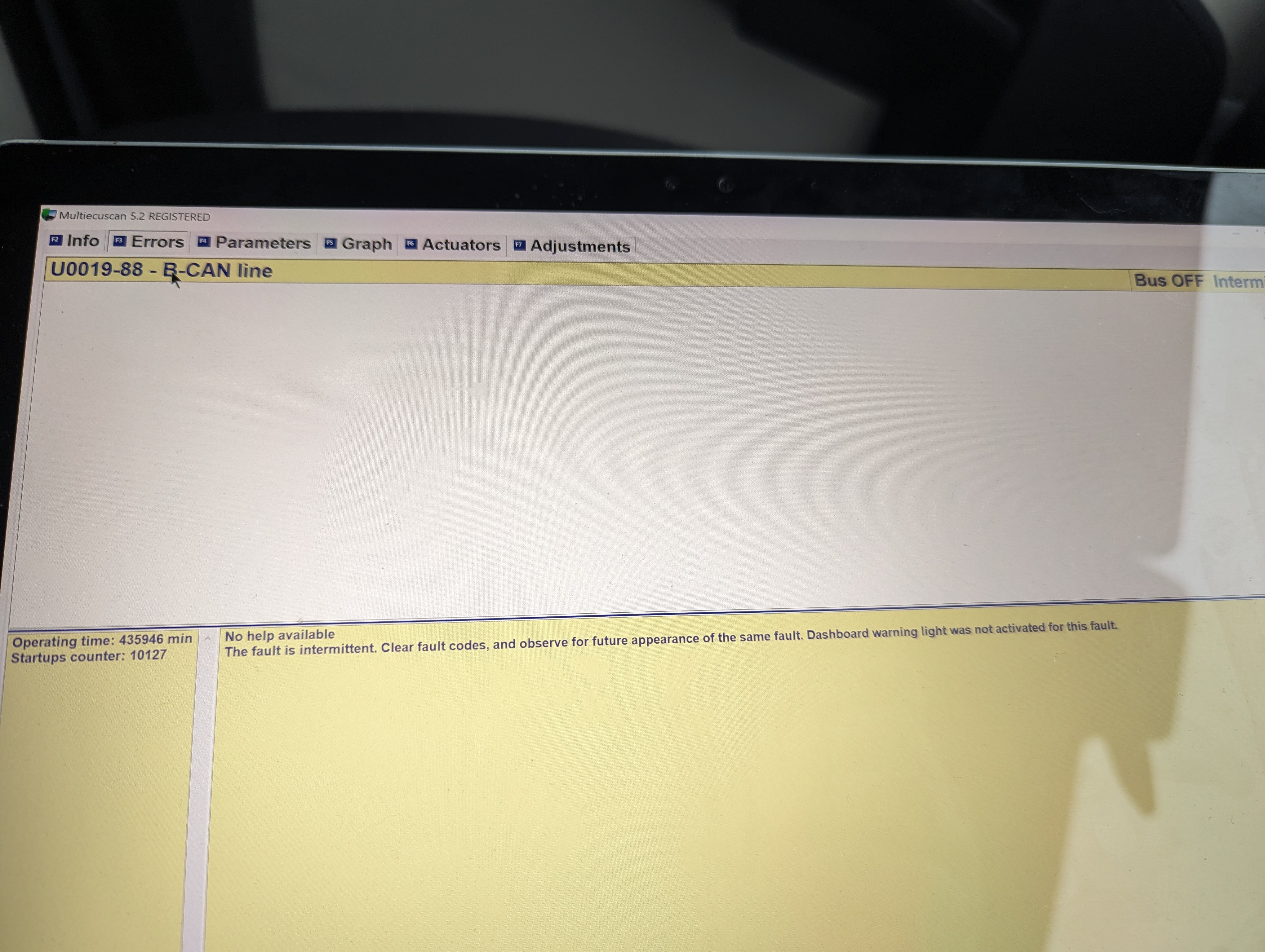

Had a po236 error and replaced map sensor and the boost solenoid. Still present, only kicks in when I've driven for a couple of miles or so; straight into limp mode. Just checked the body computer for errors, and it's logged a U0019-88. Cleared them both, both were present after the fault reoccurred. Could they be related? Noticed, when clearing the canbus error, that for the first time ASR was off, which just adds to the weirdness.
