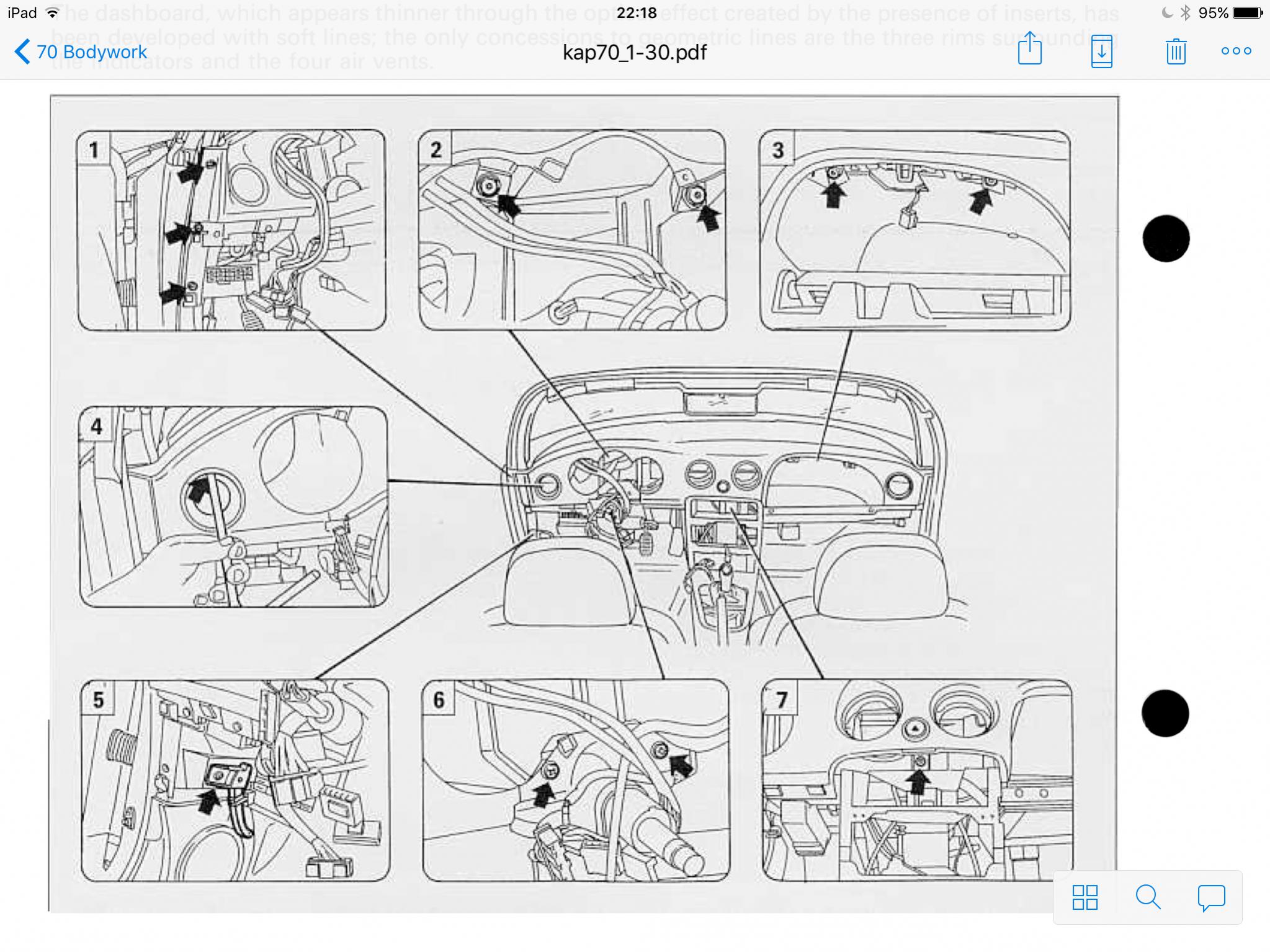

Thanks for the quick reply, even my fiat specialist doesn't fancy doing that ! It would seem that the hinge welded to the new door is in a slightly different place, where can I get a hold of a drawing to locate the dash screws please ?
Image from manual attached.
You don't need to remove the whole dashboard, only the body coloured sections which have obvious bolt heads on them.
I think anyway, that's how the manual reads.
