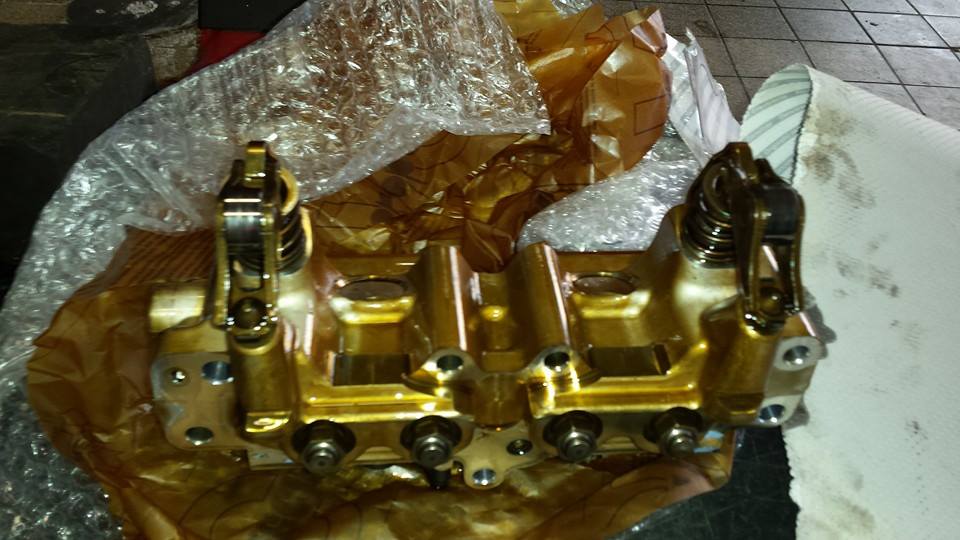

UNI Air Module. ;)

My brother had the uniair module fail on his 500 - it was done under warranty - his symptoms were poor starting and high oil consumption - it didn't seem to affect fuel economy.
Just had one fail on my 4 x 4 (see separate thread) symptoms were the ECU just shut down one cylinder which leaves little to play with...
With respect to driving it to the dealers, I think when they did that with mine it probably hastened the demise of the clutch (pulling away on one cylinder). Good luck
