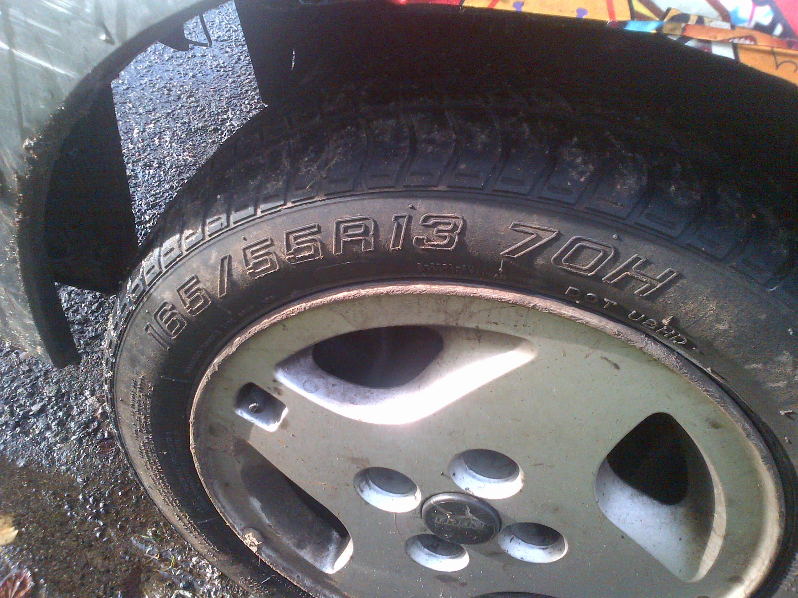

165/55/13... Need diff tyres ;)

As an everyday tyre the Bridgestone RE040 as fitted OEM on Lotus Elise iirc are only £57.20 each from Mytyres.
The only option other than Nankang in the 165/55/13 size is an old design Pirelli P700 which are £62 each from Mytyres.
So more modern design tyre plus saving in price what's to loose. The only issue is you want a wheel no wider than 6" which for aftermarket is limited as most are 6.5-7" wide but does open up OEM Lancia/Fiat/Alfa wheels which can often be picked up check though off-set needs to be checked.
