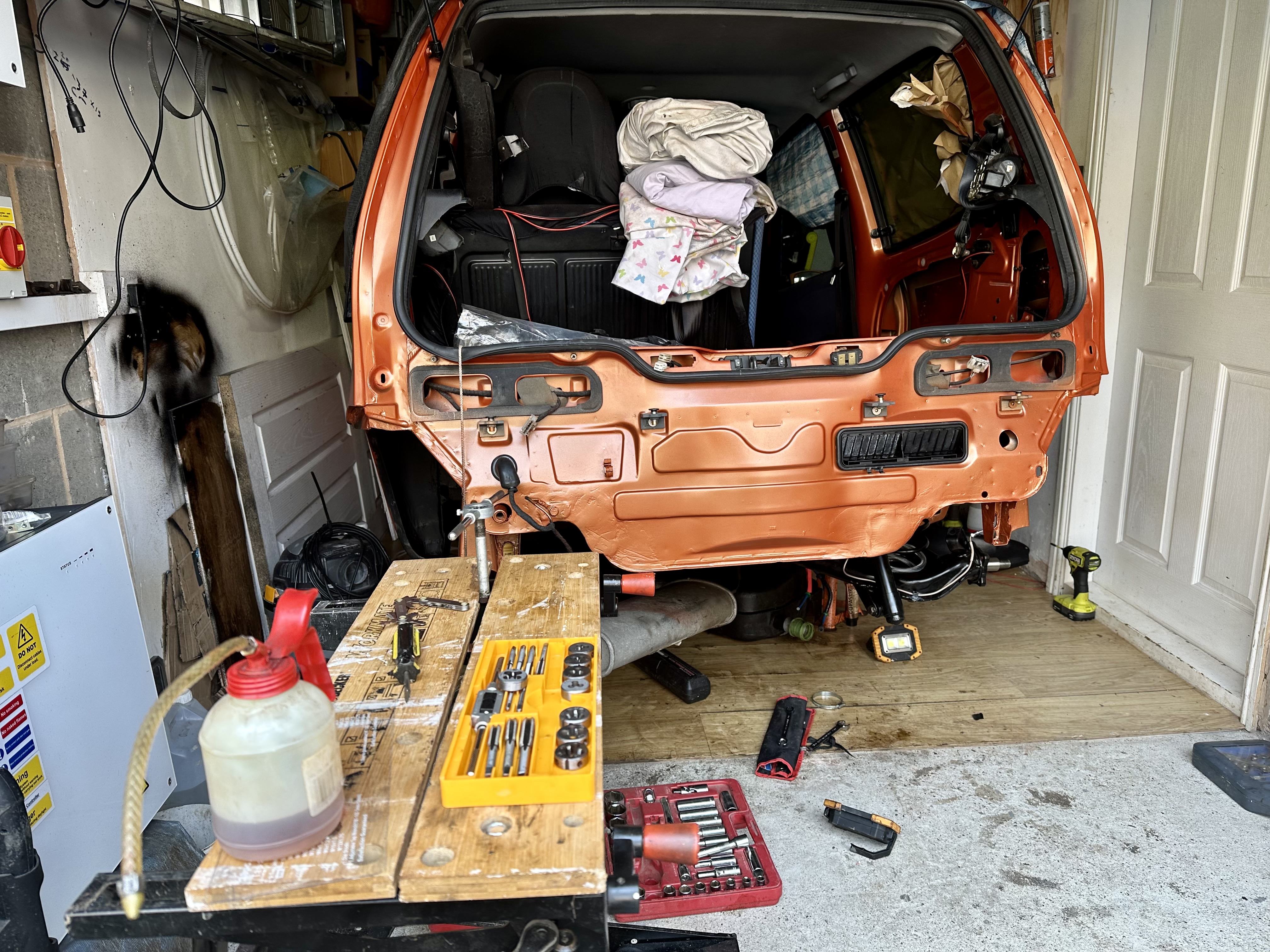

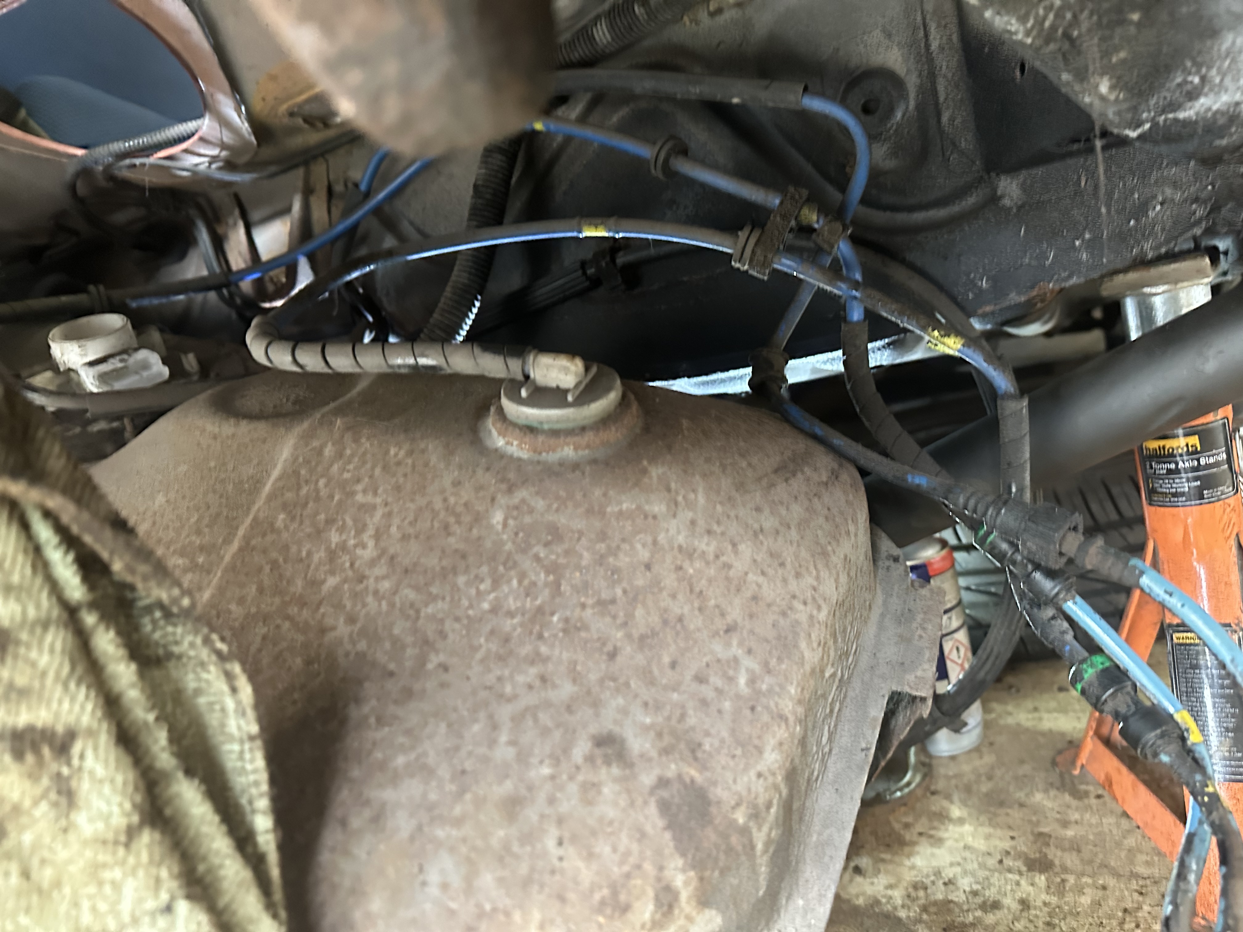

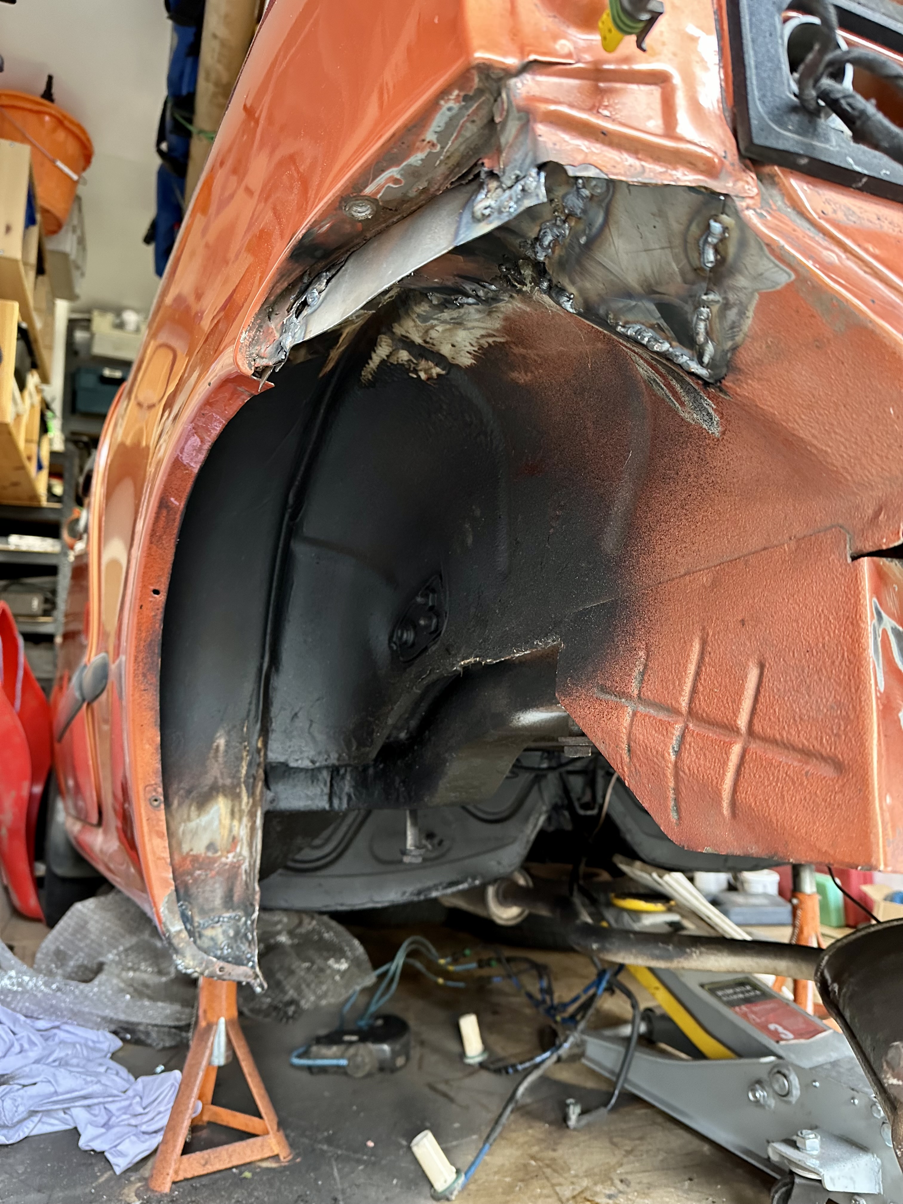

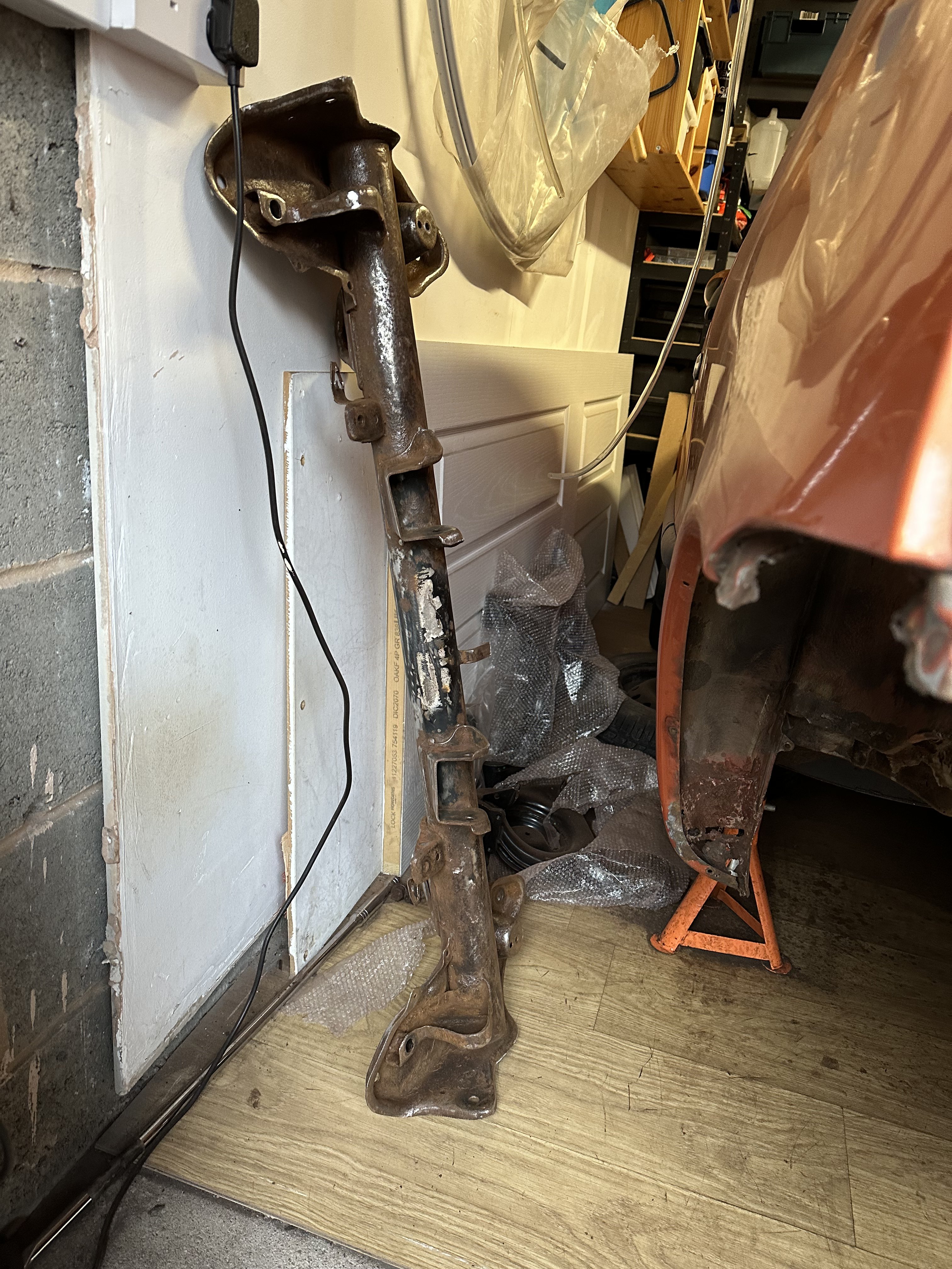

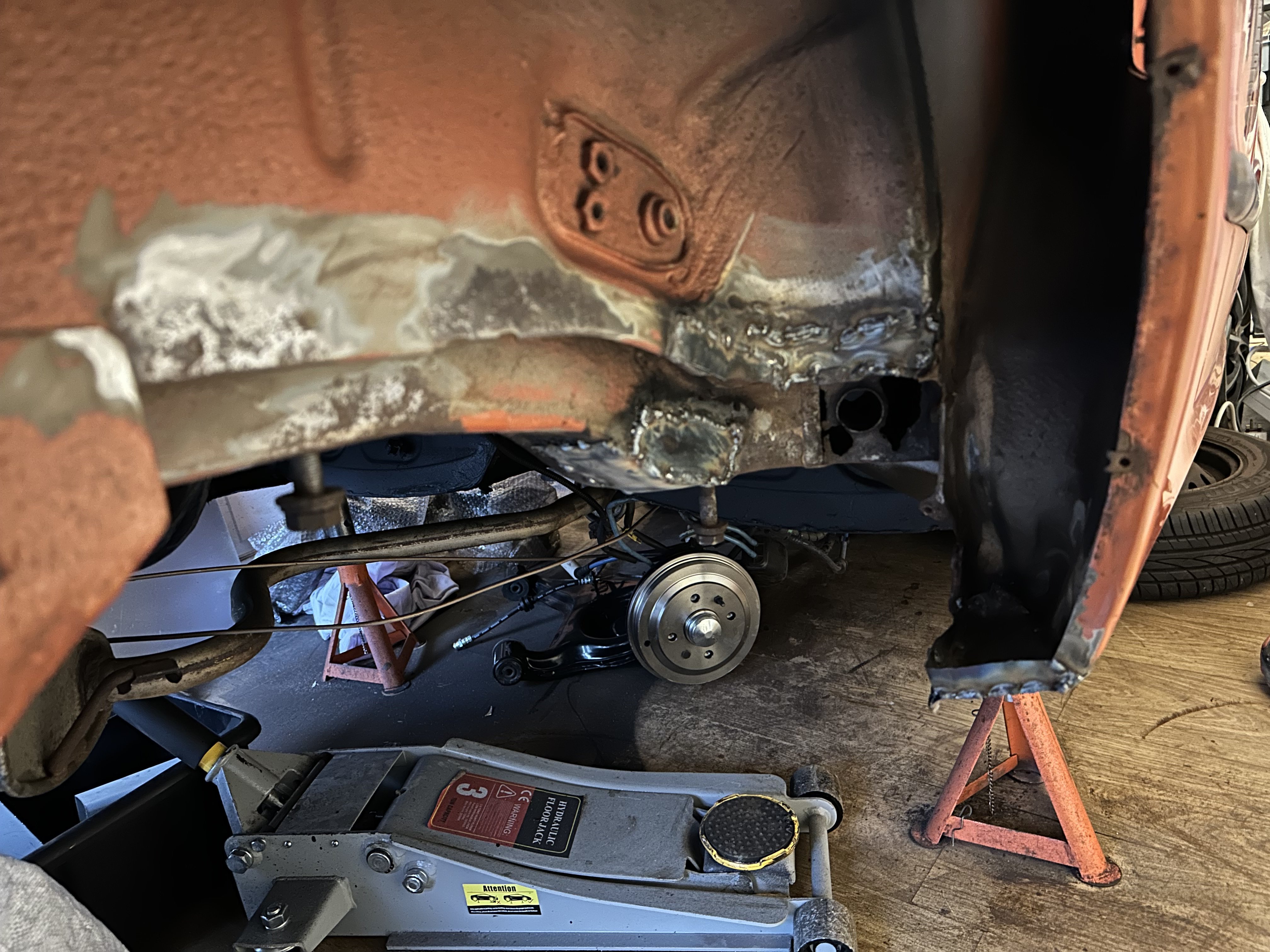

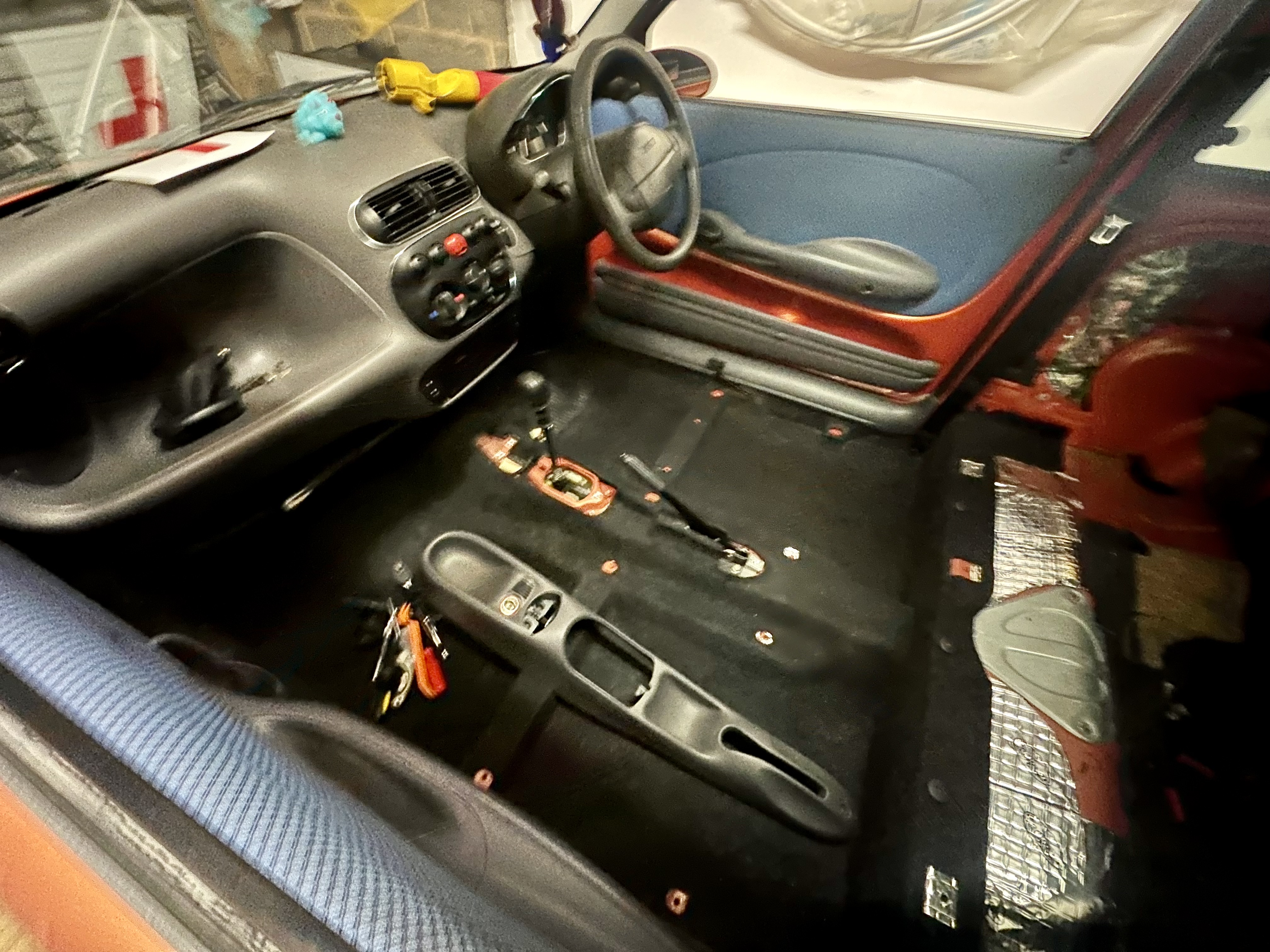

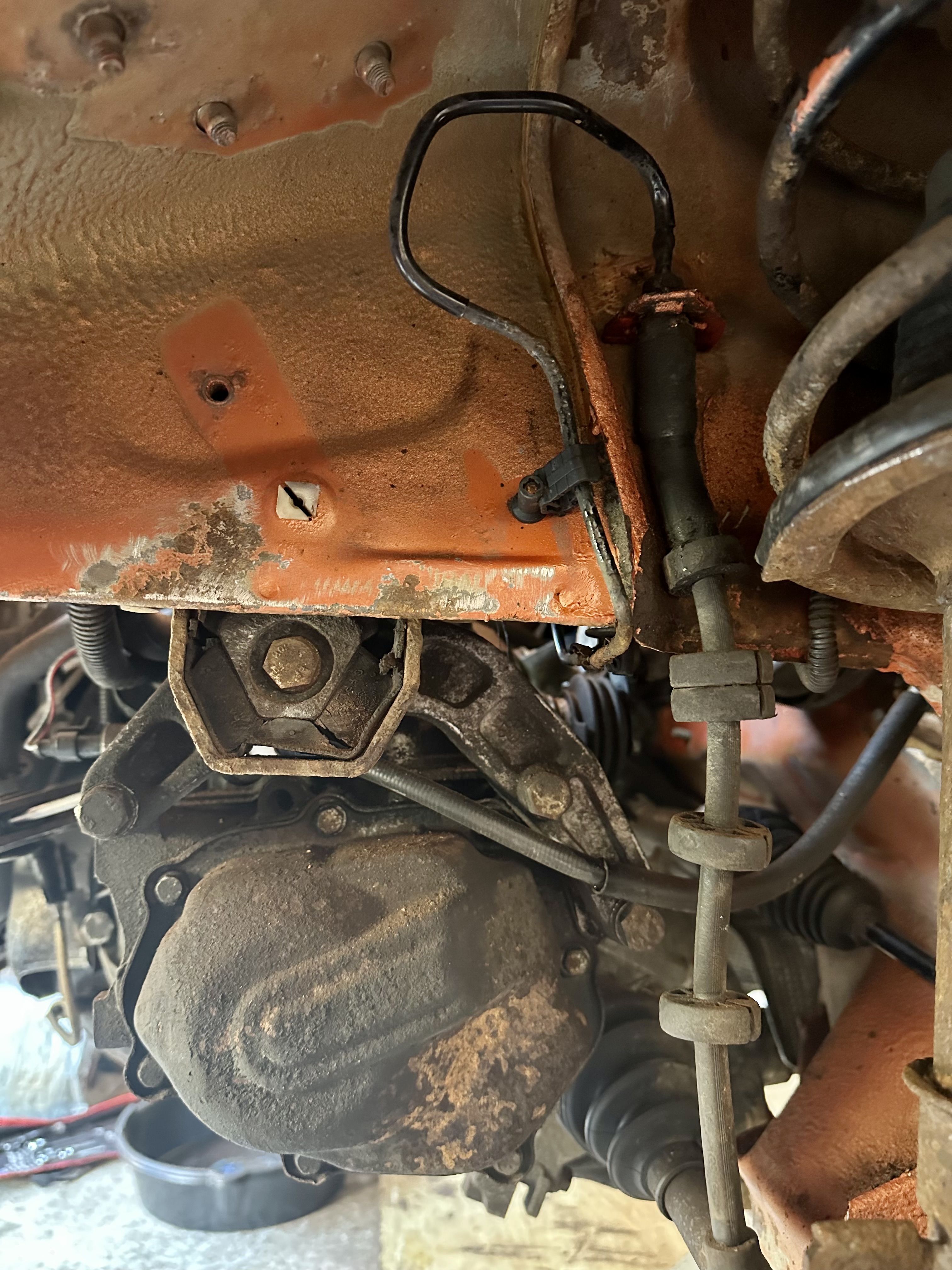

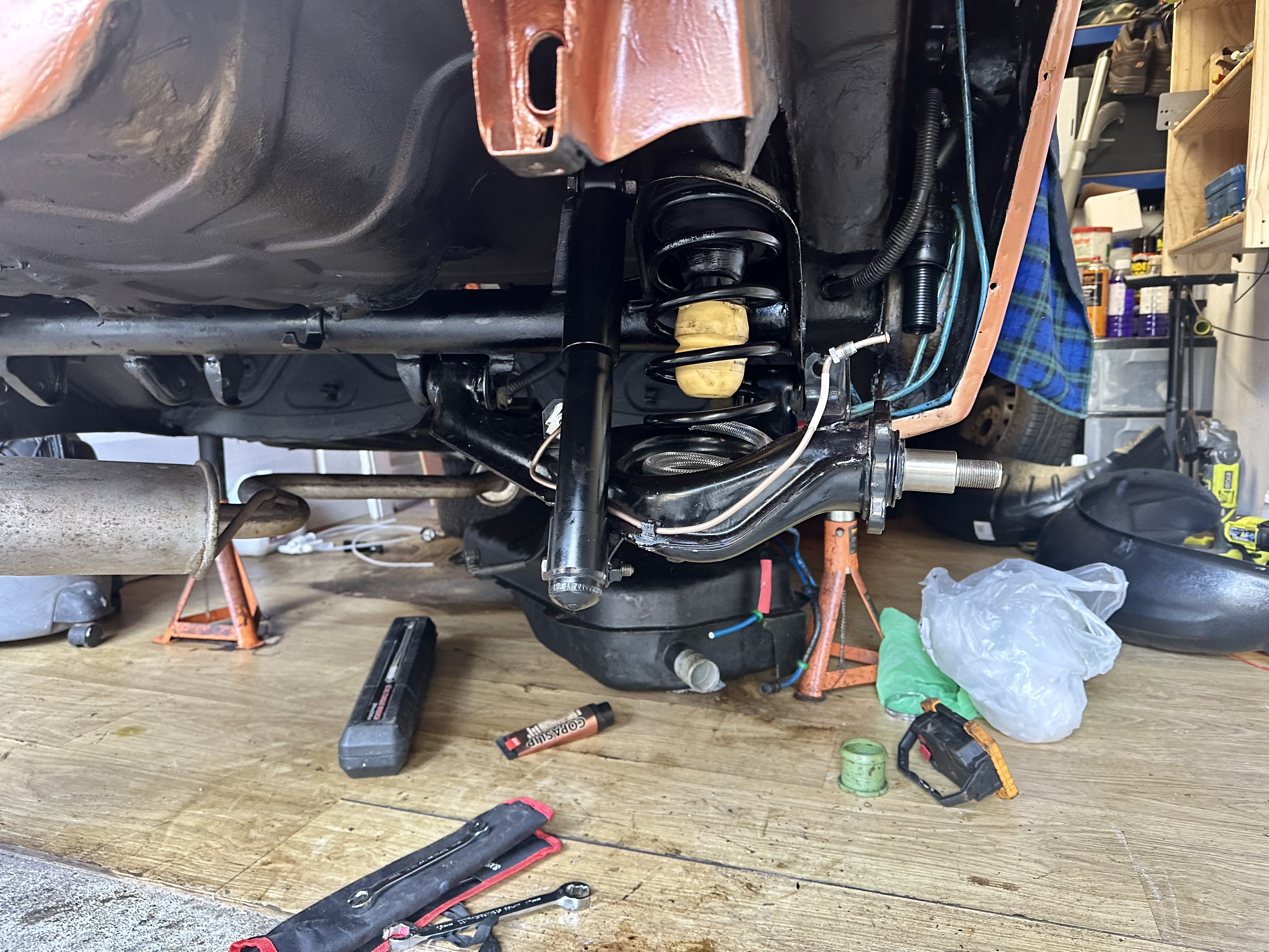

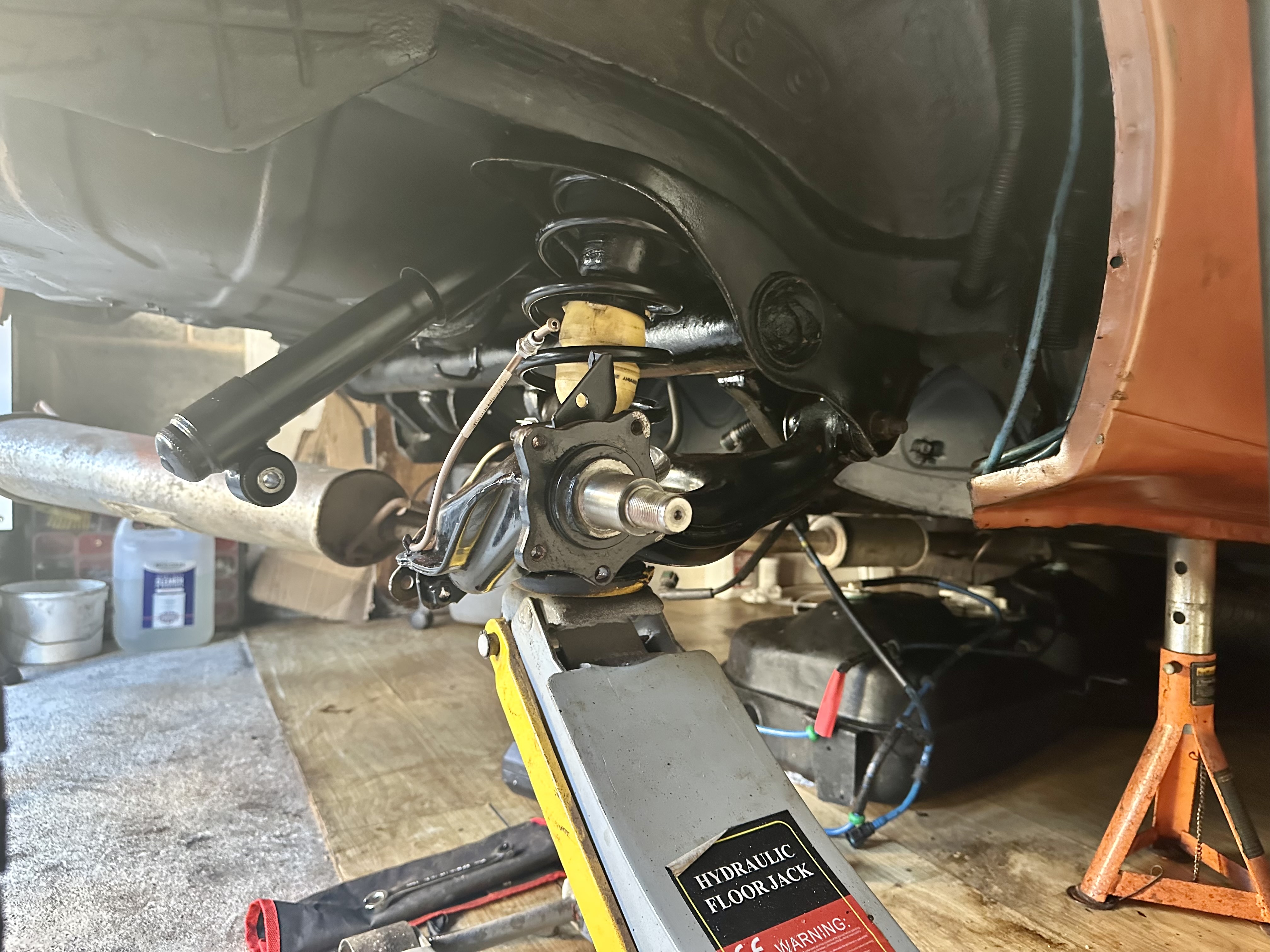

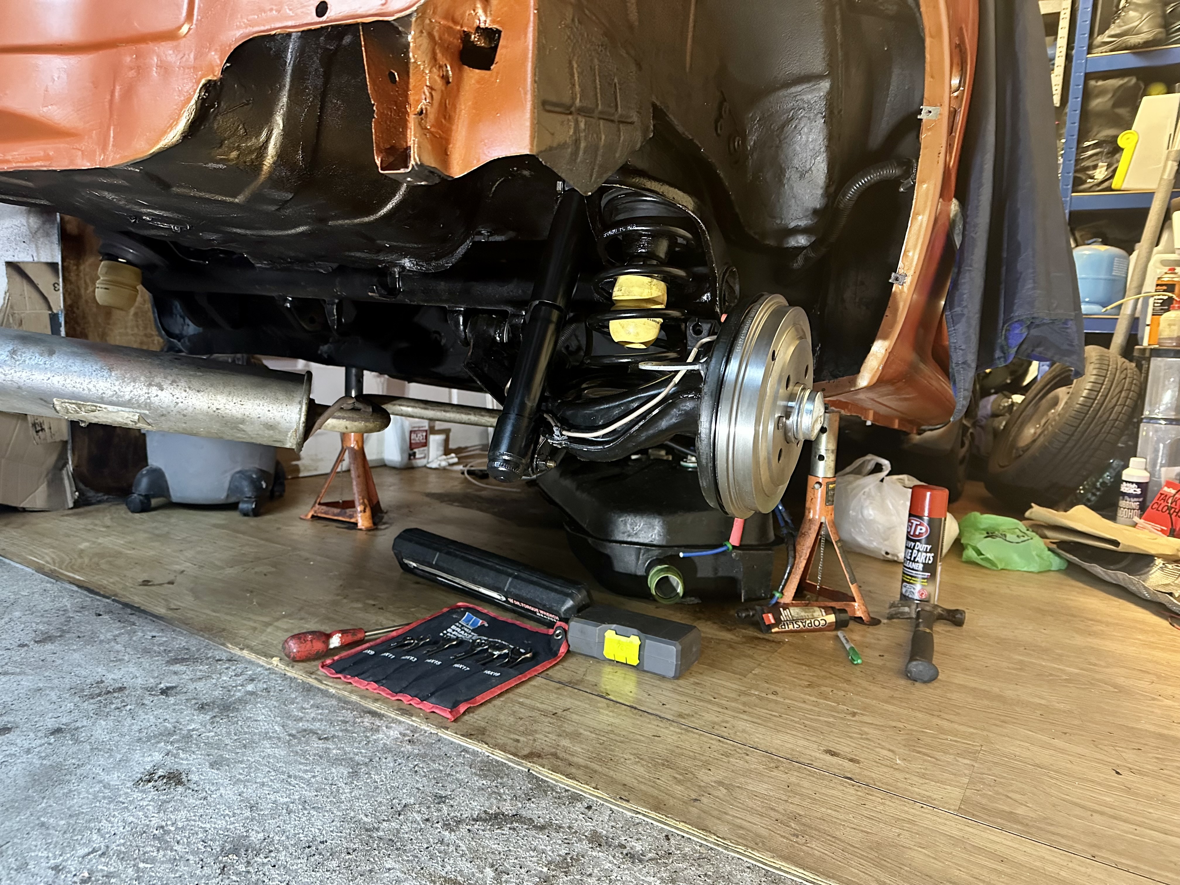

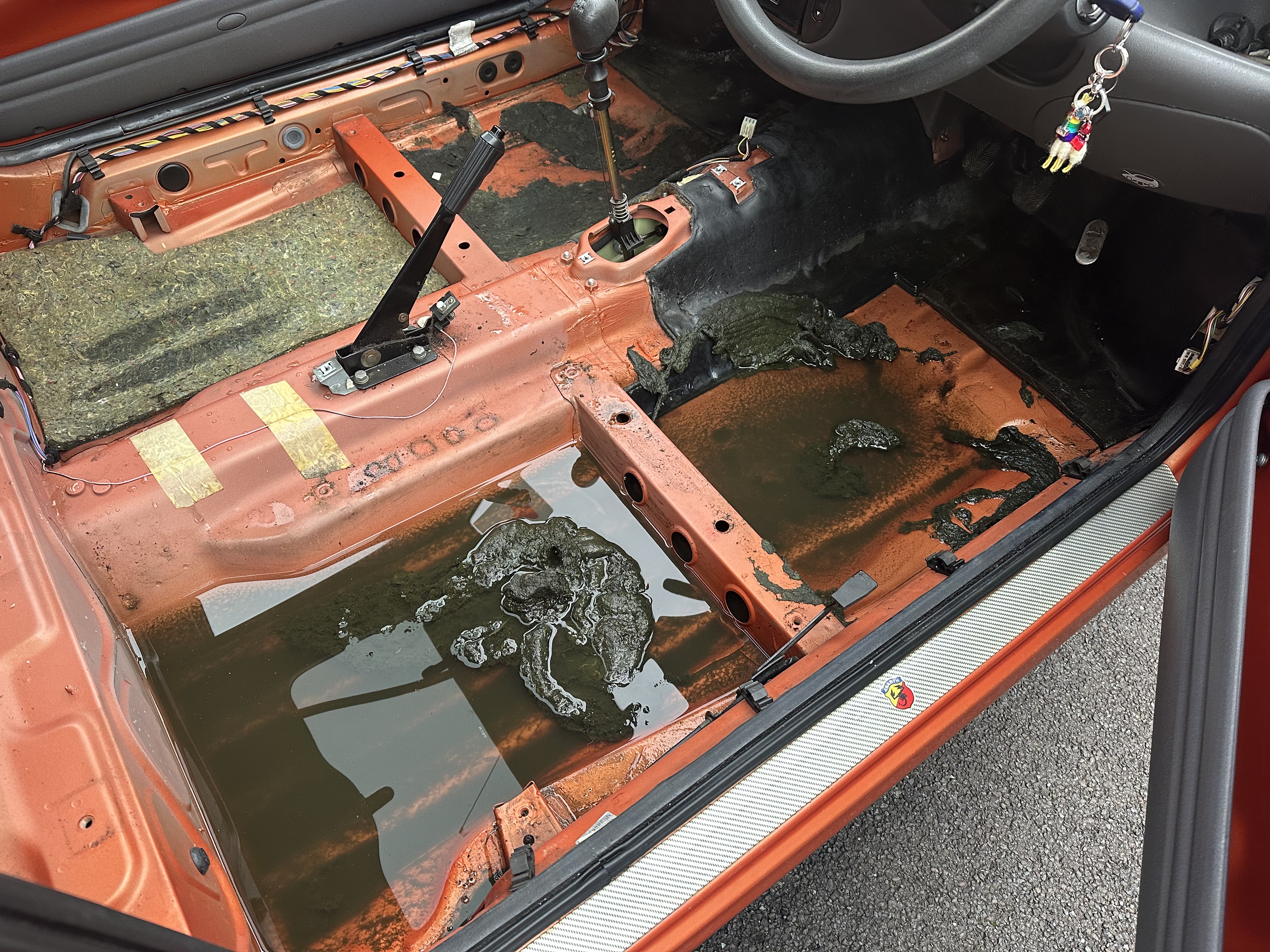

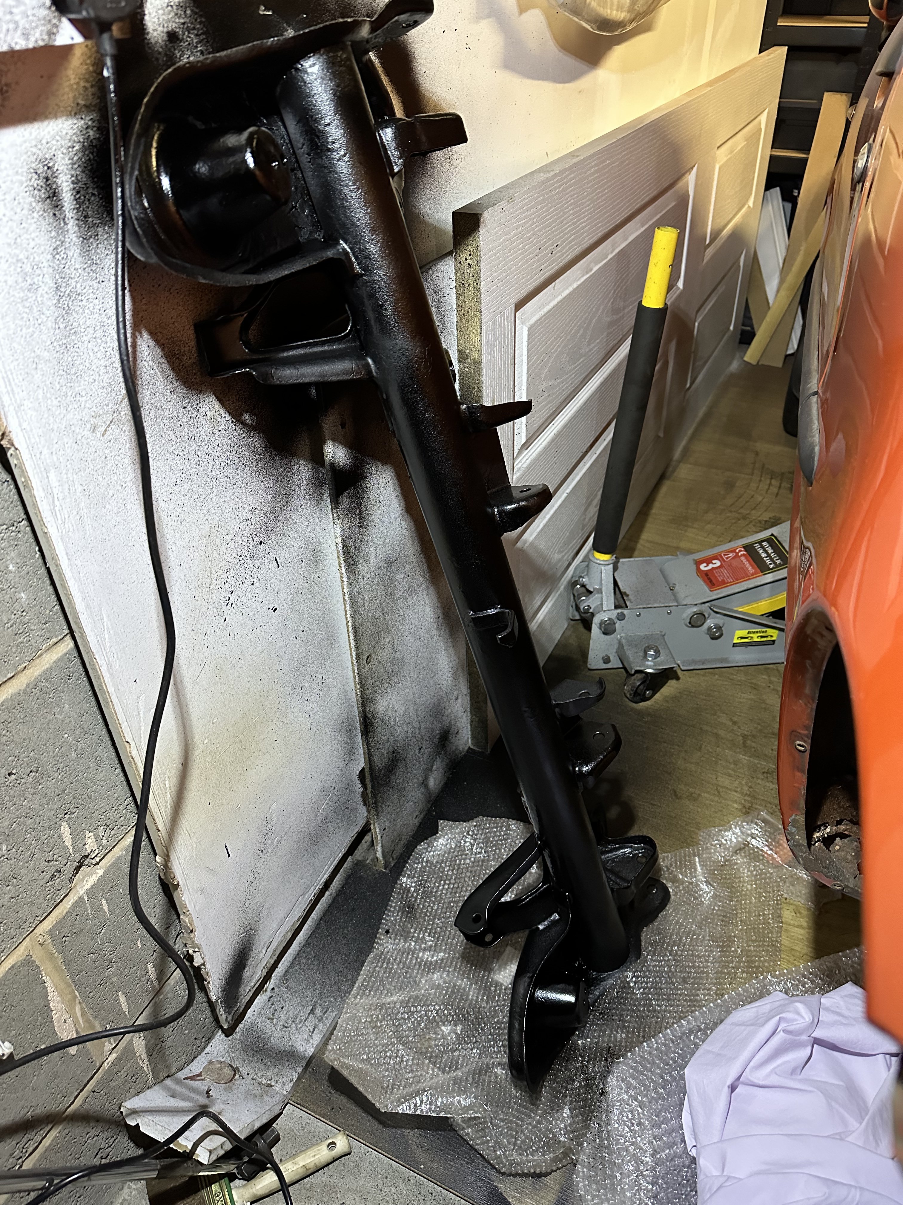

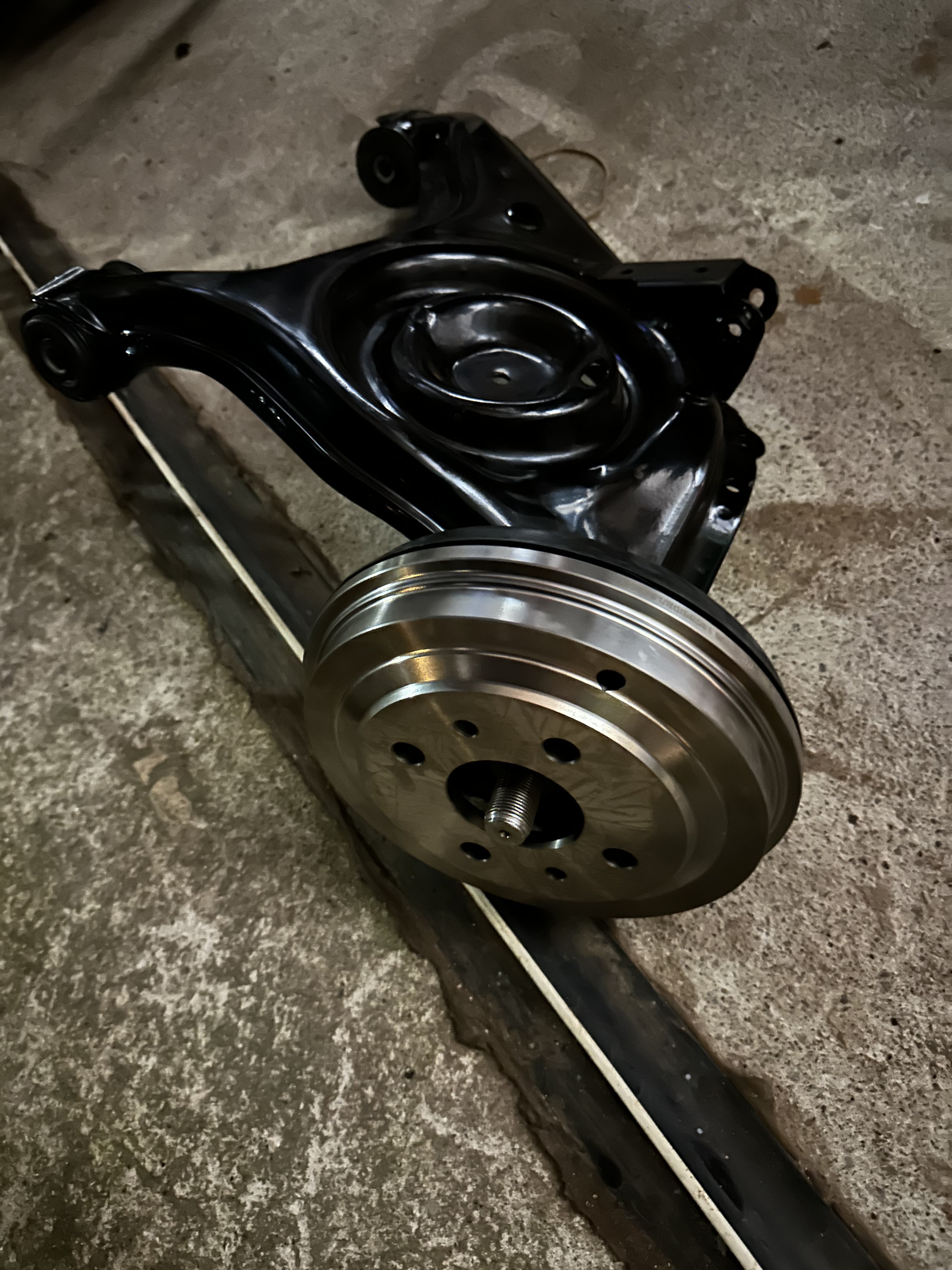

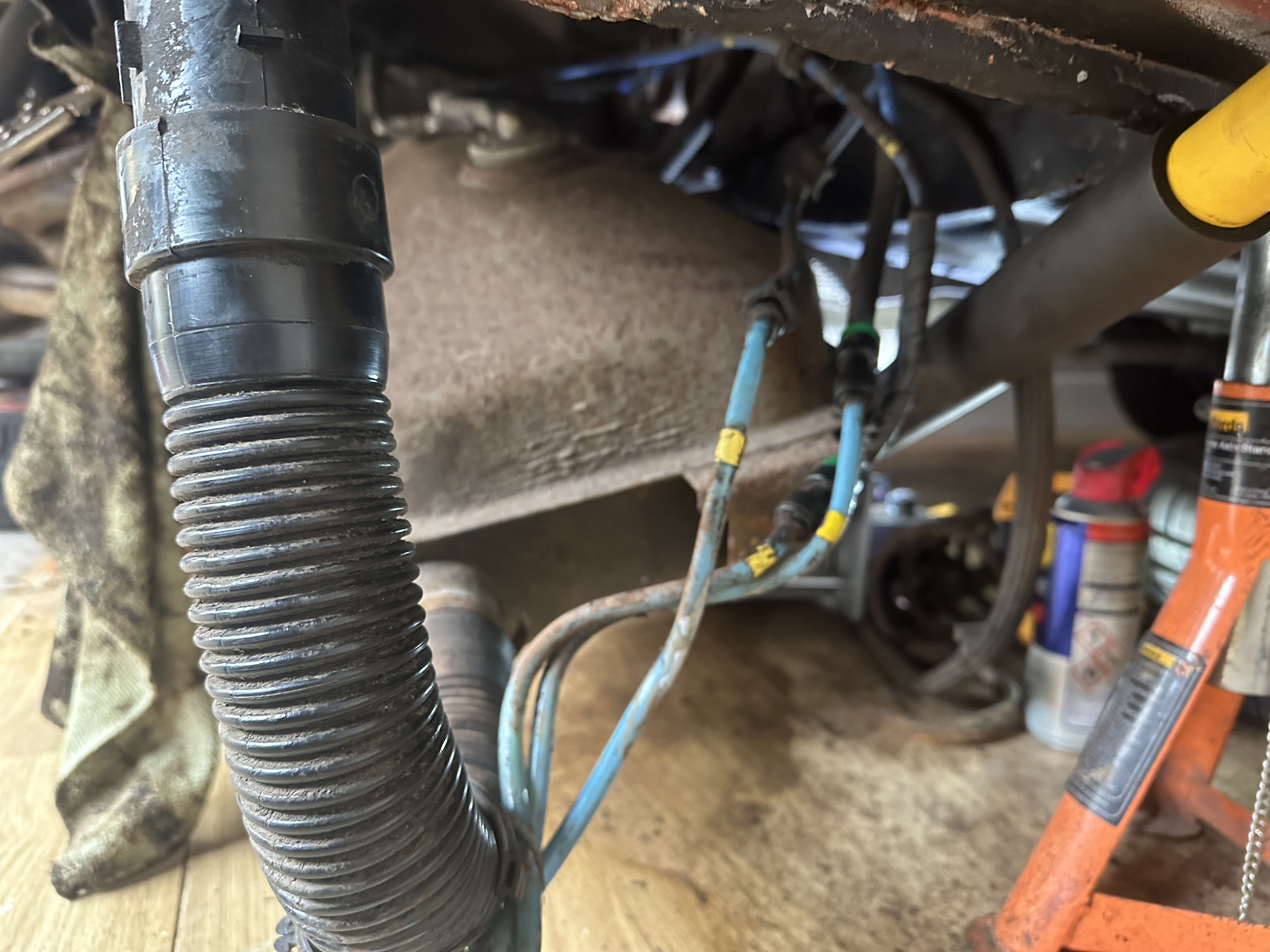

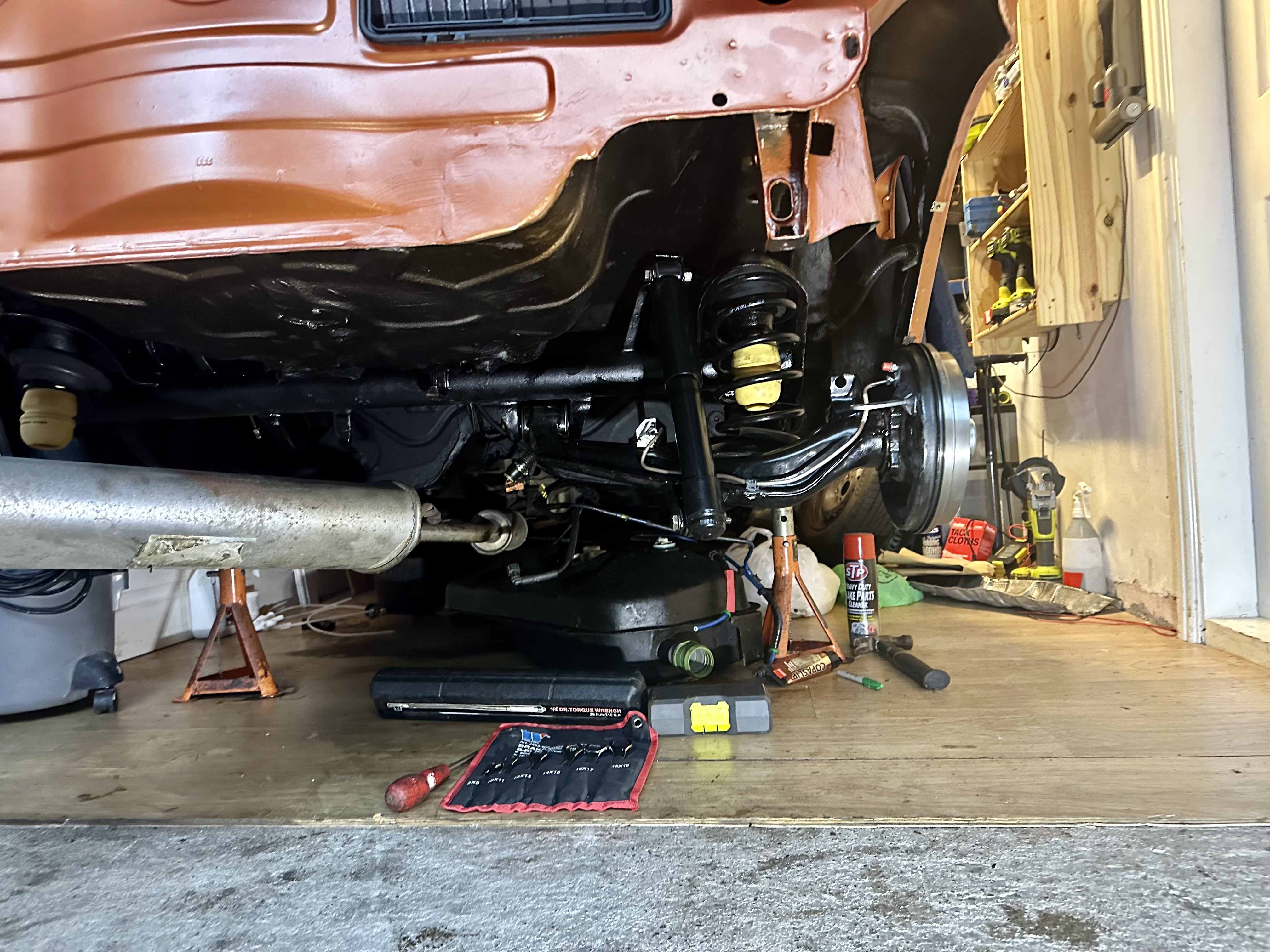

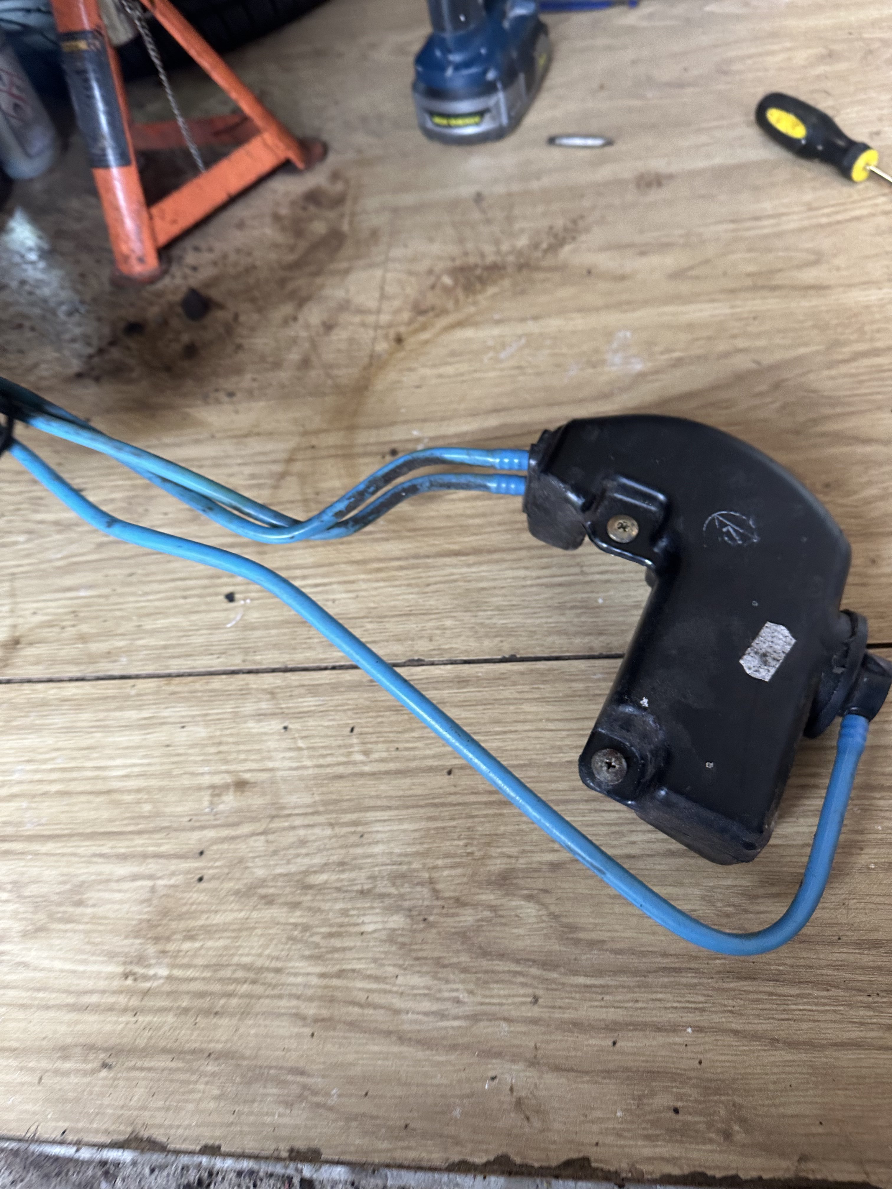

Hope this is the right place to post this and hopefully some may find it interesting to follow as I’ve enjoyed doing it . I’ve been working on daughters first car for a little while now . first it had a leak which was a nightmare to find but while interior was out we had a big clean up and replaced worn out bits like under carpet etc , also covered it all over floor with soundproofing And filled side walls with soundproofing too . .2nd , there was a knocking at the back end , I jacked it up and it was a bit rusty under there . Found out the shocks and trailing arm bushes were shot , also both coil springs were broken too . So I decided all out and replace what was needed and clean up the rust then undercoat and wax olyed , Once all back together Lanoguard everything. In the Meantime a few little welding bits need to be done but nothing major . i will also be replacing brake pipes from master cylinder to rear brake shoe cylinder and also the handbrake cable .i ended up rpl the whole trailing arm as it was a nightmare trying to get the old bushes out 🥴 . i hope this has been done right
this is my first time at this lol . I will update as I go along , well I hope I can ! . Not bad job for a postie 👍😂

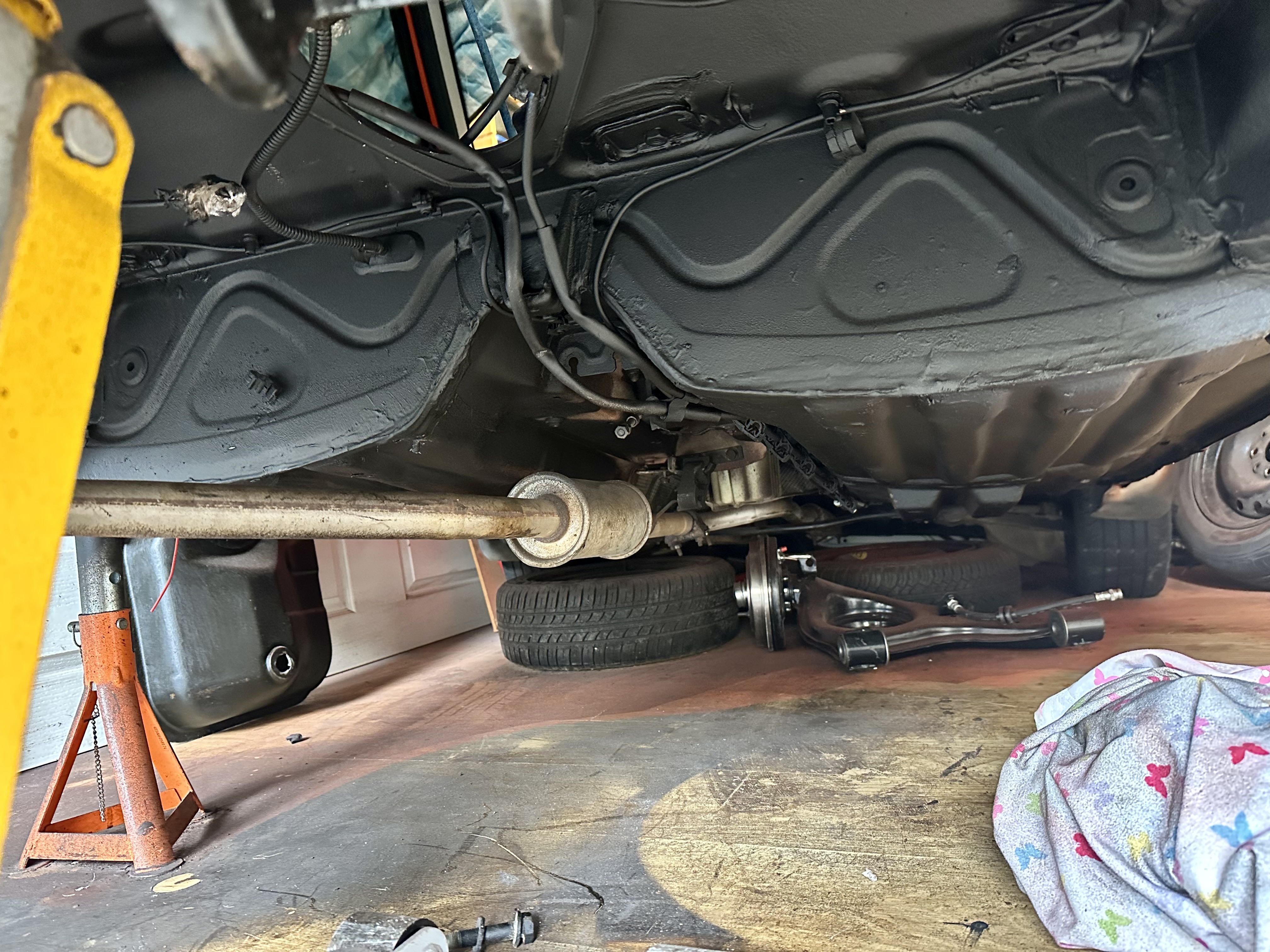

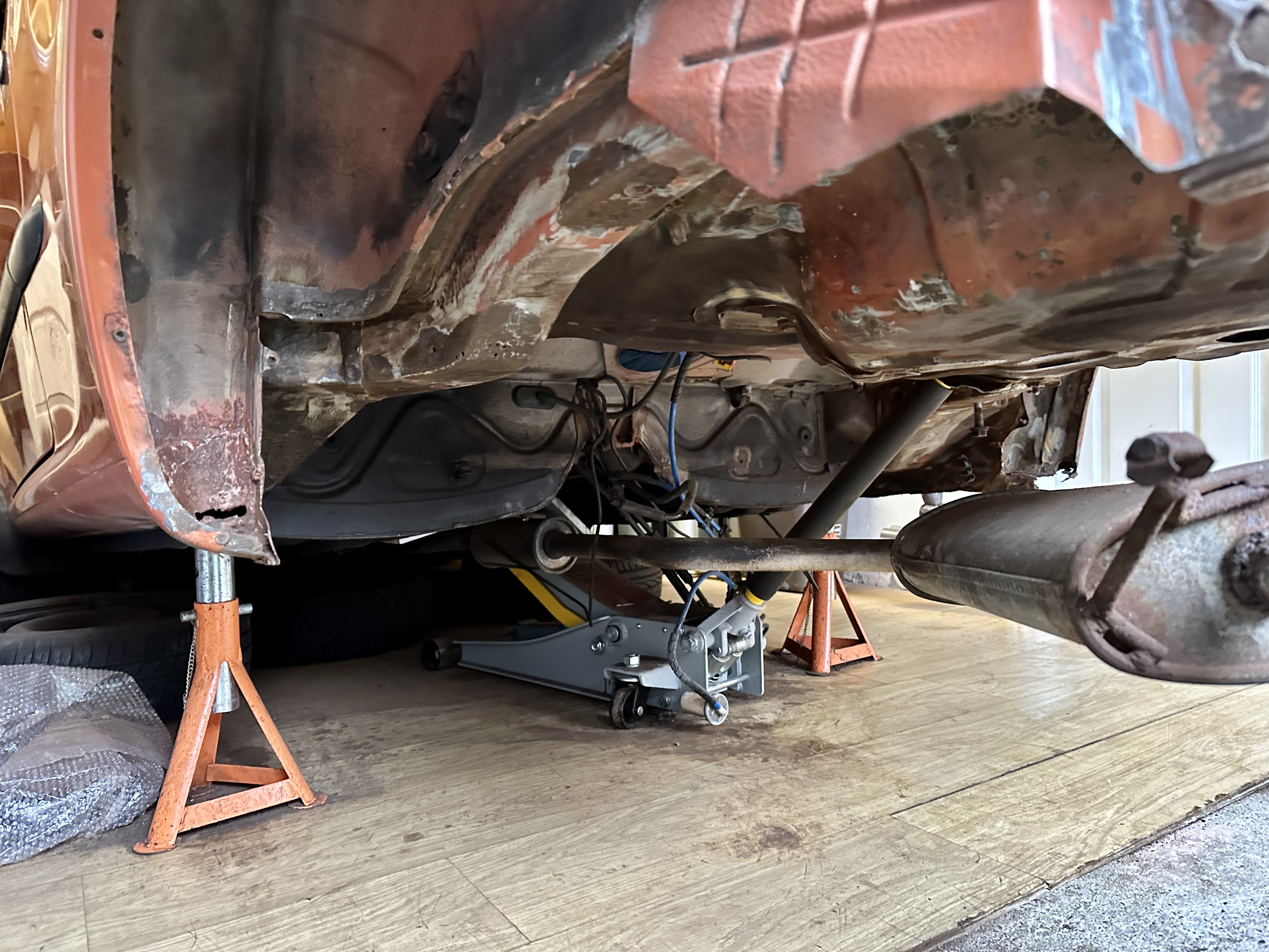

Bit more done Surface rust all cleaned up then zinc primer then wax olyed , hopefully the welding will get done in the next week or so

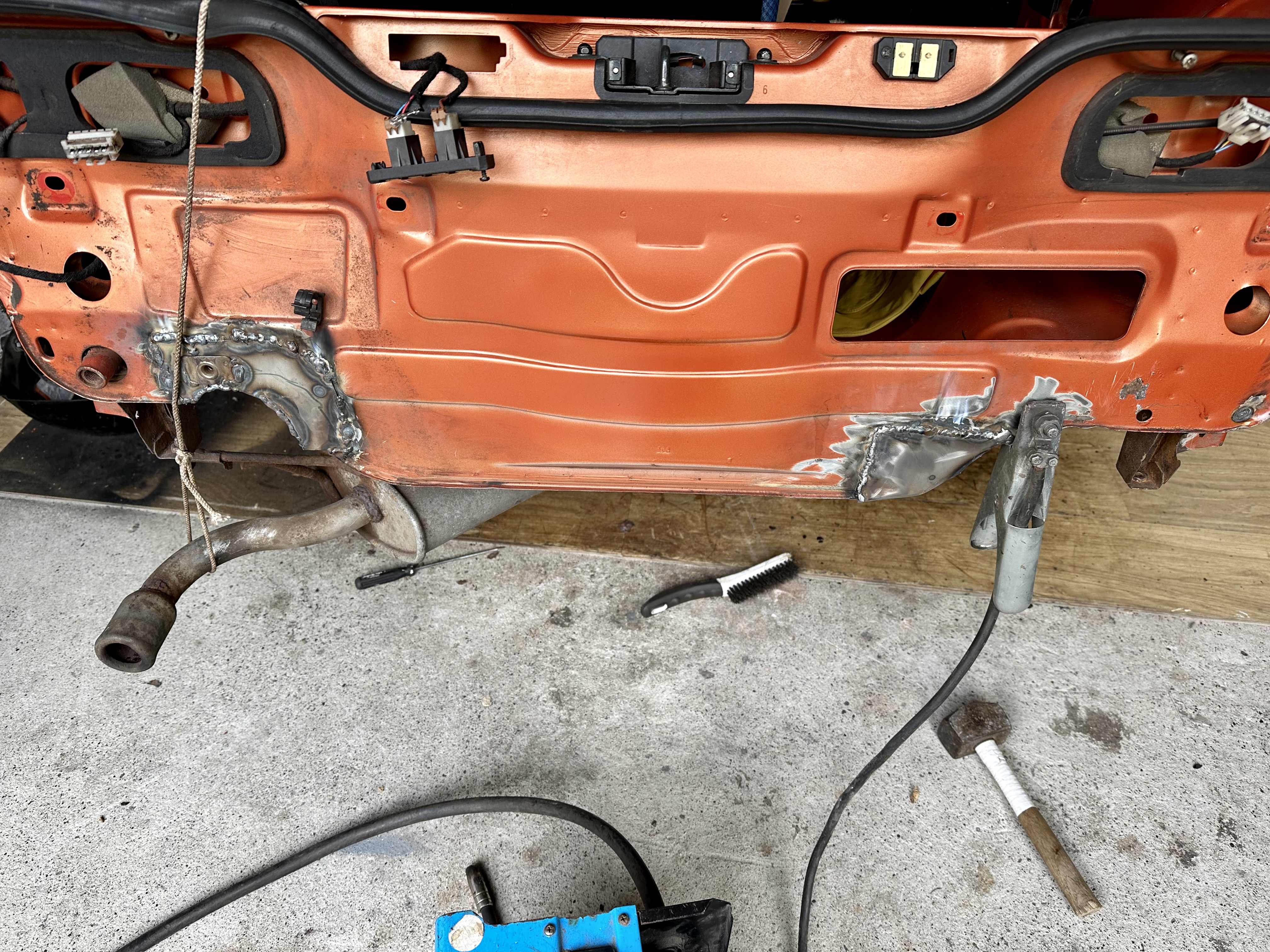

thank you very much for your help , i have enjoyed this . the welding was done by someone that knows lol . I am now teaching myself after he showed me . I have now purchased some lanogaurd which will go on after everything .

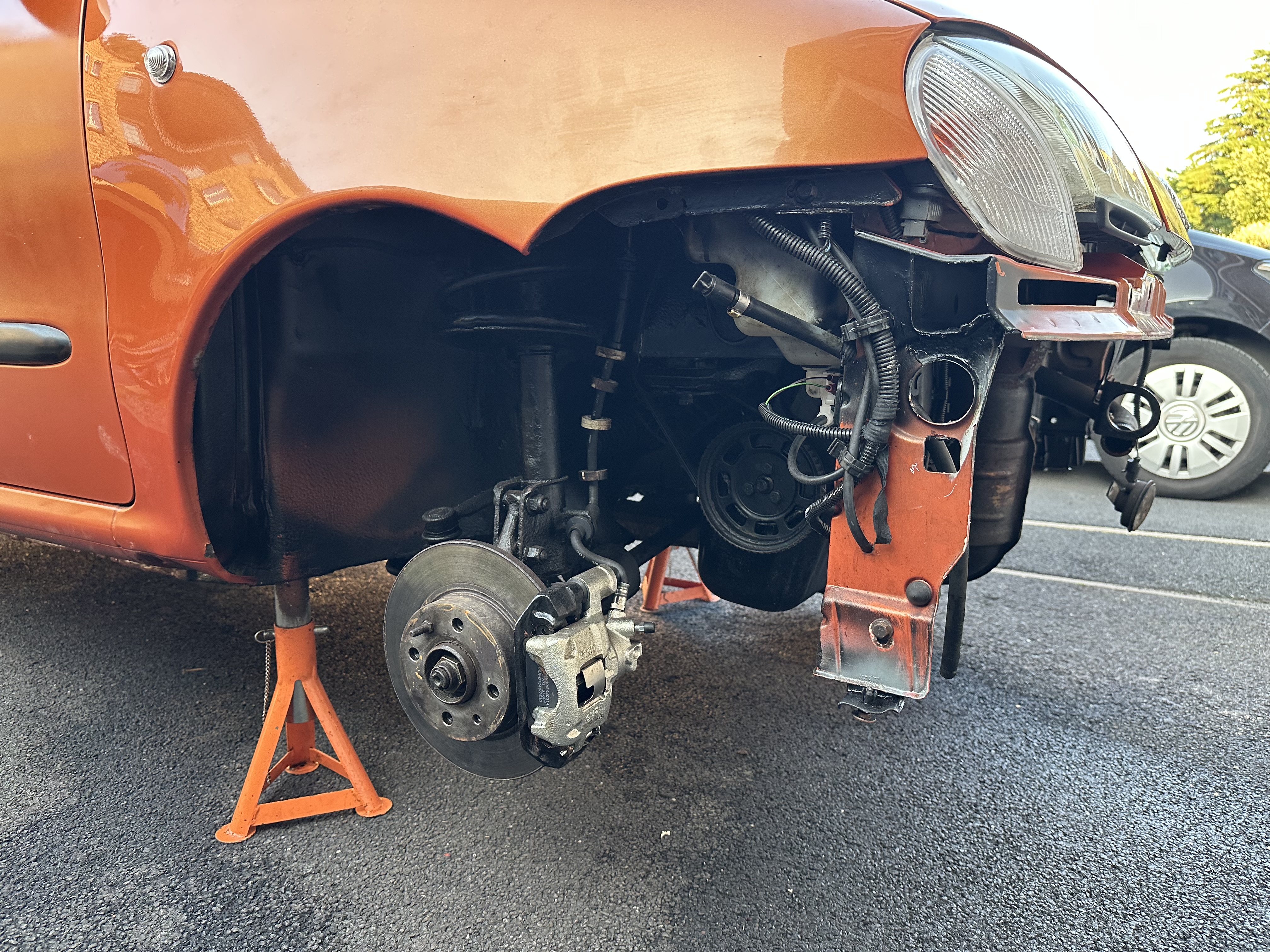

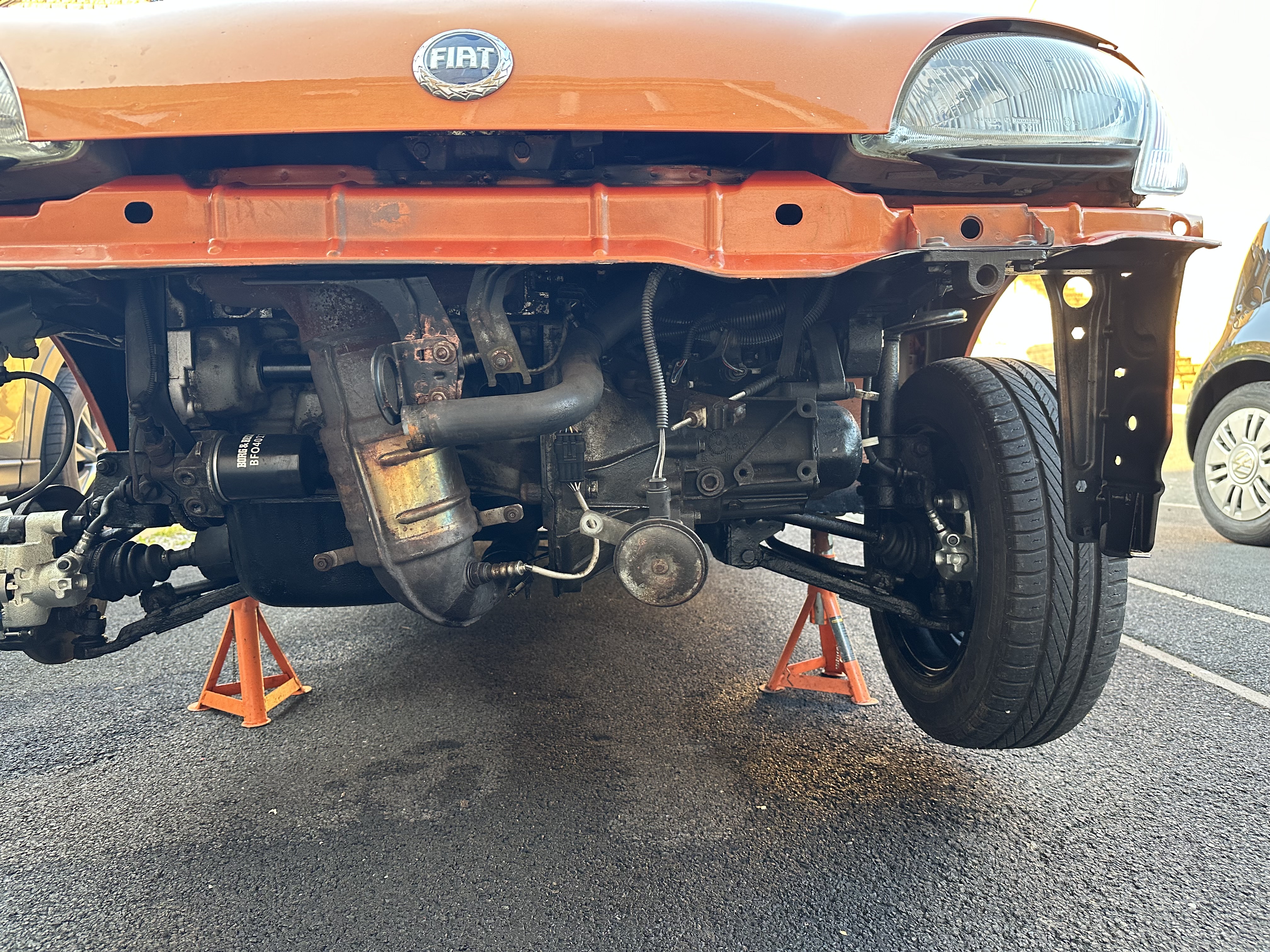

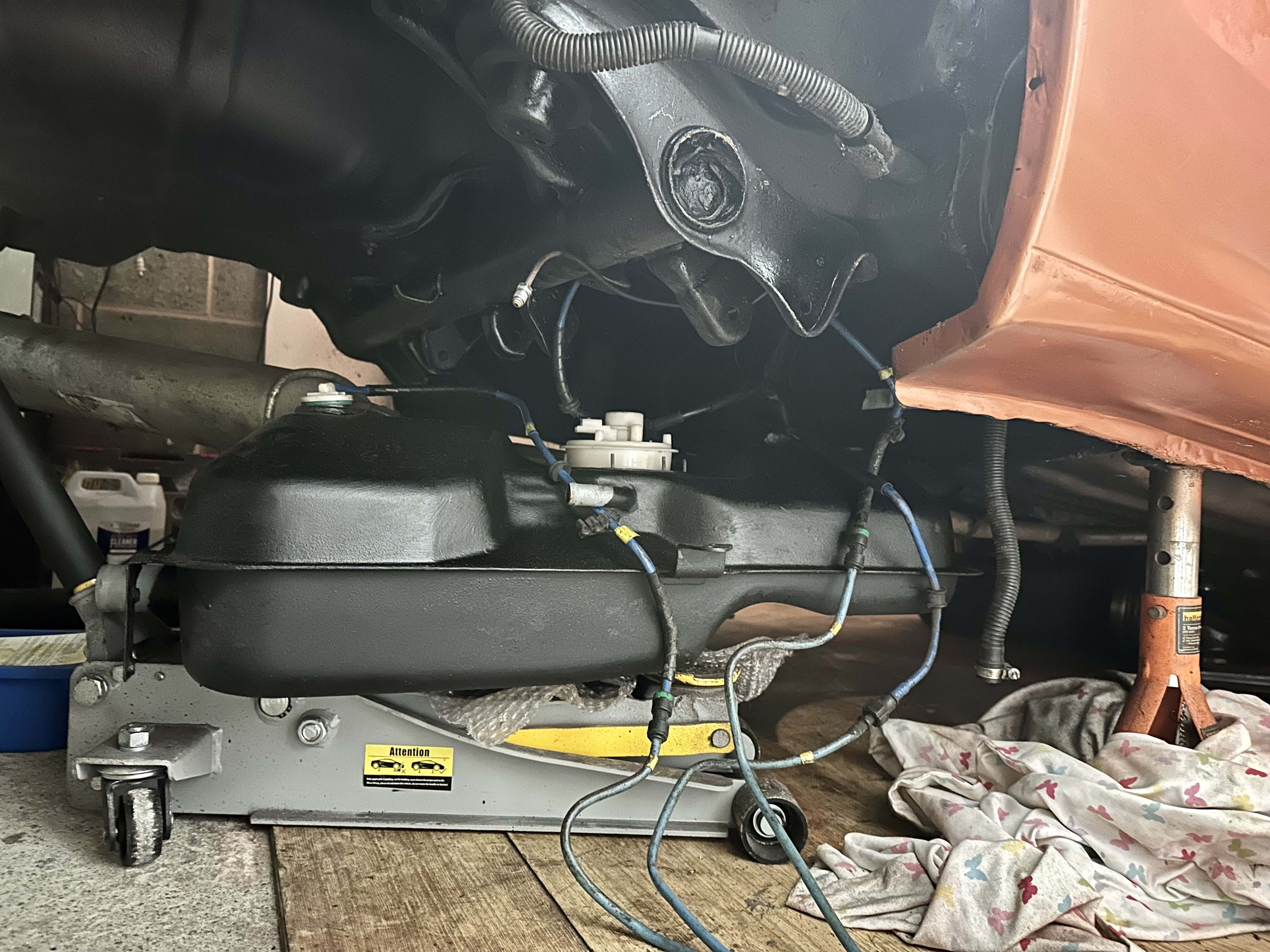

turned around now front brake callipers and pipes also new coolant , air filter , oil filter ,new oil sump and oil . Shocks ok for a bit longer , theres no front end knocking so 🤞 . all de rusted and Lano guarded .
now to cut and buff new paint , MOT and Tax . Then my daughter can drive off and I will not worry as much , maybe !
oh engine is sound, new gearbox and clutch were fitted by previous owner to sell .

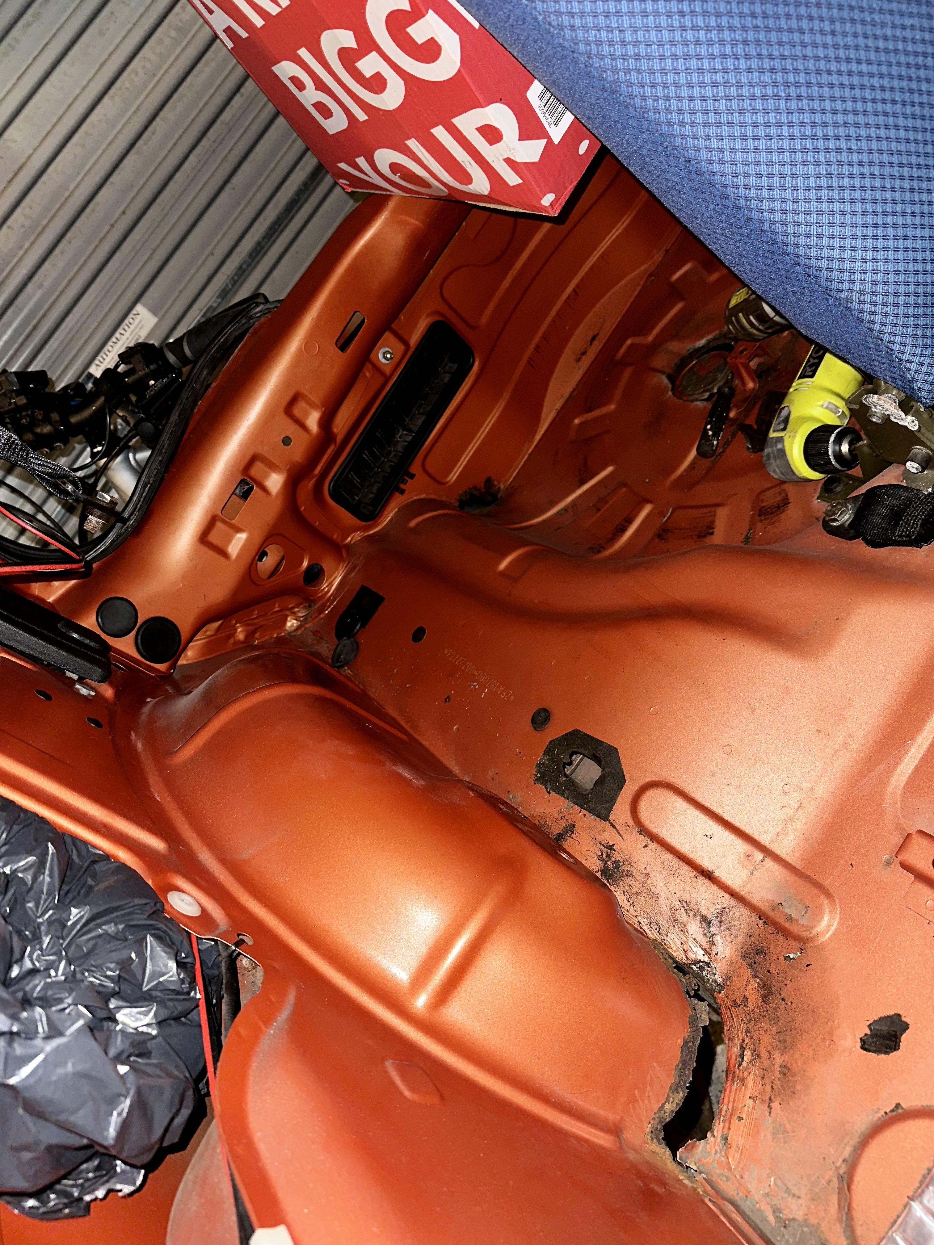

That's really excellent work on a car that many non-Fiat people would have scrapped without a second thought. Some very familiar rot spots there. I had a Seicento the same colour and it looked fantastic on top but there was a world of rust and rot below. Hope your daughter appreciates all the effort!

Brilliant, will look forward to more pictures. The ones you have posted are a very useful reference guide as all of these cars need more or less the same procedures carried out and you have done it really well. It's certainly inspired me! I reckon that's one of the best Seicento colours (I can't remember it's official name) and my Seicento in the same colour used to look stunning when the sun was on it. Keep up the good work!

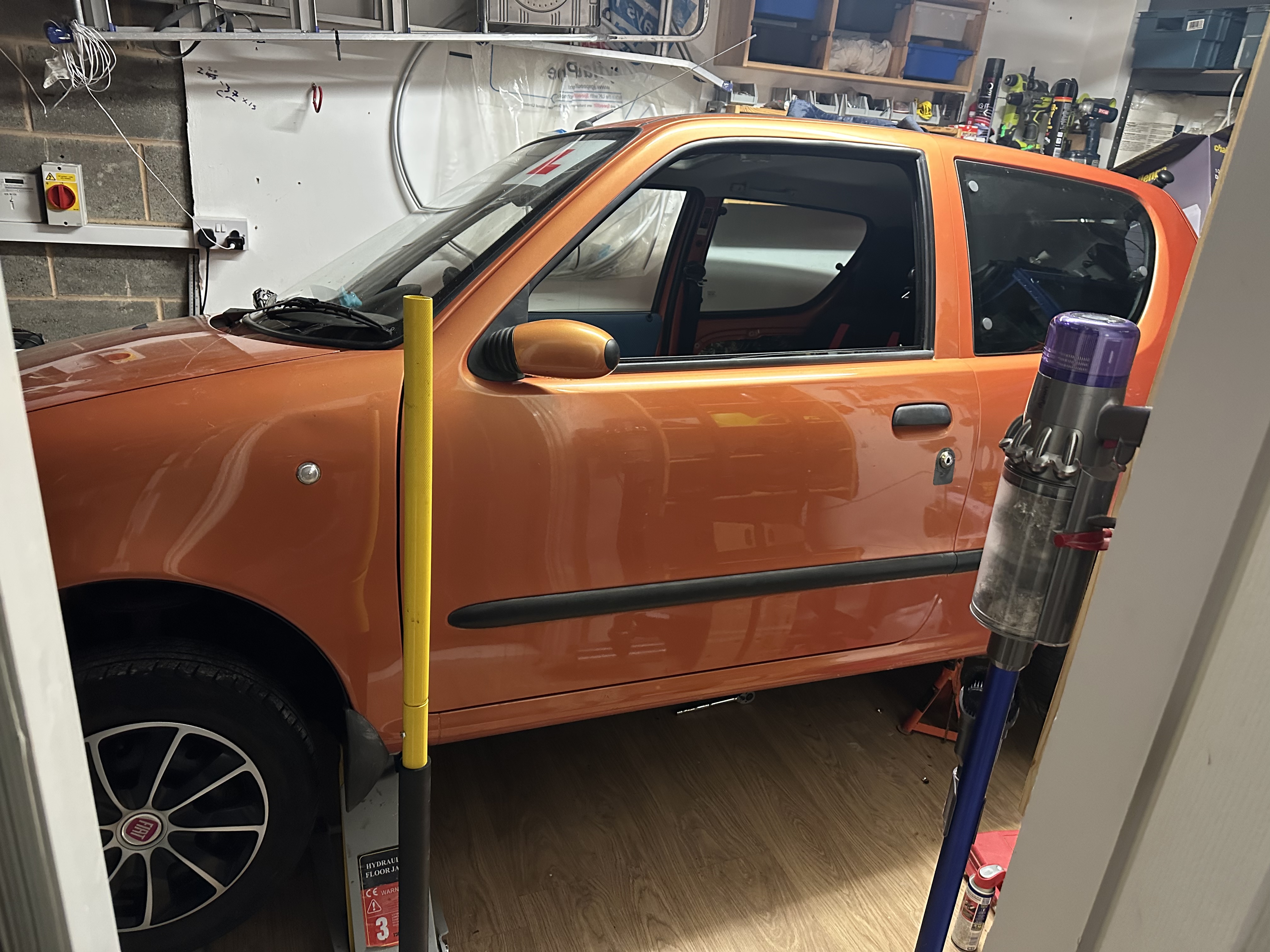

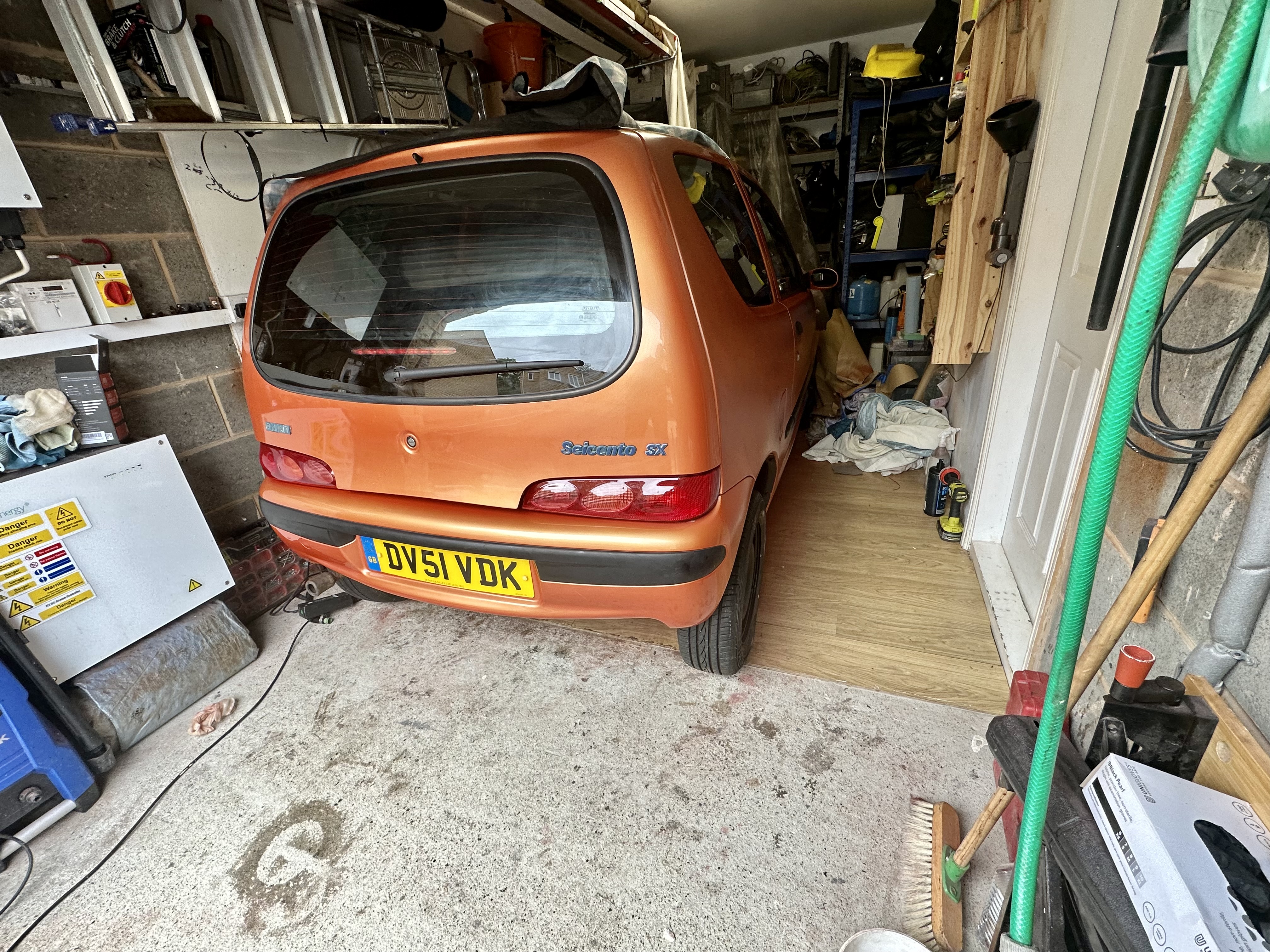

Waiting for MOT , yep it passed with all clear 👍 . Still jobs to do but it’s now drivable so my daughter is happy , i can do the little bits as and when . Sunroof was sealed shut with mastic by previous owner, may spray the bonnet and other bits as new sprayed panels look great and can now see how much the original paint has faded . no rush but now it’s time to make a work station for the garage 😜👍👍
