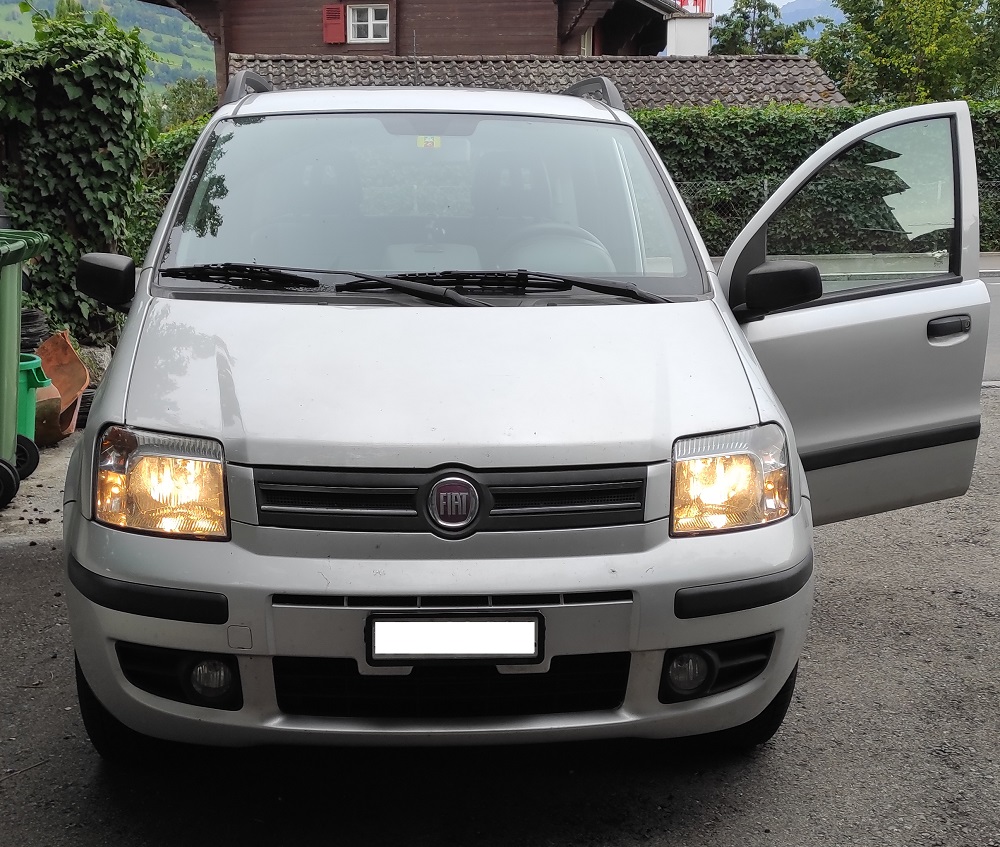

So I noticed that one of the dipped beams on our Panda wasn't working. Changing the bulb didn't fix it and I noticed that the connector was a bit melted and charred.

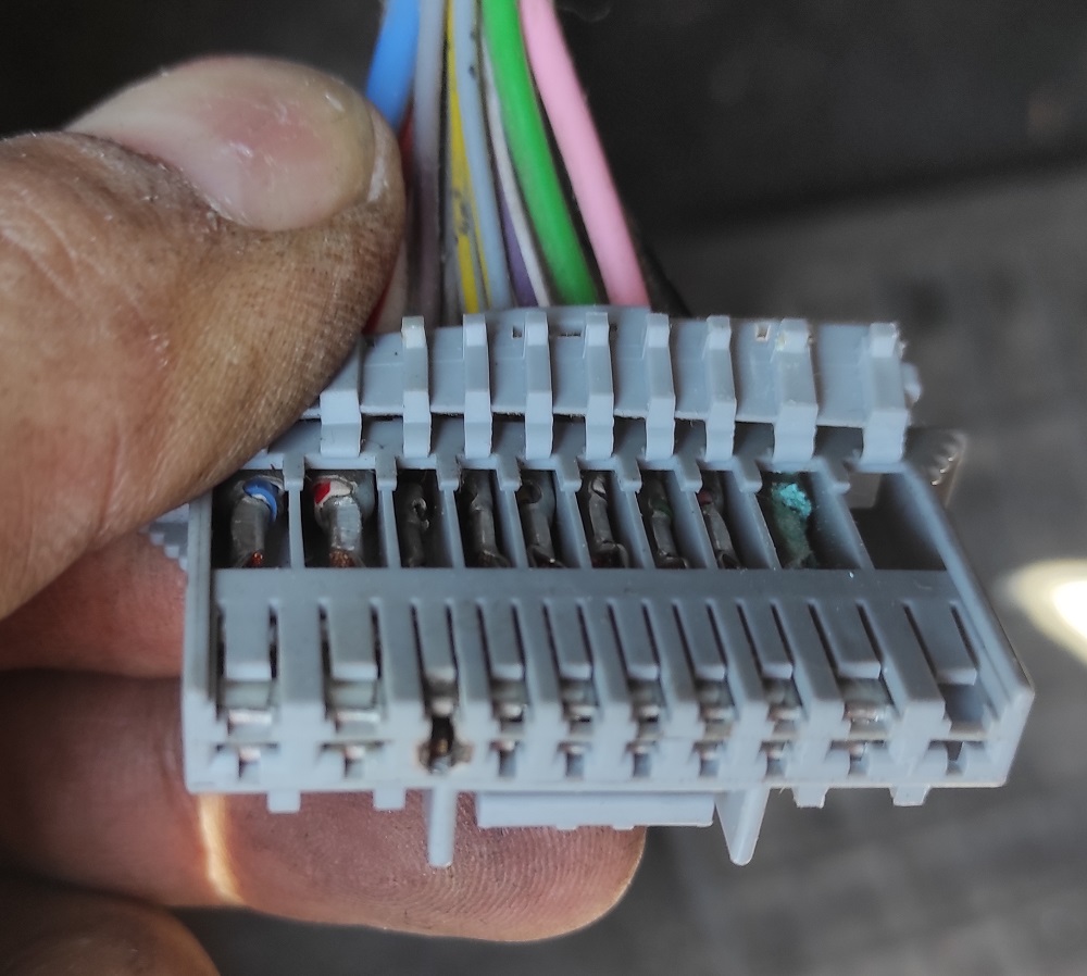

So I did a bit of research and found out about the block connector issue and pulled it out. One connector was a bit charred, but I've seen worse on the internet.
So I've removed the lamps as they will need new block connectors (which I've ordered), and I've ordered a new block connector. Just wondering if that's the route cause of the problem. It's quite a palaver getting all this done so I don't want to do it twice.
The other thing I don't really understand is the revised block connector has thicker wires, but you still join it onto the original thinner wires. Doesn't that just shift the problem?

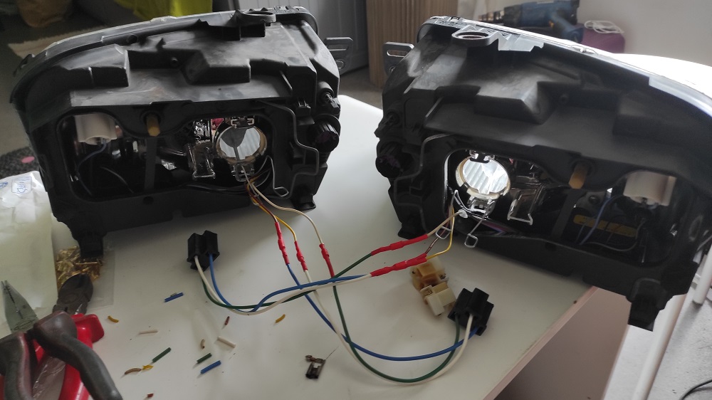

The bulb connectors arrived so I fitted them and put the car back together. No idea why there are such different coloured wires.
I tested the lights just to see if they worked, not expecting the broken one to light up, but it did.
Really surprised as the block connector in the cabin is a bit burnt on one terminal, and also the headlight with the really badly burnt bulb connector, the connector that fell apart when I removed it, wasn't the one that wasn't working.
I'm still waiting for the cabin block connector, but it's not a lot less urgent.
