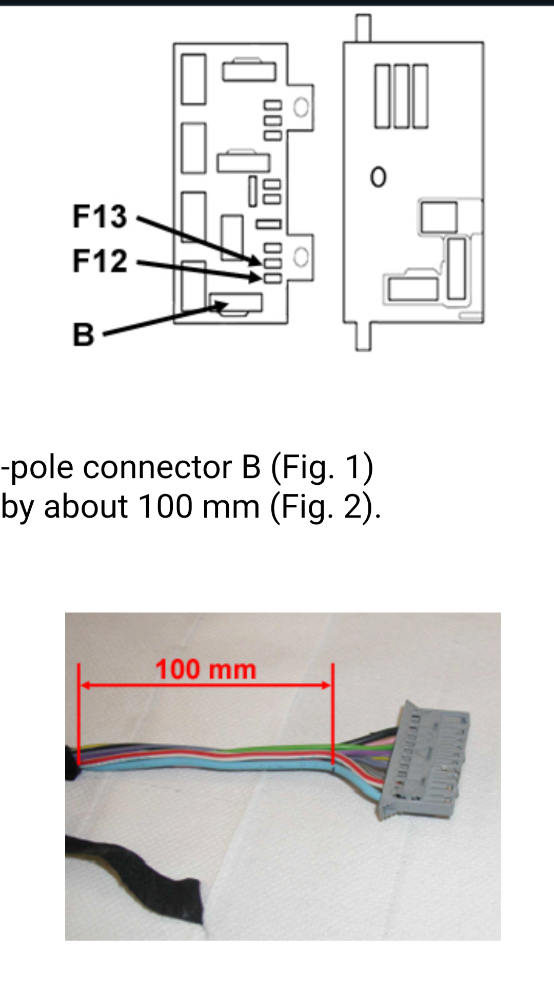

  • Identify the connector B on the body computer (Fig. 1).
Fig. 1
  • Disconnect the 10-pole connector B (Fig. 1)
  • Untape the wiring by about 100 mm (Fig. 2).

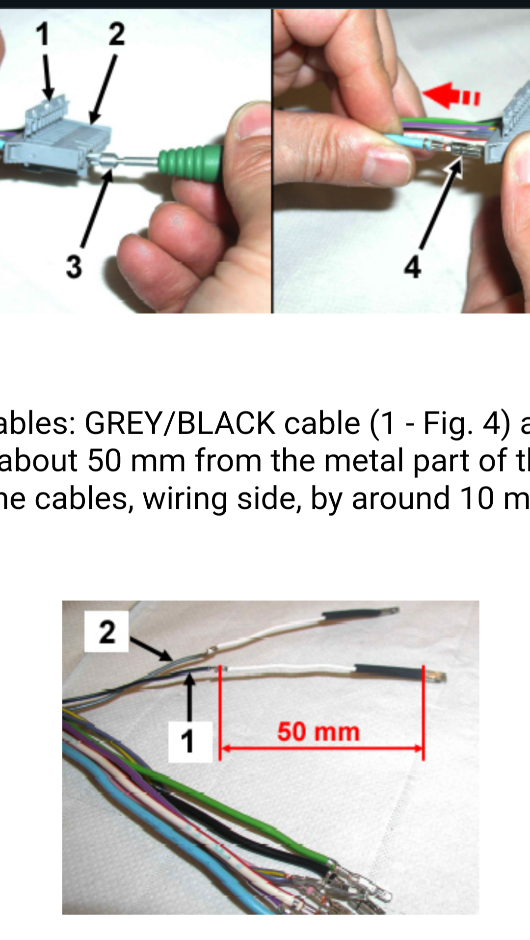

  • Release the secondary lock with lid (1 - Fig. 3) for the connector (2) and open it.
  • With the help of an extractor (3 - Fig. 3) release and take out the terminals (4) from the connector.
Fig. 3
  • Cut the relevant cables: GREY/BLACK cable (1 - Fig. 4) at pin 7 and GREY cable (2) at pin 8, about 50 mm from the metal part of the terminals.

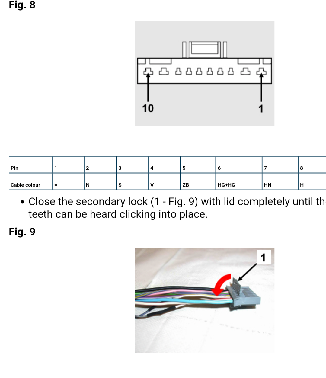

  • Fit the ends of the cables in the new connector, supplied in the kit, making sure that they are correctly positioned as shown in the diagram (Fig. 8).
Fig. 8

  • Close the secondary lock (1 - Fig. 9) with lid completely until the fastening teeth can be heard clicking into place.
Fig. 9
Fig. 1
Fig. 3
Fig. 8
Fig. 9

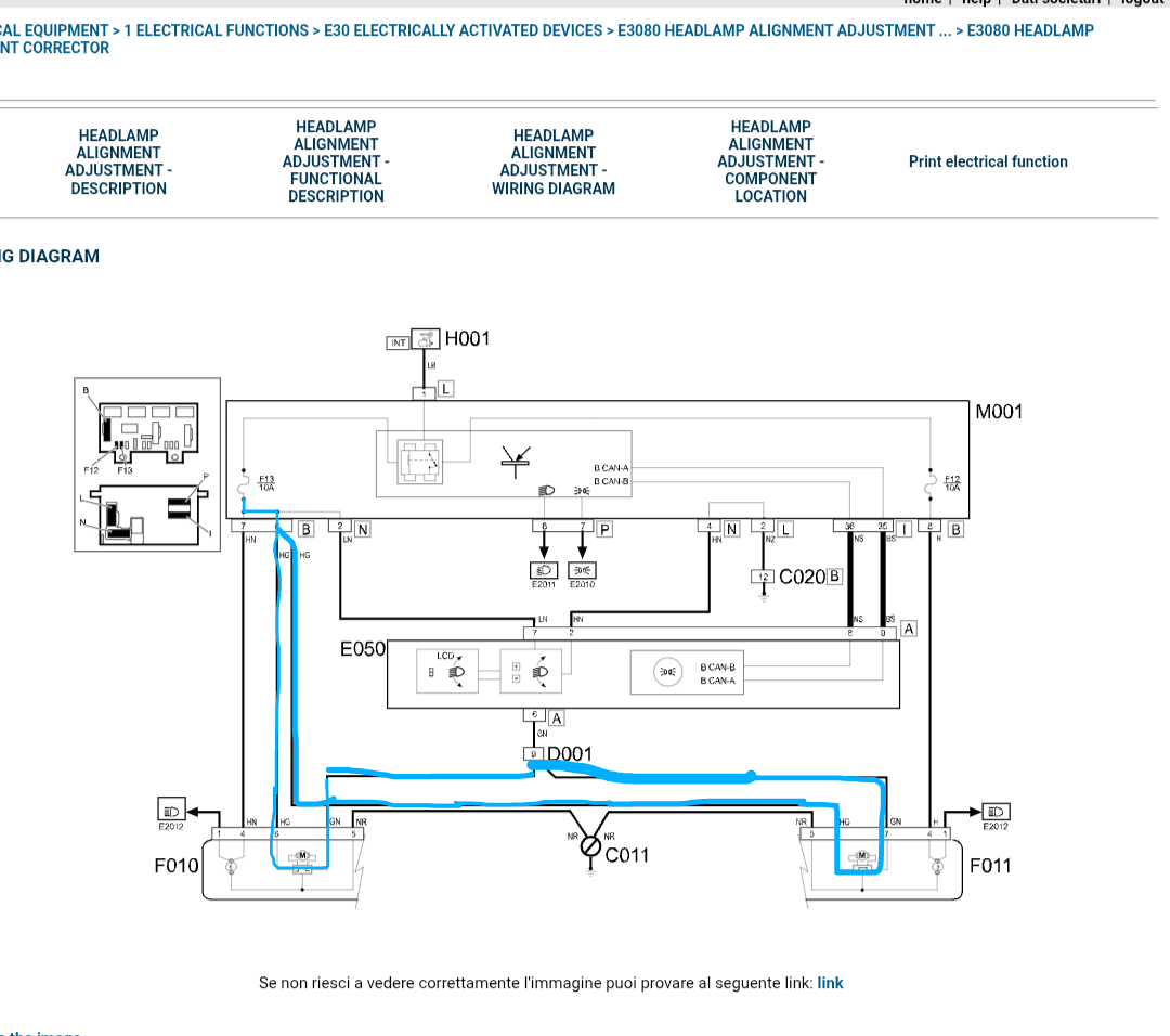

Just heard about a strange problem with a Panda's headlights. Car is a 1.1 Active Eco from 2009, Right hand drive.
Apparently, both dipped beams failed, bulbs were changed (but not checked before going in the bin). New bulbs didn't fix problem. Mechanic (-ish) at side of road looked for blown fuses (didn't find any) and changed bulbs again. No difference.
Car driven home and i got a phone call this morning. Short of time, so said i would have a look but probably won't have time to do more than check the basics.
Car arrived, with no dipped beams and one high beam (left) out too.
Checked over the obvious (bulb fuses, infamous BCU connector which sometimes burns out but I've only seen on LHD cars) and found one fuse (F13, left dipped beam, 7.5a) blown. Changed it, tried lights, blew immediately.
Disconnected headlamp connector, replaced fuse, switched on lights, blew again. Puzzled, decided to look at the other headlamp.
Disconnected RH headlamp connector and retried. Fuse didn't blow. Took out RH bulb and found H4 connector was scorched. It disintegrated while removing, so replaced the connector block after cleaning up the terminals.
Plugged everything back in and...
LH dipped beam now works, RH doesnt.
RH high beam now works, LH doesn't.
Re-checked fuses, all OK.
Having run out of time to do any further diagnosis, thought I'd see if it rings any bells with forum members.

I'm still puzzled by the symptoms though... how can the RH headlight blow the fuse for the LH dipped beam? I know the dipped beam fuses also covers the headlight motors, but I had assumed that they were per-side. Maybe they are both on one fuse so a fault on the RH motor blows the LH fuse... time to look at some circuit diagrams I guess.
You could be on to something here
Both motors are powered by F13, so a short or stalled motor on either side could blow the same fuse
And are tapped into each sides H4 bulb holders ground circuit so can effect current flow to the bulbs
That looks like an interesting possibility... it fits at least some of the symptoms nicely. Thanks for finding that.
Think I need to get hold of a spare headlight to verify/rule out.
Shame
Bet there's been loads of scrap smashed headlights thrown in the bin
Looks like the would make nice test rigs
Keep a set of each colour connector
I've got one for the old type headlights - not planned, I was trying to replace the motor in one and one of the plastic pivots snapped as I was taking the wires out.
I was wondering if I had enough bits to make up a converter from new-type loom to old-type headlight, but I don't have a new-type socket. (Although I will have when I get a replacement headlight, assuming the current one is stuffed)
A quickish test would be to disconnecting the headlight adjustment motors
A suspect.a short In the the wiring or motor and adding a break in the circuit might be enough confirm this
I was thinking along those lines, but with a bit of luck, I should have a known-working pair of the correct headlights arriving next week.
When I (eventually) get to see the car again I will be swapping out both the headlights with the known good ones, and then I will work backwards from there, depending on what happens.
I need to change one anyway because of a broken bracket, but of course its the other one that seems to be causing the problem.
If it fixes all the problems then I will probably disassemble the faulty one just to see what went wrong. If not, it'll be back to the drawing board, I guess, but it will have eliminated the motor(s).
