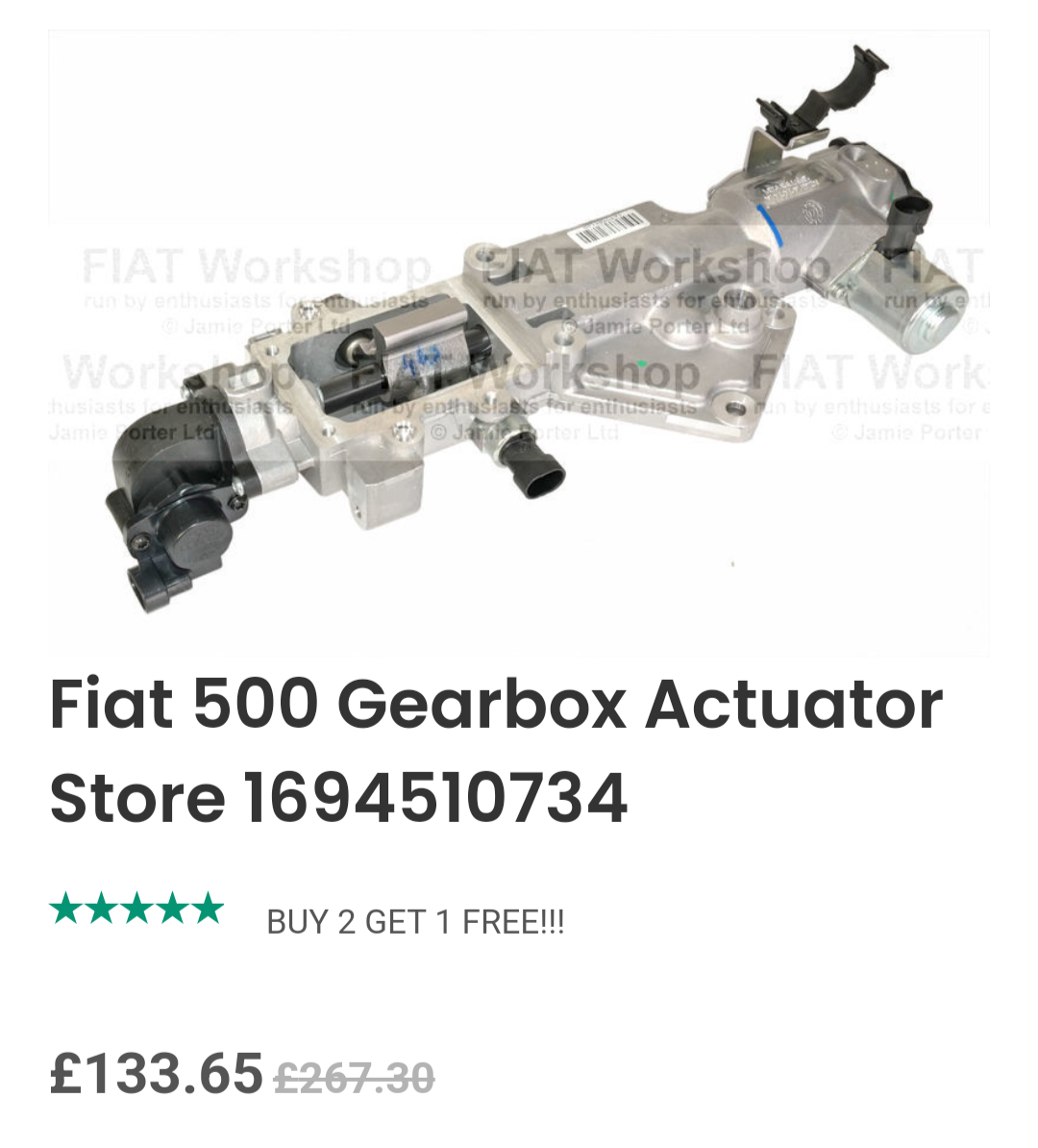

Say it's the actuator, just replace it

That new OEM
Seen them for £90 but not in the UK
Some cheeky people are selling the same part for £300 seconds hand, and rebuild washer kits for £200
Unfortunately unless you are going to do it yourself
A garage will normally charge like a heard of elephants because they know there not many people repairing them
I only used this as an example as it a common place for the to leak
Could easy be somewhere else
If it's possible to buy a serviceable aftermarket actuator for anywhere near that kind of money, then that opens up the possibility of repairing cars which would otherwise not be economically repairable.

Yep most garages will not touch them here in the uk, I don't know why there's nothing complicated in them
There is a specialist in Stoke on Trent that does an exchange, can't remember who or how much he charges
I suspect you're thinking of Carl at CD Motors in Stoke; he advertises on ebay and charges £600 to refurbish your actuator with new seals.
If you've removed it yourself and it subsequently fails, then presumably you can send it back to him to sort out. But if you've also paid a local garage to remove and replace it, you'll have to pay them again in this situation.
And if a VAT registered garage sends it on your behalf, then they'll have to charge you VAT on that £600 (assuming Carl isn't registered for VAT).
Your car will be off the road whilst all this is being sorted, so you'll have to arrange alternative transport. And the local garage may not be too pleased about having it sitting around on their premises whilst they're waiting for the part to be returned, and may charge you storage.
It's understandable that many garages can't be bothered with all this, and it's also understandable that some folks with older cars just cut their losses and scrap the car.
They're not even hard (or particularly time consuming) to remove (apart from draining the coolant to get a bit more room, although I have done it without).
DIY rebuild is theoretically easy, but very hard to find seals at a sensible price. Done one (using mix of seals from 2 failed units) and it's still going. Got another 3 in the Round Tuit pile, waiting for me to find seals.
