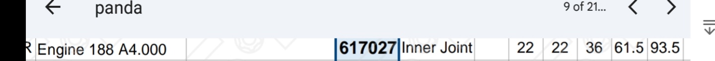

@koalar, can you please check if there are any differences in the driveshafts?

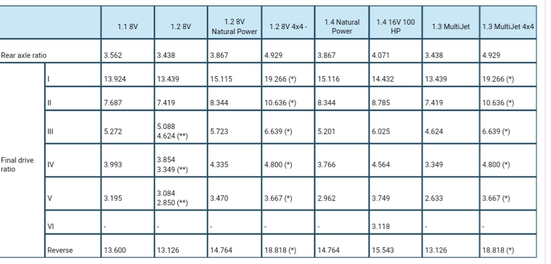

Yes no maybe
I can't remember fully and it's not worth looking it up again as the 6 speed is worse in this case, it just that the gears are closer together
The 1.1 and 1.2 share the same shaft
1.3 is unique
The 100HP is unique
The 1.2 and 1.3 climbing, Treking, 4x4 share the same drive shaft go figure
Some of the differences is the splnes on the hub end, probably disc size, use different hubs
I suspect the diesel and 100HP might be swappable, there was something like 2mm length difference but without putting them side by side I can't be sure
By swapping hubs and so on you can probably mix and match quite a bit, Some punto parts are also a direct fit

Got a stage 2 map in my cross on 175/65/15 and she’ll sit at 90 all day comfortably and push well past when provoked 😇 but I’ve never wanted a 6th gear. I would look at 15”s and suitable tyres to help increase your gearing but it won’t make the speedo read properly the Multijet needs to be kept spinning to make it work and before mine was mapped it spend a lot of time in 4th on the motorway as it couldn’t pull 5th on a slope
Yes, it appears you haven't really read the OP, but thanks for the input.
Thanks for posting that, its interesting data, but it just relates to other Panda's. In my OP I mentioned that I was looking at gearboxes out of other models fitted with the same engine such as a Corsa or an Astra as some of these came with a 6 speed box.
