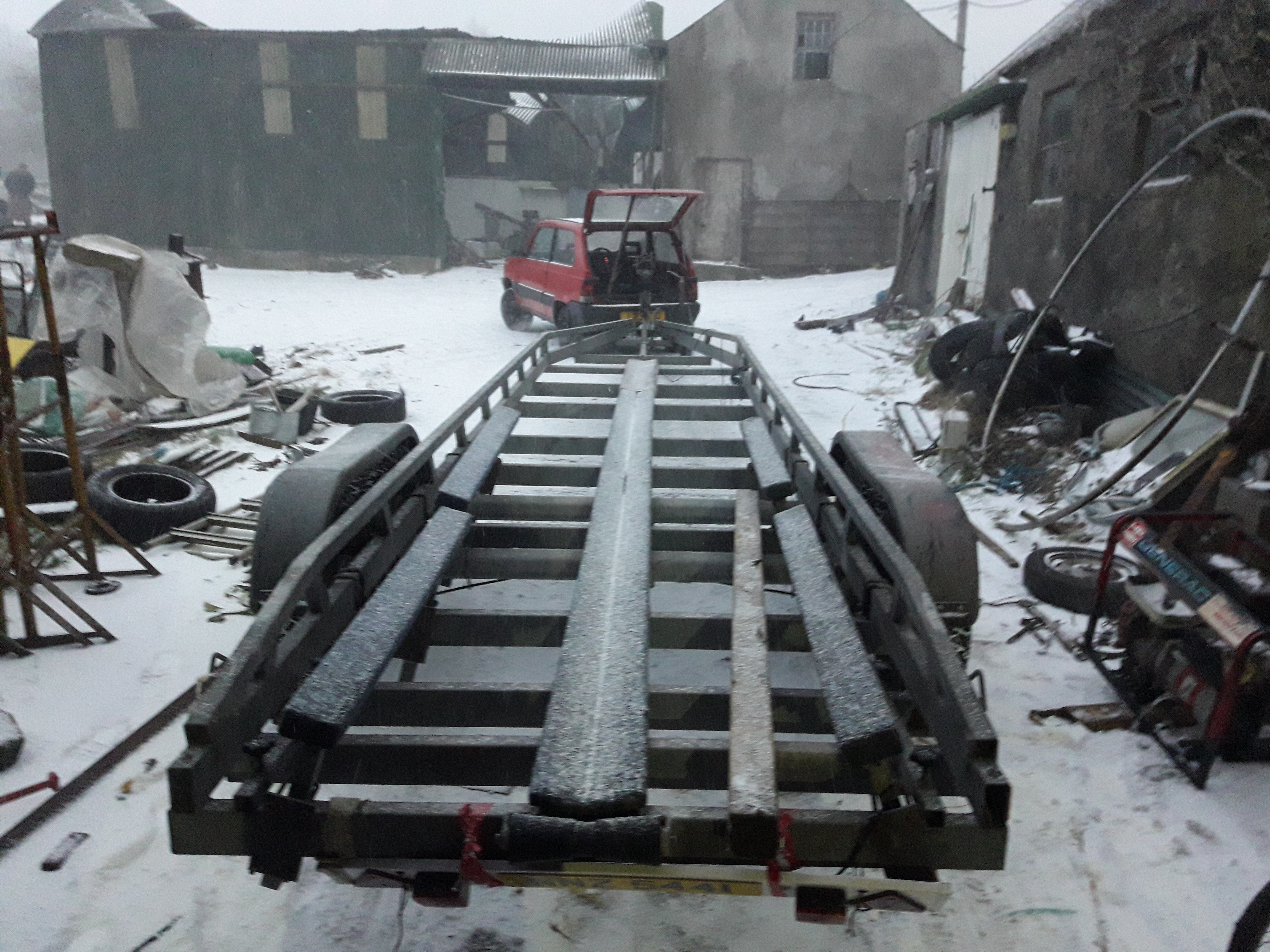

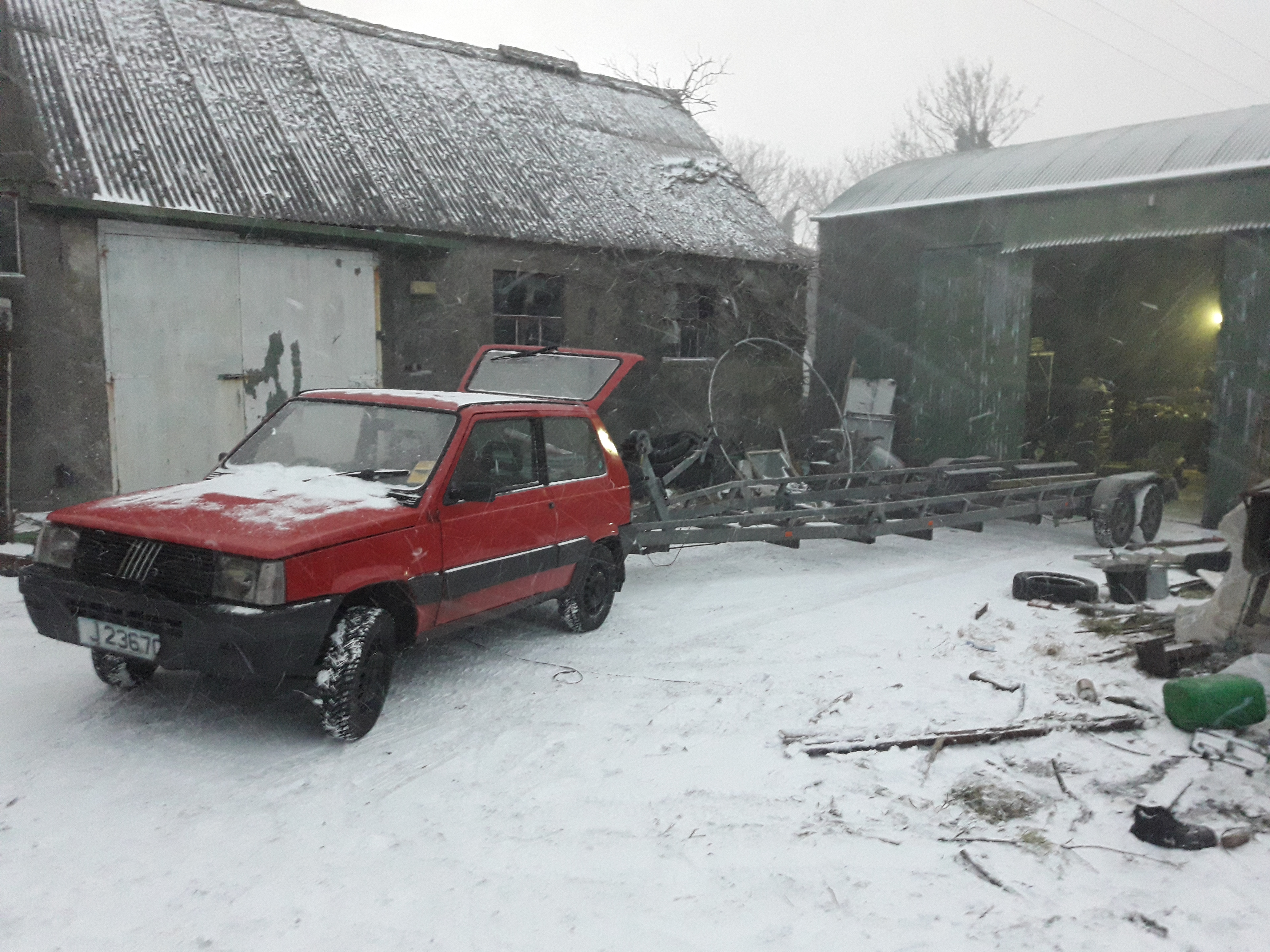

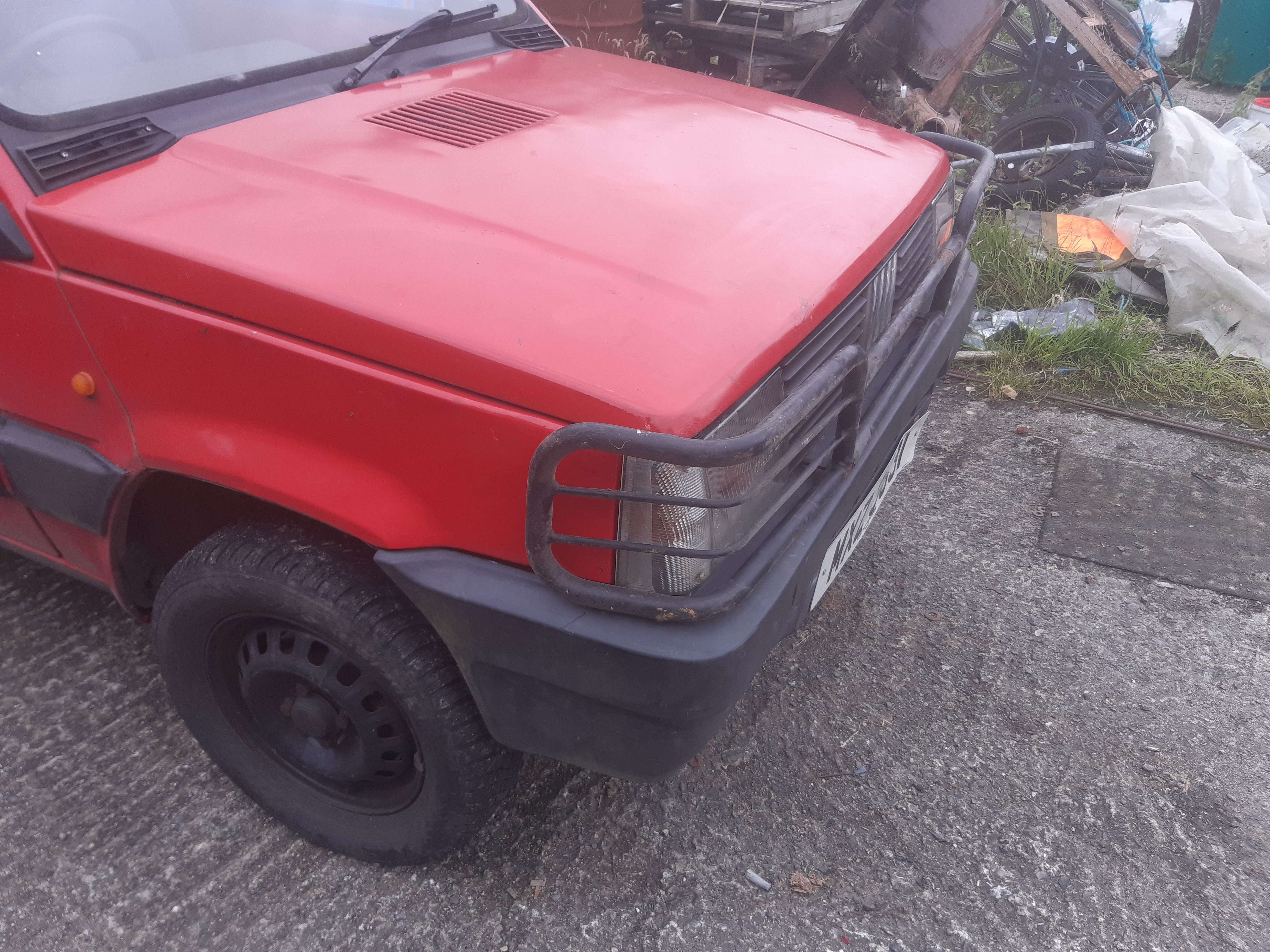

panda was put to work today manovering a boat trailer about the yard in a blizard. as it has small turning circle 4x4 and starts more predicably than my tractor. did the job well. steering is definetly wonky on full lock but ok wheen straight cant think why that would be?
Have you got exactly the same amount of turns from centre to left as right ? If not you have the rack off set and wheel may be rubbing on the arch inner wing !!!! May also need rack sims adding to add more riditance backlash when turning

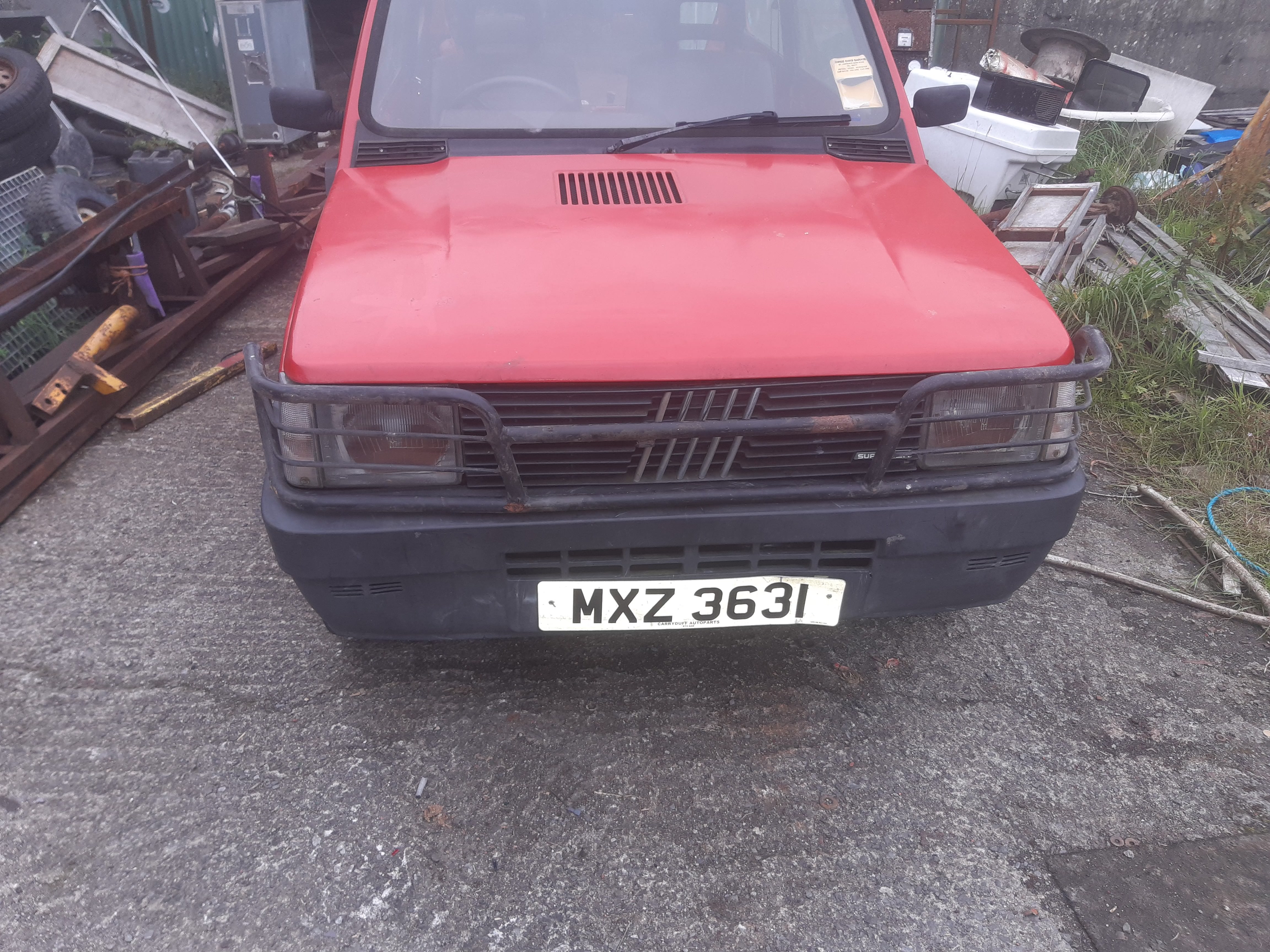

I bought a cork seal and some hylomar to fix the fuel tank leak but it might have fixed its self. the fuel pump also apears to be improving with age. on my 3rd fan belt. have removed the rear propshaft as it was vibrating badly at speeds over 40, caution to all those who rebuild there popshafts make sure everything is marked. haven't finished my off rack or fitted stereo, sump guard or bullbars yet.

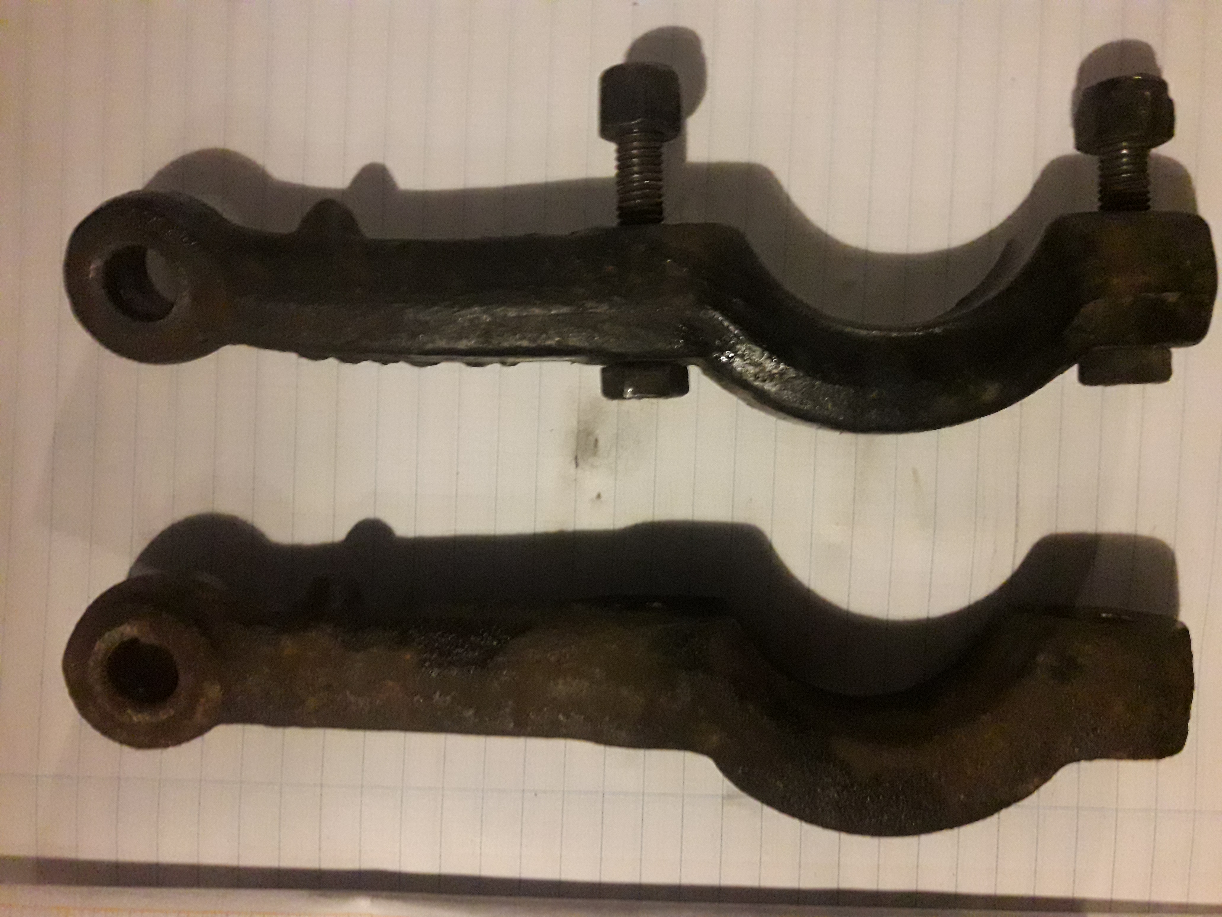

one year on and i am fitting new front shocks and rod end boots for mot. i notice one of my steering arms is bent. probably the cause of my un explained wheel scrub. the steering rack was broken on the car when i got it perhaps the arm was bent by the same incident. found a rusty but straight one in my box of 2wd parts, looks to be a better job.

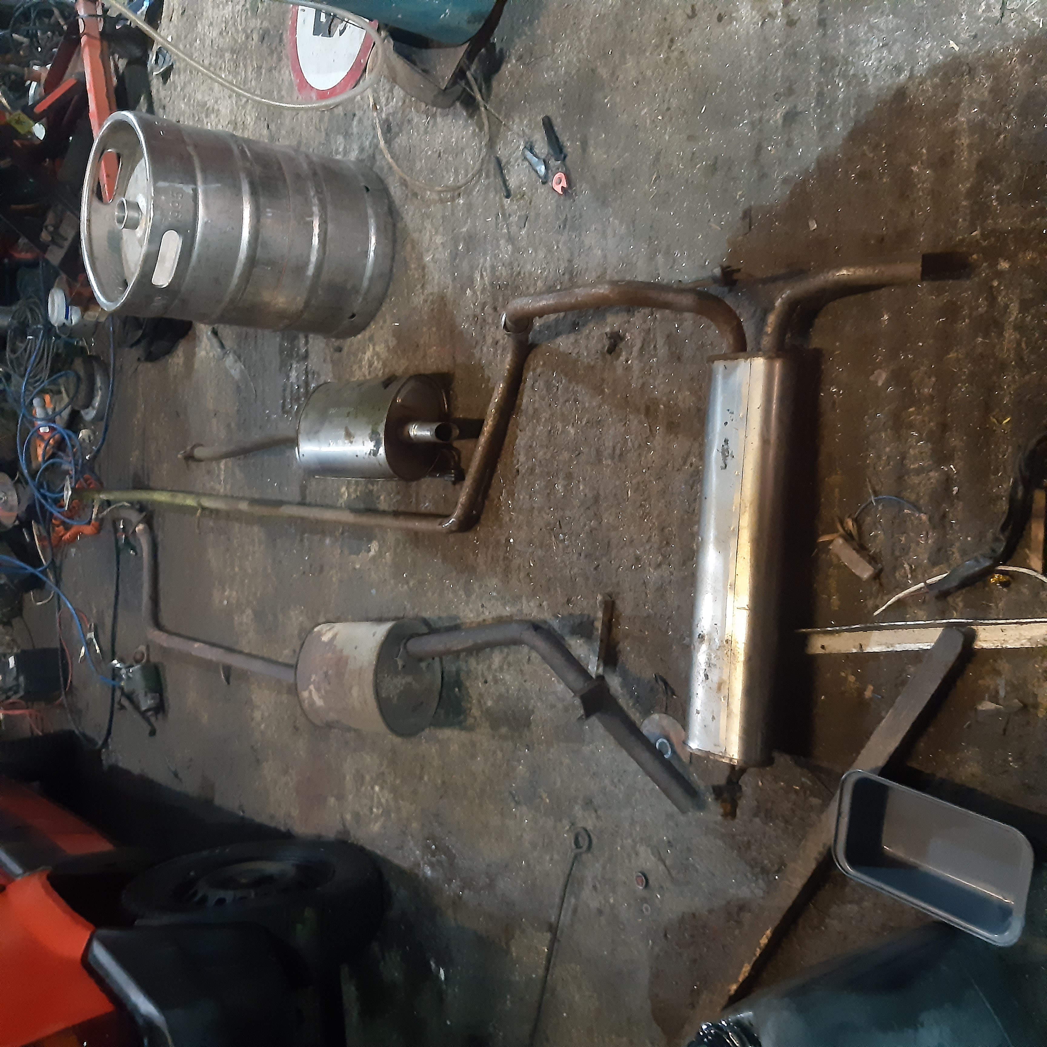

the bull bars haven't made it on yet but i did make my self a stainless steel exhaust its made of a Peugeot 107 exhaust and a ford ka back box got them from my local breakers for £40 i think these are made 409 grade stainless they are magnetic and a bit corroded but will hopefully last ok. i tig welded them with 316l filler rod. pehaps i could have found a slightly bigger bore than the 107 exhaust its kinda wee.

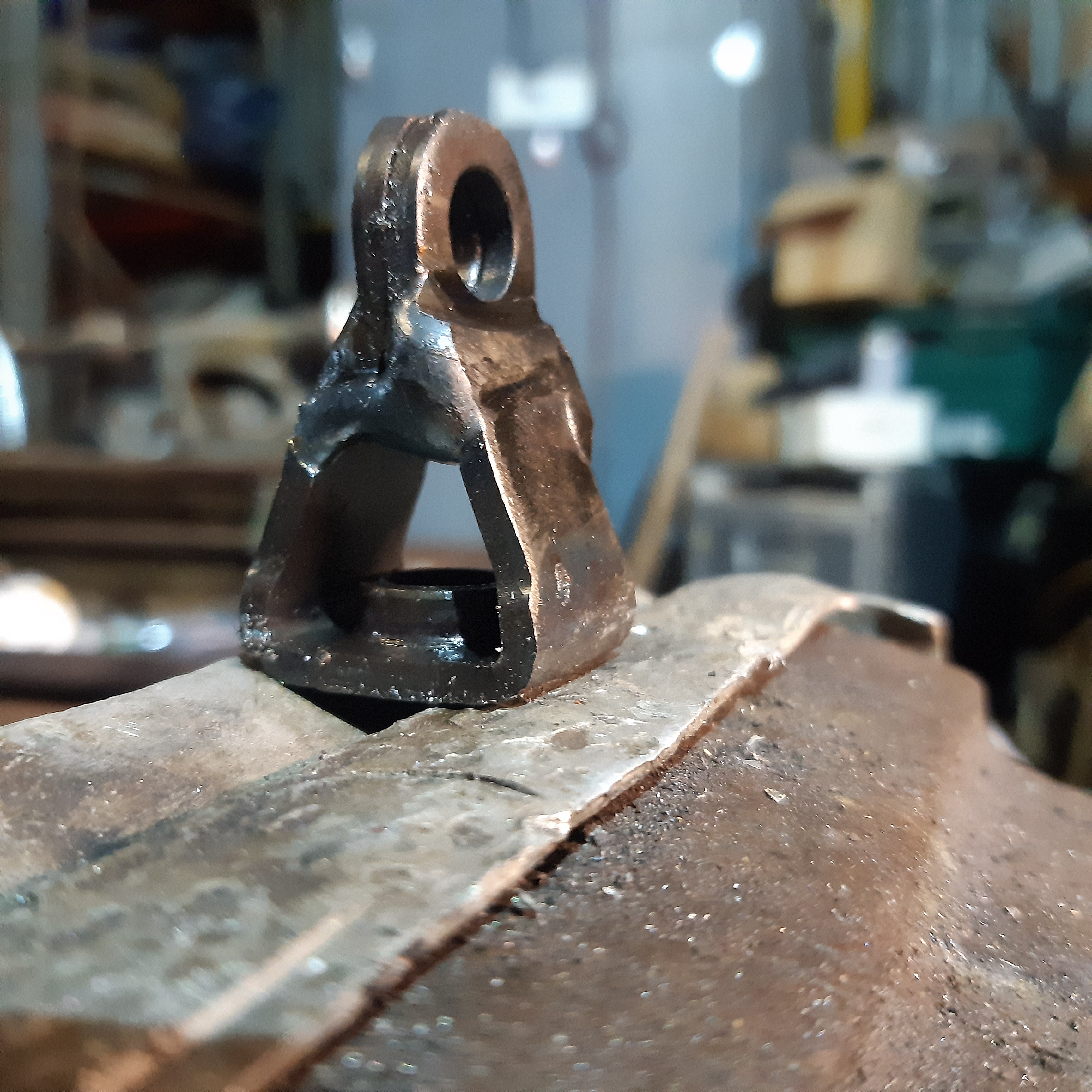

also got round to fitting the Lexus master cylinder got of eBay bout a year ago. I had been meaning to follow sjvarleys lead for a while but i eventually found the motivation to do the job when my brakes failed due to all the fluid having leaked out of my flaky old master cylinder job was handy enough done bit of a cut and shut on the forfend and had to cut a few mll of the connecting rod as the fist time i fitted it the rod was to long and made the brakes bind. ive had problems with brakes binding before but this time they were binding equally on both sides so i new it was the rod length.
