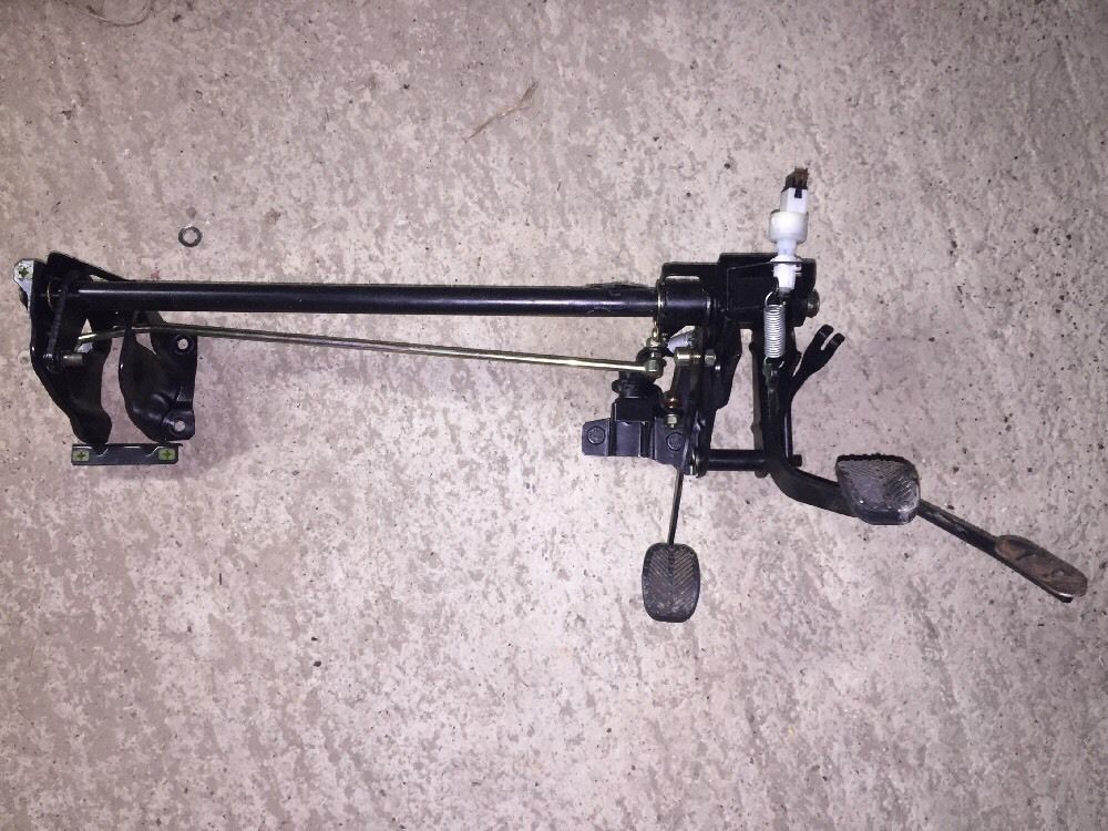

jury is still out on which hand drive the car will be, brakes and steering looks easy but dash electrics and heater will be pain in the arse to shift to the right. Removed the engine gearbox dash seats and carpet today found 20.10 French francs and 0.11 Irish punts the youngest franc is 1991 so it must have come to Ireland after 91 and before the Euro in 2002.
i need to find or make a link rod to connect off side mounted brake servo with a near side mounted brake pedal. as i have never seen one and cant find one for sale i am stumped. has any got a decent picture of one? I have atached an image of a seicento brake pedal assembly dose it look similar? could it be bodged?
