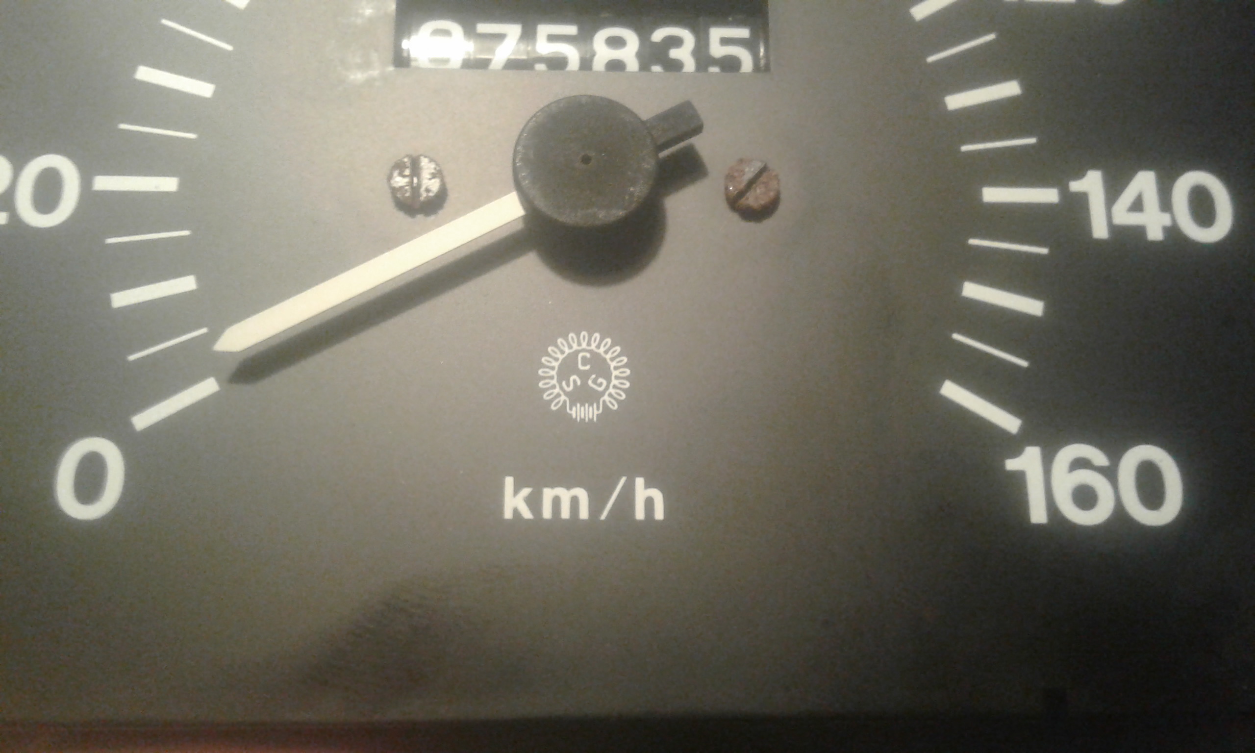

painting is finished i hope, all the glass is in. The rhd loom, diy vinyl dash, pedals and servo, engine and gearbox back in (old clutch new thrust bearing) my carb manifold drilled and taped for brake vacuum, and the back brakes are rebuilt. i have been checking over the electrics while the loom is visible. the loom is from a rhd 2wd carbed car so i have added extra wires for a fuel pump if i ever go fuel injected, an extra wire for the 4x4 dash light, and will have to extend the brake fluid warning light wires to reach the servo assisted brake reservoir. i was initially disappointed by the lack of functioning dash lights most of these were solved by sorting out bad earth connections. while poking wiggling wires i started to wonder if my kph speed o would pass an mot. after some on-line research it appears that N. Ireland has stricter rules than the rest of uk on this mater. see here. https://www.pistonheads.com/gassing/topic.asp?t=920698
I had a mph instrumet panel at hand but i wanted to have the 4x4 lamp. Its simple to add a lamp to the 2wd panel as the lamp holder and lens is there but it would be missing the symbol. I elected to build a Frankenstein instrument panel both panels looked identical the kph 4x4 panel was made by CSG and the mph 2wd by Veglia. disassembly was easy but reassembly required some filing an minor adjustment to make the speedo fit in the panel, fortunately no bad language was required. Hope the DVLNI appreciate this uncharacteristic enthusiasm for adhering to the rules.
