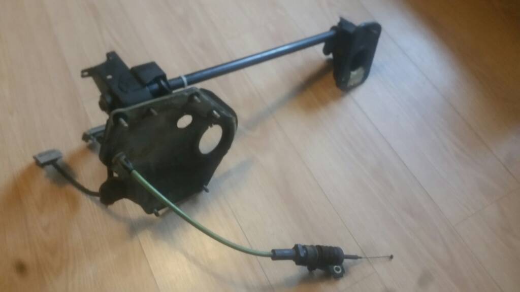

class, that is a comprehensive set if photos. a panda has been advertized on ebay by a breaker in n. ireland if he hasn't got the part ill just make one.
It was some point in 93 that 2WD cars got servos, came in at the same time as the Marelli injection systems and cable gear change etc. All Mk2 4x4s have them.
yea Andy that would be great, i reckon i wont need the servo as i have one in the lhd car. Dont think there would be many in Italy Kolza what with the driver being on the same side as the servo.

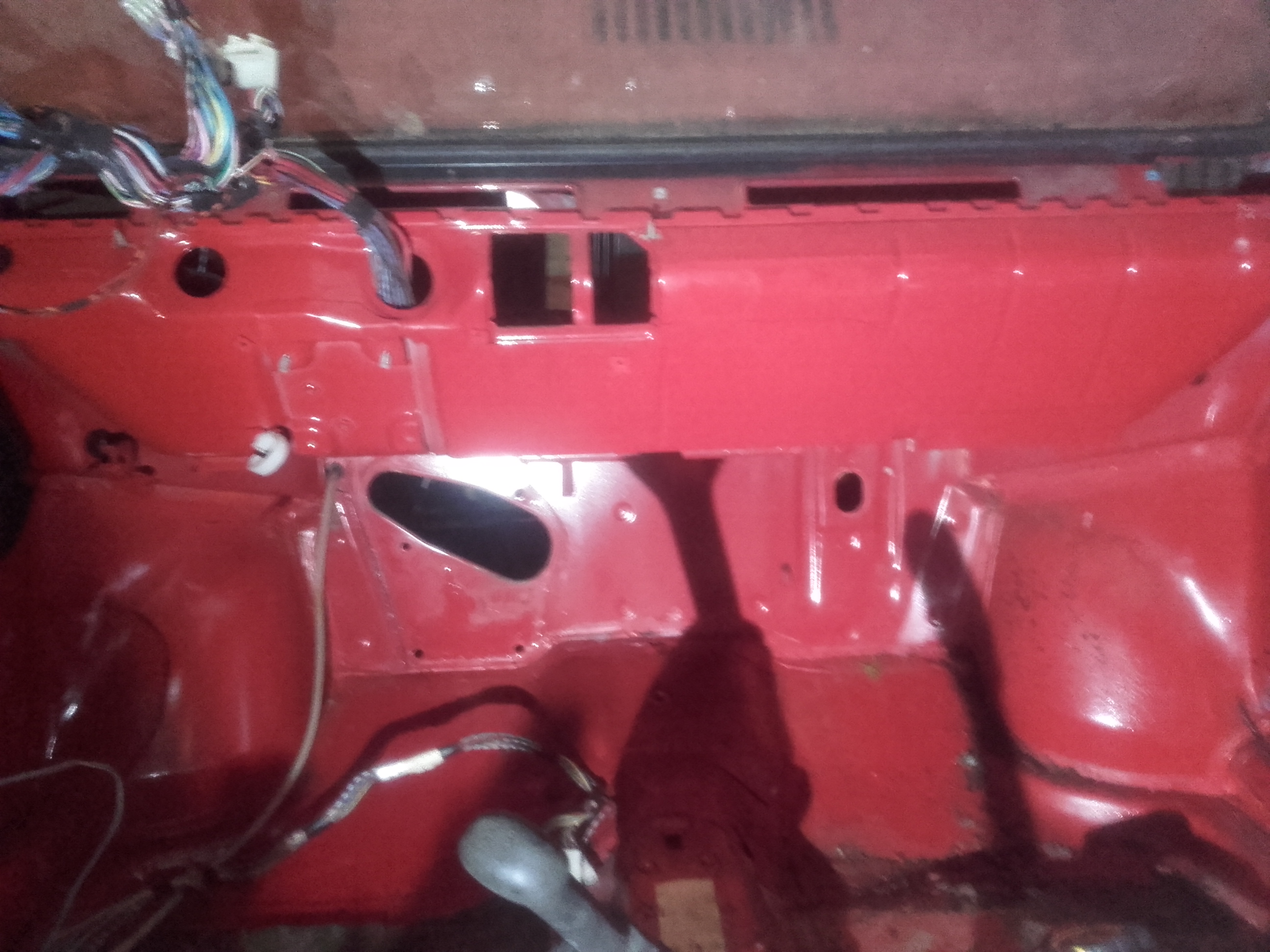

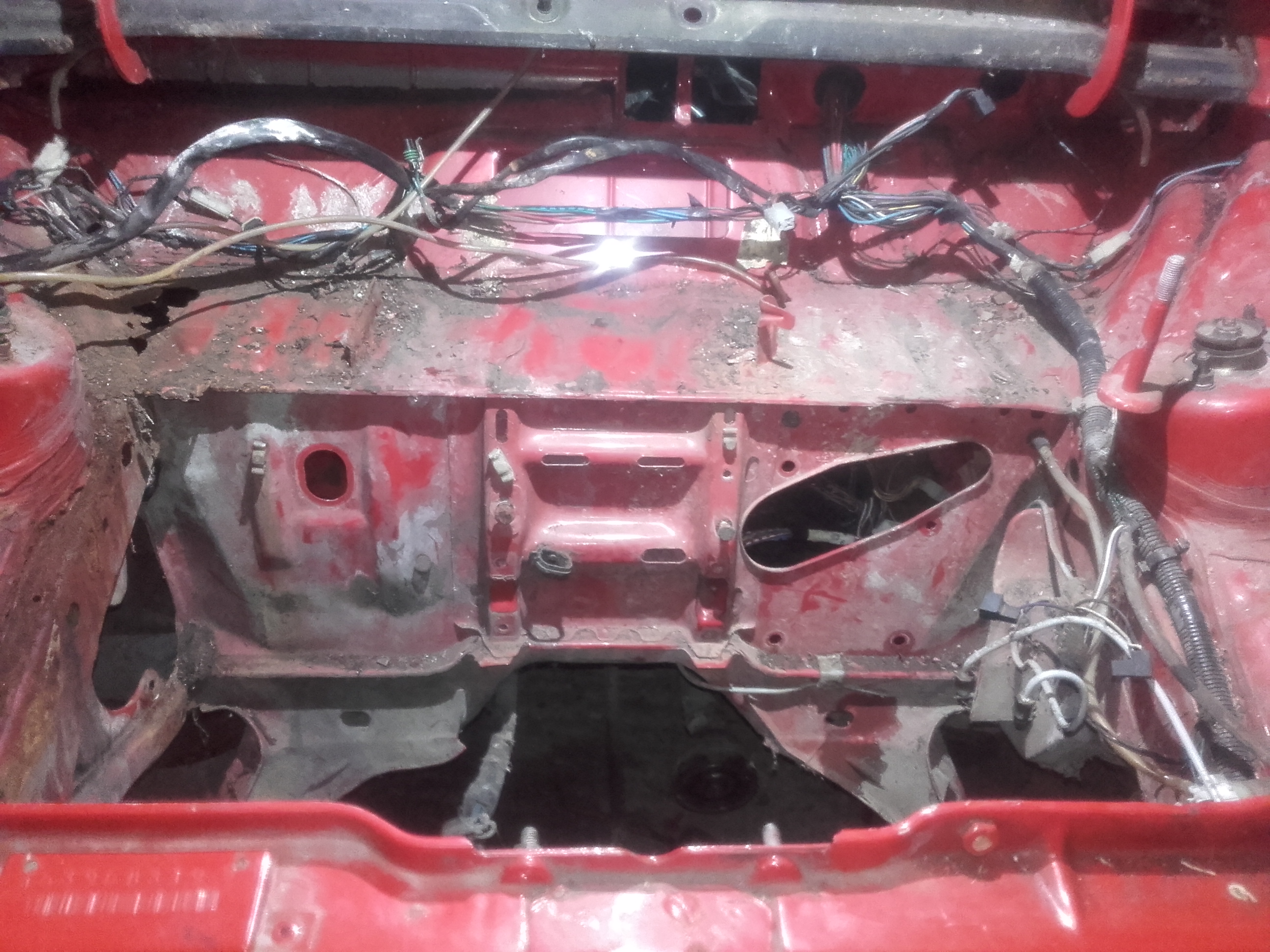

this the bulk head from the inside it needs new cutouts and dents on the right hand side for dash steering colum and heater controls and loom and the old ones blocked. need to add reinforcement where steering colum bolts on
on the engine side the the steering rack mounts are in the right place. there is some corrugations that hopefully wont get in the way of the steering shaft. the oval hole will be blocked with the back plate off the old steering box which will provide the correct mounts from the master cylinder

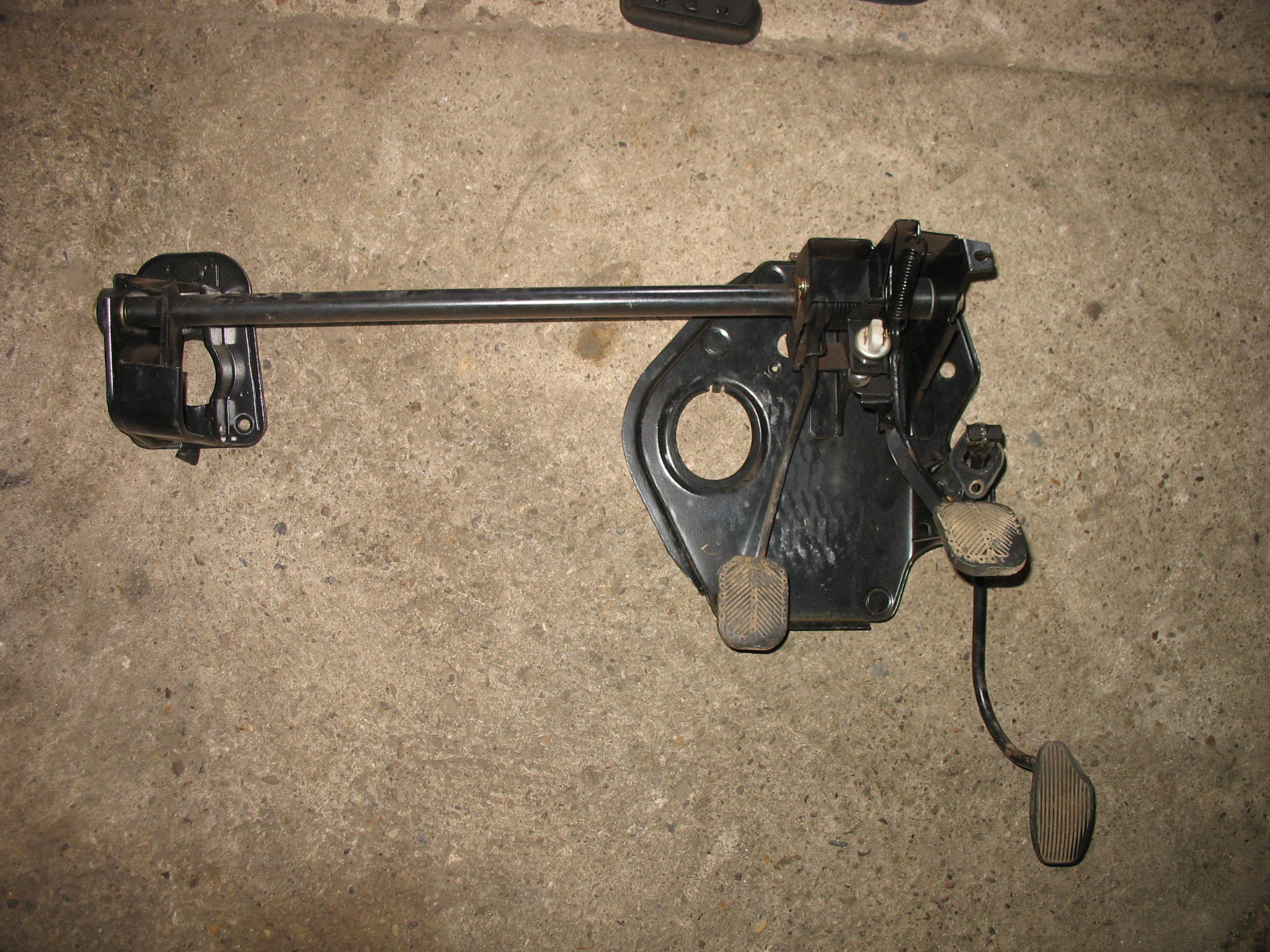

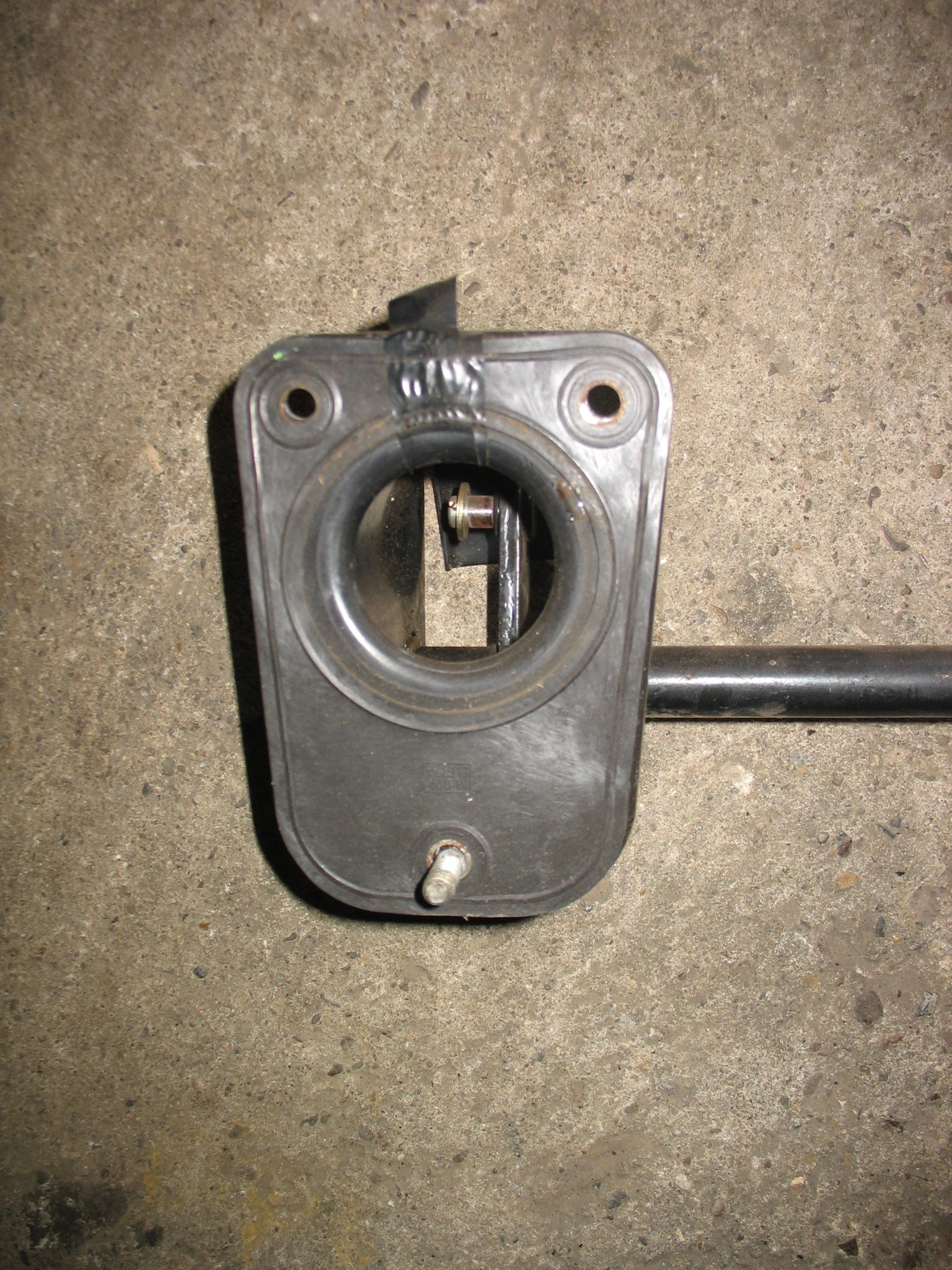

it may not be worth the hassle but, as my lhd steering rack was in need of replacement and i only had a rhd one this car will be rhd. i will swap the wiring loom, the dash, heater. pedal box and clutch cable. i will reuse the steering column, brake servo throttle cable. as i am fitting a carb i will get rid of the ecu, spi manifold, (have to drill hole in carb manifold for servo) and a strange tank under the wing, what is that? and some wires and solenoids.

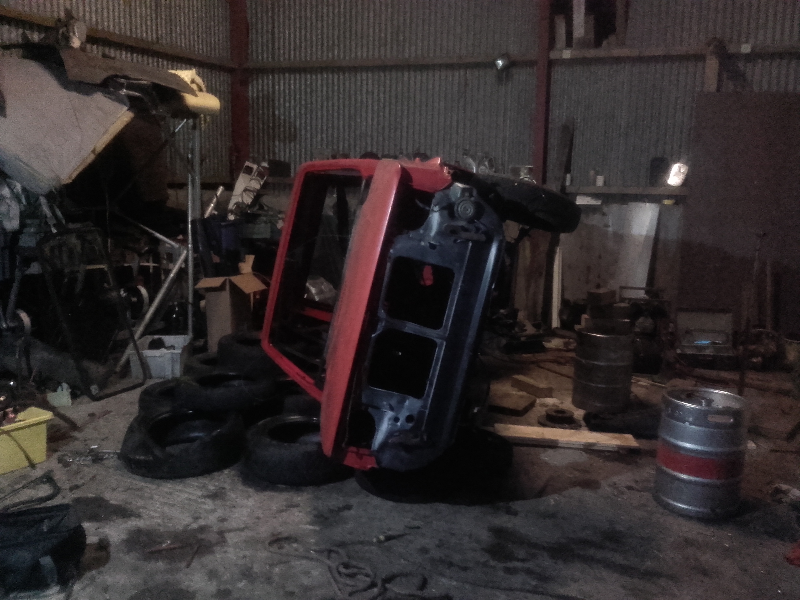

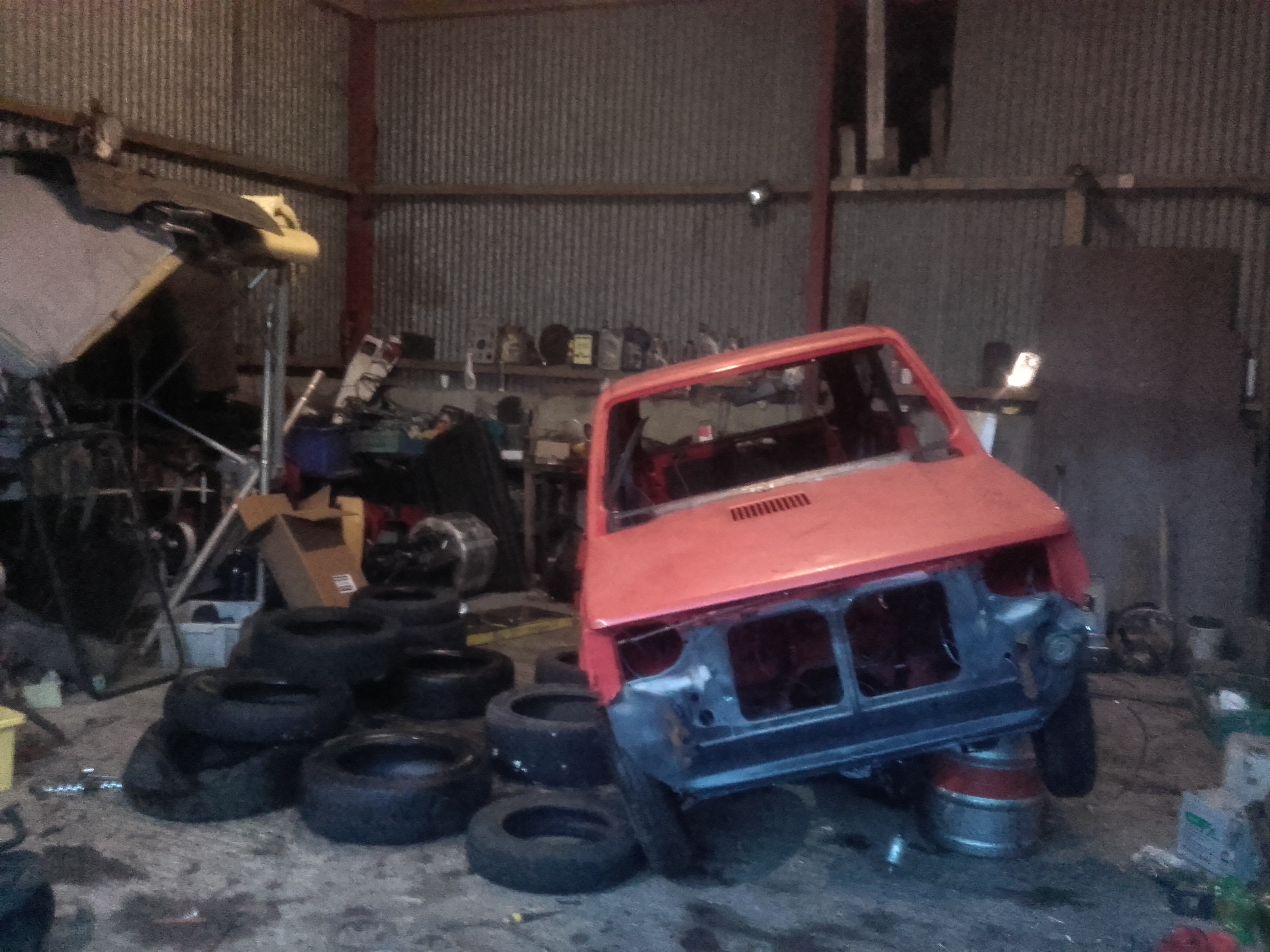

i will add an electric fuel pump and a choke cable. but first iam gona tip the car on its side and fix a few rust patches and check over the back running gear.

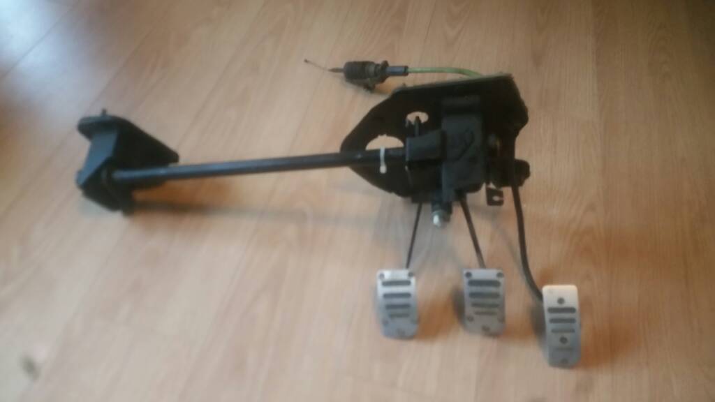

without the engine it was easy to roll over and balances with most of the weight on the wheels and sill. nice one Andy are those go faster pedal rubbers i see.

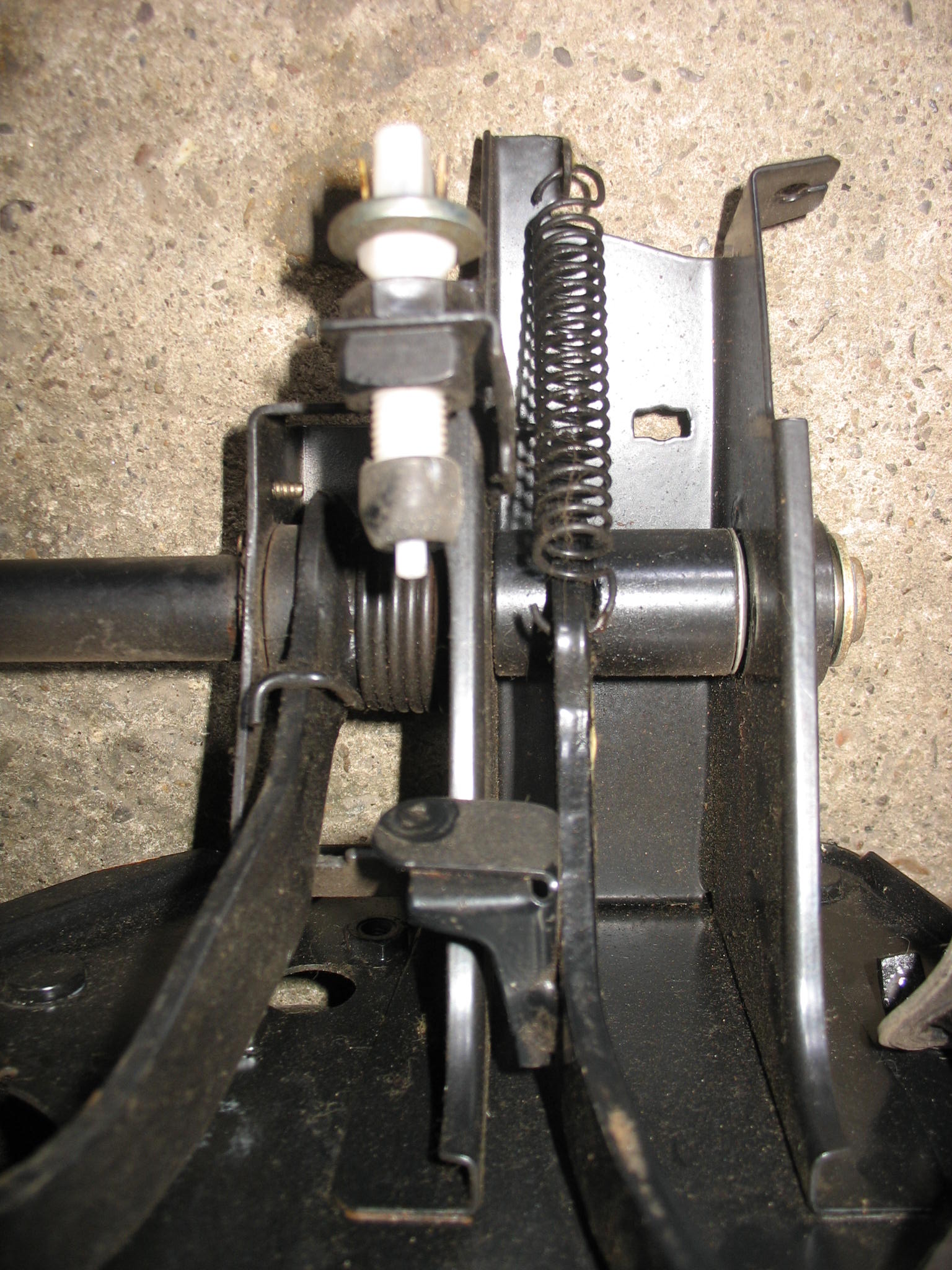

my new pedal box arrived today. thank you Andy. in the mean time i have been power washing my underside so more panda tipping.[ame]https://youtu.be/YFfHet9bzfQ[/ame]
