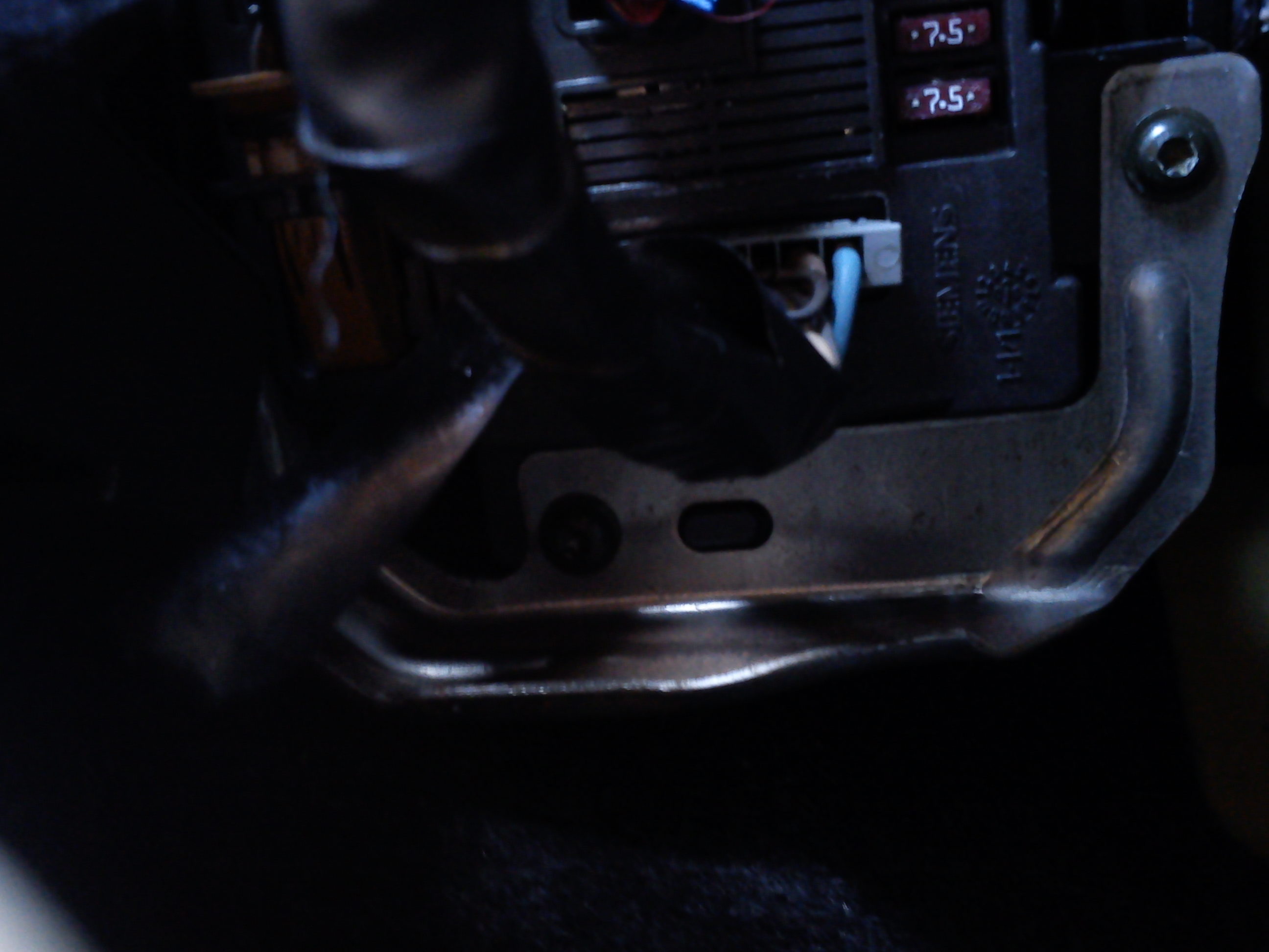

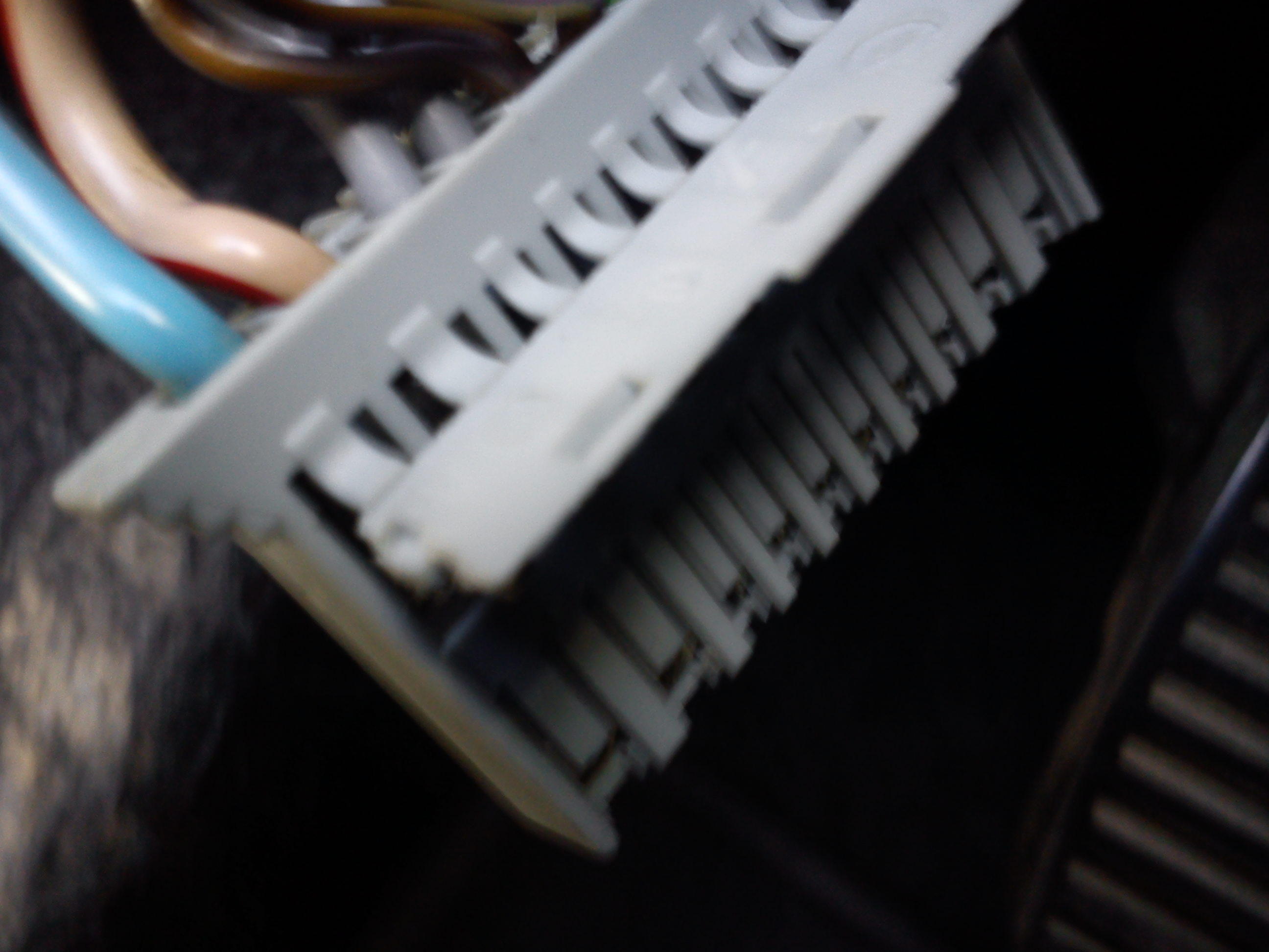

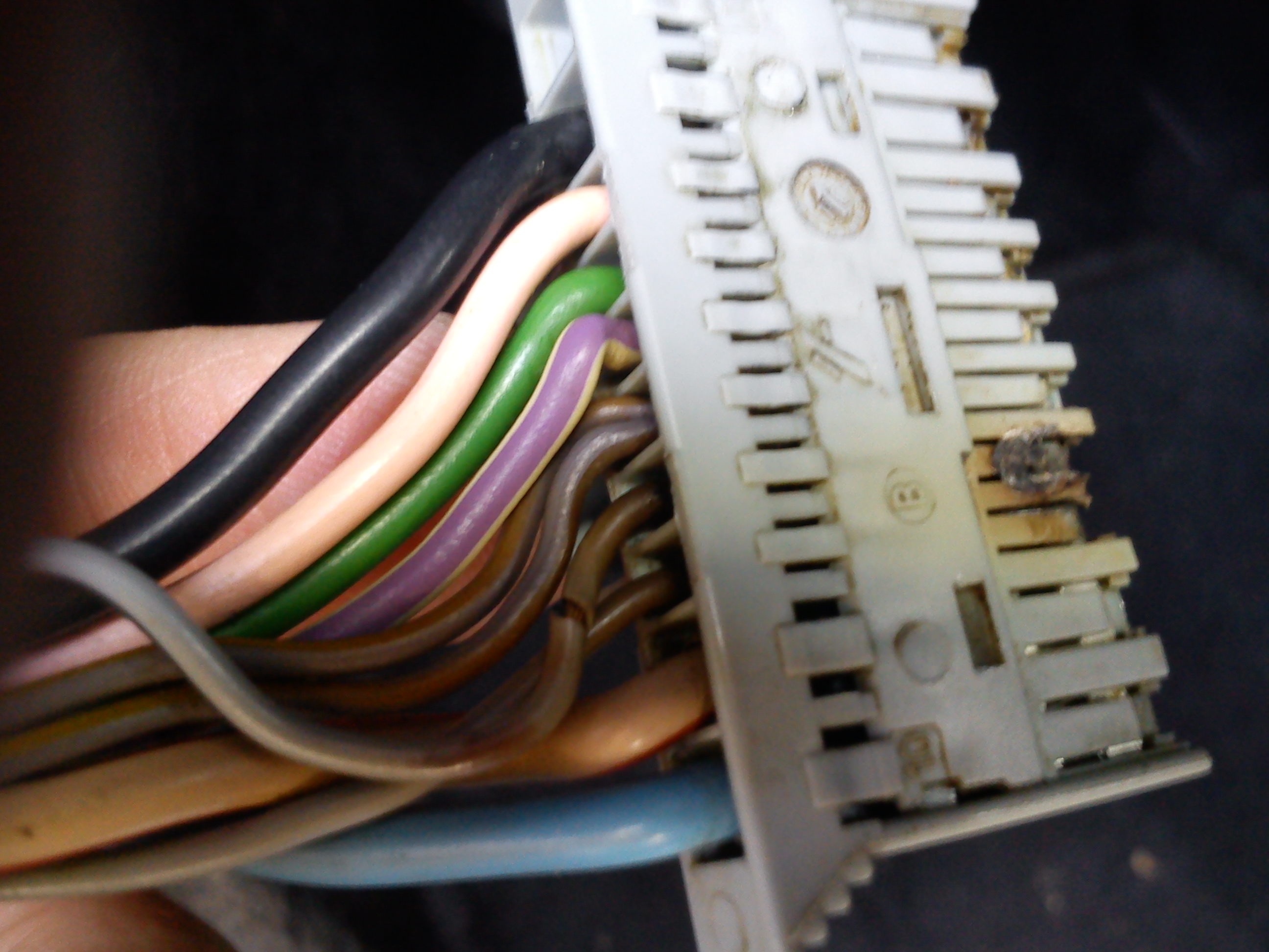

OMG, how can I thank you enough! The bottom connector of that unit was fatal burned. It came out only with force and in pieces. Two gray wires was badly burned. Everything else was in great shape.
Grey wires was very very tiny for long connection to bulbs. Is it possible that the wires are just too little for headlights? Or was it bad connection in case both wires were burned? I drive long distances and lights are on.
Im going to make direct wiring with relay anyway. I cannot live with these kind of connections.

It's my understanding that these wires go to the relay and do not carry the full load. Mine were just a lttle burnt. I gave everything a good cleaning and slightly bent the connectors on the bodycomputer.
So I haven't used the connector I bought on E-Bay.

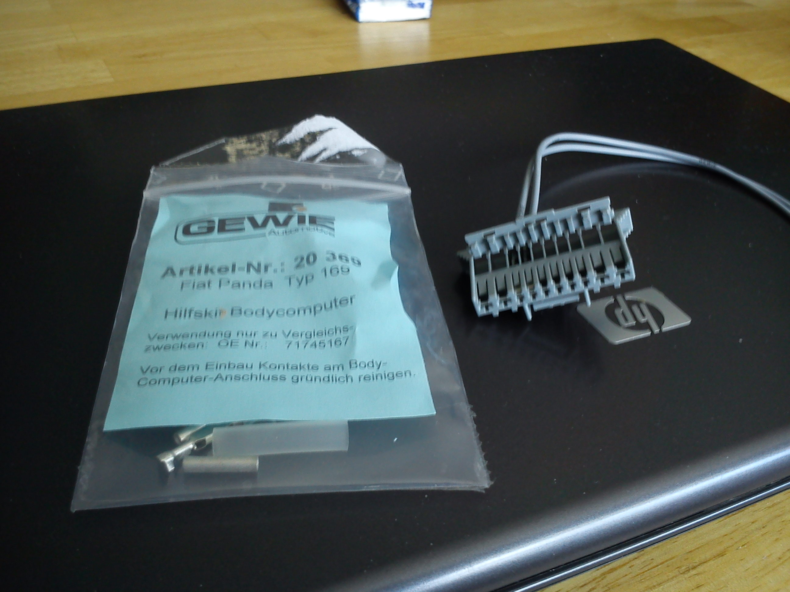

Changed my connector yesterday. After cleaning earlier the connector burnt out again after my holiday.
New connector uses bigger gauge wires.

Did you use the connector you can see in picture, because I have the same problem and had to be ordering this, or burned it also ??

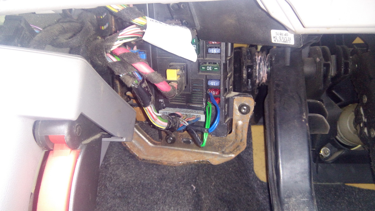

Dear friends
First of all I want to thank you for the information about this problem with headlights.
With the help of a friend who happens to be electrician we came up with a solution which cost nothing and works just fine.
We by passed the plastic connector and wired the two grey cables directly to the fuses.
I am posting a photo so you can see what we did.
For one more time ,THANK YOU VERY MUCH…….
