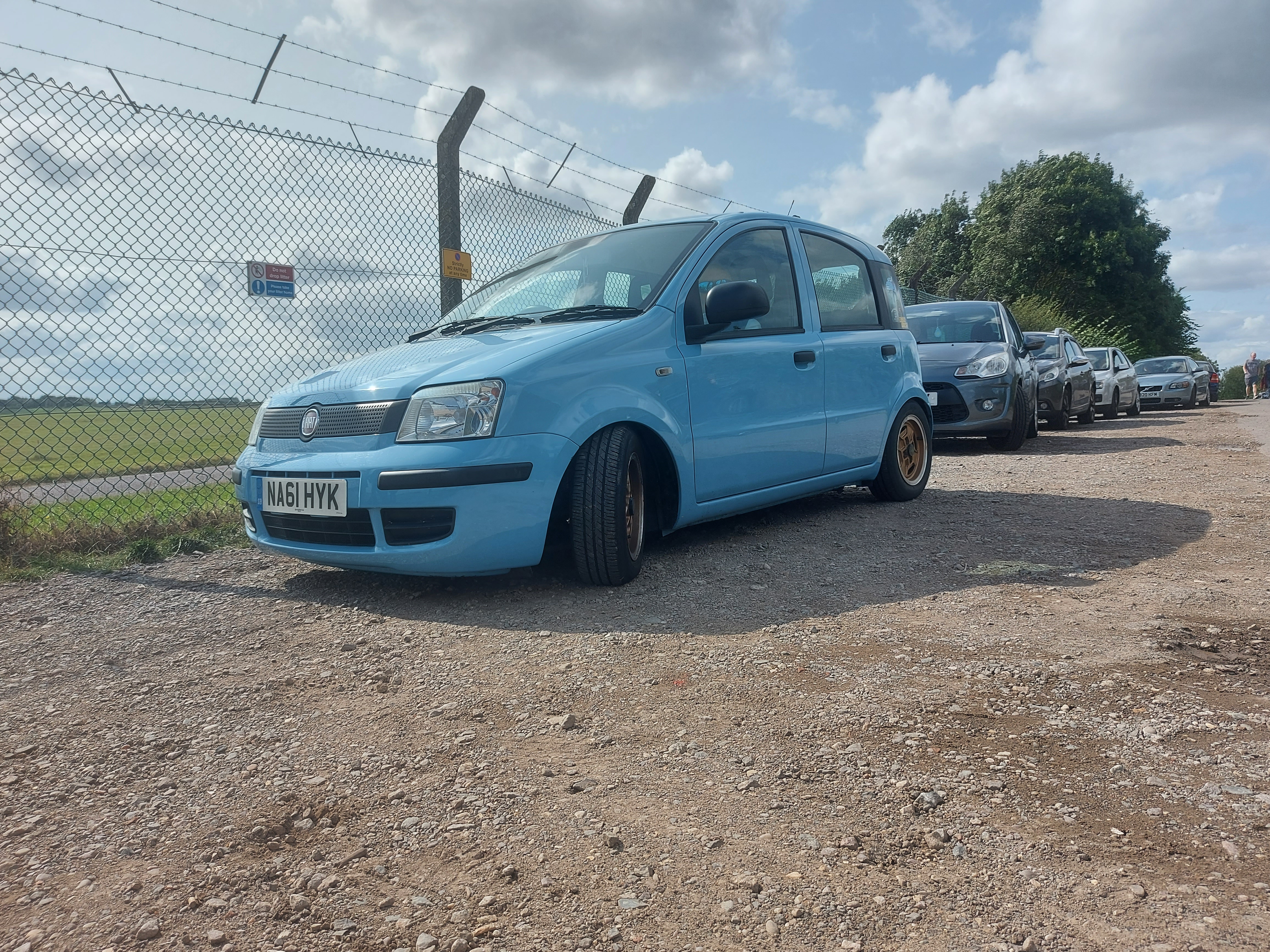

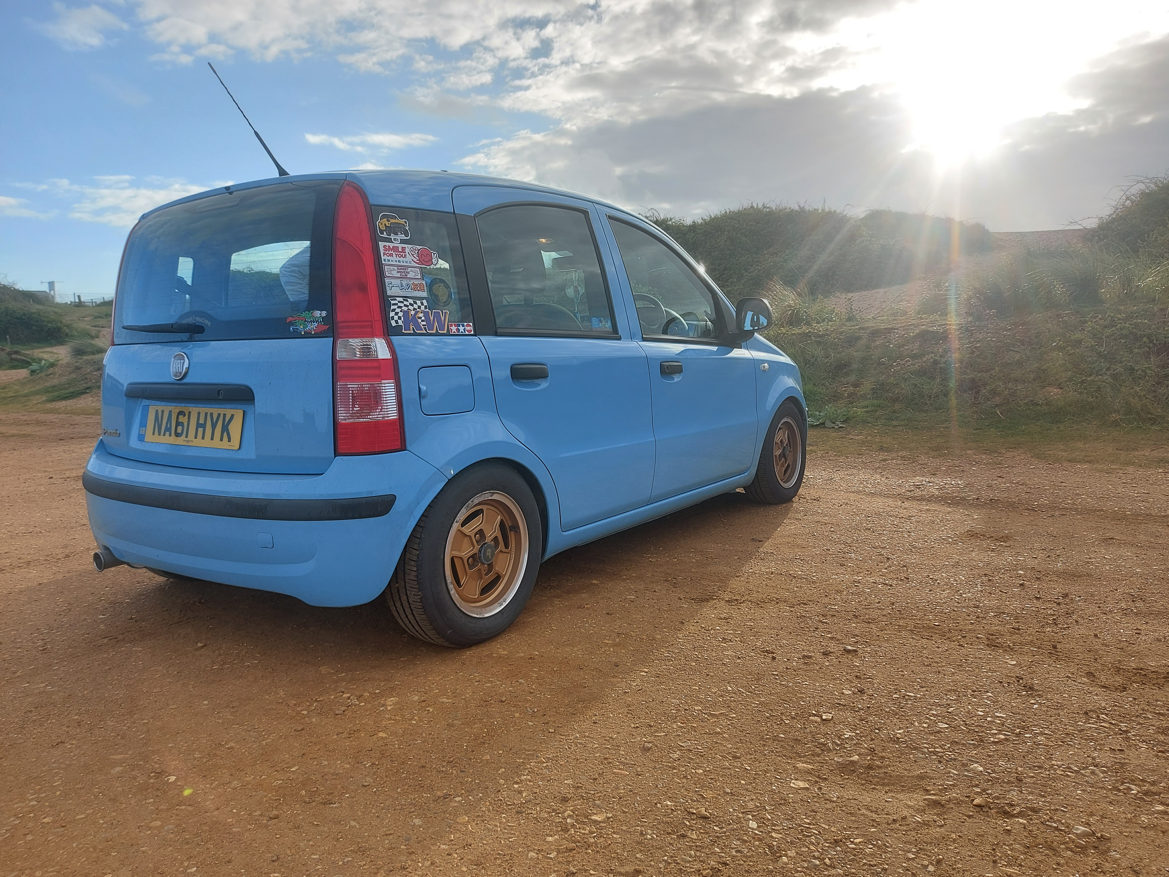

I love seeing other people mess about with pandas! They're such wicked little cars that are nippy fun things to drive that are also super cheap to run, tax and insure and bits are cheap to buy as well. I've had mine a couple of years now and even the build quality has surprised me!
I've done a few little bits to mine but nothing major, it's fairly low on some kw v1's that although more expensive than lowering springs are still pretty cheap and an option I think is well worth it. I've also put some alloys on, they are 13 x 5.5j and et 24 so a pretty aggressive offset for these but they fit perfect and have been on for a year or so with no issues. The only other thing I've done is a stainless cat back, this was more due to the original exhaust catching stuff after lowering.
Insurance wise I'm with safely insured and they've always been great, with everything declared its about 60 quid more than standard through the comparison sites.
