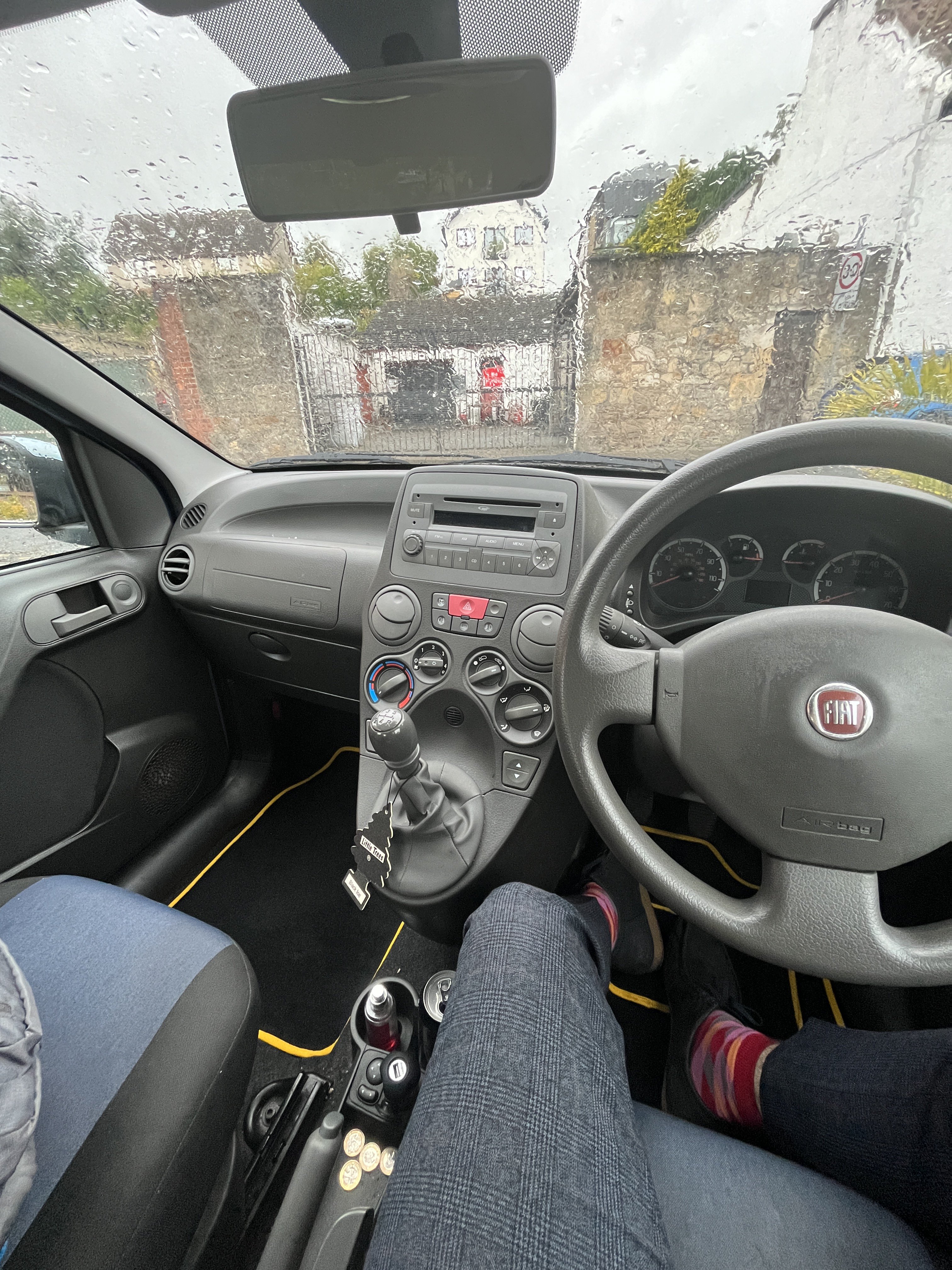

The first thing on my mind is the chance to replace the driver seat. I slide around a bit on roundabouts, even at 15-20mph, and I love the idea of tweaking this little care with fantastic little mods here and there —
Recently found £5 racing seat someone is trying to get rid of, and I’d love to install it and see it up. (Pictures attached including one of my car!)
Anyone have experience with changing the seats?

Great to see your Panda getting the love it deserves!
In terms of future-proofing I would definitely focus on rust-treating the rear axle, rear sills (access through bung in rear wheel arch), engine oil sump pan, coolant return pipe in front of engine, and mud trap behind front springs.
All other parts are cheap and fairly easy to replace when needed.
Swapping for other Panda-based cars' seats is well documented on here. 500 / Abarth 595 / later Ford Ka seats fit with some minor modification.
You'd need dimensions of that seat you're looking at to know if it will physically fit, and be prepared to get creative to bolt it to the existing mounting holes on the body.

customize the gear knob if possible (I don’t think Fiat made it conducive to that however)
The Panda gear knob pulls off, it's not threaded and there aren't many aftermarket ones like this.
I've seen some that were just epoxyed in place, then you need to allow for the lift up reverse collar.
I've thought about getting a second hand standard one and having it retrimmed in alcantara or leather (or doing a terrible job myself - I'm good at that kind of thing).
But then koalar's comment reminded me that cooperman recently put a six speed lever and cables from a 500 in their 100HP:
Which made me think, presumably a 5 speed 500 lever with cables would work on our standard Pandas?
Pulling off a standard Panda gear knob often damages it internally so it now pulls off too easily. It's actually not solid plastic.
This is nice but won't match the Panda reverse gear slider.
