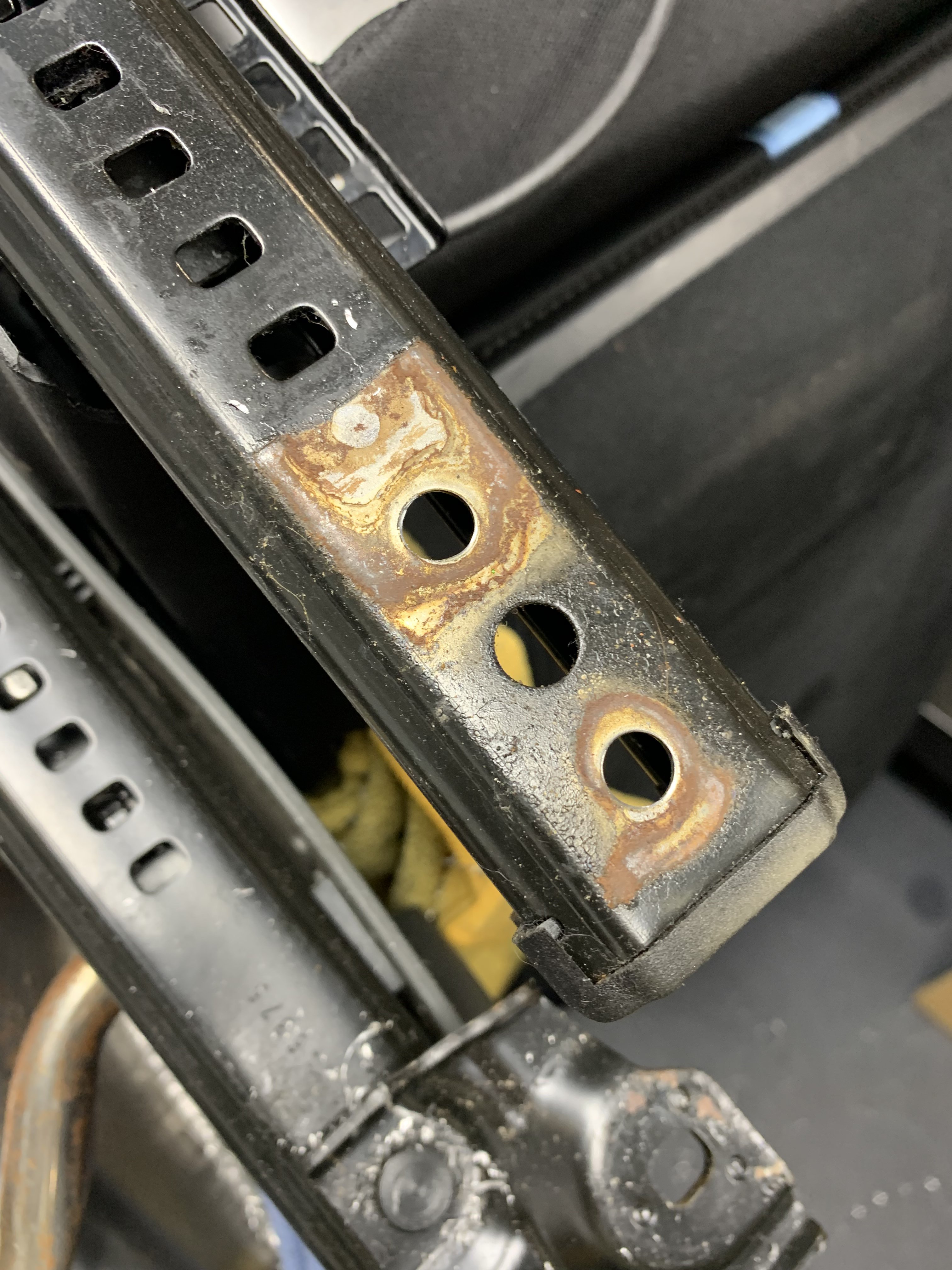

Panda bracket - holes part-drilled
500 bracket-
The end rivet on the 500 bracket is impossible to reach with a drill bit, so I jacket it off-

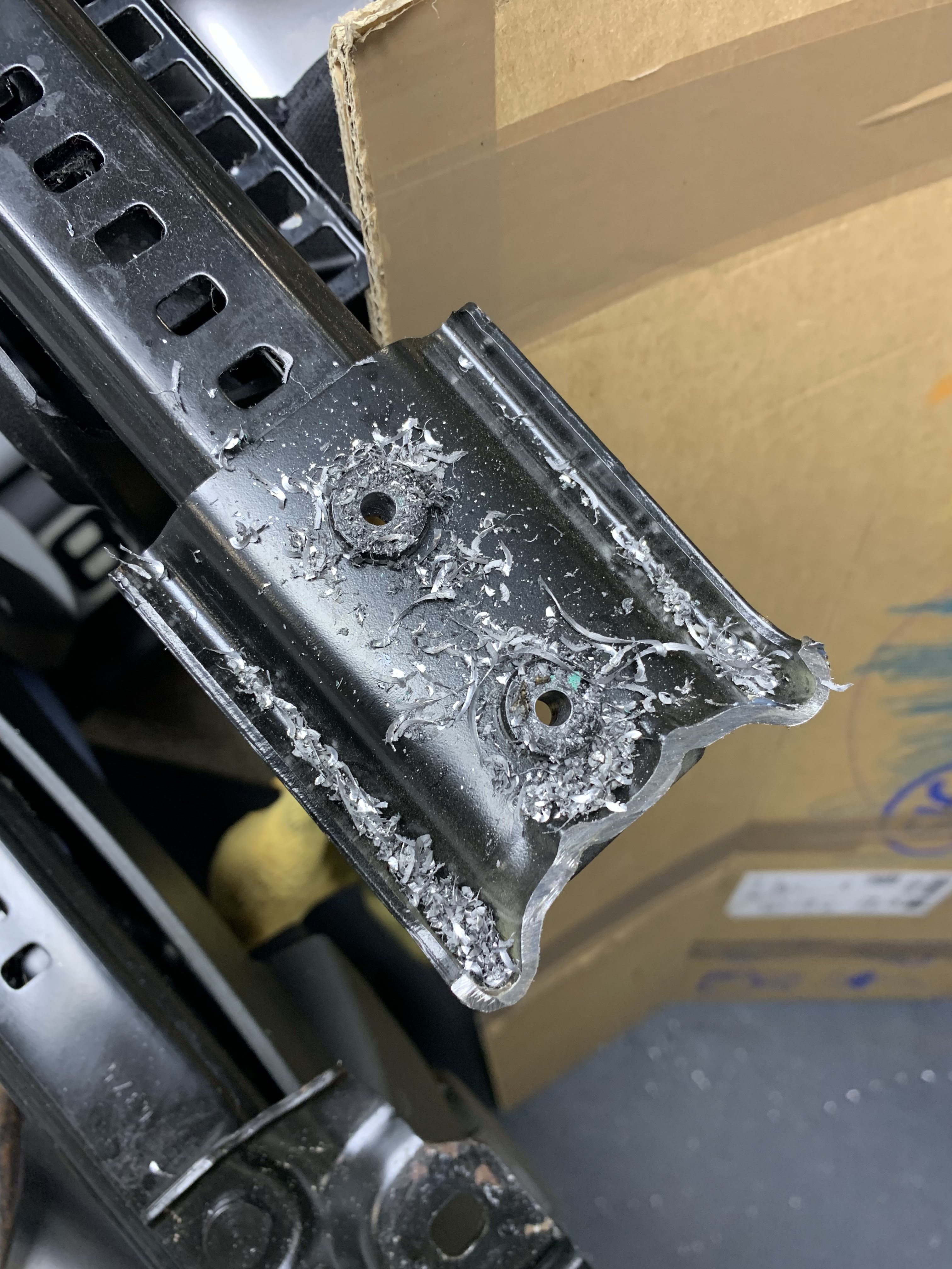

Then drilled out the rivets-

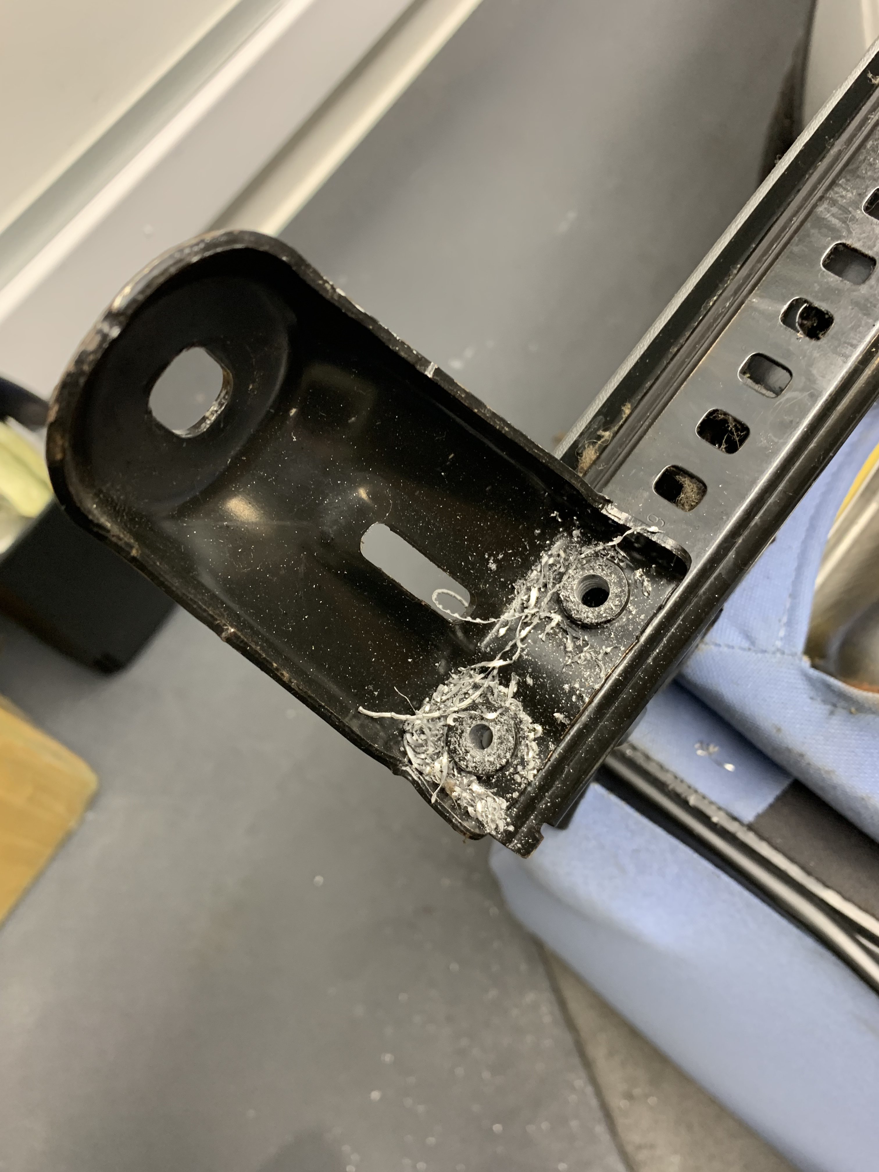

Brackets removed-

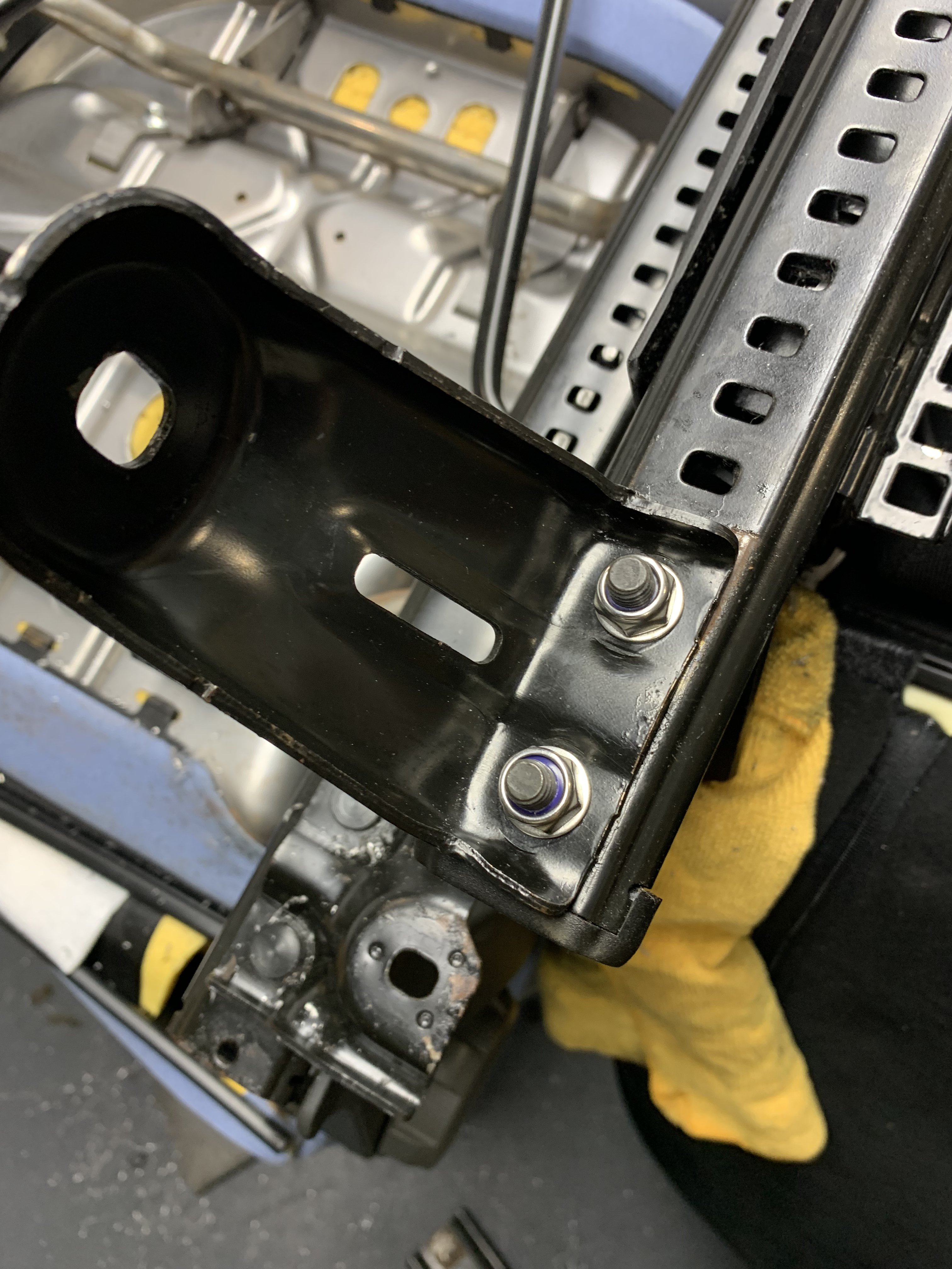

Panda bracket bolted to the 500 rail with 2x M8 Allen bolts and Nyloc nuts-
