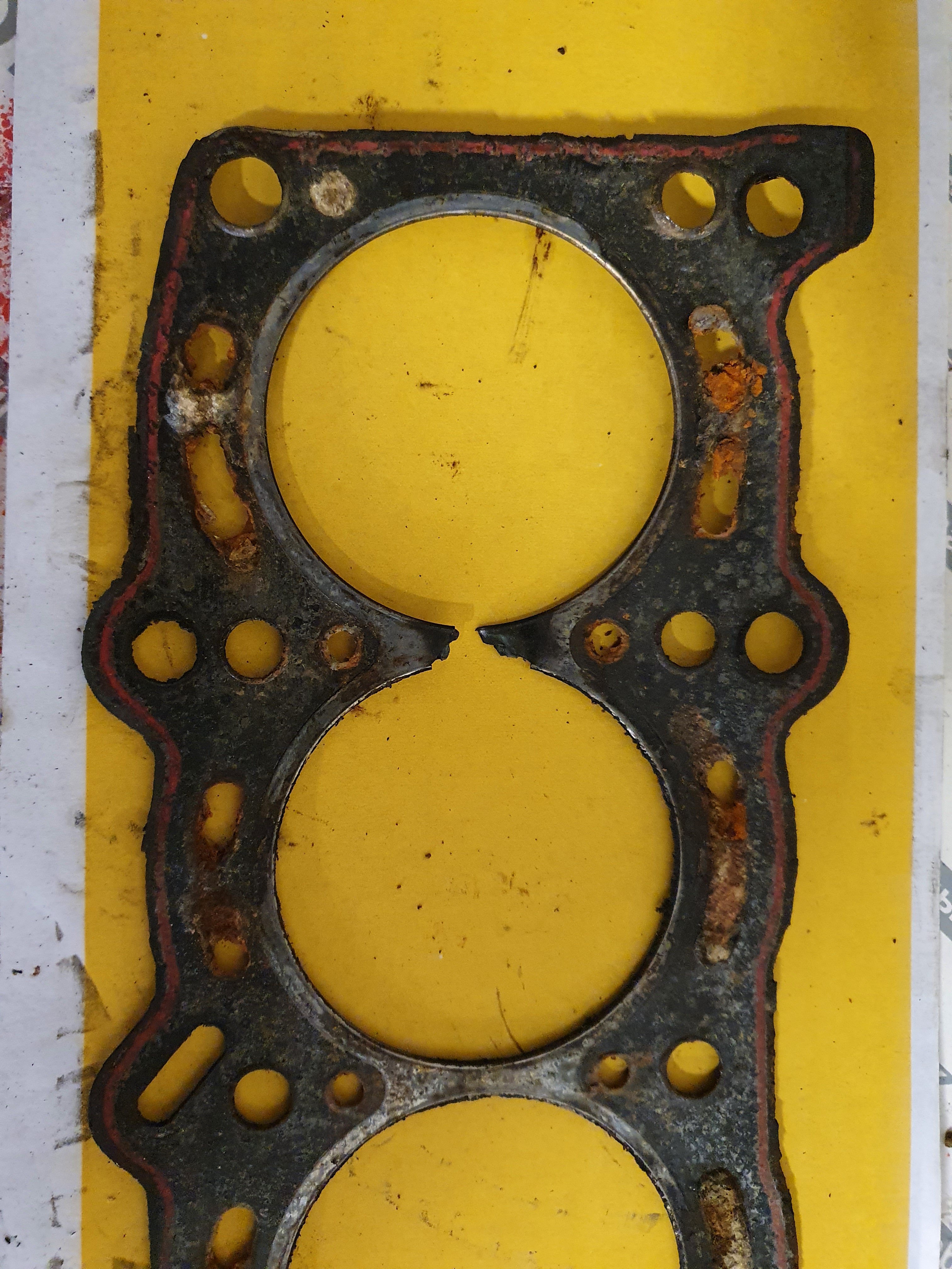

Garage hsve found a clear leak in the head gasket between cyls 1 and 2. Explains why the oil and water were good compression was 73 and 140 in those two and 170 in cyls 3 and 4. Head pressure checked all good just waiting for it to be built back up. Bill is as yet unknown but guessing itll be c.£400.

Gasket breakdown between two cylinders is quite a common way for a head gasket to fail. In such cases, the coolant passages usually aren't compromised, so a coolant check will show nothing amiss.

Definitely head gasket. Cant believe how bad this looks though........all good now.
