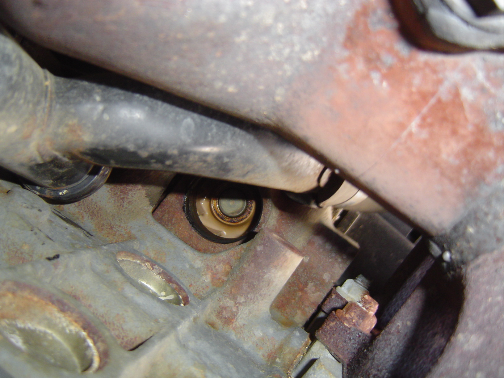

Finally got the rail out - the power of the hammer!
The impellor looks ok - see photo.
Should it be able to be turned by hand? Can't seem to.
Is it possibly seized? (No screeching noises in the past)
I want to fix this - don't want to have to borrow the wife's Golf:cry:
No.
timing belt will stop it from moving (by hand)
If T/belt was to be disconnected and then turned by hand you should be able to move the pulley and watch the fan work
However - the bearing in the middle don't look great.... rust when there should be anti-oxidising stuff in your anti-freeze
If you turn the engine over by hand you should see it moving :) Camera phones come in handy here to watch for movement while you crank it :)
